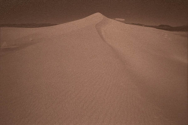

Here is another cyanotype.
Good one! I think it works because there are no white highlights. I kind of gave up on toning cyanotypes because -- as Serdar has noted and knows a lot better than me -- the highlights don't really clear all the way. There seems to be an unavoidable light yellow or light pink "stain" in the highlights. I'm also kind of fanatical about highlights, and can't be happy if I don't like the way they look :smile: So this is definitely a YMMV thing.

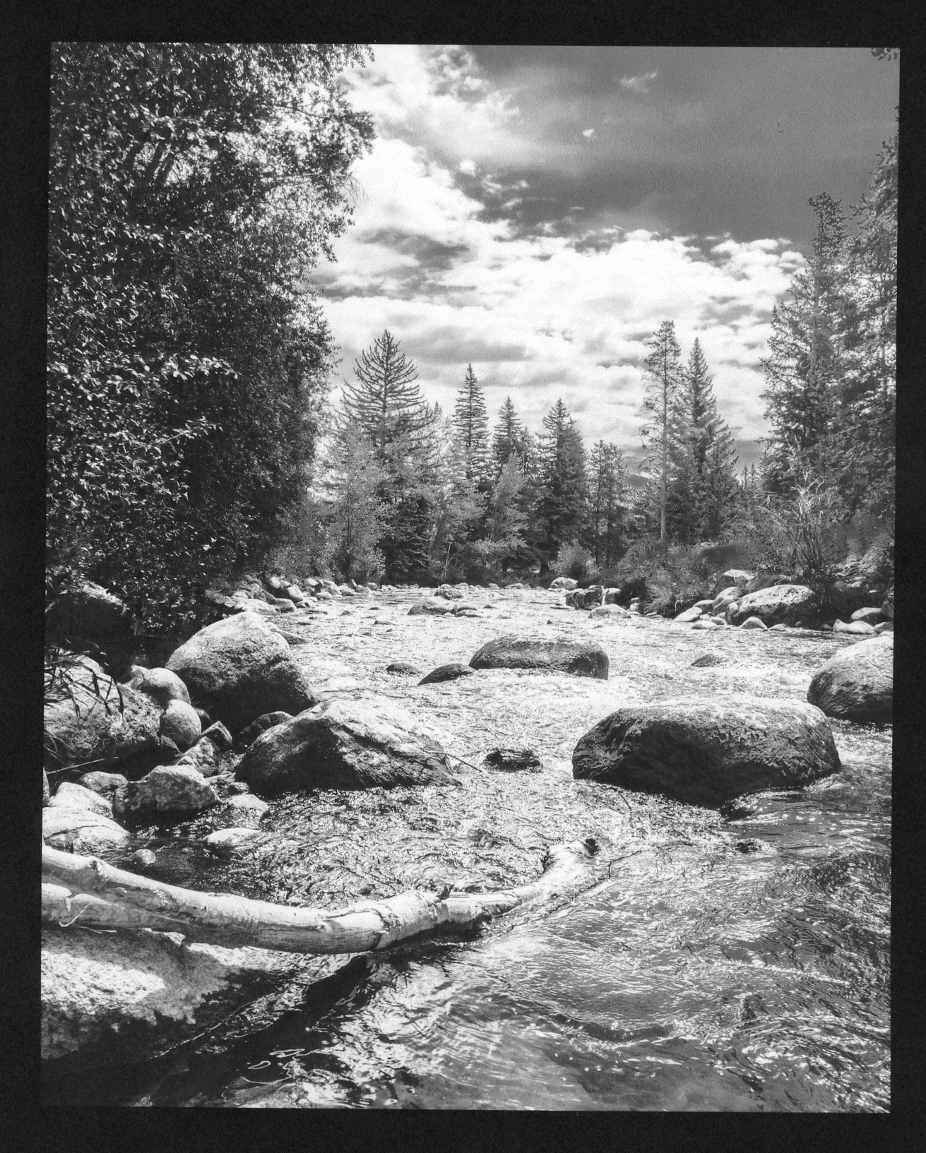

Some Kallitypes from yesterday - still kind of trial and error on the negatives, probably need to learn quadtone RIP and run through the calibration sequence. These were made from digital images taken with Fuji X-T1, printed on Fixxons transparency. Used the B&S Pl/Pt curve and iteratively adjusted the contrast and brightness setting in the epson ABW menu to get these results - standard B&S chemistry with "black" developer. Gold toned for 10 minutes standard hypo fix 2 minutes, hypo clear and wash.
Revere Platinum paper, single coat, used the Onforu 2 Pack 96W Black Light Bar, LED Blacklight (385 to 400 nm - great for kalli) - thank Rollieflexible for the recommendation. They could be tweaked a bit WRT contrast, but overall not too bad. I have a large injet print of the Paris scene and the Kalli (5X7) looks very similar but with a bit more tonality. The stream is Gore Creek just outside Vail Colorado (6x9)....could use a bit less contrast/more midtone, nevertheless I am pretty pleased with both of them given my limited experience. These are best two of six so some lessons were leaned, including don't leave your print face down in a toner tray with ribs...

Not bad!
I'm not sure I would do anything to change the Paris print.
As you say, the creek print could use a bit of work, especially in the highlights. Since you are using a "found" curve, I would try tweaking the curve. Found curves are a great starting point, but are rarely optimal in my experience.
Alternatively, you could try some burning in on the image before inverting to make the negative. One of the things I like about digital negatives for alt processes is the ability to dodge and burn before printing a negative.
