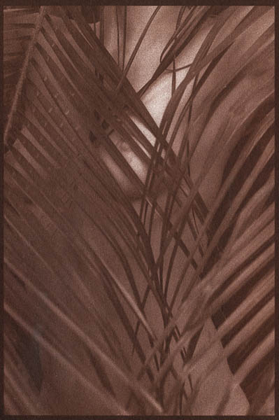

very stable if one sprays the exposed paper with sodium carbonate.
Hey, that's a neat trick, I didn't know that. You mean stable in the dark, right?
I do vaguely recall that turmeric was very pH-dependent in the hue it gave, but I only played with anthotypes briefly, and it's about a decade ago...
fgorga
Aug 31, 2015
858
New Hampshire
Also fairly stable in the light, however I have not really investigated this systematically.
The turmeric extract (using iso-propanol) is bright yellow when coated on the paper. Thus the untreated print is fairly low contrast (yellow image on white paper). Spraying the print with a solution of sodium carbonate turns the image a red/brown and the paper generally a light brown. Different papers give varying results both in term of the image color and the background "stain". One has to carefully spray on the carbonate as the pigment is water soluble and thus the image will "run" ("bleed"?) is one get the paper too wet at this stage.
Examples can be found here: https://porfolio.gorga.org/anthotype (the first two images are made with paprika, the remainder with turmeric).

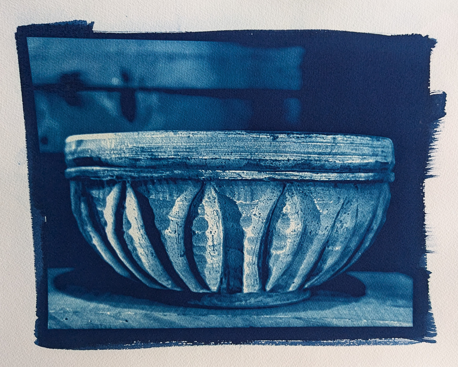

Way back in June, Niranjan (@nmp) posted a cyanotype toned with sumac, see: https://www.photrio.com/forum/threads/showcase-for-your-hcwps.199853/page-20#post-2803705
Seeing this very nice print piqued my interest in toning cyanotypes, a topic I had explored several years ago, see: https://www.photrio.com/forum/threads/on-the-toning-of-cyanotypes.175185/
Thus, I bought Annette Golaz's book about toning cyanotypes with botanical material, see: https://www.routledge.com/Cyanotype...ueprints-Naturally/Golaz/p/book/9780367553548 and, earlier this week, I did some tests following the method she describes. I'll not describe the method. Buy the book if you are interested; authors deserve to be compensated for their efforts.
The last time I made cyanotypes was four years ago. All of these prints were made on Hahn. Bamboo Mixed Media paper using traditional cyanotype chemistry with one small change; the stock solutions which were mixed 1:1 by volume were both 10% (w/v) rather than the more typical 25% and 10%. Prints were 'developed' in 15% vinegar and then washed extensively. Toning occurred several days after printing... i.e. the prints were dry before they went into the toning tray.
I was half expecting results similar to those seen with the typical tea, etc. toning of cyanotypes (lots of staining of the paper with concomitant loss of contrast) but was very pleasantly surprised with the results.
Here are a few of my results:
Cyanotype toned with ferns (foraged from my yard)
Cyanotype toned with sumac gall tannins (purchased from a supplier of natural dyes)
Cyanotype toned with marigold (purchased from a supplier of natural dyes)
Cyanotype toned with weld (purchased from a supplier of natural dyes)
Untoned Cyanotype
And one more... sorry for the different negative. I ran out of prints of the other image.
Cyanotype toned with dried tarragon (from the grocery store)
The supplier of natural dyes I bought from is https://longridgefarm.com/. They are located fairly near my home which is why I chose them. I took a drive and picked up small amounts of various materials rather than having them shipped.

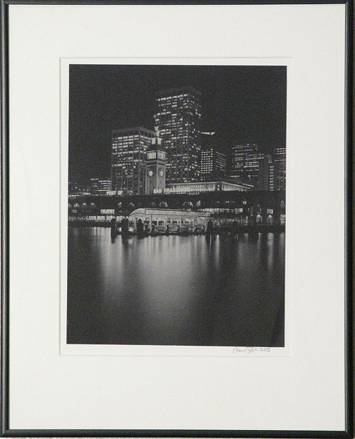

Salt Print
One of my favorite salt prints which I have had on display since I printed it back in 2013. I forget now the paper that was used - either Fabriano Artistico, Lanaquarelle, or Bergger Cot 320, all of which I was using in those days, and (IIRC) toned it with a gold sodium acetate toner. What I do recall vividly is the difficulty I ran into in shooting the negative. This was shot with a Toyo 810G from the end of Pier 1 looking back at the Ferry Building which is located at the foot of Market and Embarcadero in downtown San Francisco where it is next to impossible to find a parking space. I arrived at the end of the workday when everyone was leaving for home and was there ready to snag an open spot when one suddenly became available 1 block away. I wheeled the camera in its hard case and a Manfrotto 475B tripod with my 2-wheel dolly to the end of the pier. The plan was to set up the camera and focus while it was still daylight and wait until darkness had set-in to take the exposure only to discover while determining the exposure with the spot meter that I had left the Delta 100 exposure sheet with the reciprocity curve at home. So I returned the next day and again managed to get a parking spot just a few feet from where I was parked the day before. The plan was the same and this time I had the data sheet. But upon determining the proper exposure and waiting for the incoming/outgoing ferries were both away from the Pier and the swells produced by their propellers had subsided (I wanted an unobstructed and smooth as possible foreground) just as I was getting ready to trip the shutter the lights all along the waterfront suddenly went out! Initially I entertained the idea that this was some sort of conspiracy by security whom I knew were aware of my presence from the security cameras that are employed on the Pier. The next morning I called the Pier and was informed that a construction contractor had accidently cut a cable which resulted in the power failure. So back out for the 3d consecutive night and unbelievably got a parking space just 1/2 block from the previous. This time everything went according to plan and I took the 15 second exposure using a 360mm Schneider Symmar-S.

Salt Print
Tom,
A very nice print.
I think that every landscape photographer has a similar story about the patience needed to get the photo one has in mind. Too many beginning photographers don't understand the patience that photography needs. Come to think about it, one can leave the "beginning' out of my previous statement and it would still be true!!! 😉
Thanks for sharing your tale.

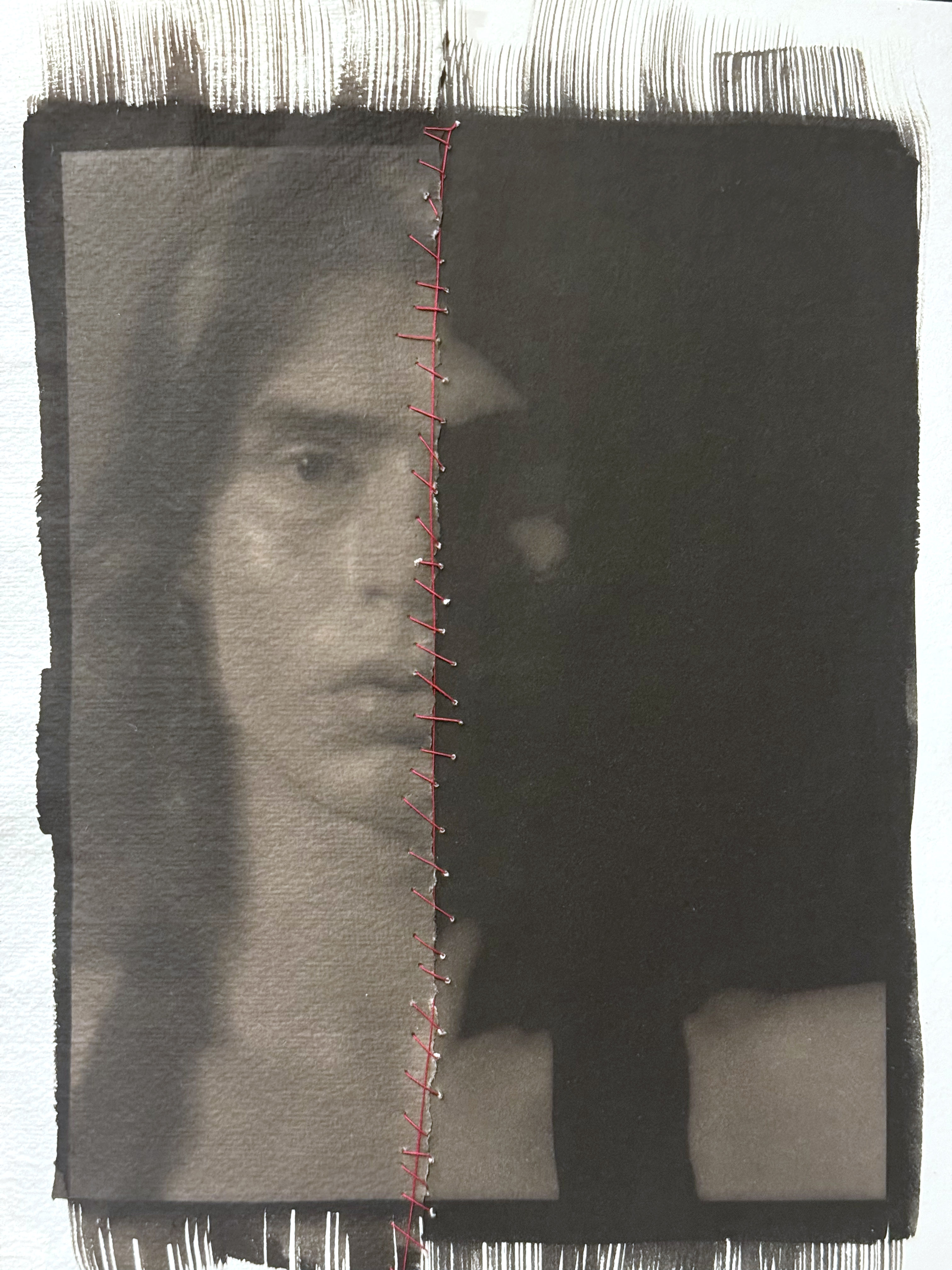

Doing something a little different:
full
I took the portrait image, made two different digital negatives; one straight, one tweaked to give deeper shadows. I made prints from each negative on different papers, then tore the one print to split the model's face, and then stitched the two prints together and attached the top layer to the bottom layer with wheat paste to keep it stable. The "clean" half was printed on Velke Losiny Prague, which is a textured cold press paper. The "dirty" half is on Berger COT320. Both prints are palladium with NA2, developed in Potassium Oxalate.
full
Nice! I really like the choice of the red thread.
