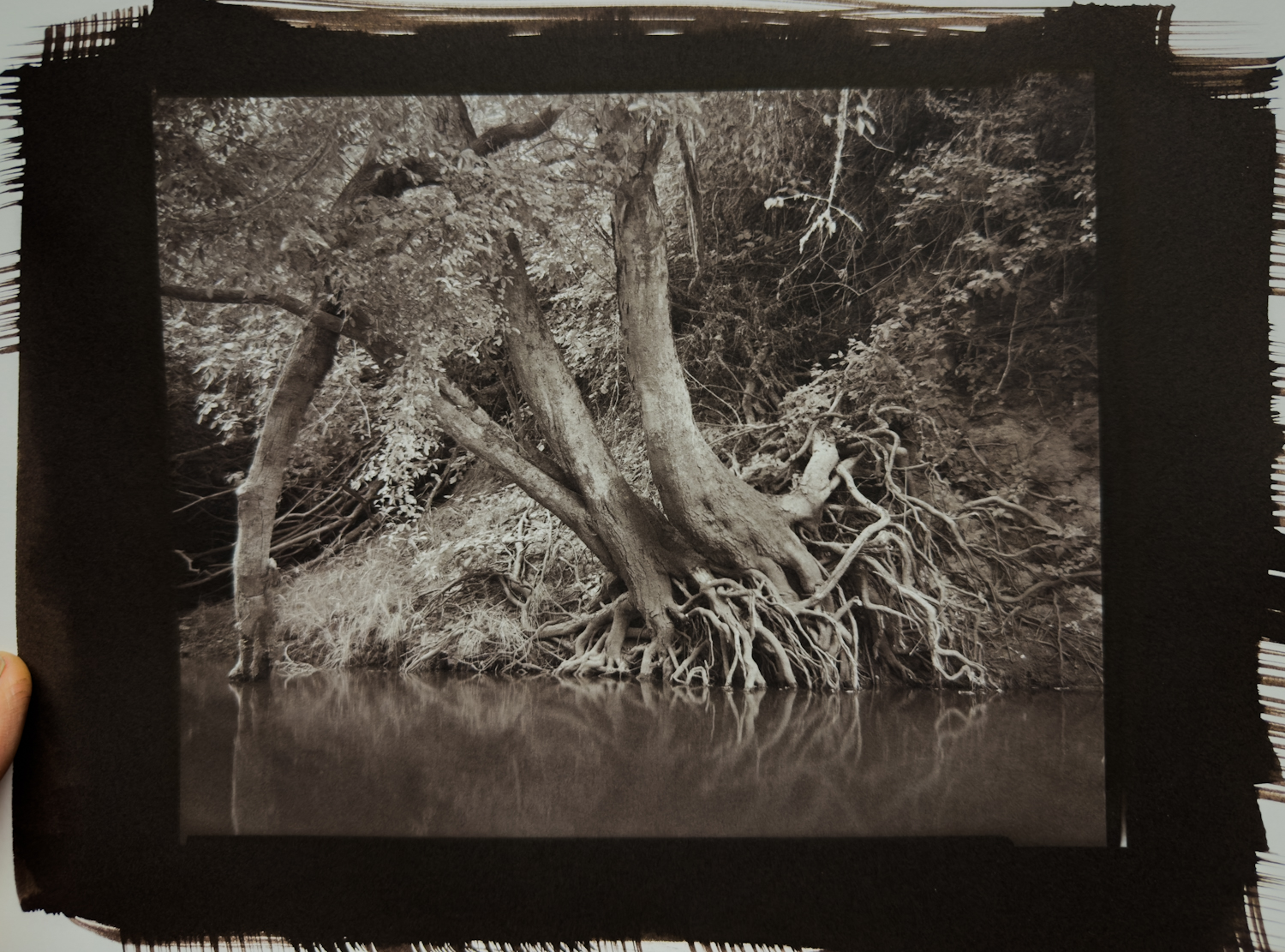

An 8x10 Kallitype from an in-camera negative (FP4, developed in double strength PMK). This print was gold toned before fixing. Paper used: Hahnemuhle Platinum Rag.

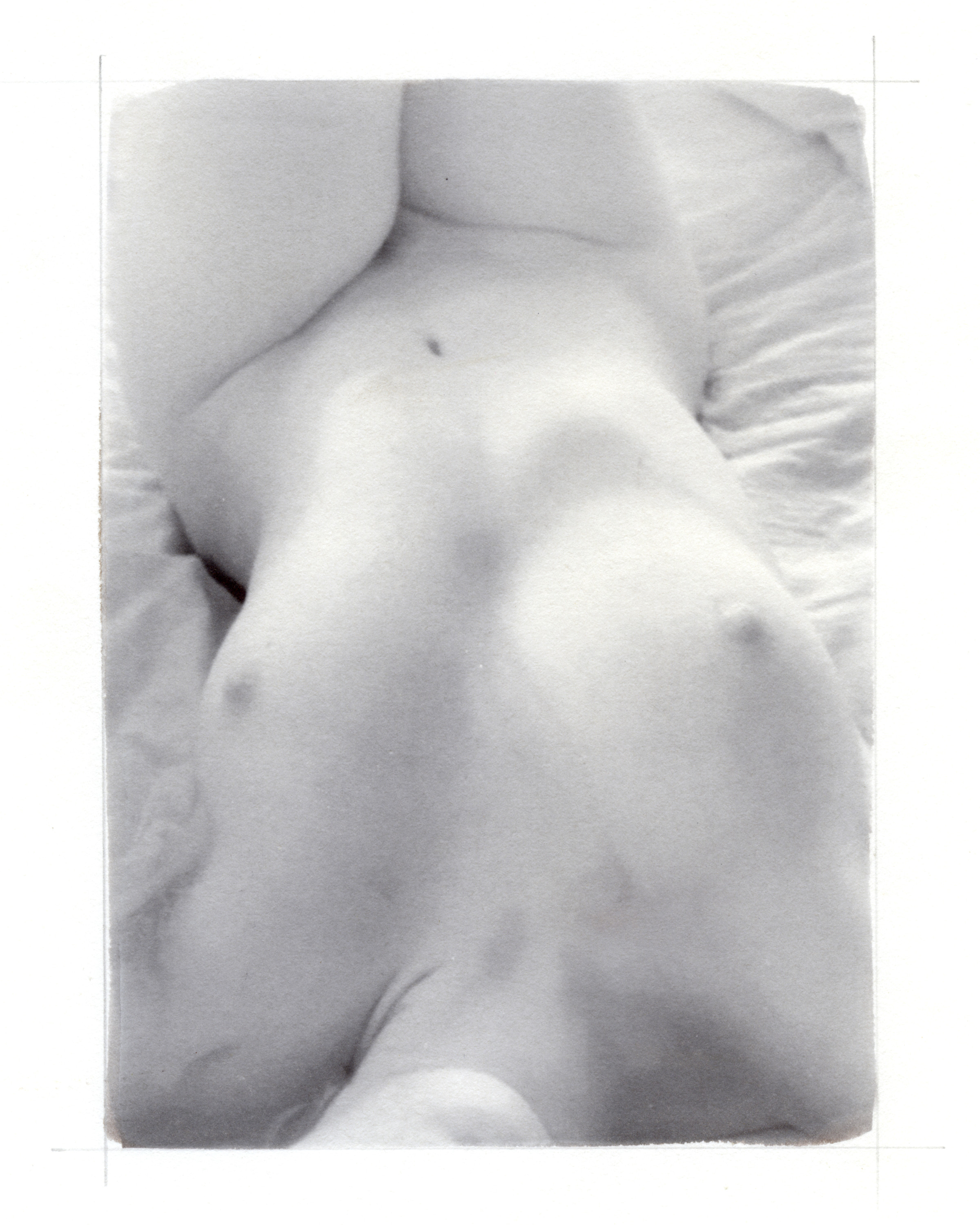

Okay, let me give this a whirl. Here's a kallitype, toned in platinum. I shared this with two other photographers. They gave diametrically opposite opinions. If you have thoughts, I would like to hear them.
I praise your sensitivity to other people's feelings regarding this type of subject matter. The small block that reads spoiler is probable a good idea. I'd remove the "more naughty bits" or change that part of the phrase because the images are too beautiful to be called "naughty".
FWIW,
Robert

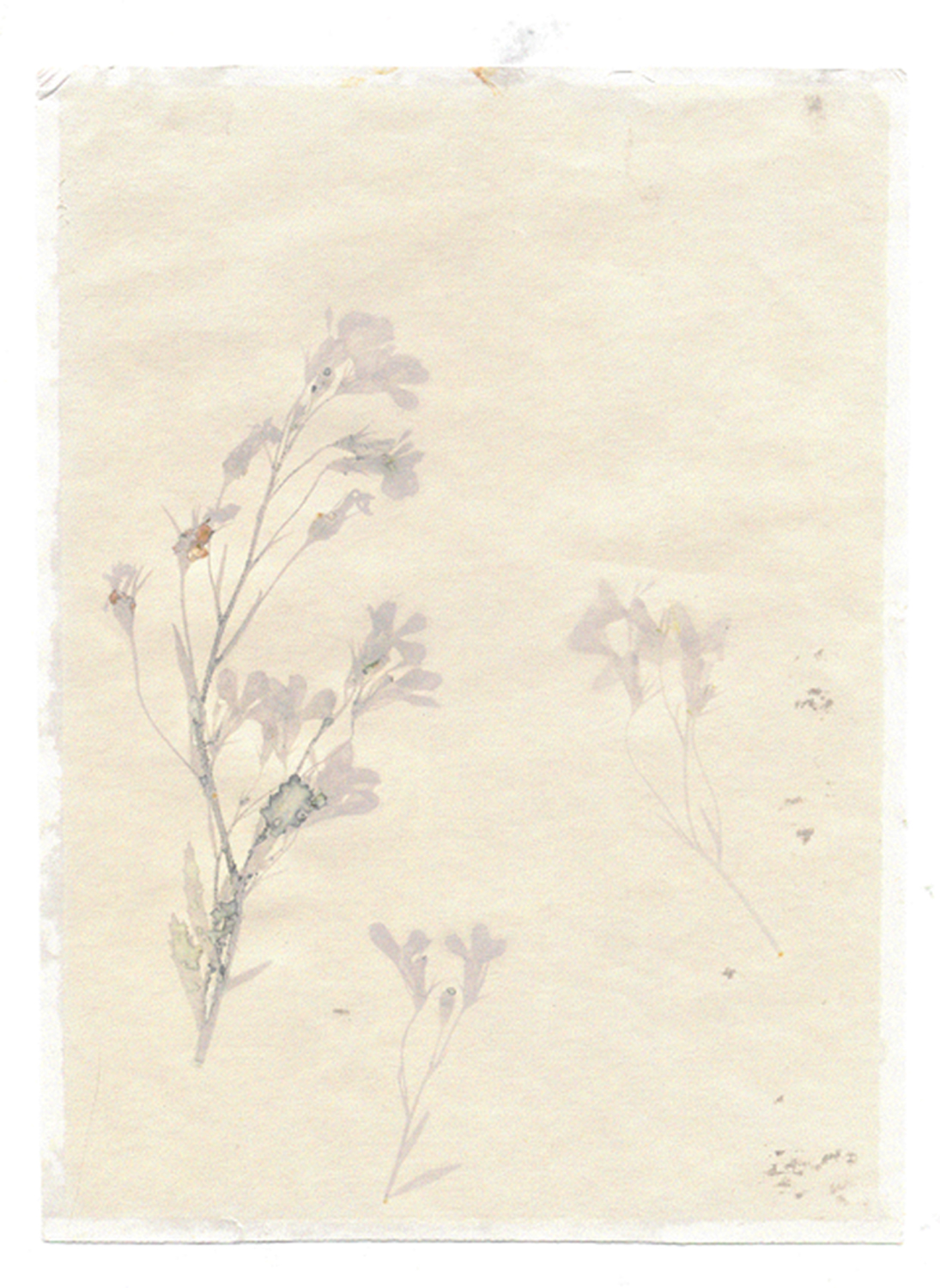

I think this was made using the juice extracted from Peony flowers in distilled water or Gin. Exposure was several days. The paper was Arches art paper.

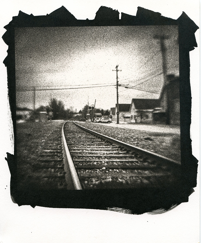

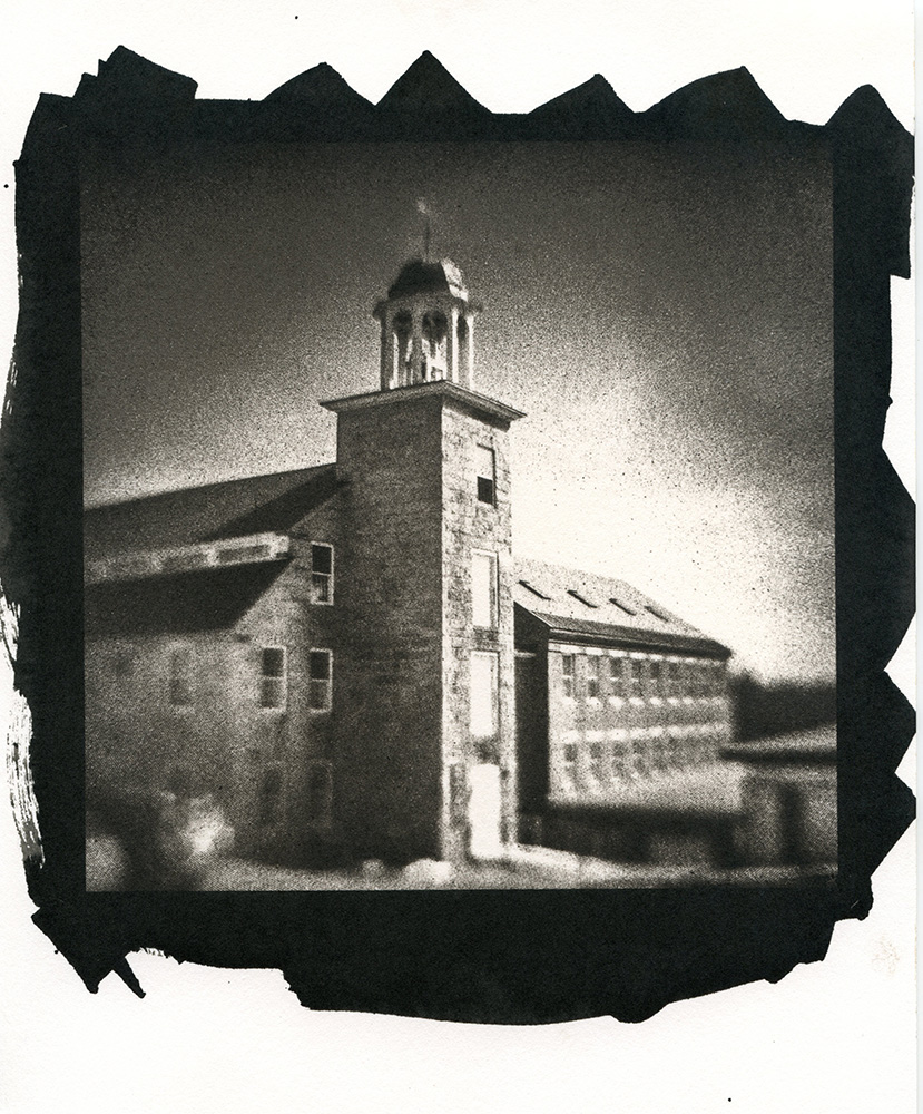

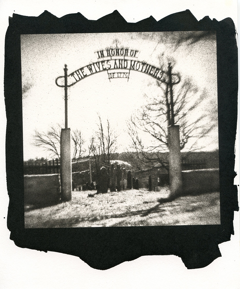

Three Pt/Pd prints made today. Images are 6.5" square on 8x10 sheets of Revere Platinum.
The exposures were made back in March using my camera obscura, see this post for more details about that: https://www.photrio.com/forum/threads/finished-cyanotypes.177566/post-2314740.
The latter two are places I visit (and photograph) more-or-less regularly.
Railroad Tracks at Windsor, VT
Cemetery Gate, Temple, NH
Cheshire Mill No. 1, Harrisville, NH
So, an anthotype. Thanks for the details.
I've experimented with anthotypes, mainly using tumeric which is relatively fast (exposures of several hours) and very stable if one sprays the exposed paper with sodium carbonate.
I have also tried paprika which is also fast but not very stable. The prints faded to 'zero' in the dark over a few months.
