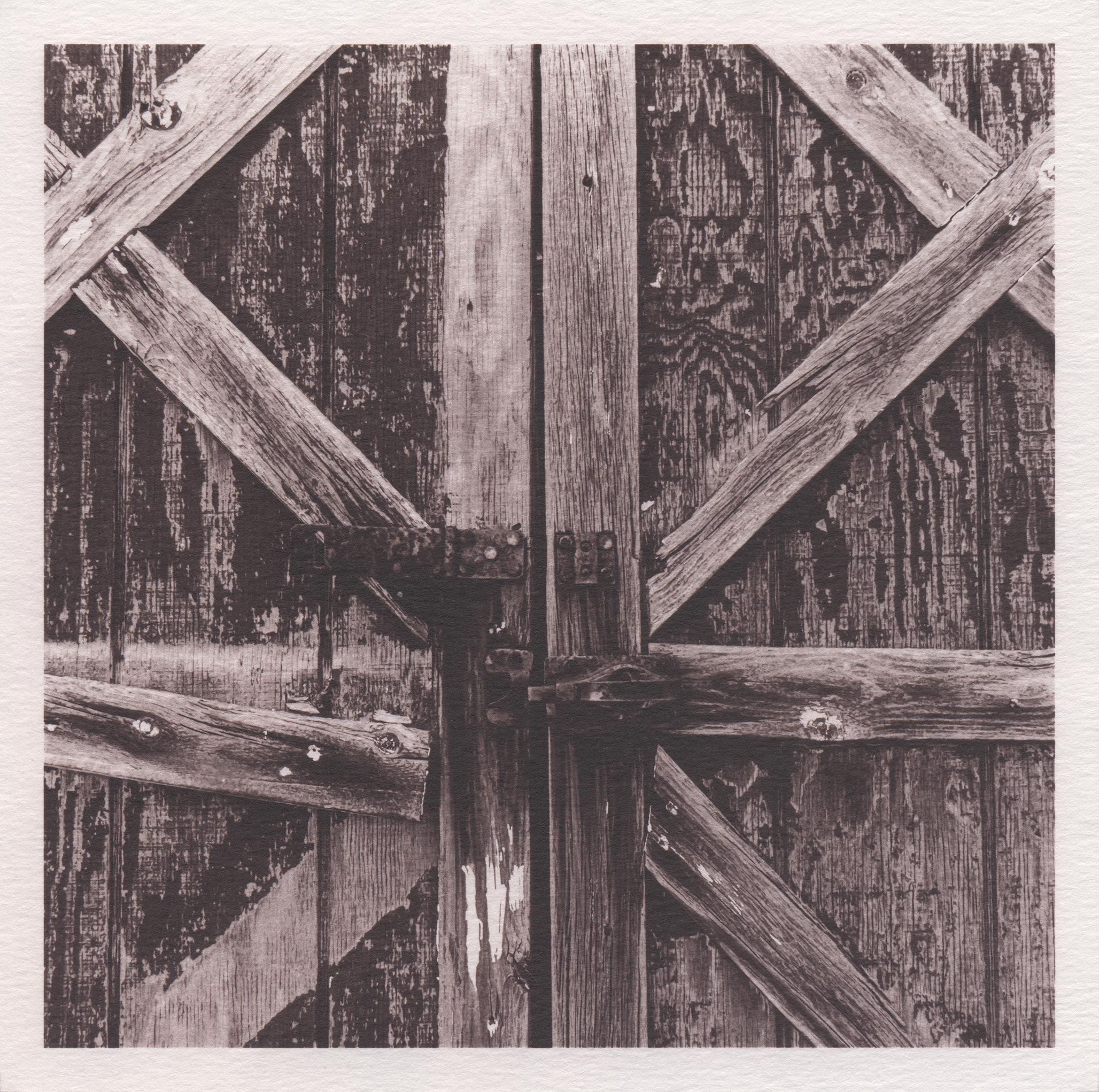

One more classic cyanotype toned with Sumac extract on Canson XL Watercolor 300 gsm paper:
Barn Door. Frederick ,MD.
Thought the rust and faded paint would look better on a brown print.
Might be the last one for a while (hopefully not never) before I move to my new place and figure out how to set my work flow all over again.

lovely print - I am intrigued with the sumac toning. I have experimented with other plant based toners when I first became interested in cyanotypes, but dropped it as I moved on to other processes. I may give this a try again - I see the sumac extract is commercially available so somewhat easy to obtain. I have used that paper for cyano in the past and had great results. Good luck on you move and setting up a new workflow. Again a really nice print

Thanks Dave.
I tried a number of alternative tannins and found this one to give the best characteristics in terms of most toning (retaining Dmax) with least staining. Close second were oak gall extract, tara extract, and ACS grade tanninc acid which all gave much better results than the usual suspects like coffee, tea, etc. This print was treated for 10 min in 1% toner after bleaching a freshly made print without drying in between.
I bought it from an on-line shop not too far from you (Roanoke, VA):
A bit pricey, but I like the results - particularly the color. I used only 1g per sheet (6"x6") to make 100 ml solution that was used one-shot.
:Niranjan.
P.S. Earlier I made an error in answering a question from @koraks, I think I said it was extract from the bark of Sumac tree. I guess when I bought some I ended up, without knowing the difference, ordering extract from gallnuts of Sumac tree instead.
Ah, thanks; I was wondering about this. I'm familiar with the seasoning sumac, which I think is the dried fruit of the 'sumac' tree. I'm not a botanist, but I think there's quite a few rather different trees or shrubs out there that are all referred to as 'sumac'. The sumac that's used for culinary purposes has a slightly acidic, tangy taste, but it's a far cry from the levels of tannic acid you find in stuff like acorns, oak galls etc. I doubt the culinary sumac will do much in the way of toning cyanotypes.
Coincidentally, I also did experiments (years ago) with oak-based concoctions for cyanotype toning. I found that boiling the de-husked acorns and then reducing the liquid yielded a very good toner concentrate that indeed gave pleasing magenta/purple tones with relatively little staining. I was looking for something brown/black at the time, so I didn't do much with it apart from a couple of tests. Maybe I should revisit this when autumn comes.
I did the same thing some time ago since I also have an ample supply of oak acorns right outside my building that rain down in the fall and hurt you if you are not watching. The problems with those I found was when you boil them after taking the outer shell out, the liquid also contains some other components like fats, carbs and proteins, which by the way they are full of actually making them quite nutritious if you remove the tannins. Native Americans used to do that by putting them in a bag and hanging them in flowing water. Apparently, squirrels do not dig and bury them only to store them for the winter but also to allow the tannins to be absorbed by the moisture from the soil, making them eminently more palatable. Smart, those squirrels! Anyway, these other ingredients tended to mess up the paper. I am sure there is probably way to purify the concoction but that looked like too much work so I abandoned the effort.

I mostly remember a very heavy, hairy mat of mold growing on top of the concoction when I dug up the jar a few weeks after having done my initial testing. Something very nutritious must have been in there for sure.
