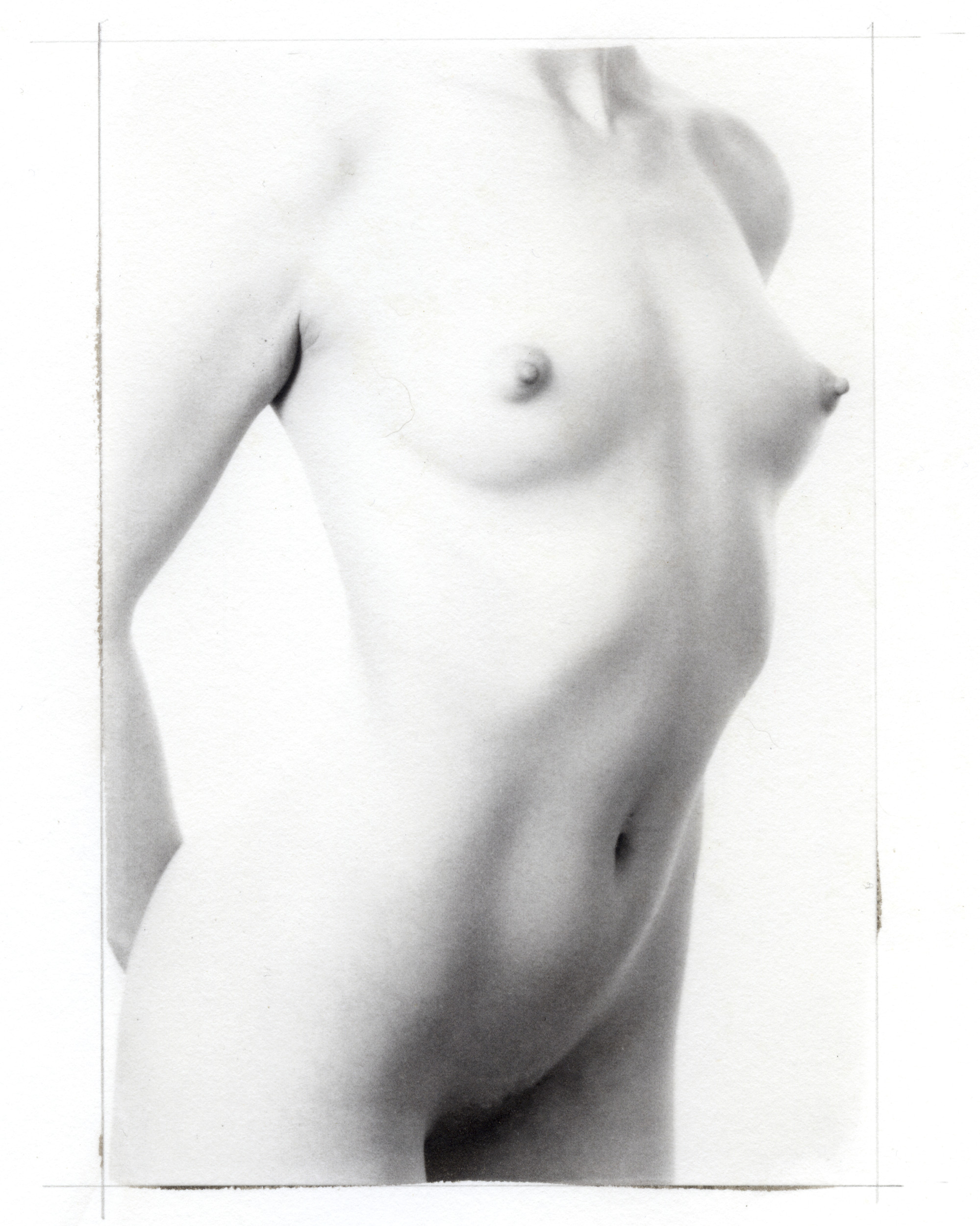

Jo, it’s a fair question and I don’t have a ready answer, yet. Twenty years ago, I started shooting a series of nude portraits. It was all about the eyes. Nudity was a thread but I worked hard to avoid erotic suggestions. I wanted to play on the incongruity of nude portraiture as a way of exploring what a portrait is, and how viewers process nudity out of the expected contexts.
This time, I want to revisit naked bodies in a less cerebral way, on a more inchoate level. Some, like the first image, are cropped and reworked negatives from the portrait series. Others, like the second, are newer images. Your question of how these work as gravures is a fair one. I am about to find out.

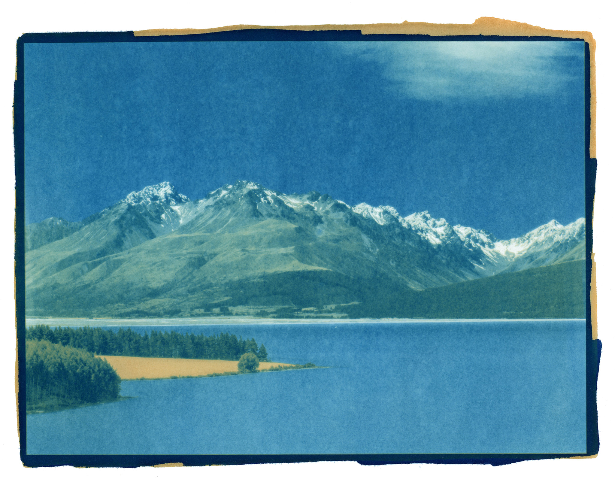

I'd suggest to start with duo-tone cyanotypes, @Rolleiflexible. Tri-colours are great if they work, but the madder root for the magenta layer stains fairly strongly and can be a source of frustration (at least to me it is). For duo-tones, all you need is the (classic) cyanotype chemistry you already have and a bleach (like sodium carbonate). You also need to only linearise two processes instead of three ;-)
For duo-tones, the choice of subject is very important, since you cannot create reddish warm tones. However, skin tones work to a degree, since the yellow is more an ochre than a pure yellow. But it's best to choose images that are almost exclusively made up of cyan and yellow.
When the image below appeared in the development of the cyan layer, I was quite taken aback. I didn't quite expect such a result at all. But I'm very pleased with how it came out.
Lake Pukaki - Duo-tone cyanotype

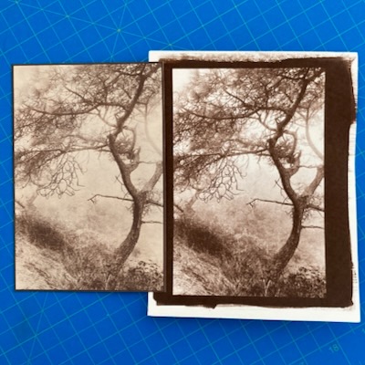

Niranjan, I used the Bostick kit. Paper was Fabriano Studio HP watercolor. It fogs unfortunately with the Bostick salt, but the fog worked for that image. I just salted some paper last night with a NaCl/Citric Acid mix I think you use (2%/5%) and the first print is much cleaner on the same paper. I just got lucky since the fog worked with the above image. You are right that I am new to salt prints so I mostly get crap. I've had issues with splotchiness so I decided to salt the paper by immersion instead of brushing. Seems to work better so far. I think I am also going to use a puddle pusher instead of a brush for the silver coat. I just need to make one. I have a big one but I don't make big prints too often.
Here is the print above next to the one from last night. The Citric Acid made quite the difference. Although the second is technically better, I think the foggy print in this case works better.
That's a dramatic difference. I would rather have the process of the right side and fix the "look" in the negative. That way you will have highlights when you need it. Of course, this is true if you are using a digital negative. If you are using an analog one, it is nice to have several difference options for the process/materials for a desired outcome as demonstrated nicely here.

I'm happy to see those whites more preserved in the 2nd one. Thing is... one of the things I like best about salt prints are delicate almost glowing highlights... need to be able to get to white to see the delicate ones. ( I'm the opposite of most people here... and don't care as much about "dmax" if the highlights are in good shape ) Have fun!

I went to last week's opening of The Nude show at the Southeast Center for Photography. There were over thirty works on display. One was a straight platinum print. Mine was a platinum kallitype. All of the other photographs were inkjet prints. Nothing, that I could see, was printed in silver gelatin.
While there, I saw other photographs of models I have shot over the years. It inspired me to go back and reinterpret a 2008 negative that I'd consigned to the outtake pile back then -- here's the kallitype printed this evening:
Not really surprising. I also had a print in one of their exhibition maybe two years ago. But I was very aware that the majority of the other submissions would be inkjet prints. I'm actually surprised that there was another platinum print there...
BTW, very nice print. Delicate gradients, which suit the subject well.
Patrick, this has a lot to do with the paper you're using. Fabriano Artistico is a very heavily buffered paper which makes it unsuitable 'out-of-the-box' for most alt processes. But I'm also one who really likes the surface texture of this paper and I am printing a series in Mike Ware's New Cyanotype on this paper. However, I have to pre-treat it with a soak in sulfamic acid. That sorts it out very nicely.
As to your prints: when you posted your first version, I was very much attracted to the ethereal look of the image. The fogging and loss of contrast make it stand out - it genuinely looks like a 100-year old print. The version on the right might be a technically better print (and, to be honest, a print I personally would probably aim for despite my following remark), but the first one has much bigger impact on me. Despite or because of its flaws. The haziness, the softness - I love it.

Okay, let me give this a whirl. Here's a kallitype, toned in platinum. I shared this with two other photographers. They gave diametrically opposite opinions. If you have thoughts, I would like to hear them.
I think it's lovely and tasteful. The cropping is good. I'd have liked a little more detail in the lower part.
I was actually using Fabriano Studio which is a cheaper paper than Artistico. I have ways around acidifying paper when I do cyanotypes, but that depends on the paper. I am still just experimenting with Salt prints. I have only made a dozen or so. I am just using whatever paper I have laying around to try to use it all. Artistico is a great paper though. One of the best I've found.
Yeah, I got lucky with the first print, but I'll take it! Sometimes it is better to be lucky than good.
Tom, thanks for the compliment. "Tasteful" is a minefield. Sometimes I worry that tasteful is a euphemism for anodyne. And the risk of giving offense in a broadband website (even in a narrower slice of it as here) leads me to choose prints that are least likely to give offense. But I know those are my issues, not yours, and I appreciate the compliment as you intended it.
Re the blocking up of detail at the bottom, it was intentional. I blocked up the highlights at the top of the frame, and wanted to balance that with blocked shadows at the bottom. I find myself blowing out and blocking up the areas that are not essential elements of the photo as I see it. So, in the high-key torso in Post 518, I blow out the highlights on the neck, shoulder and upper arm. I've already beheaded her -- I'm overexposing to distill her torso to its basic elements.

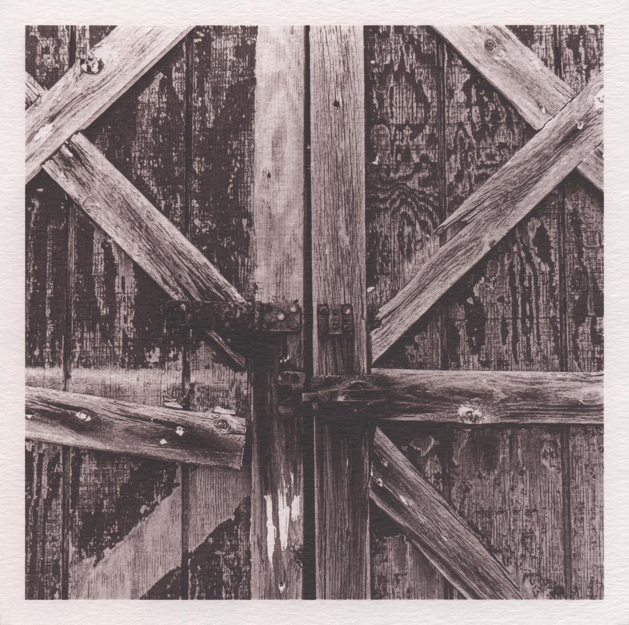

One more classic cyanotype toned with Sumac extract on Canson XL Watercolor 300 gsm paper:
Barn Door. Frederick ,MD.
Thought the rust and faded paint would look better on a brown print.
Might be the last one for a while (hopefully not never) before I move to my new place and figure out how to set my work flow all over again.

That sumac toner works wonders, @nmp! It's lovely.
I wonder if it would work well with a tricolor-approach too? Chroma is a little low, it seems, but this may make for a nice and muted palette.
Thanks! I added some contrast to the the original image that might have made the shadows a bit clumpy - I should probably back off a little. May be next time, whenever that is.
Interesting thought. May be @maverickaesthetics might have an opinion. For purer red, though, I would recommend cuprotype (without the acid toning.)
