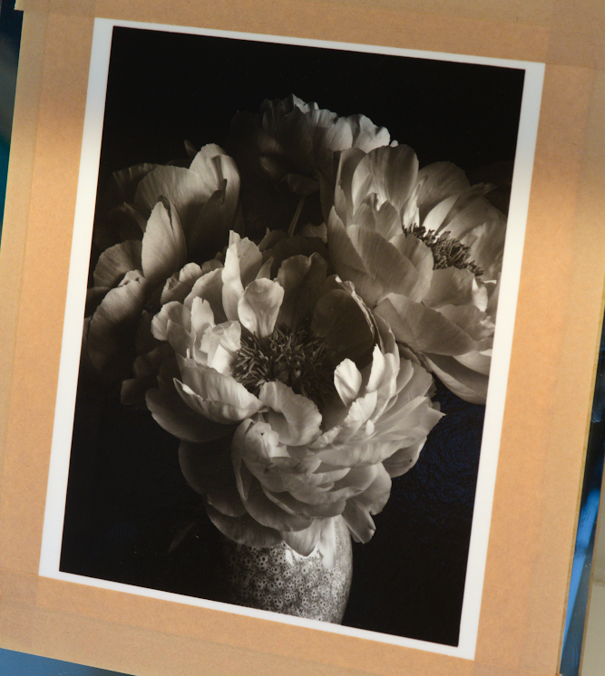

Thanks @nmp, much appreciated - and yes, this is a print I'm technically really happy with. It's now in the final stage; taped to a mirror, waiting to dry to a lustre finish:
Please do share final dried print.
I'll try, I'll try - but few things are more frustrating than trying to capture on a digital screen what a print looks like.
Yeah, this was definitely hand-made all the way. I've heard that the UltraStable tissues from the 1990s still print OK albeit with a little fog by now. I use less DAS in my tissues than Charles does, but the difference isn't as meaningful as it is with dichromate. Keeping pigment concentration down and negative contrast way up is the way to go. Exposures end up being long, but since DAS is so consistent, I get a decent print in one or two tries now.

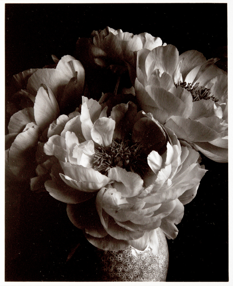

Here's the first version of the print from the same negative; I found this one a tad too harsh:
So for the version that's drying now, I used a tissue with a little less pigment and preflashed it ever so slightly. The net result is that the entire tonal range is compressed a bit, which makes the whole thing a little friendlier.
It's still flowers in a vase of course. But it was too hard to resist how the light played on those peonies - and since Calvin uses a peony as an illustration for his pigment prints pretty much all the time, I figured I should pay him a tribute.

Koraks, that's lovely. I've not seen many carbon prints but the depths of the blacks are wonderful and this print plays to that aspect of the process.
Thanks, yes, carbon tends to do wonders for the blacks/low values. High values are more tricky. One thing I've yet to try is to get a high-key image to really work well on the process. That's going to be one of my next steps in fact.
Wow, that's a sumptuous print! Correct me if I am wrong, but most of Calvin's prints are multilayer (even monochrome ones) so considering that this is quite an achievement.
:Niranjan.
Thanks much, Niranjan! Yes, I think Calvin uses exclusively multilayer techniques for monochrome as well. This print is a single layer print, and to be frank, I doubt there's very much to gain by trying to multilayer it. For digital/inkjet negatives, it does make a lot of sense I think. But I also believe that continuous tone silver gelatin negatives have a distinct edge in this particular department.

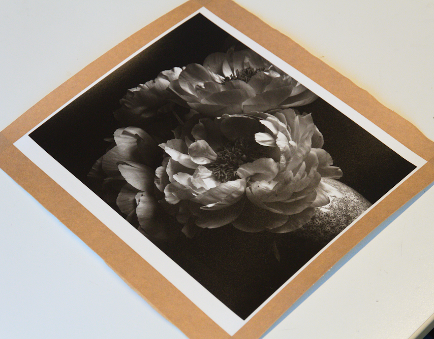

Finished print:
Perfectly beautiful print - I have been so impressed by the carbon prints I have seen in galleries, the blacks are so deep. This must be spectacular in person. The process produces such wonderful images, I would like to try it sometime, however the complexity keeps me from trying it - maybe in the future. Again - beautiful subject and print.

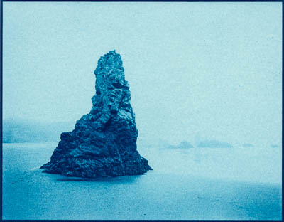

Nothing lowly about it, Niranjan. The delicate tones in the background are gorgeous!
Is this classic Cyanotype or New?
Thanks. Lowly (I was being somewhat facetious) because cyanotypes are so accessible and cheap to get something on paper. Barrier to entry is low but, like any other processes, it still requires a good bit of effort to understand the underlying mechanisms to make it do what you want it to do. In the end though it is the quintessential alternative process that was so even at the time of infancy of photographic print.
Some more data on the print:
- Classic cyanotpye
- FAC to KFi ratio is 1.75:1 by weight
- Overall solids content of the sensitizer is 20% w/v (20% each of FAC and KFi)
- T-20 in the form of premixing it in KFi @ 0.05%
- Paper is equilibrated in a saturated salt environment at 25C overnight
- Rod coated, air dried 10 mins, heat dried at 50 C for 10 mins
- Digital negative from digital capture using QTR on Epson P400
- Exposed immediately after drying 10 mins under a bank of CFL spirals
- Developed first with citric acid acidified tap water, then tap water and finally 1 rinse of distilled water
:Niranjan.

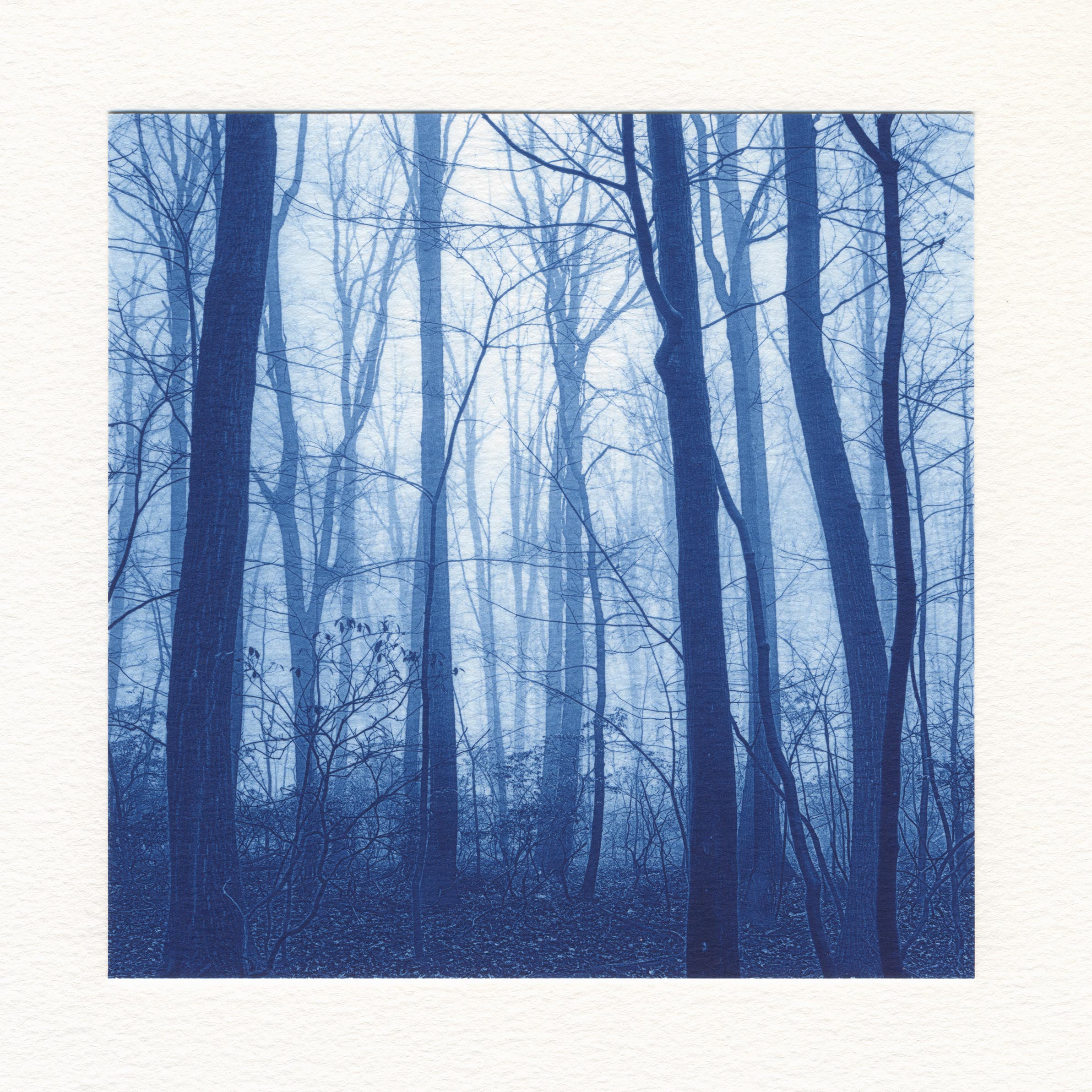

This is probably my print for the exchange as well. Regular ol' cyanotype on Bergger COT. Cyanotypes are easy to make, but to make a good one.... I acidify the mix as well as add some LFN. I picked up some Tween recently so I might start using that. I usually let the print soak in the first Citric acid wash for quite a while. I find I get better tonality that way, especially in the light tones. I'll sometimes let the print soak afterwards in plain tap water to bleach it a bit if necessary.
