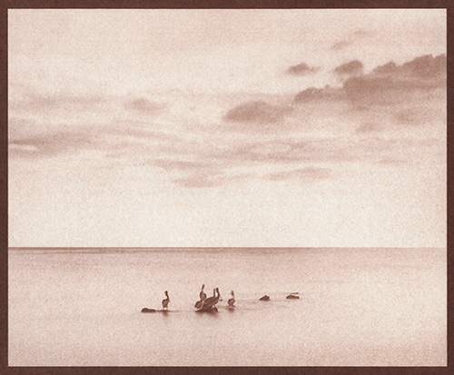

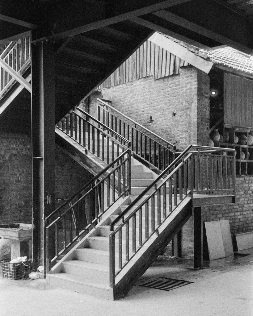

Salt Print
One of my favorite salt prints which I have had on display since I printed it back in 2013. I forget now the paper that was used - either Fabriano Artistico, Lanaquarelle, or Bergger Cot 320, all of which I was using in those days, and (IIRC) toned it with a gold sodium acetate toner. What I do recall vividly is the difficulty I ran into in shooting the negative. This was shot with a Toyo 810G from the end of Pier 1 looking back at the Ferry Building which is located at the foot of Market and Embarcadero in downtown San Francisco where it is next to impossible to find a parking space. I arrived at the end of the workday when everyone was leaving for home and was there ready to snag an open spot when one suddenly became available 1 block away. I wheeled the camera in its hard case and a Manfrotto 475B tripod with my 2-wheel dolly to the end of the pier. The plan was to set up the camera and focus while it was still daylight and wait until darkness had set-in to take the exposure only to discover while determining the exposure with the spot meter that I had left the Delta 100 exposure sheet with the reciprocity curve at home. So I returned the next day and again managed to get a parking spot just a few feet from where I was parked the day before. The plan was the same and this time I had the data sheet. But upon determining the proper exposure and waiting for the incoming/outgoing ferries were both away from the Pier and the swells produced by their propellers had subsided (I wanted an unobstructed and smooth as possible foreground) just as I was getting ready to trip the shutter the lights all along the waterfront suddenly went out! Initially I entertained the idea that this was some sort of conspiracy by security whom I knew were aware of my presence from the security cameras that are employed on the Pier. The next morning I called the Pier and was informed that a construction contractor had accidently cut a cable which resulted in the power failure. So back out for the 3d consecutive night and unbelievably got a parking space just 1/2 block from the previous. This time everything went according to plan and I took the 15 second exposure using a 360mm Schneider Symmar-S.
That is a beautiful image, I am really impressed with the neutral and deep blacks, I assume that is due to the gold sodium acetate toning, since in my limited understanding salt prints are not known for their deep blacks. And a great back story to go with it.

Many thanks to Frank, Dave, Patrick and Bernard for their kind comments. Back in 2013 I was a big film noir fan (still am) and bought every film noir DVD that I could find at Rasputin's who created a film noir slot in their stores. I envisioned this image as belonging to that category and was impressed by how well the blacks turned out.

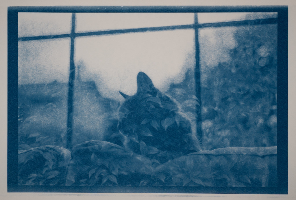

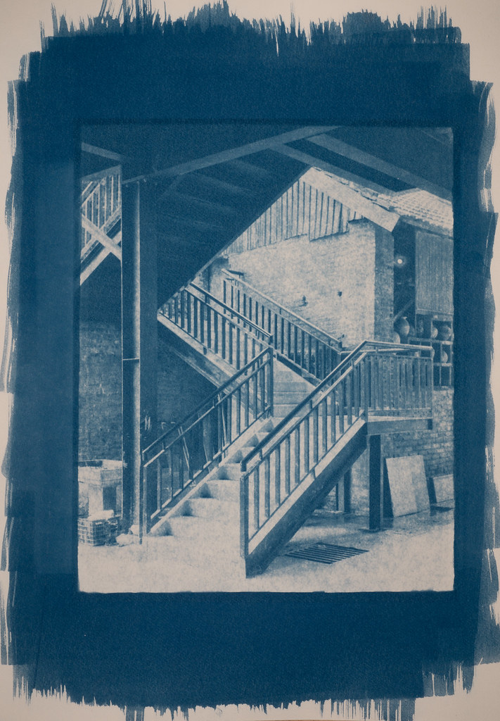

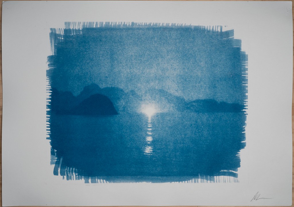

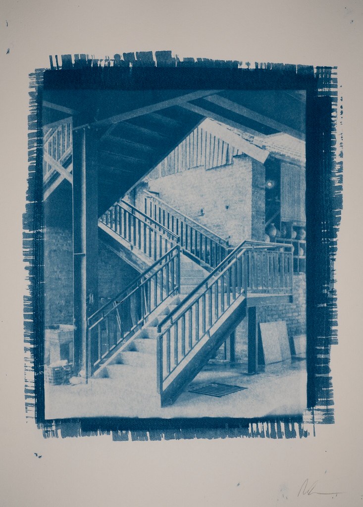

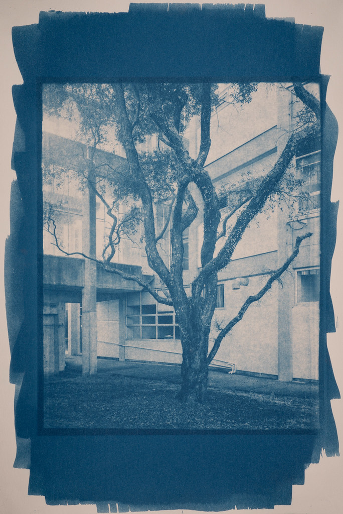

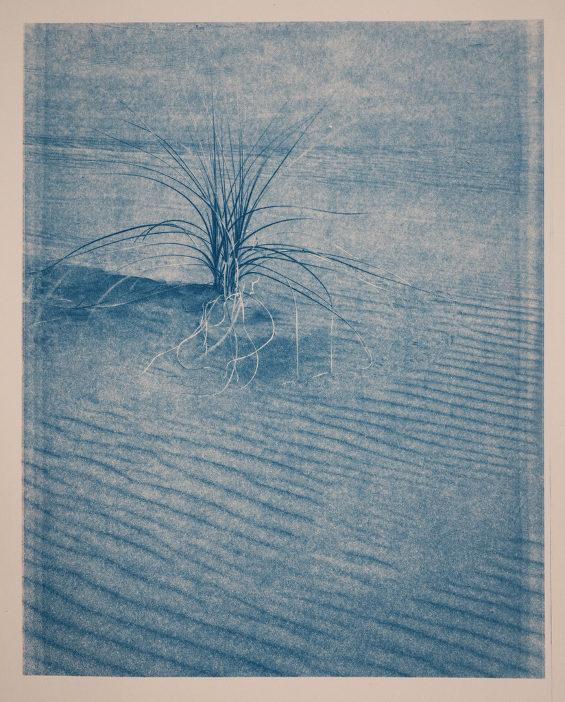

Four original cyanotypes, two on cheap cartridge watercolour paper and two on Magnani Portofino (both hot-pressed).
Nice set Andrew. Are these by any chance made with digital projection - or traditional contact printing?

Salt print on Fabriano Studio HP watercolor paper. Neg is a little hot on the right side from the sun but overall I don't think this one is too bad. Not quite the Dmax of other papers though even with a long exposure.
Great print, love the minimalist composition. Going to try some salt prints. Curious what paper you think has the best DMax...

Thanks all!
They were 'digital contact printing' using an LCD screen instead of a negative, you can see the details in this thread: https://www.photrio.com/forum/threa...egative-in-alt-process-contact-prints.207526/
Patrick,
A very nice print!
Did you pre-treat the paper with acid before salting it? That might help with the Dmax.
I have tried a lot of papers for salt printing (which is my main alt process) with varying results. In the end, I have settled on the papers designed for alt process printing... i.e. HPR and Revere Platinum. These papers just work and thus allow me to concentrate on making art rather than worrying about the details of the process.
In my experience salt printing is one of the pickiest processes with regard to paper, followed closely by platinum/palladium. Thus, I stick with the above mentioned papers for these processes.
Cyanotype, on the other hand, is mush less picky about paper if you 'develop' prints in an initial bath of 10-15% vinegar instead of plain water. Fabriano Studio is one of my 'go to' papers for cyanotype second only to Fabriano Unica.
Lastly, Chris Anderson has done much research on paper for alt processes and reported her results here: https://www.alternativephotography.com/massive-paper-chart/. Just in case you had not seen this.

Thanks Frank.
Yes, I soaked it in a Citric Acid/Salt solution, then coated the silver. I think the Fabriano Studio has too much sizing to make a real deep black, but it makes a decent print. I might be getting too much salt on the paper though. I agree on the Revere Platinum. Best paper I've used so far I think. Not a big sample size though. A lot of papers have been splotchy for me. I am not sold on soaking the paper though. Might go back to brushing on the salt. I am still trying stuff and learning.
I think I have gotten to the point of just acidifying everything for cyanotype in Sulfamic Acid before I coat it. Just works better that way for the most part. Better tonality and faster speed in general but it depends on the paper. I also "develop" in Citric Acid. I really wanted to avoid having to do that, but sometimes you just have to give in and go with the flow.

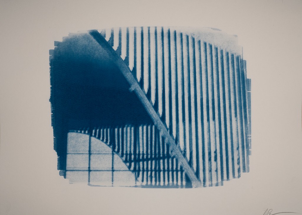

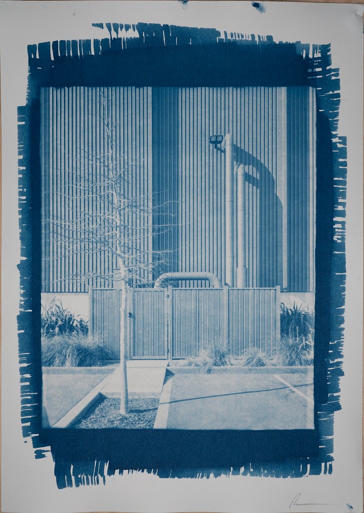

Took some high quality photos of the above prints with a copy stand.
They look great, Andrew.
Contrast is quite high in all of them - do you do any curve correction or is this how it in the originals?
:Niranjan.

Yes I have used a calibration curve on all of them, it's quite an extreme curve too due to the nature of cyanotype. I have generally chosen images with relatively high contrast as I think these look better as cyanotype prints, I feel like the blue tones and relatively low D-max tend to suck a bit of the contrast out of an image.

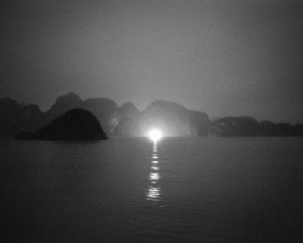

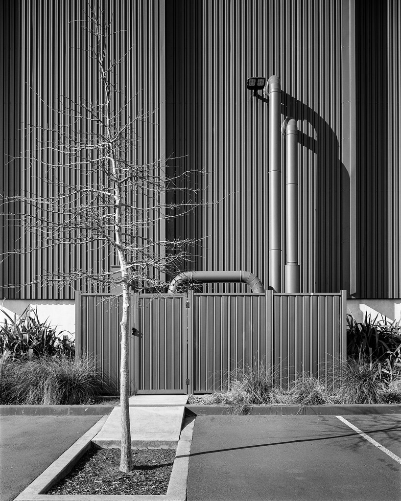

For reference here are the original digital files. (Top two are 4x5, bottom two are 35mm, as you can see from the relative levels of grain).
They look pretty close.
One way to deal with the extreme curve shape is to use 2 curves. I sometimes deliberately use only 75% or so of the first curve and generate a second curve which will turn out to be of much more benign shape. In making the negative, the second curve is placed below the first curve. Rest of the process remains the same.

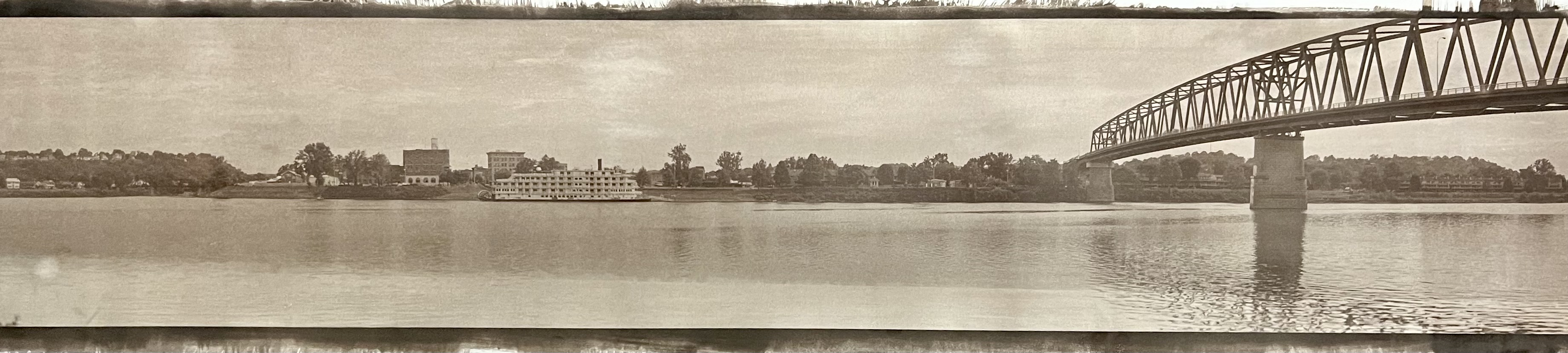

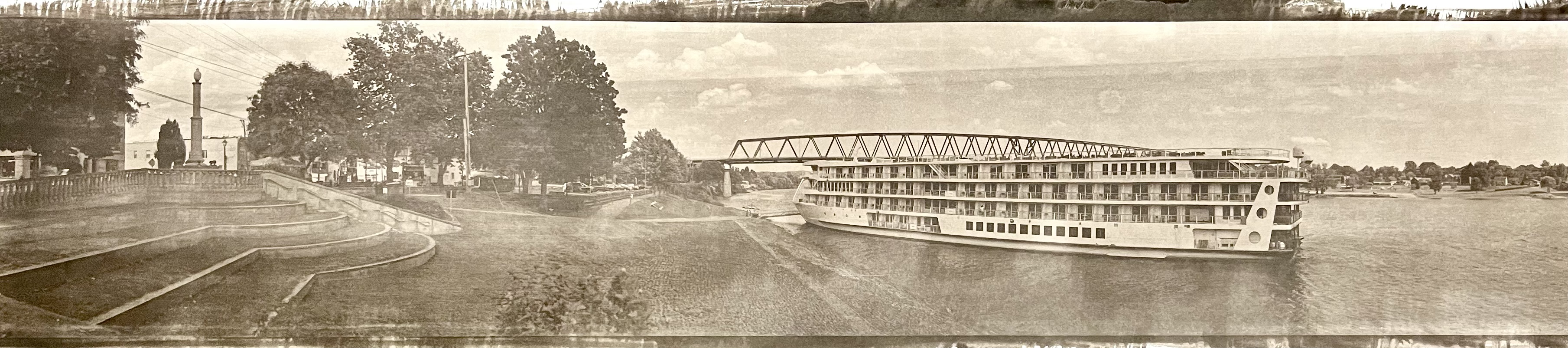

Here are a couple of 10”x50” vandyke prints (toned with dilute KRST) I made with a negative taken with a Cirkut No. 10 panoramic camera. These are on Hahnemuhle Platinum Rag.
This summer American Cruise Lines has been running American Melody and American Heritage up and down the Ohio and Mississippi Rivers. I’m fortunate to be able to capture their stops here in Marietta, Ohio.
I’m still working on consistency in my coating technique at this size and exposing and developing negatives that have a good tonal range. These are only the third and fourth prints I’ve made with negatives from the Cirkut.

Nice!
10x50 inches... yikes!!!! Coating that much area without flaws is certainly going to take some practice.
How are you exposing such long prints?

Thank you! I’m finding I’m having decent luck using a 3” hake to coat. I’m double-coating and loading solution onto a pre-soaked brush from a 1-cup Pyrex bowl rather than pouring and spreading.
For exposure, I’ve built a 20x 84” UV unit using four rows of the Barrina lights. Each row is one 2’ light linked to a 4’ light. The lights are about 5” from the surface of the 12x72” contact frame I built. I’m getting exposure times of around 10 minutes.
