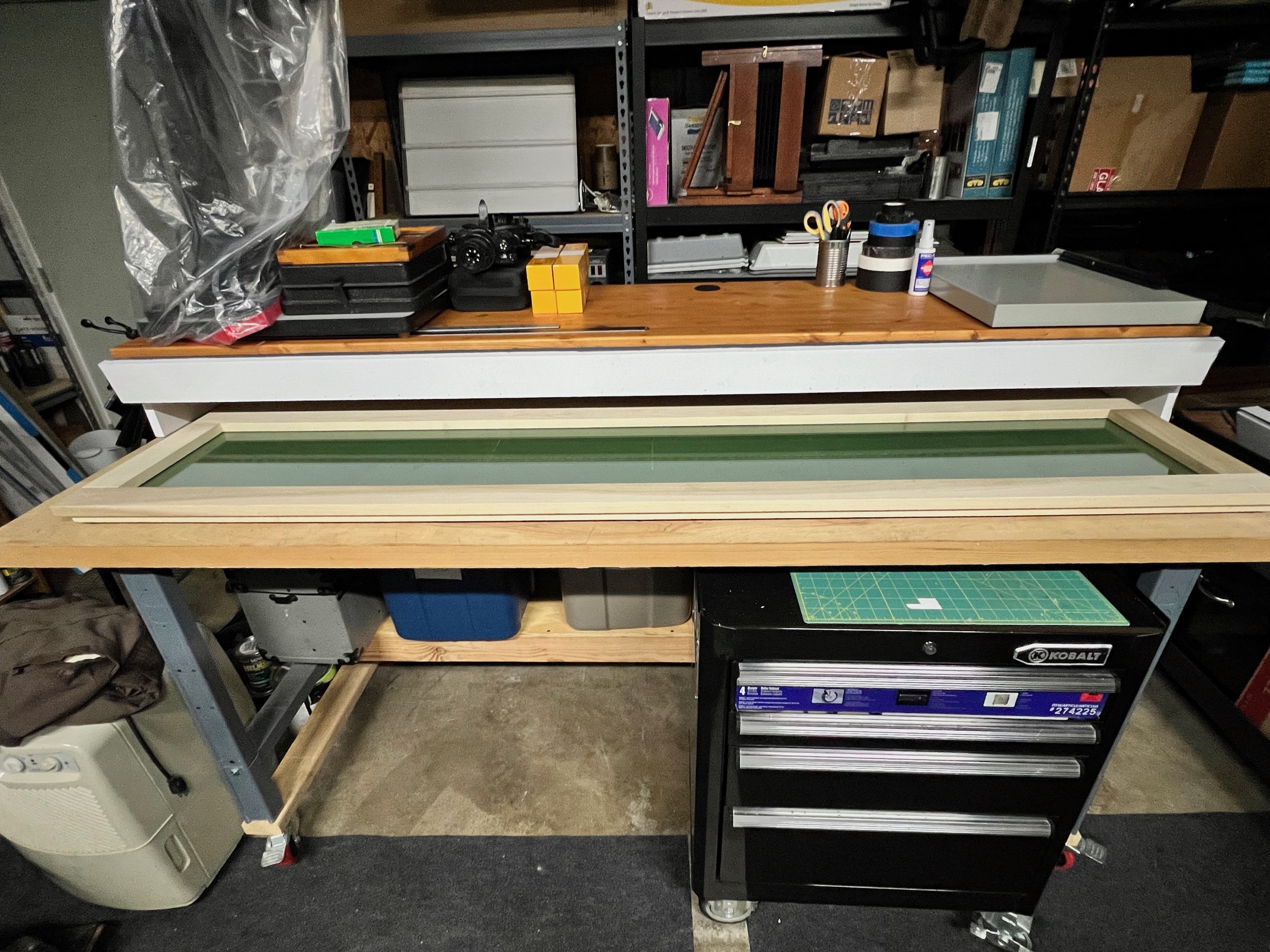

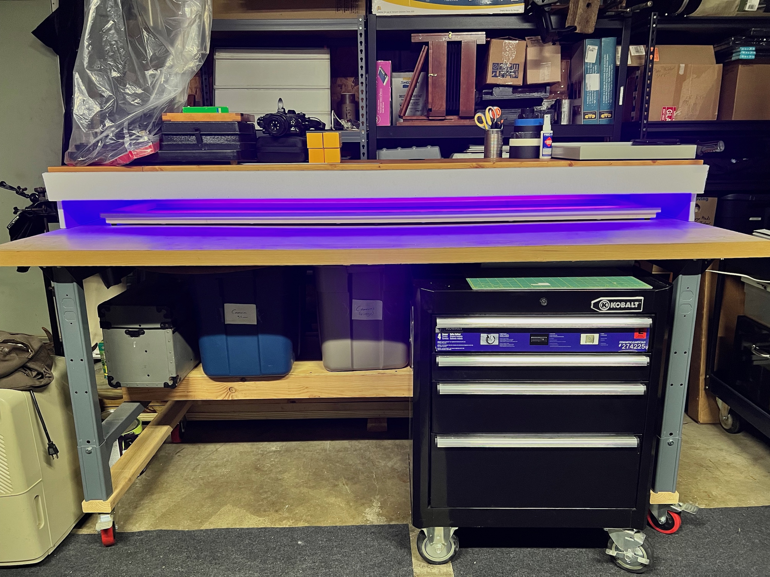

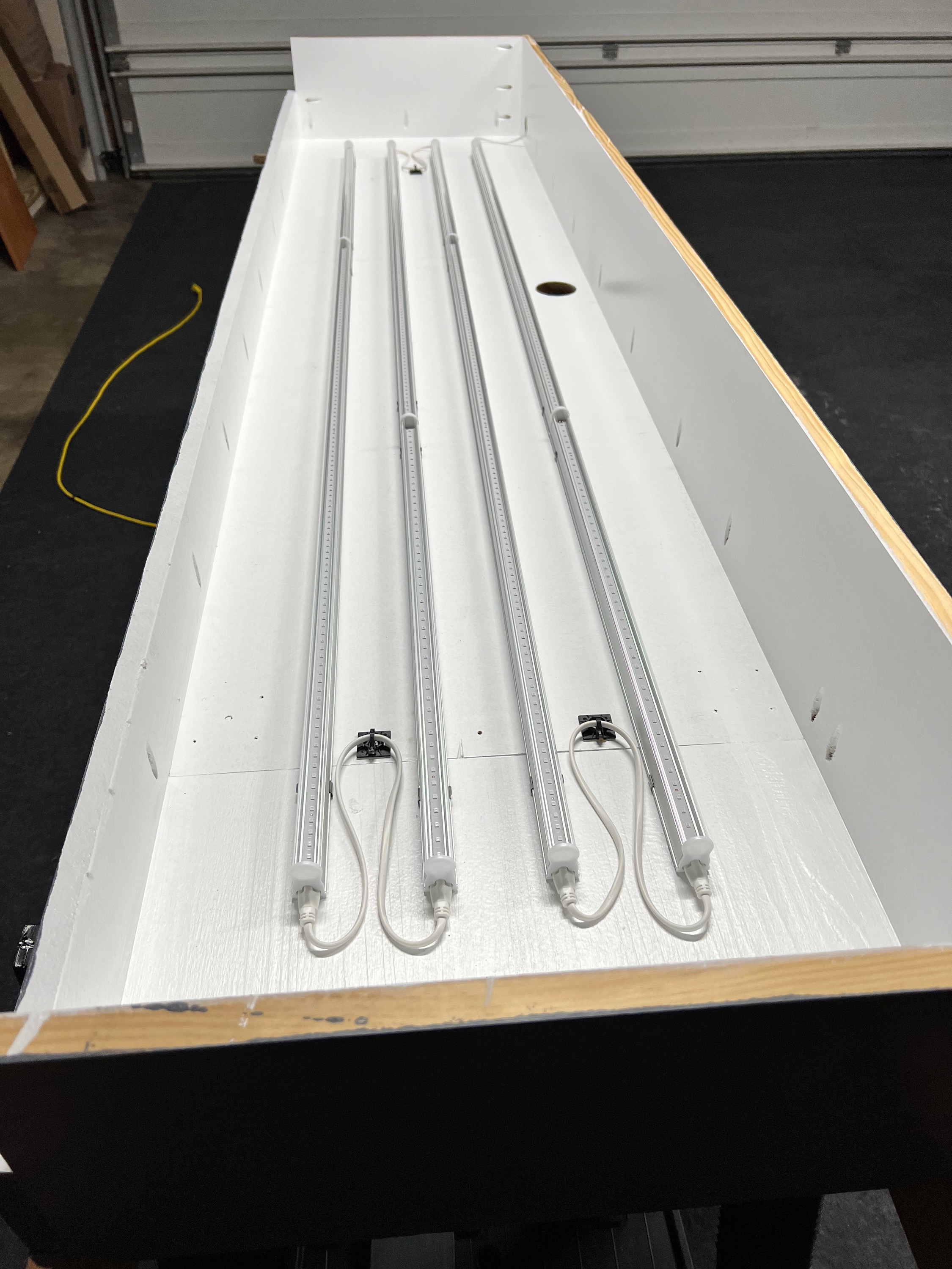

That is really amazing.... I am just blown away by the processing equipment and the camera. Having just built a 20"X 25" UV box I am very impressed with yours. The images are just wonderful as well. I have seen antique large panoramas of large groups ( bands, military, etc) and have always wondered how they were captured, I assume it was camera similar to yours. Just wonderful images - I am downstream in Louisville and occasionally one of these big riverboats docks and I am hard pressed to get a decent shot even with a 12mm lens on an aps-c camera.

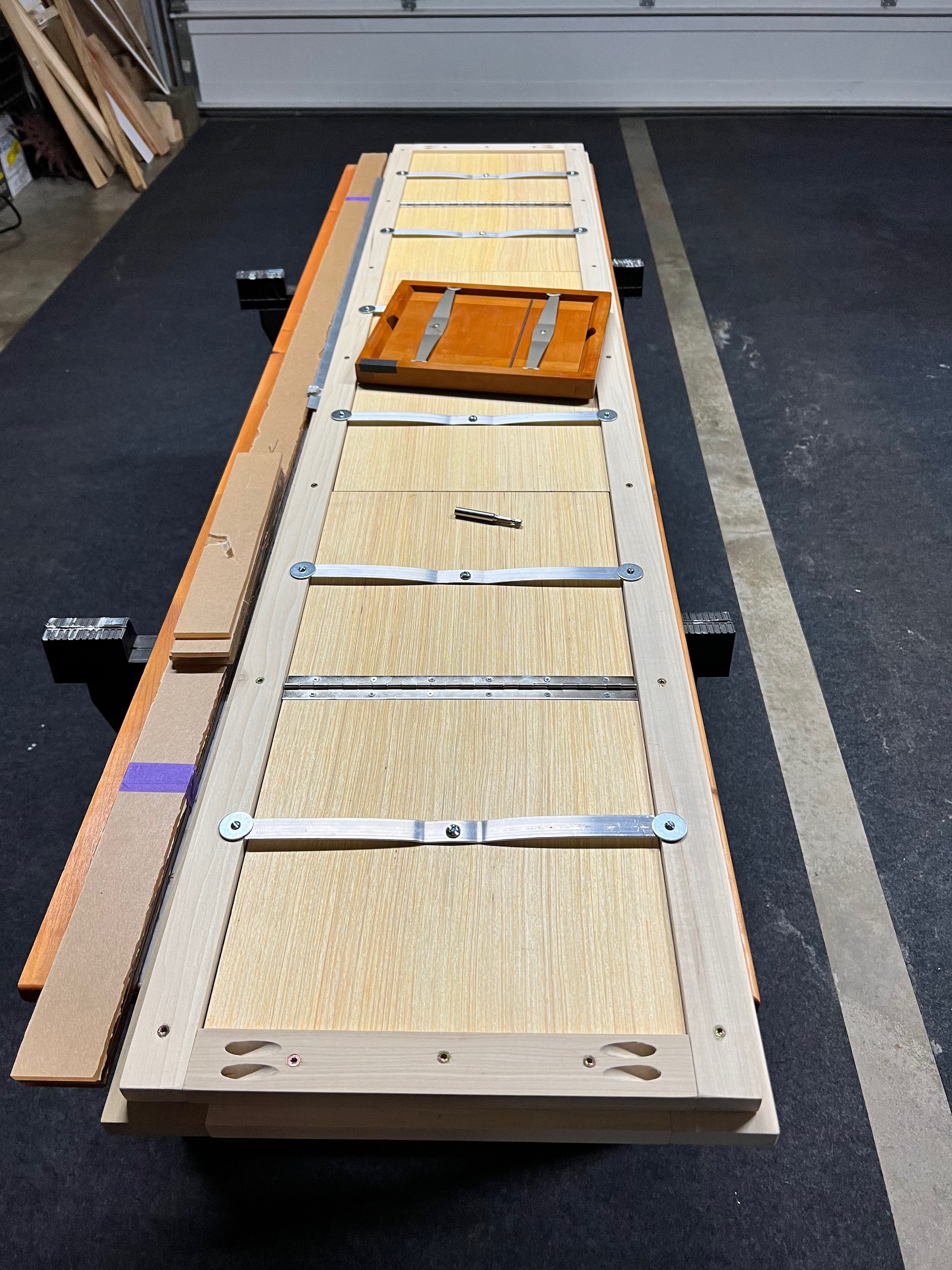

The contact frame is amazing, if I may ask where did you find the spring "fingers" to hold down the segments. I have also built my own contact frame but have struggled with finding a way to fabricate those spring fingers, and use a jerry built "strong back" assembly.

Thank you, Dave. Yes, many, if not most, of the old panoramic photos of school groups, military, bands etc. were taken by Cirkut photographers. Eugene O. Goldbeck is probably the most well-known and prolific of them all.
For the springs on the back of my contact frame, I picked up 1/8”x3/4” aluminum strips from Lowes. I may swap them out for steel if I can find some thin enough, as I worry a little that they aren’t giving me enough pressure for good contact.
Here are a few snapshots of the frame and UV box in my darkgarage. There’s an 8x10 contact printing frame in there for scale. The box has a hinged door. It just happens to be open in these photos.

Drew,
Thanks for the info and the photo's of your set up. I will give that a try - I looked at some of the metal shapes at Home Depot, but was not sure what would work best. I agree that steel may make a better "spring" compared to aluminium, it will depend on the alloy and thickness. I am using a repurposed picture frame that has a groove around the inside, so if I can find the right material it should be straightforward.

Hi, Dave: I am using a similar set-up with grooved frame I bought for less than $10, using 3 of these galvanized strips bent at the center, from The Home Depot:
Seem to work fine.
