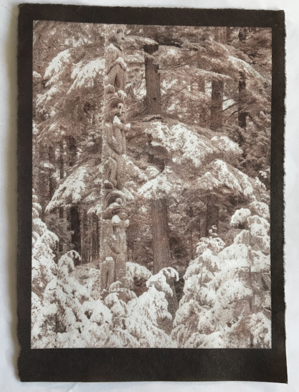

I got it here: https://paintspot.ca/art-supplies/p...arker/mulberry-paper-roll-wenzhou-paper-roll/
In the writeup it says paint doesn't spread or bleed, but sensitizer sure does so I've been tearing it to size and brushing right to the edges. Haven't decided on presentation yet, but leaning towards affixing to heavier European paper.
Beware though...blotches are occurring...you can see it in the discolouration on the bottom Beavers right 'arm'.

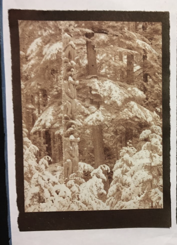

Got a bit impatient yesterday for an argyrotype to dry, so popped it into the oven compartment of our wood stove which was at about 110 degrees F, then forgot about it for 15 minutes resulting in quite the surprise. Had read Ware's account of heating prints for colour change, but wasn't prepared for the apparent increase in mid tone contrast and deeper resonant browns. Happy accidents 👍👍
I sometimes run a clothes iron over salts prints and Van Dykes. The tones shift to neutral and dmax appears to increase. The latter is more of an optical illusion, but hey, if it looks good...

Thanks.
View attachment 381813 View attachment 381814
There is substantial dry-down with Argyrotypes, more so than with Vandyke and salt prints IME. And it can be slow, like a week or more before the orange tones are gone and it reaches an equilibrium. Chances are that your print would get about that density/color/contrast on its own after some time.
But extreme changes in temperature and humidity can probably take it further than under normal conditions. Worst (or best) case I've seen was a framed print that hung next to a wood stove. The repeated heat/drying cycles had made the brown print completely grey/black, and darker than when it was framed.
The paper will also make a difference. I've seen the greatest change in color on papers with heavy gelatin sizing.
It's a nice print by the way. I prefer the baked version. :smile:

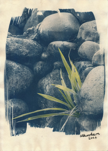

I'm new to the forums, but I've been playing around with cyanotype a bit. This one is unbleached, toned with instant coffee (as it seems to stain the paper less than other toners I've tried.)
Paper is Canson Imagine 200gsm. It can stand the washing ok, but tends to wrinkle if not dried under a weight - I put the prints face down on an old towel, fold it over then put a heavy book on top.
Canson XL watercolour 300gsm that others mention is better, less prone to wrinkling but more expensive.
Scratch marks on image are due to using a piece of recovered glass out of an old refrigerator to weight the negative during exposure.
After drying I hand coloured with Albrecht Durer watercolour pencils, and a wet paintbrush. I like these pencils as they use artist grade pigments and come in a wide range of colours so if you're not experienced in colour mixing with watercolour paints, it's much easier to get desired results with hand colouring.
If you know you're going to be hand colouring, it can help to selectively lighten a little your subject for colouring in Photoshop or your preferred editing software before producing the negative, while leaving the rest of the image as normal, particularly if the part of the image you want to colour is reasonably dark. Watercolour pigments tend to be somewhat transparent, so if the underlying cyanotype is too dark it can be hard to get a good colour result.

That is a very nice print!
A great combination of techniques which you seem to have a good handle on. I agree, water color pencils are a great way to begin hand coloring photos. I find that I have much more control with the pencils than with a brush. (But, I have exactly zero training as a painter!)
I also like using Prismacolor pencils blended with a 1:1 mixture of turpentine and vegetable oil. The Prismacolor pencils are somewhat less transparent than watercolor pencils which is sometimes useful.
If you are interested in toning cyanotypes take a look at Annette Golaz's book (https://www.routledge.com/Cyanotype...ueprints-Naturally/Golaz/p/book/9780367553548). I have been having fun with her technique... examples above in this thread.

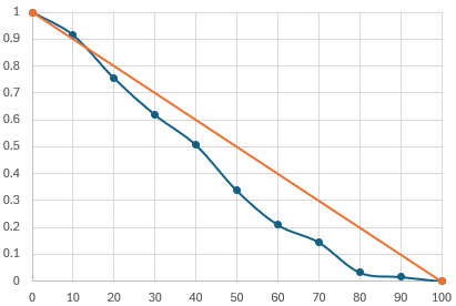

I'd suggest doing some measurements on your patches; this always helps in getting a grip on what's going on. Measurements can be as simple or as fancy as you like. You can take a snap with a digital camera under decent lighting conditions and then do some measurements in Photoshop etc. A scanner will work, too. Or you can go fancy and get yourself a densitometer or even photospectrometer to do patch measurements. For monochrome prints, any of these will give OK results.
I've done a very quick & dirty set of measurements on the 0-10-20-etc. patches of your chart. This is what the curve looks like for the normalized L-values I took from the pic you posted:
Blue line = your patches
Orange line = ideal linear 'curve'
The shadows are on the right side of the plot; highlights left. Dense values towards the bottom, light values towards the top.
As you can see, the curve is overall too dark, and the sag gets worse as you go down into the shadows. By the time you reach 80% density everything starts to compress into an undifferentiated mass of density.
