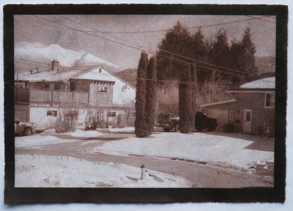

Still farting along Argyrotype Road.
Getting closer on threshold high values, but the Kozo I'm using isn't able to resolve the subtlest of details. Pretty much a 'straight print' in that there was only a light burn on the distant mountain and light dodge on the dark trees when making the negative. Photo taken through our front room window.
White vinyl siding to left of roof vent is supposed to be a pure white paper base as reference point for snow to key off of.
Any Kozo recommendations out there? (I'm using a 30 gsm machine made 100% mulberry bark Kozo-ish Wenzhou Chinese paper originally purchased for polymer photogravures, so unsuited for this process...but it's cheap to learn on).
Photo looks crunchier (grain-wise) here than in real life...

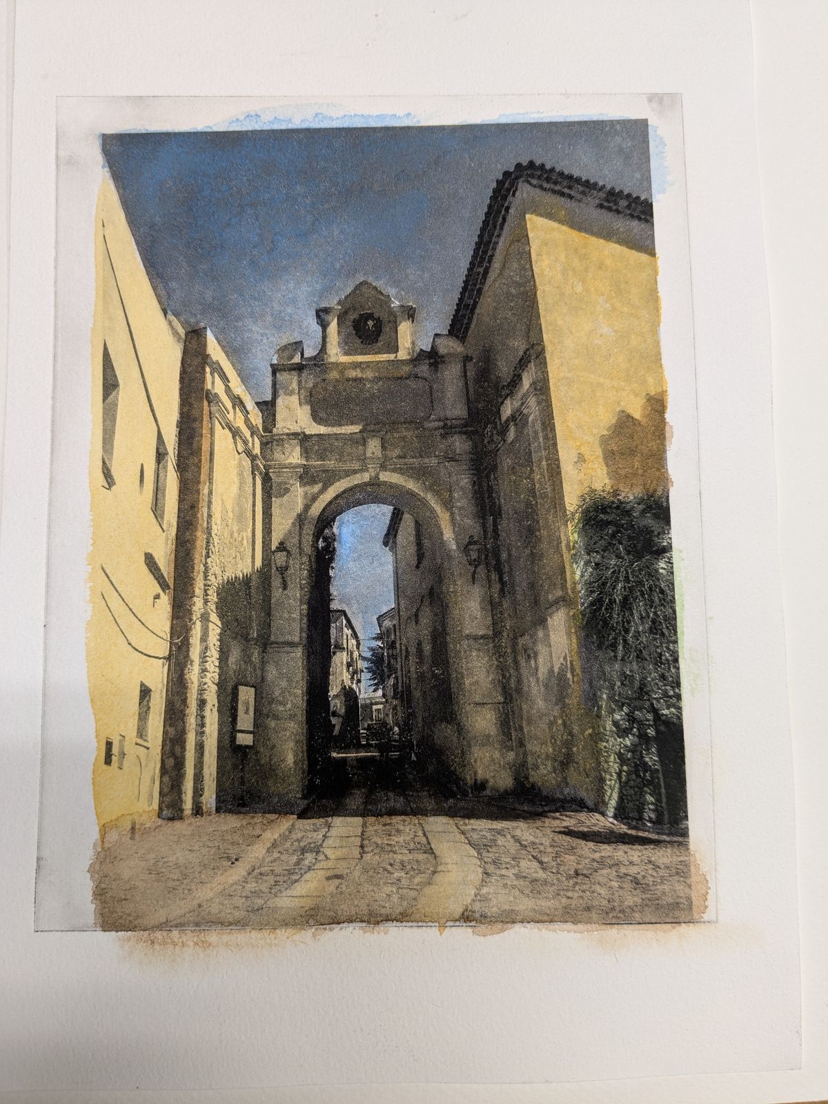

not sure if this belongs here - I have been doing some photogravure intaglio prints from my digital images. Using the direct to plate process with a fairy linear curve in QTR. Printed on hahnemuhle durer copperplate with black ink.... was messing around with doing some gum layers over the intaglio prints. Was using some prints that were not "perfect" but had some small flaws/uneven inking etc. Decided rather than using gum layers I would to try just hand paint in some watercolor over the print. Now I have absolutely NO skill in watercolor or painting, but decided to give it a try - I was surprised how it came out - not perfect but not too bad either. Wondering if others have gone down this path - sort of like old silver gelatin B&W prints that were hand colored.......
City Gate in Gerace, Italy - Calabria
Very nice!!!
Like you, I have no real skill in painting. However, I have experimented with hand coloring inkjet prints (see: https://porfolio.gorga.org/hand-colored-pigment-prints). I have not tried using an alt process print as the base; something to add to my 'to do' list.

KYsailor, hope you’re managing the snow! I was wondering if you have your etching press sorted…I keep circling back to the idea of making oil transfer prints, though sneaking a big Conrad into the house might upset our domestic harmony.
Ahh, we survived the snow/freezing rain. I lived for 20 years in Saratoga county in NYS - so I have seen a lot of snow experience ( and still have a snow blower). Regarding the etching press, I belong to a print studio with several presses - it saves my domestic harmony - off to the studio today! Besides I have met some extremely talented people at the studio and it is enjoyable to interact with them. I am not familiar with the oil transfer process - however it sounds interesting.
I looked at your gallery and I really enjoyed the hand colored prints - I should try that as well. as I mentioned I am "experimenting" with doing tri color gum over some of my photogravure prints. The gum over prints will have better alignment due the semi accurate registration of the digital negs on the print, but will lack the sort of dreamy watercolor look. On the subject of using alt photo as a base, I took Diana Bloomfield's gum workshop last fall, and she is an advocate of starting with a cyanotype base layer base layer ( as the cyan layer) and building up from there. I know Bill Schwab also has some videos of doing gum over cyanotype.... lot of interesting options

Andy O’Neil has a number of YT videos where he’s doing “gum over” cyanotypes as well—they exhibit an interesting split tone effect. Otherwise, I think you have right idea on getting in with a studio group—
I’ve shied away from photogravure and carbon transfer just because of their big footprint. One more question, though: how are you mounting/presenting your images? Is it possible to dry mount a photogravure print?

Due to the cost of the plates I generally make plates that are approx 8X10 and sometimes cut them in half. The watercolor image was a half plate. After I dry them, I press them ( between two pieces of thick MDF with a couple of kettlebells on top) and they come out nicely flattened. I do not have a dry mount press. I usually mat them with linen hinges and put them in a frame.
The intaglio printing paper is interesting, it is dampened to print and the paper is "soft" to allow it to deform into the depressions in the plate to absorb the ink. It feels much different than the water color paper I use for other alt processes. I would think it could be dry mounted. If you use traditional oil based ink I have read that it actually takes a couple of weeks to fully dry. I would wait until then to dry mount them.
