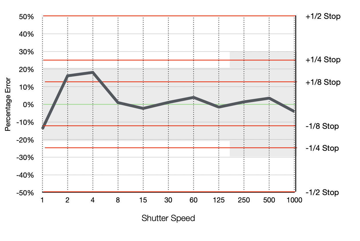

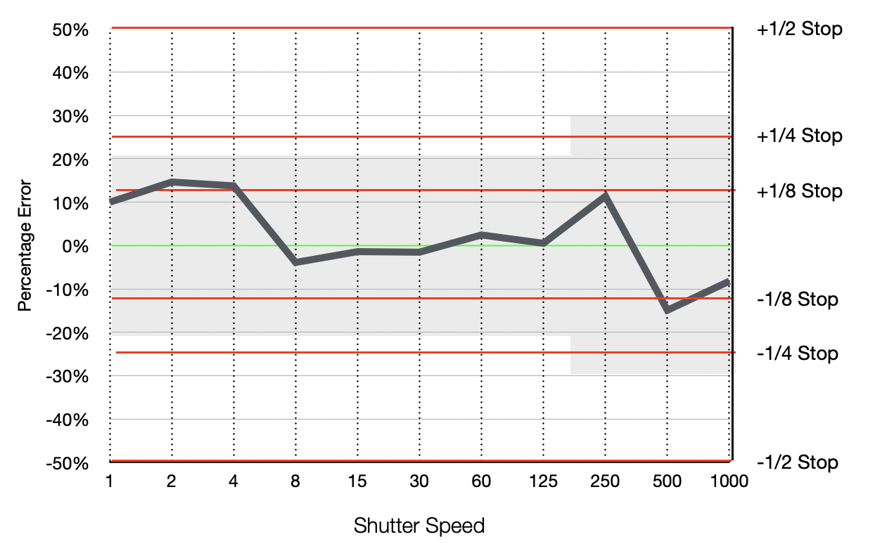

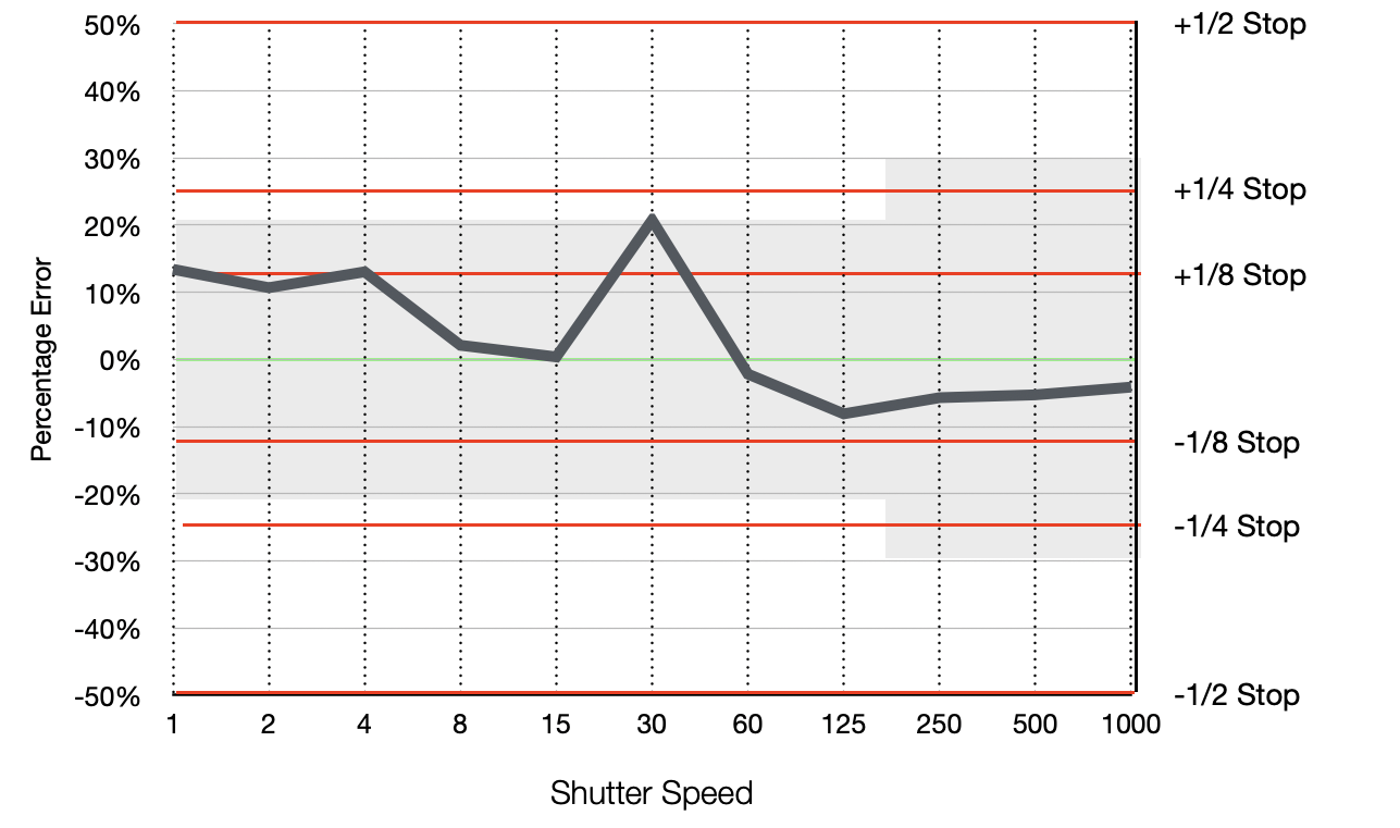

The 4 cameras all cleaned up nice on the outside, but it took a while to get them all working on the inside. The following graphs show the shutter speeds I was able to obtain.

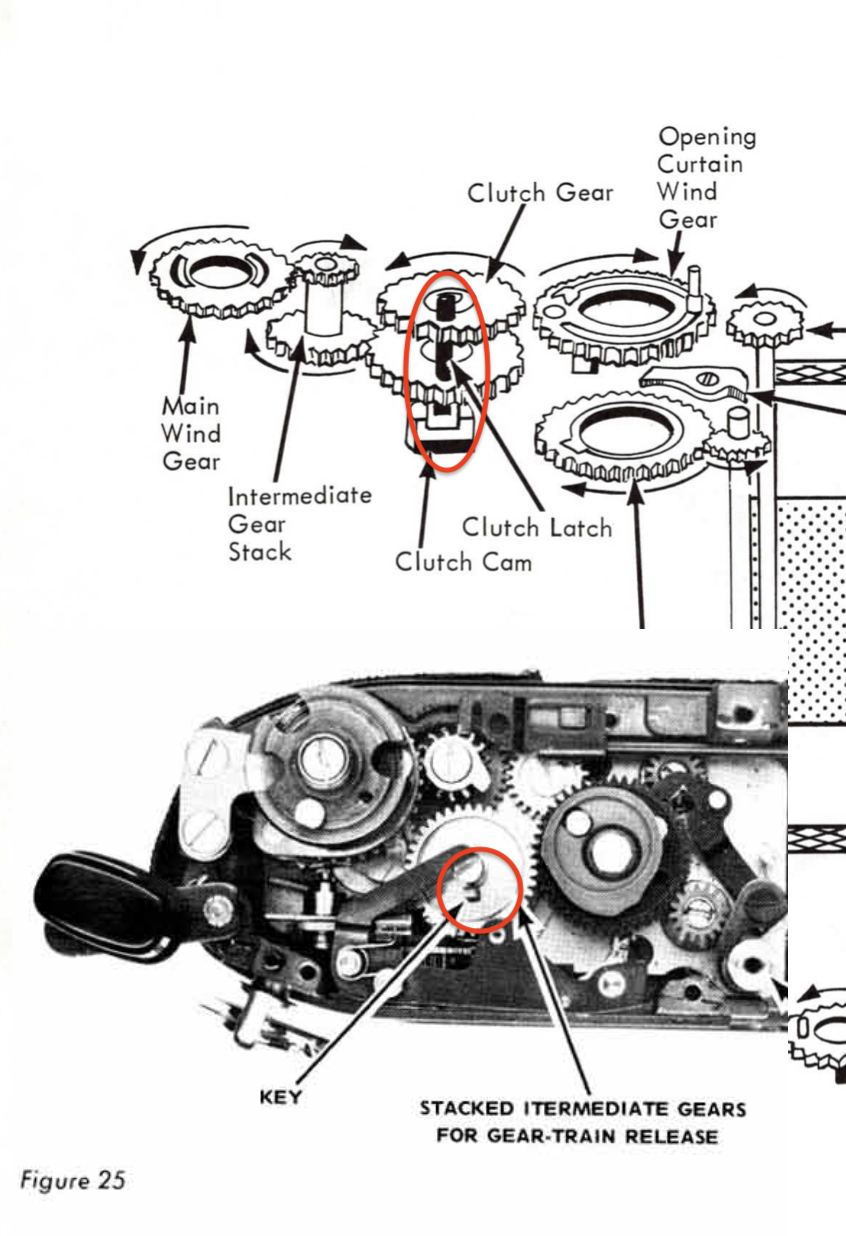

Partly inspired by this thread, I just purchased a black SL35 "Made in Germany" version that is jammed. The film advance lever is stuck and the shutter button is easily able to be pressed down, but doesn't fire the shutter. Taking off the bottom plate revealed that the shutter and mirror are cocked based on what I've seen in a few photos online, so it appears I'll need to dig deeper in to see if I can determine what the problem is.
Any guesses on what may be the issue?
Check this:

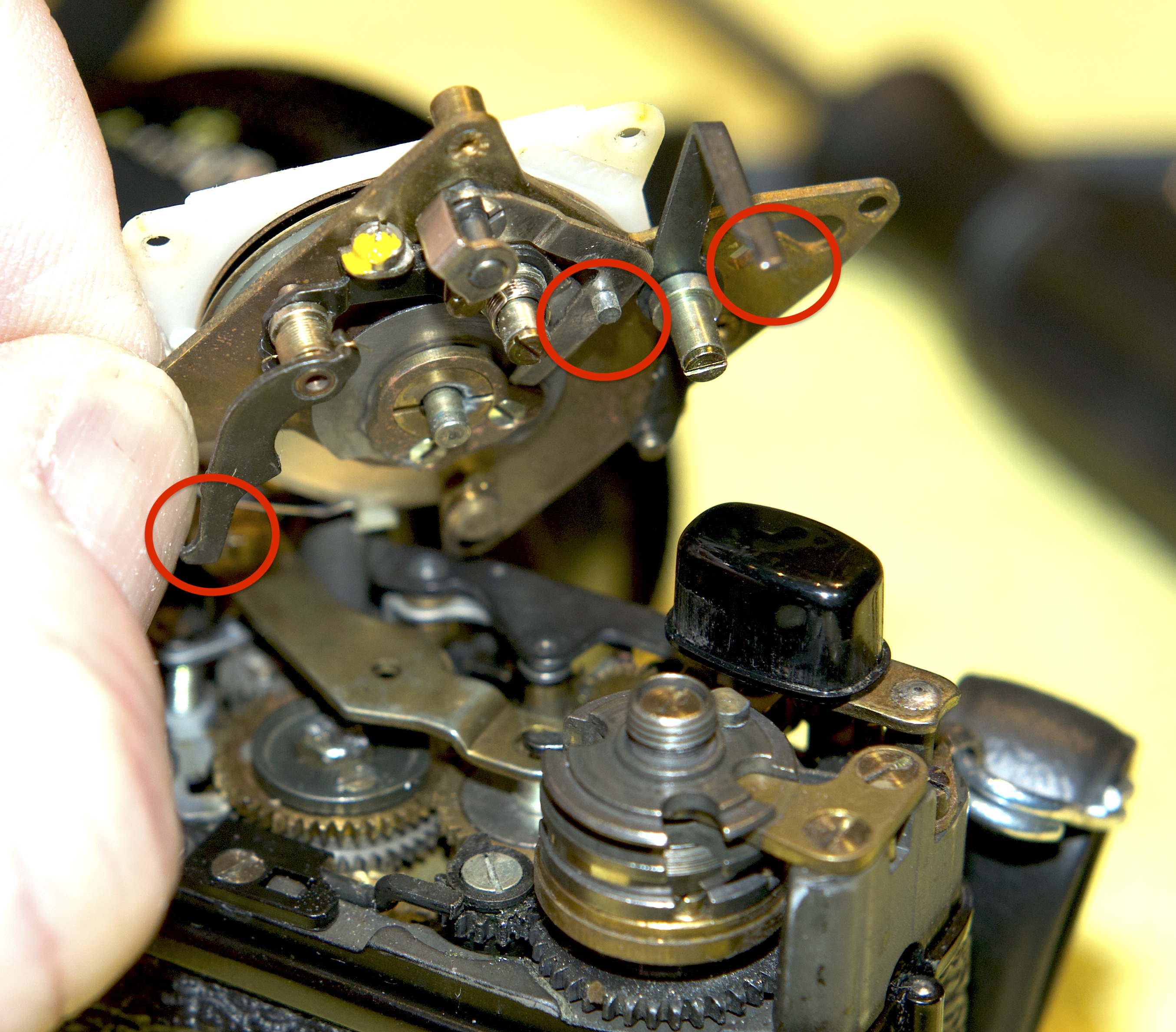

Underside of the speed setting cams showing the three levers that need to be in position when re-attaching the assembly.
This needs to be removed to get to the eccentric screw on the first-curtain cam which sets the slit width for shutter speeds 1/125 to 1/1000.

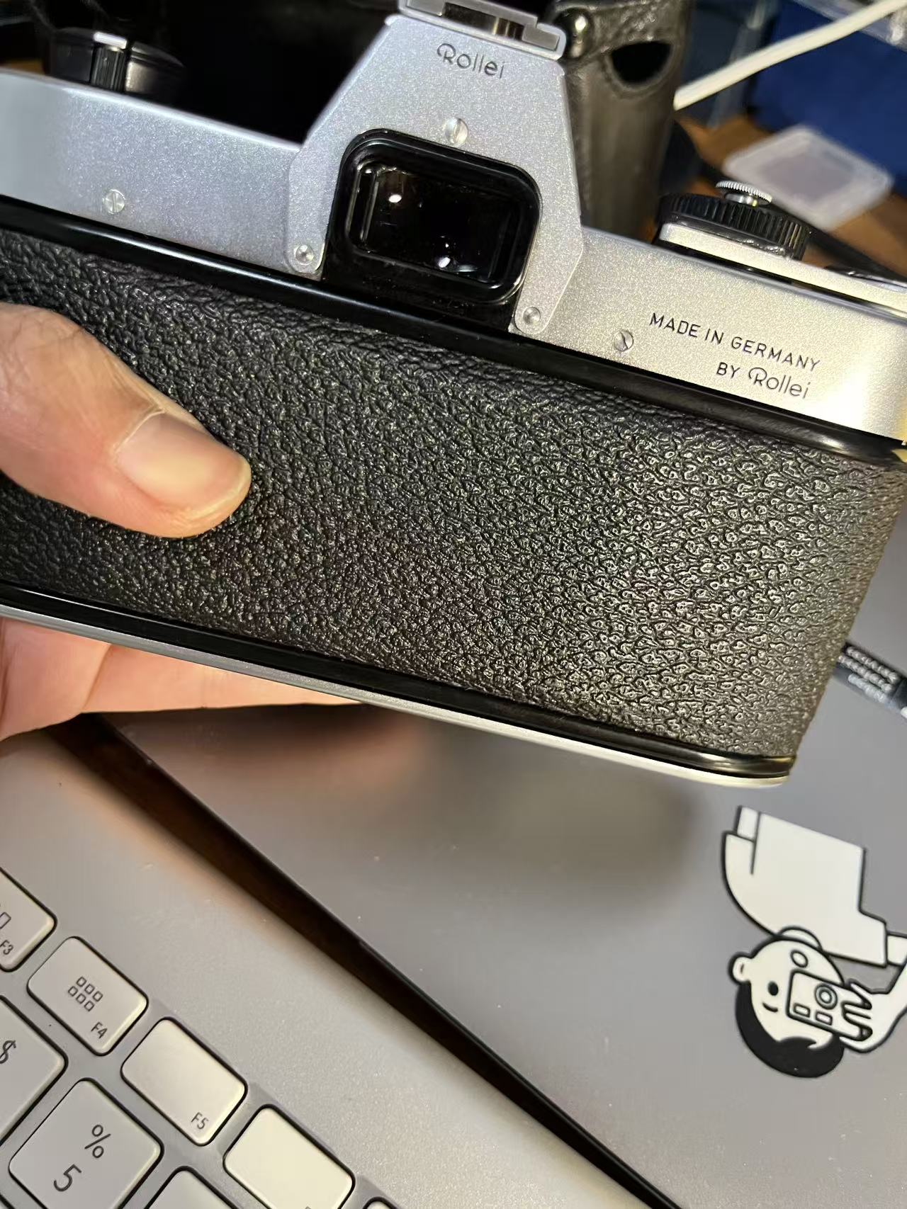

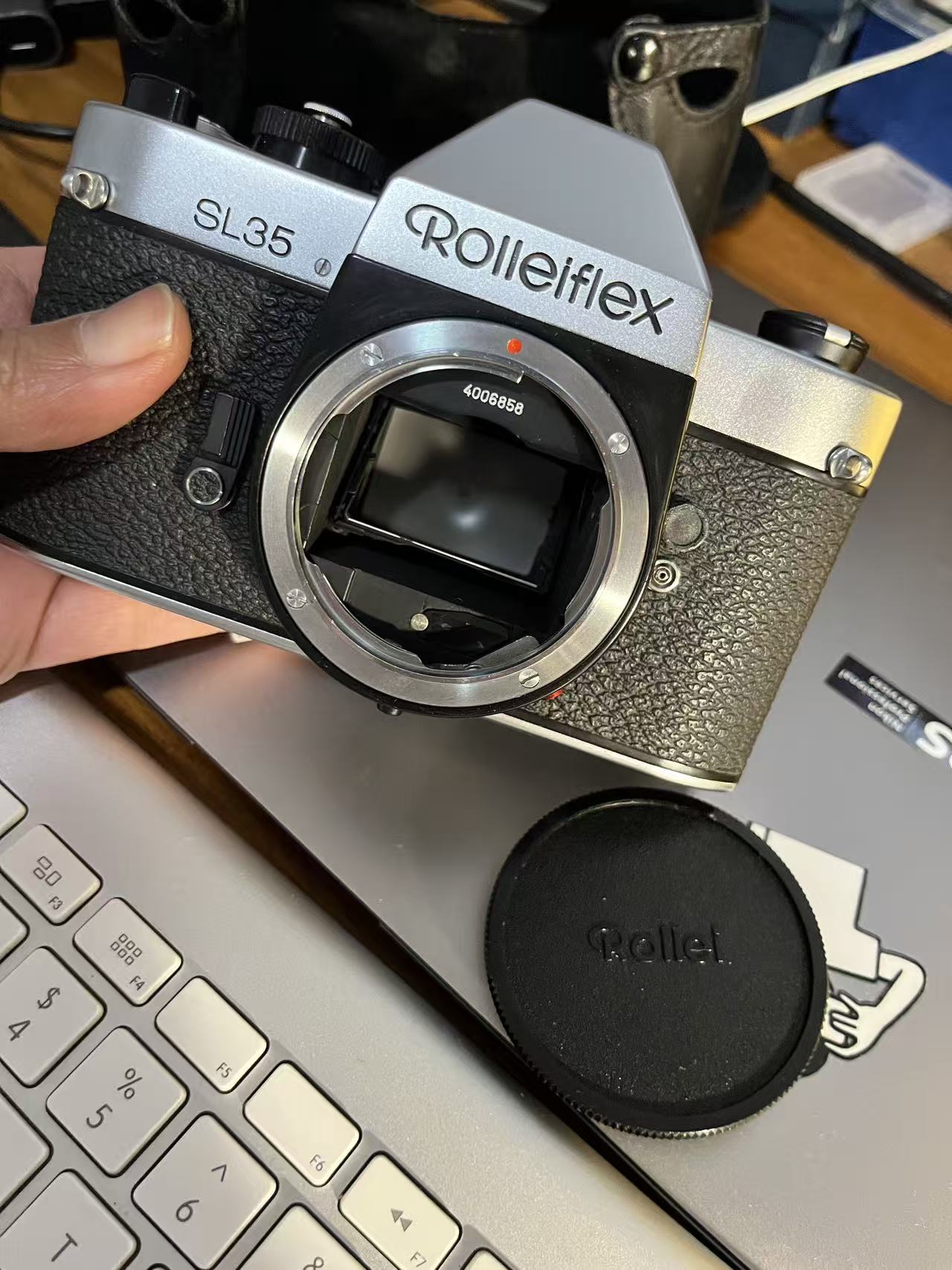

Your post about the Rolleiflex SL35 system has been extremely helpful to me. I really appreciate your effort and knowledge. Below are some of my experiences and a few questions.
In recent years, I have been trying to collect German-made Rollei SL35 and SL350 bodies. I am fortunate to own both now, but unfortunately they are both chrome finish, not black paint versions. Also, the frame counter on my SL350 (with working meter) no longer advances — I paid 130 EUR for it, so that was a bit disappointing.
1. Production origin & identification​
From the information I found, only about 25,000 early SL35 units were made in Germany. The serial number on the mount should be ≤4025000, and the early German-made version has only one front screw, which is slotted screw.
If possible, may I suggest checking your SL35 bodies to see whether there are any exceptions? For collectors who are obsessed with German-made Rollei cameras, the true origin matters a lot. I hope this information is useful to you and other collectors.
2. Build-quality difference between German and Singapore production​
Some users mentioned obvious differences in feel and mechanical quality between the German and Singapore SL35 bodies. I haven’t used a Singapore version myself, but I am very impressed by the build quality of my German SL35 — in my opinion, it may even rival Leica bodies of the same era.
Since you own several versions, I would love to hear your personal impression regarding the difference in feel and craftsmanship.
