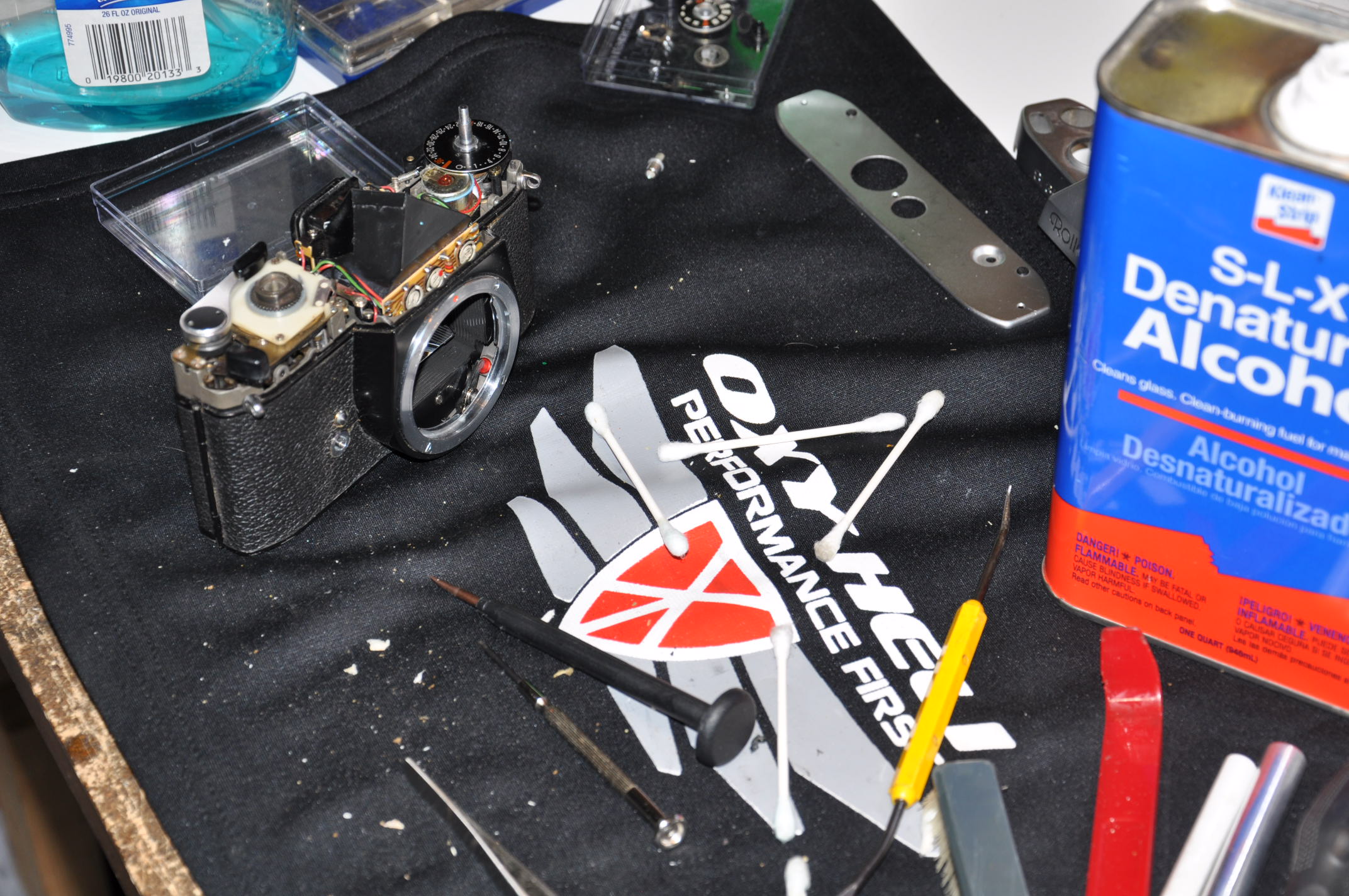

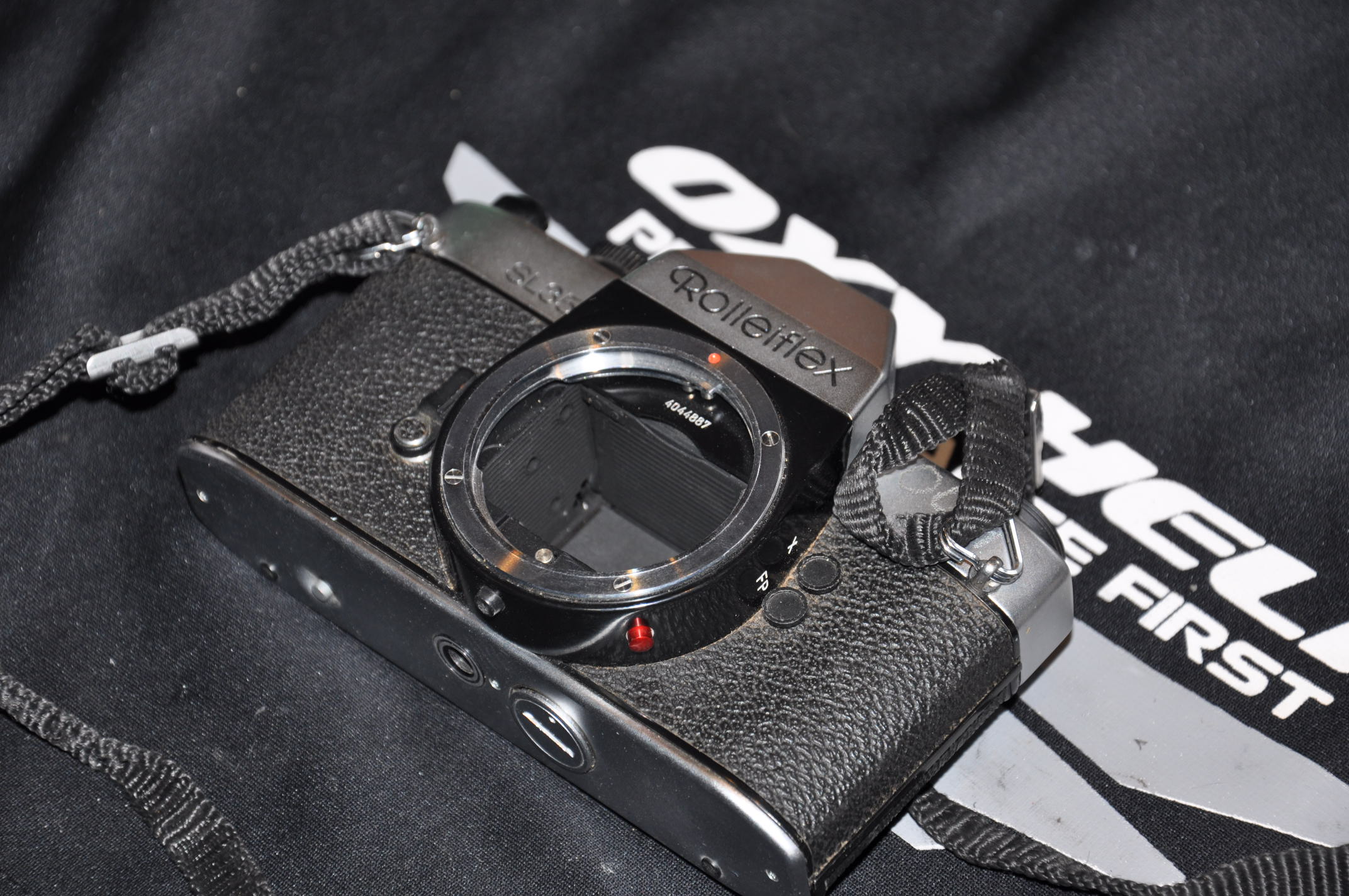

Camera #3 arrived today. Again, this one is also made in Germany, but comes with the mirror stuck in the up position:

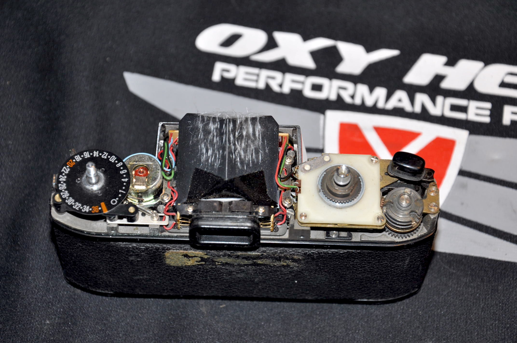

The mirror release lever is visible from the bottom, so it did not take long to release the mirror. However, the shutter is still cocked and won't release.

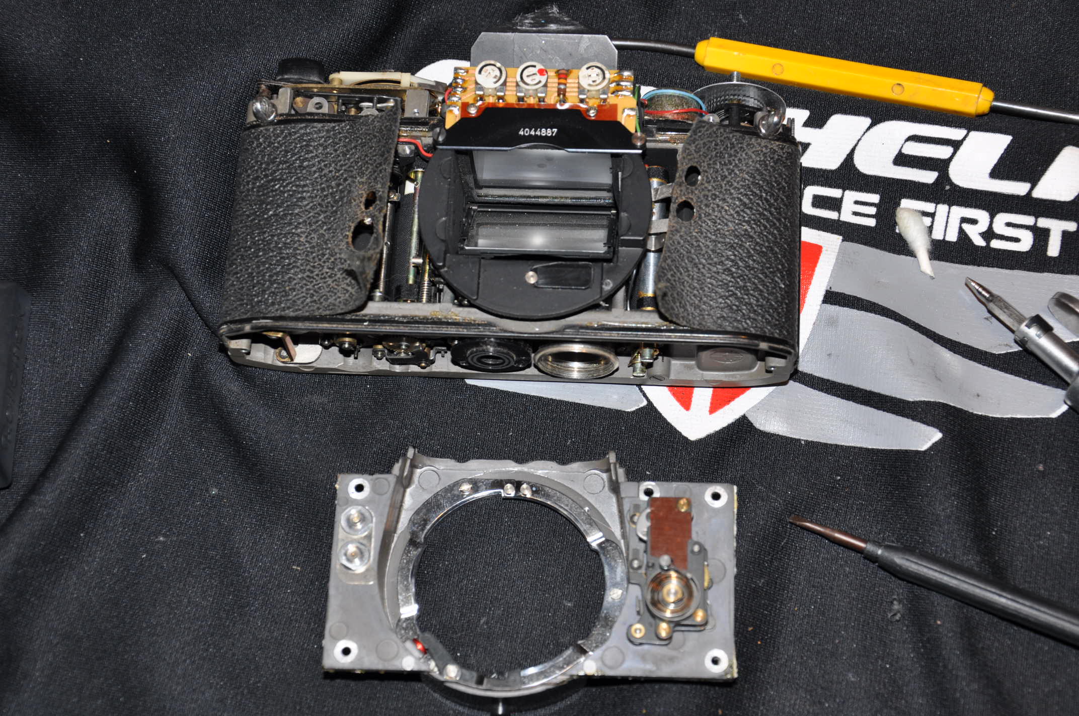

The first curtain release is under the front cover, so that has to come off too.
The mirror is down, but I need to remove the front covering to take the front plate off.
The self timer button unscrews.
Five screws hold the front on and two screws of same size hold the self timer mechanism. Those screws can stay in place.
The way it works is pressing the shutter release releases the cocked mirror to go up. When the mirror reaches the top, a lever releases the first curtain latch (down at the bottom of the opening shown here).
To get the shutter to fire I released the latch.
What happened is the first curtain fired but the second curtain went very slowly across and did not have enough tension to release the mirror back down.
Turns out someone had taken almost all the tension out of the second curtain. I cranked tension back into the curtain (counter clockwise with the tensioners) knowing later I'll fine tune it with a shutter tester.

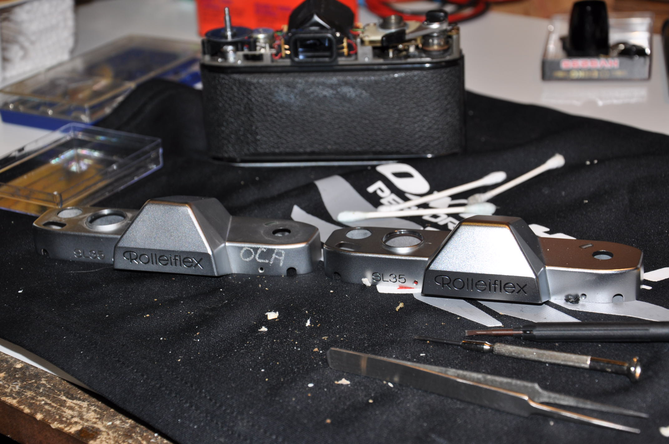

For re-assembly I have a new top to replace the engraved top.

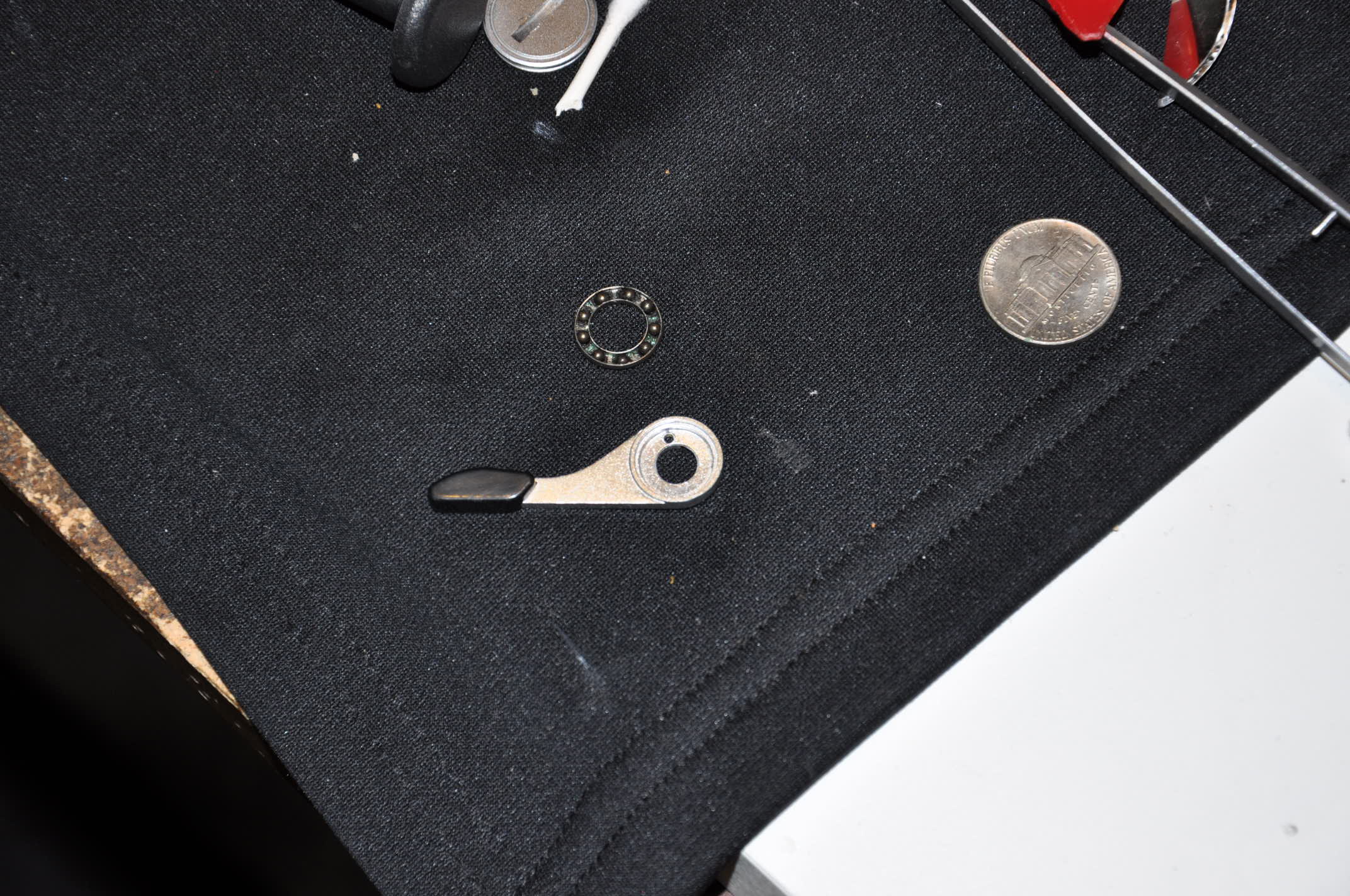

The ball bearing in the cocking lever was long gone, but I got a new one from an old thrust bearing I had laying around.

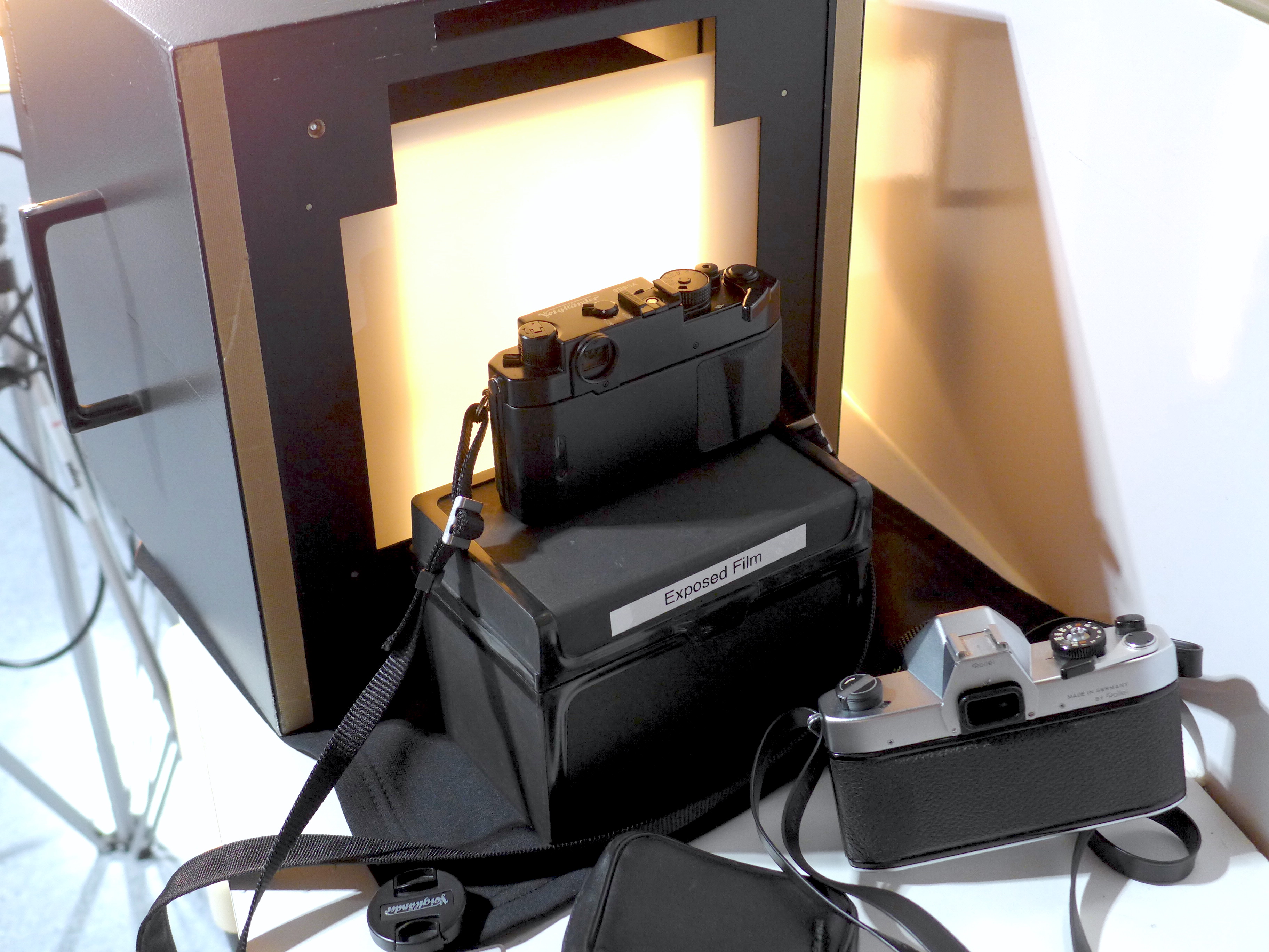

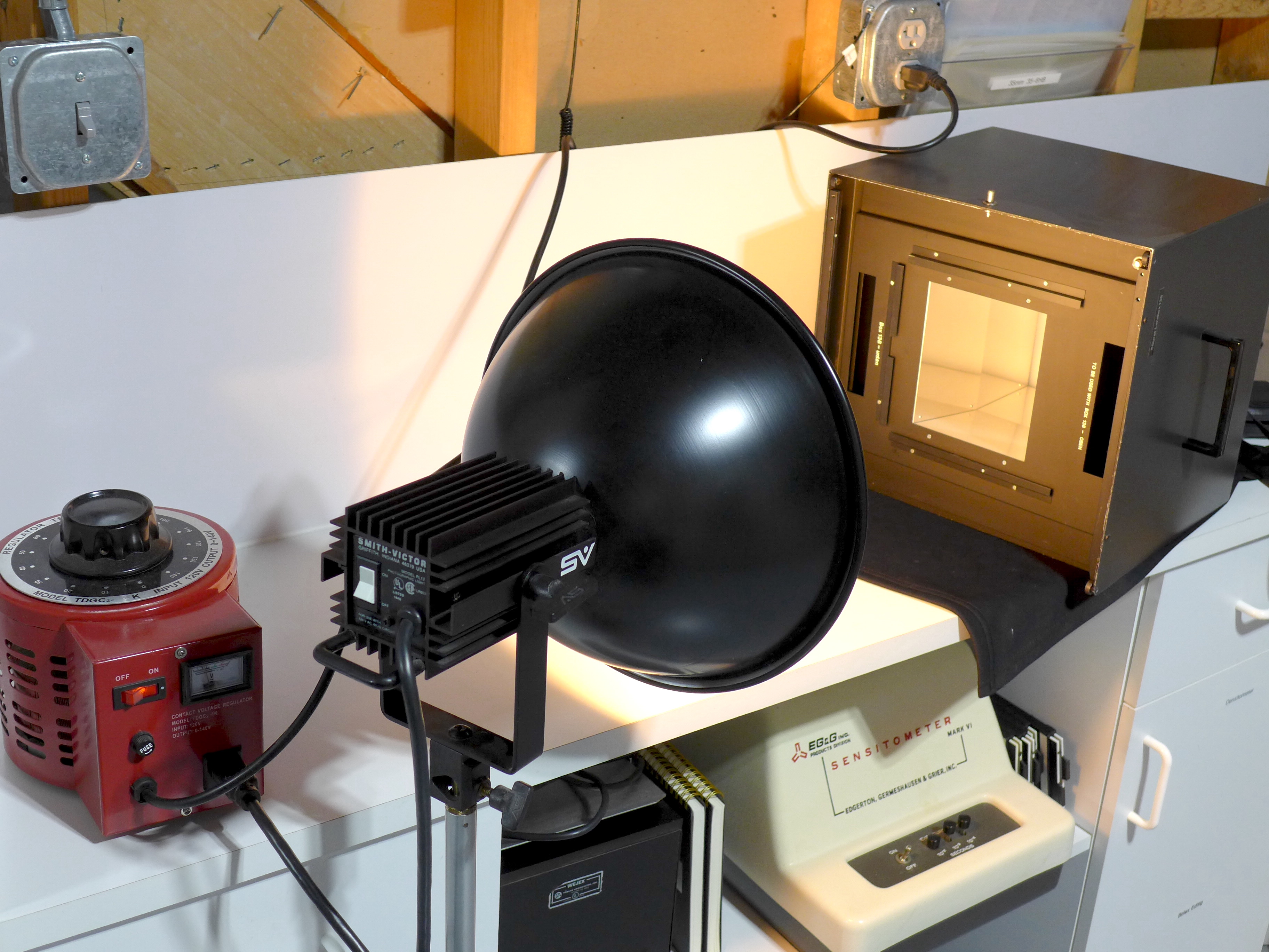

Since both a shutter tester and meter tester need a uniform illumination source, I'm planning on using a spare enlarger diffusion box as the light source for both tests.
No plans to make anything permanent. This will all be setup from existing items I have around the shop.
Light source is a halogen utility lamp connected to a Variac. I already have photodiodes and various passive components to connect this to an existing A/D converter hooked to the computer on my workbench. Power for the shutter tester will be a DC bench type variable power supply.

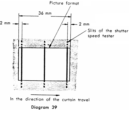

First thing to test is the shutter speed where the first curtain directly triggers the second curtain. Usually the X-synch speed. In this case 1/60.
Now, there are two different millisecond times for this speed that are very close to each other. One is the actual exposure time of 1/60th which equals 0.0166 sec.
The other parameter is the speed of the curtains across the frame. They don't actually specify the speed, just the time to cross the film frame.
For the Rollei it is about 0.012 sec. This measurement requires two photosensors. This is slightly shorter than 1/60th because, most shutter testers don't measure right to the edge of the 36mm frame, so the travel time is shorter. Also, there is a slight delay while the first curtain unlatches the second curtain, this adds to the time of the overall exposure, making it slightly longer than the travel time measured with the two sensors.
For now I'm just going to use a single sensor. So I'll infer the shutter travel time is close enough if the exposure time is 1/60 (0.0166 sec).
We don't know the exact travel time of the shutter, but any change in the first curtain speed will show up when the sensor is placed right where the first curtain opens.
Same with the second curtain. Don't know the exact travel time across, but any change in second curtain speed will alter the readings when the sensor is placed right on the other side of the frame where the second curtain closes.
So, measuring the time at each side of the frame opening can tell if both curtains are the same speed, without knowing either's exact speed.

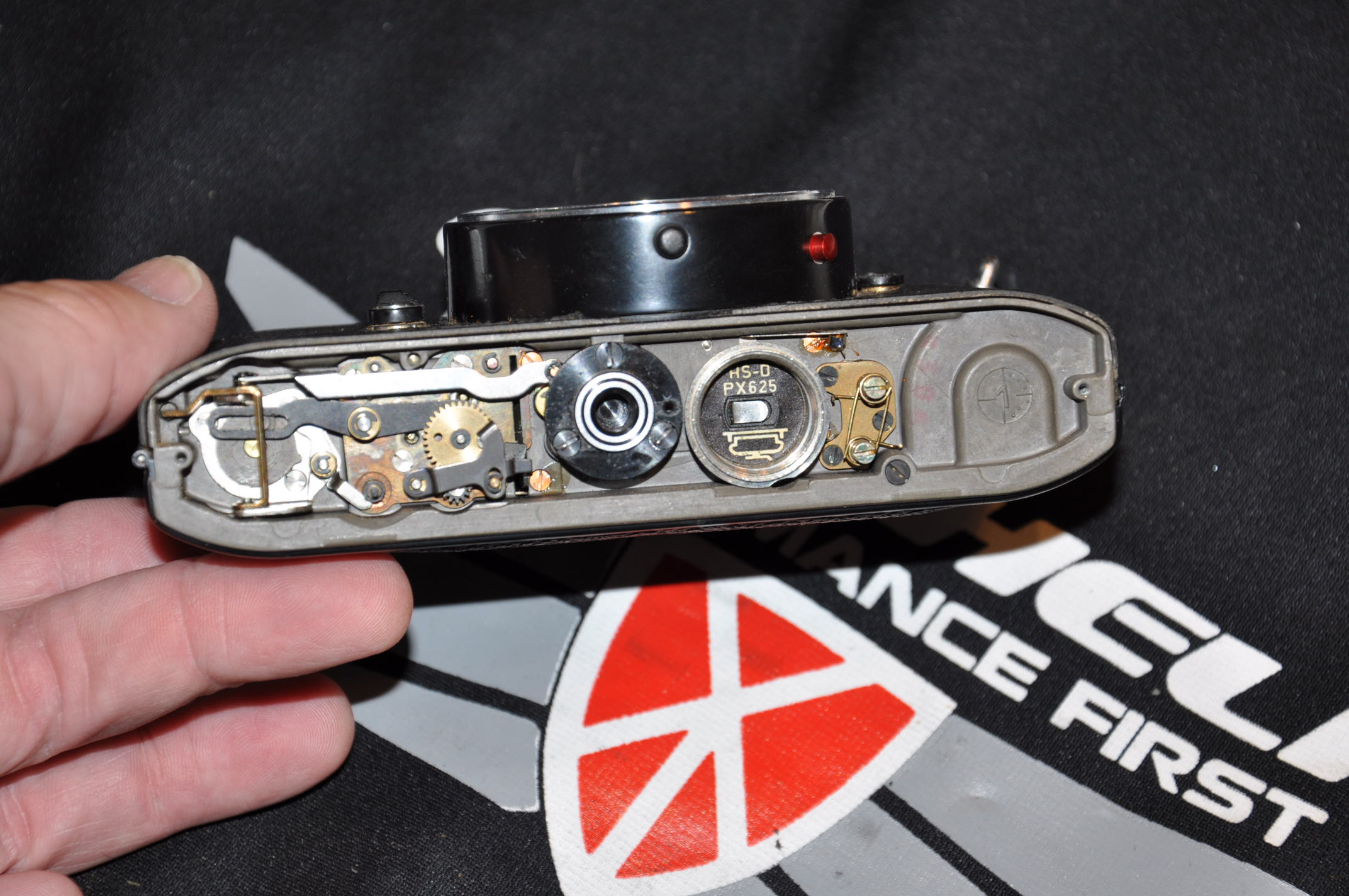

The 1/60 speed was set by roller tension in all 3 cameras. Interesting that the rollers were too tight in two of the cameras. Probably from people fiddling with them.
The rollers were set by removing the base plate on all 3 cameras.

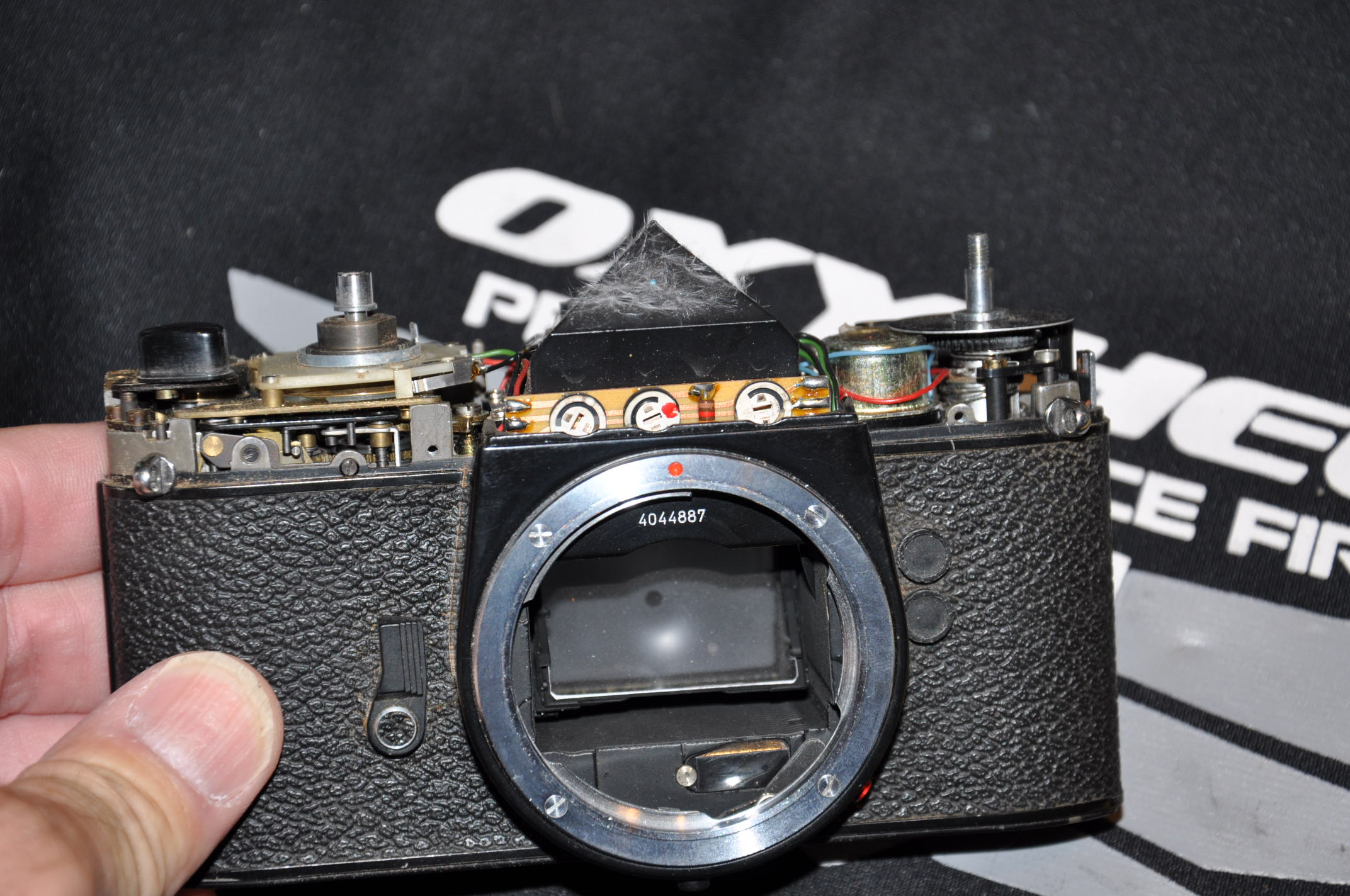

Next, to set the fast speeds, the top has to come off again on all 3. That will also expose the trimmers for the meter, so, I'll put together the makeshift meter calibration setup at that time.
Going reverse order with camera #3 first.
The tiny screw to adjust the shutter gap had been damaged, the slot for the screwdriver had been opened up by someone that did not loosen the lacquer on the screw. I was able to get it out and clean up the threads.
The adjustment is very sensitive. Only a few degrees of turn makes a big difference. Wound up with 1000 = 1/900th of a second. It was giving 1/300 when I first tested it.
All the other speeds fell in line.
The slow speeds were good enough. The meter was checked and no adjustments needed.

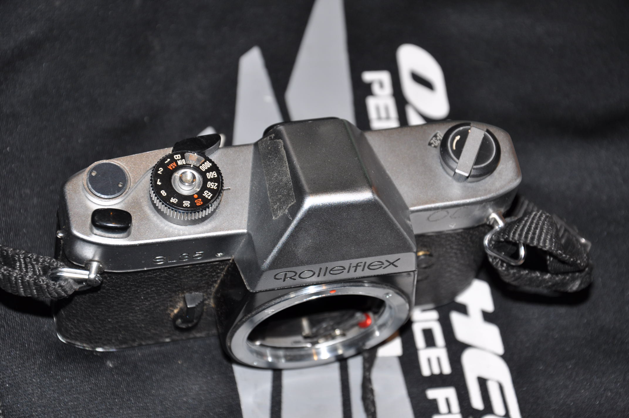

Camera #2 turns out to be a Singapore camera. Someone had misrepresented it with a made in Germany top. Good news is I have an extra "Singapore" top for it, so I put its black "Germany" top on the German camera with engravings.
So, this Singapore camera required quite a lot of work to get the speeds correct. Some pictures to follow.

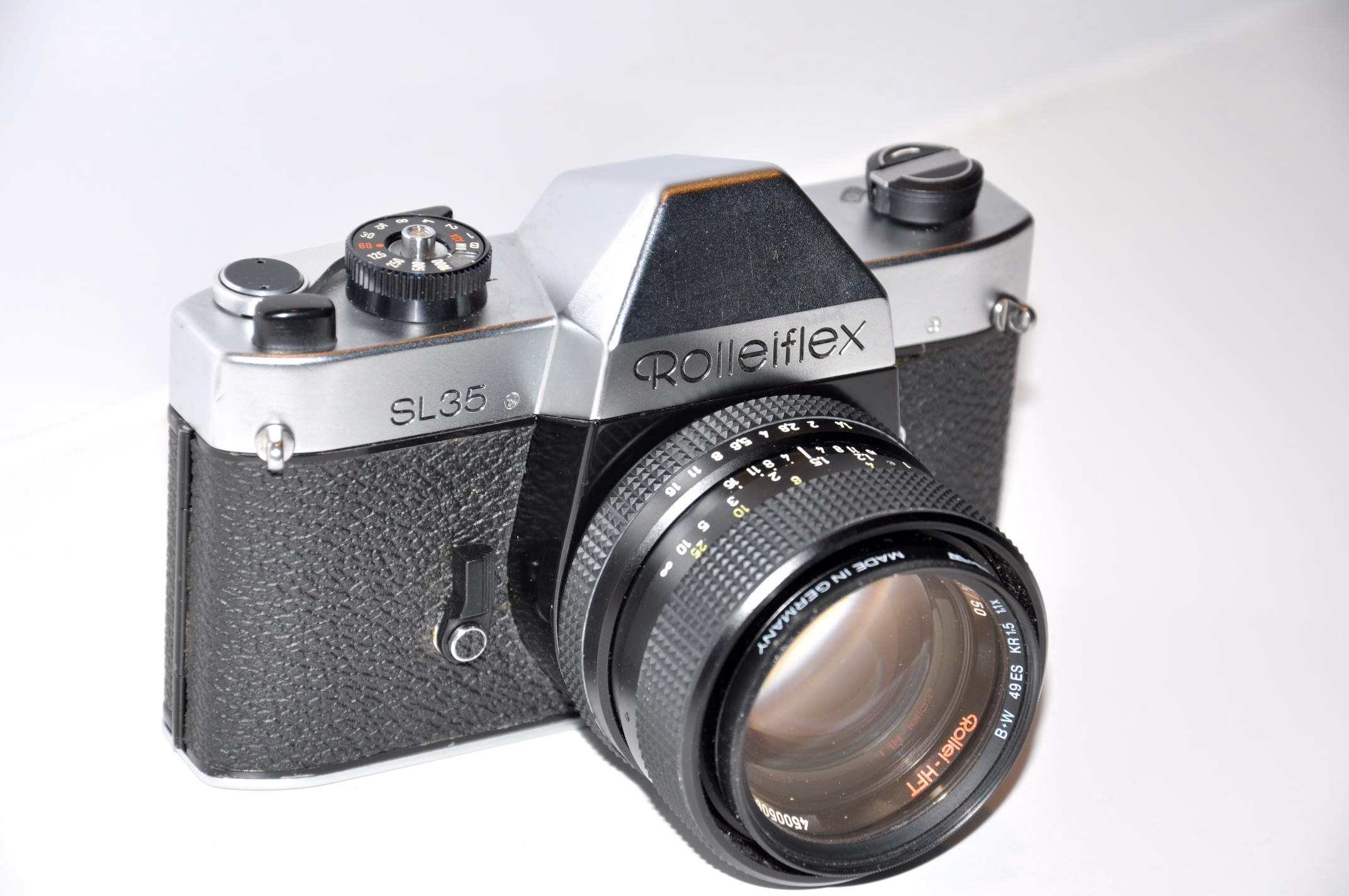

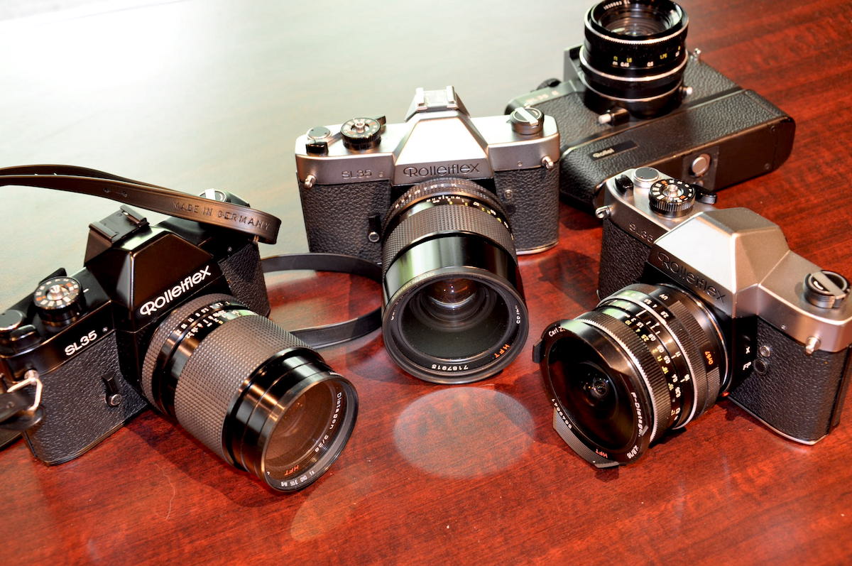

All three cameras in tip-top shape.
The black camera on the left sports a Zeiss 28mm f2.
The middle camera is fitted with a Zeiss 35mm f1.4.
The right hand camera (Singapore) is shown with the Zeiss F-Distagon 16mm f2.8.
In the background is an SL35E (totally different camera, no relation) with power winder and Planar 50mm 1.8.
I used the 5x7in light box from my enlarger, a variac and studio lamp to create a make-shift light source to set the meters on the cameras. Turns out they were all pretty much OK from the start.
