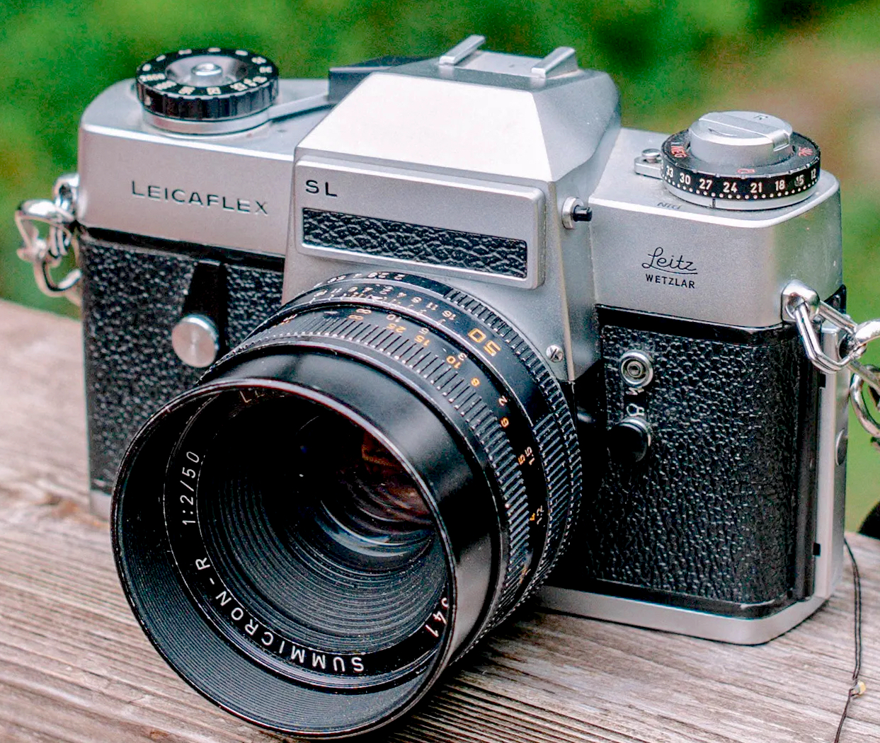

I believe a similar issues (too expensive to manufacture) brought and end to the Leicaflex SL, a similar West German 35mm mechanical SLR from the same time period.
(I don't have a Leicaflex SL...Picture is from the internet)

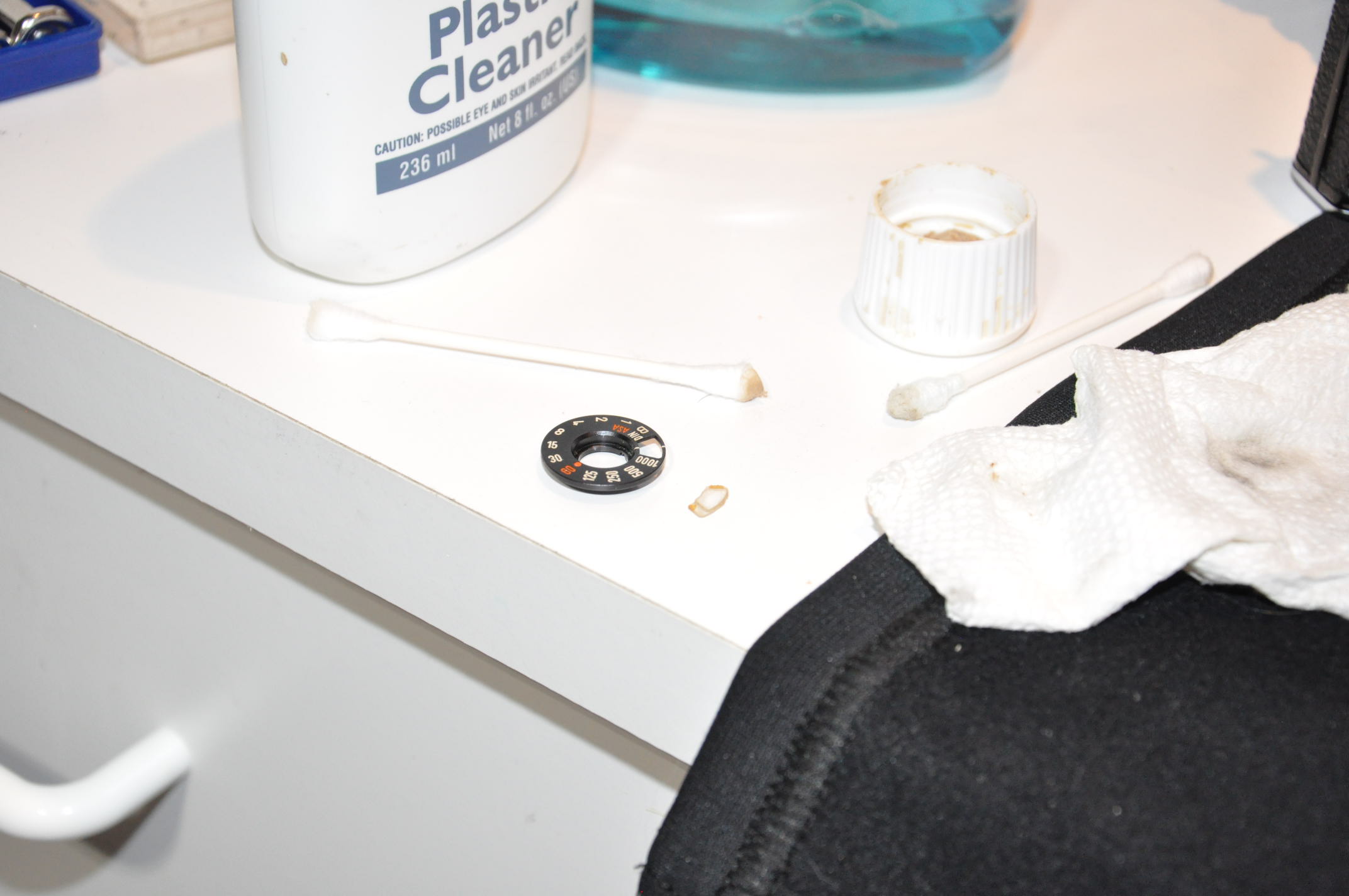

Inspection and cleaning. Nice thing about this camera is that it had never been opened before.
There was some play in the meter stop-down mechanism. I suspect from someone pressing too hard, trying to take a picture with the meter button (not an unlikely situation, based on where the meter button is positioned on the top of the camera).
I made a small spacer to take up the gap.
The frame counter window was clear, but for some reason the ASA window was dull.

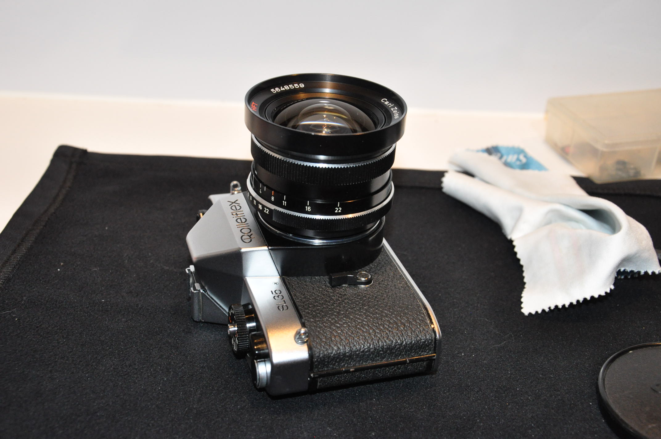

18mm F4 Distagon mounted and ready to go. Zinc-air cell for the meter and it reads similar to my other cameras and meters using patience allowing the meter to slowly stabilize as expected with conventional CDS cells.
Viewfinder, mirror box cleaned. Back of camera inspected and cleaned, no foam rubber to replace. Cocking mechanism is light and smooth. Pressure plate inspected and cleaned. Shutter speeds all within reason, no need for further disassembly at this time.
Back then, while examining the new Rollei 35 I indeed did buy a Leicaflex SL. The two did not compare in quality. Rollei TLR is in a league by itself. The Rollei 35 was just one of many 35mm SLRs in a crowded market at the time.
