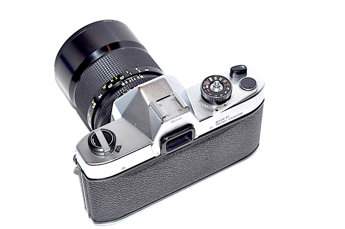

Camera #2 turns out to be a Singapore camera. Someone had misrepresented it with a made in Germany top. Good news is I have an extra "Singapore" top for it, so I put its black "Germany" top on the German camera with engravings.
So, this Singapore camera required quite a lot of work to get the speeds correct. Some pictures to follow.

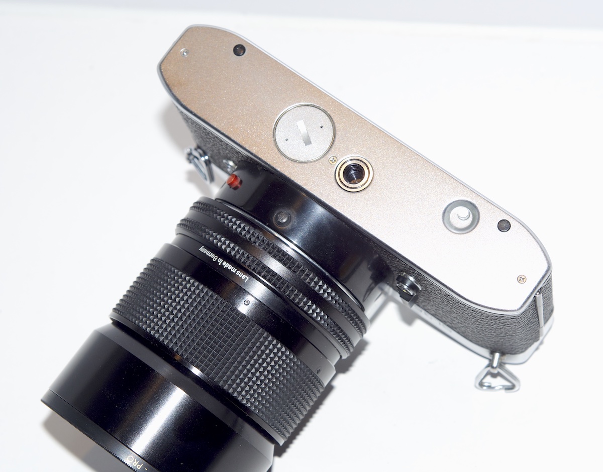

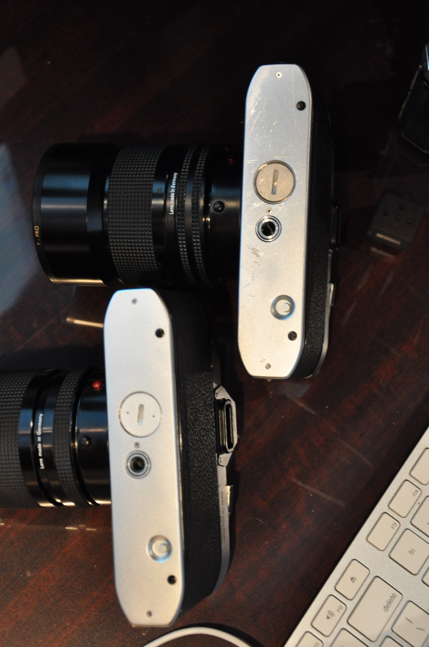

One of these cameras listed as 'parts camera' came without the battery cover on the bottom. Finding an original one would involve getting yet another parts camera.

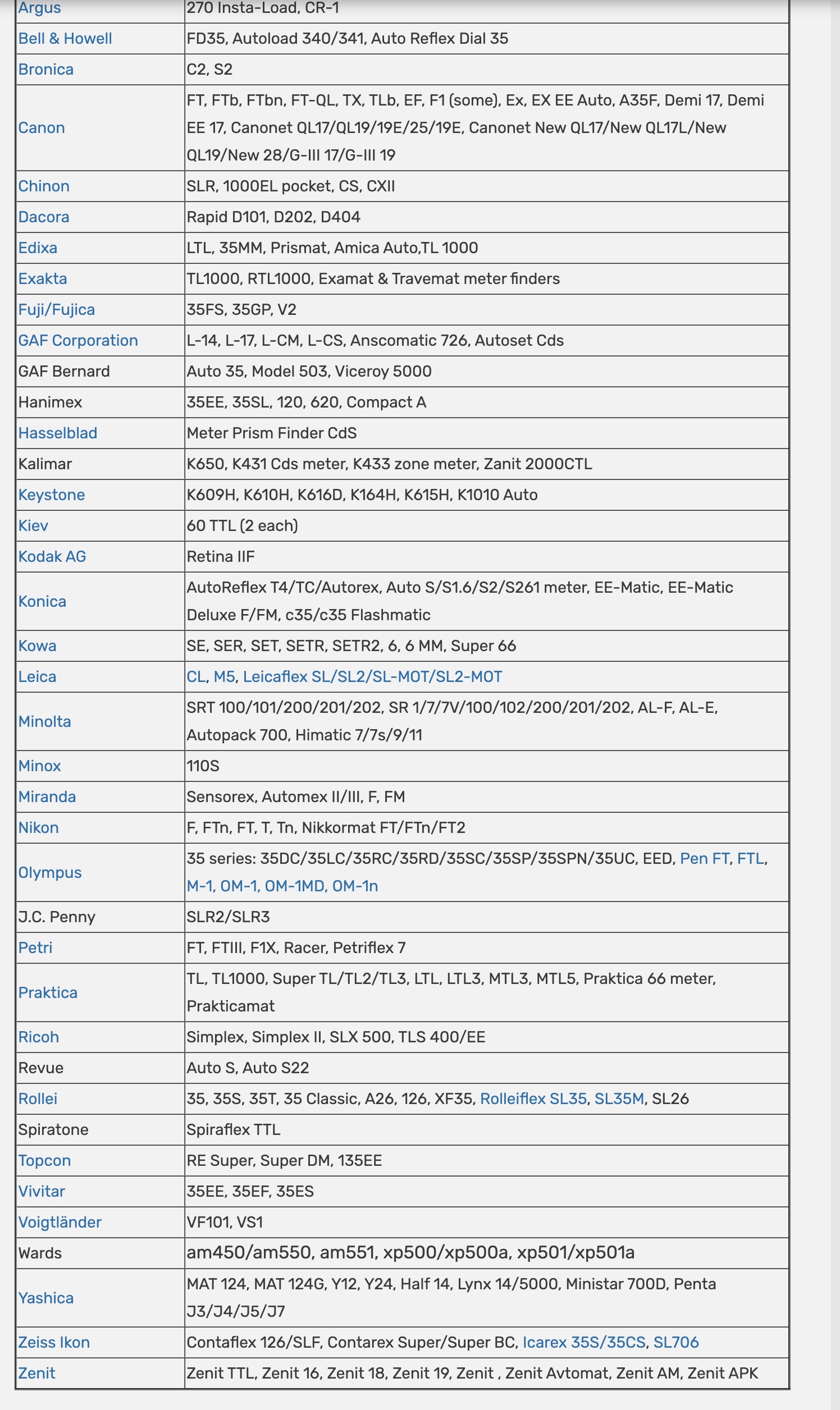

I did find this list of cameras that take the 625 battery, thinking the battery cap for one of them would also fit the Rollei.
I found a Minolta SRT cap on ebay and it was a perfect fit!

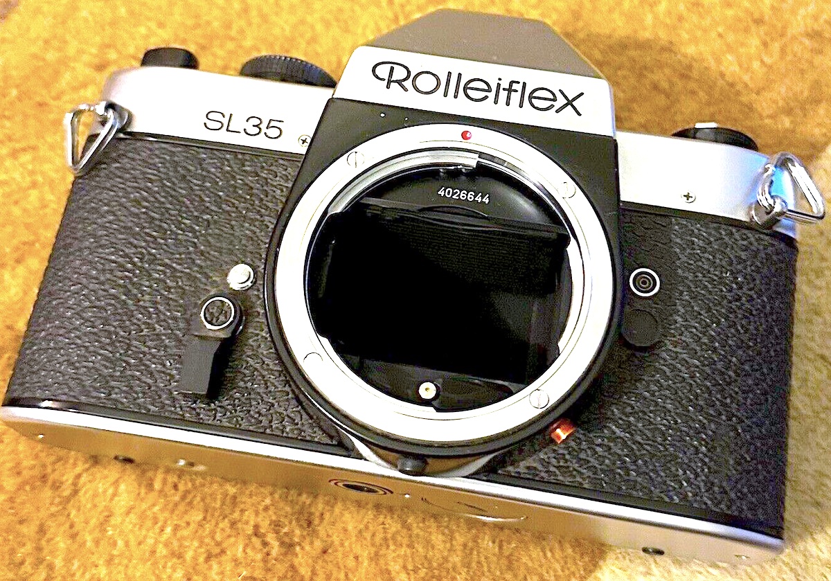

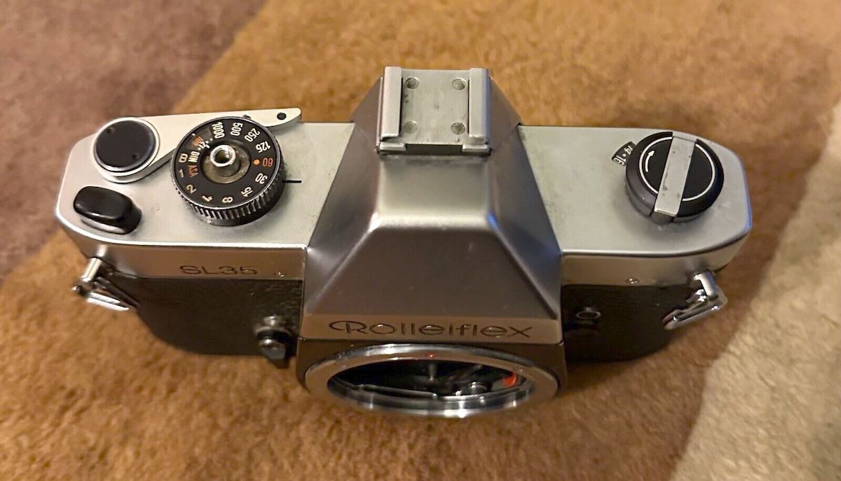

Just found another $30 Rolleiflex SL35 to un-jam and repair. Pictures to follow. This one looks very clean, just jammed.
Does not look like it has ever been taken apart or tampered !!
Nice looking camera, looks like the self-timer lever is in lockdown. I always thought the SL35 to be well-made and pretty trouble free. Unlike my experience with the SL35M and SL35ME. The SL35E was an excellent camera for me until I picked up a used old style Rollei potato masher handle-mount flash to use with it. I hooked everything up to try the flash out, and that was the last time that camera worked. The minute I hit the shutter button, it was like the camera exploded in my hand. Yup, that camera went up in a puff of smoke. I sold my lenses off at the next camera show I set up at. I haven't ventured into the Rollei 35 slr's since then. Still have a couple little Rollei 35's and several TLR's, but no SLR's.

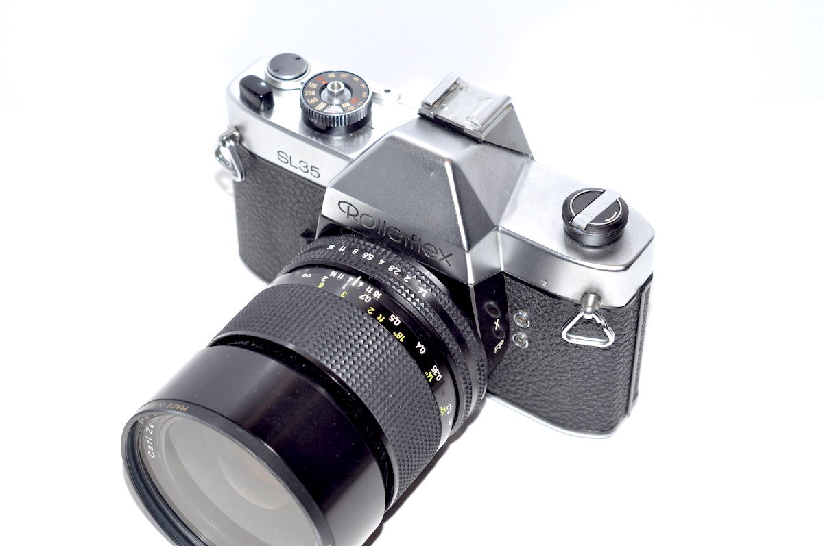

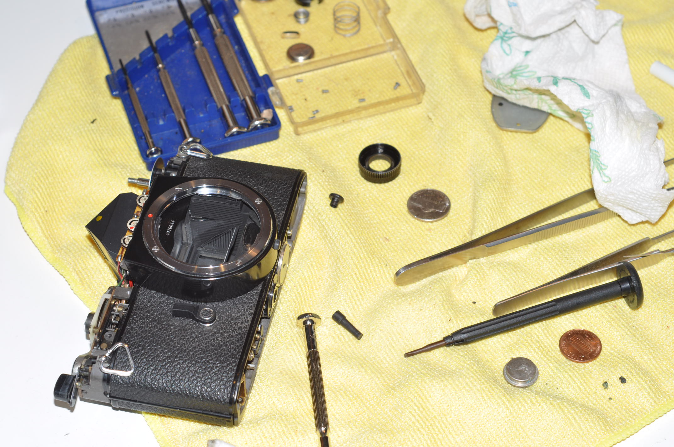

A little disassembly showed the mirror was stuck up because the closing curtain was getting held-up. It wasn't very hard to un-jam it. Then I set to cleaning it.
Other things done to the camera:
Remove and clean viewfinder lens.
Adjust ASA dial to align with dots.
Un-stick corroded battery cover and clean. Replace with new battery.
Lube opening and closing curtain shafts.
Grease a few contact points.
Adjust opening and closing curtain tension.
Clean top, bottom and leather covering.
This one cleaned up very nice. There is a little dent on top and the little black plastic tab on the wind lever is gone. Otherwise looks like new.

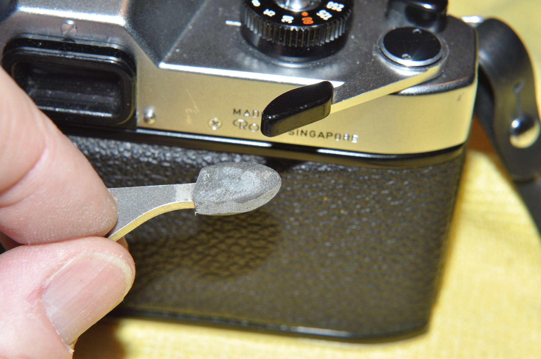

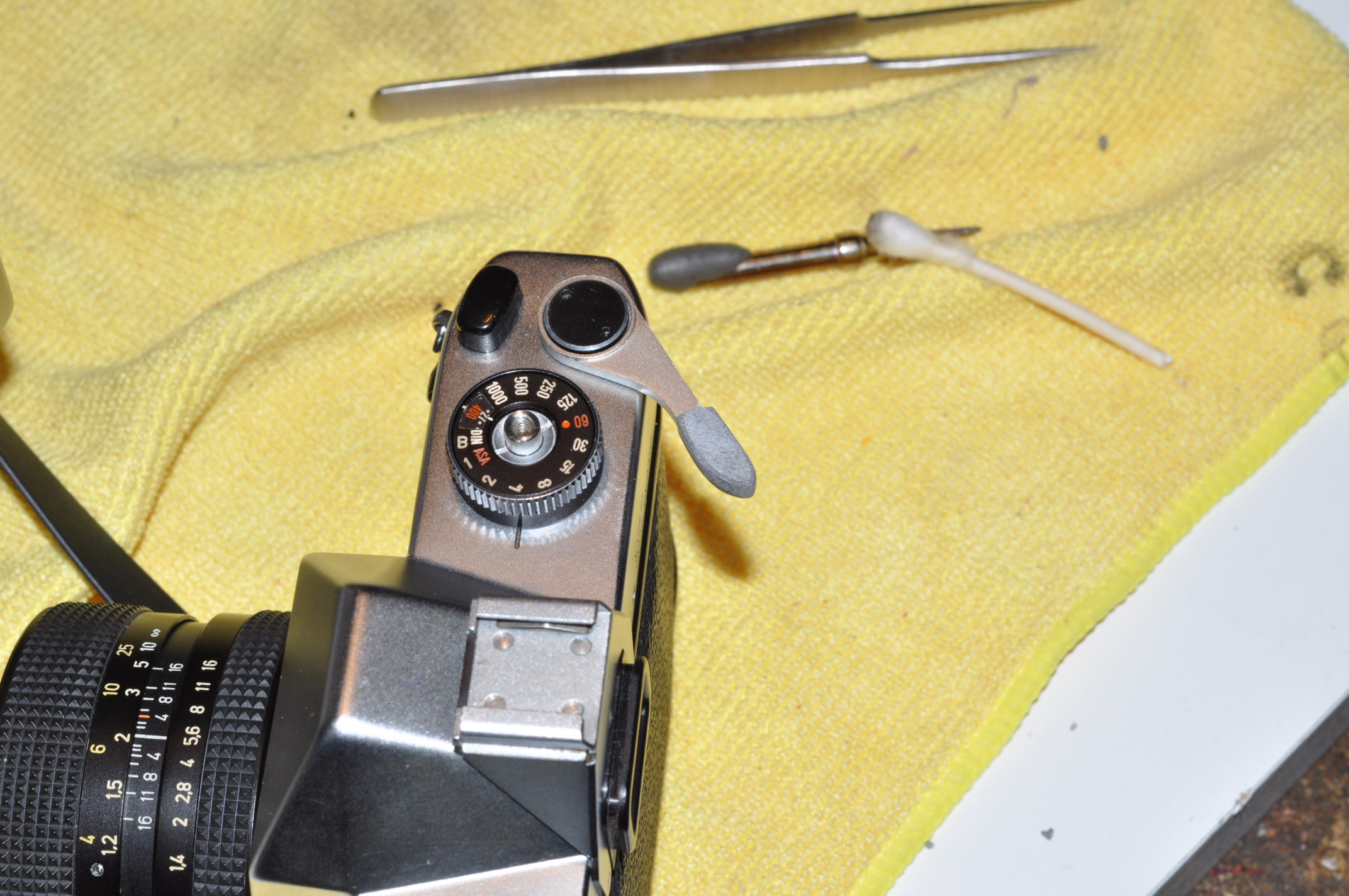

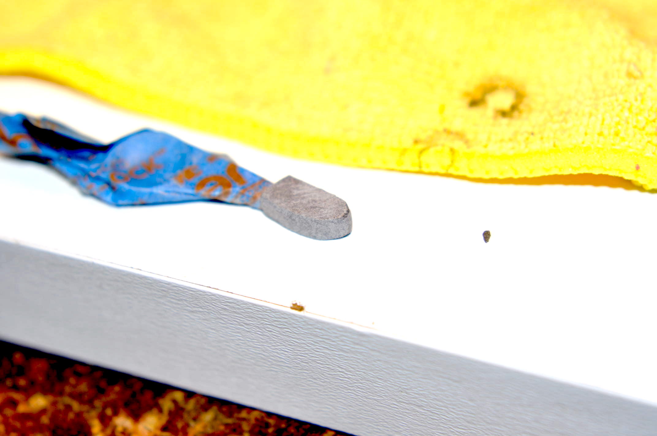

I just missed out on someone parting our an SL35 and the wind lever was already gone. So I used epoxy putty to make a new end piece.
The epoxy putty comes un-mixed and after kneading the putty, the two components get activated. It sets up pretty quick and sticks to fingers. After it set, it was easy to craft into shape.
The first picture shows the initial blob and the last picture shows the finished shape. I'll use it like this for a while just to make sure it does not fall off before I go to the trouble of painting it.
I don't think it will fall off, I tried the putty on metal before and it sticks like glue (which it in fact is).

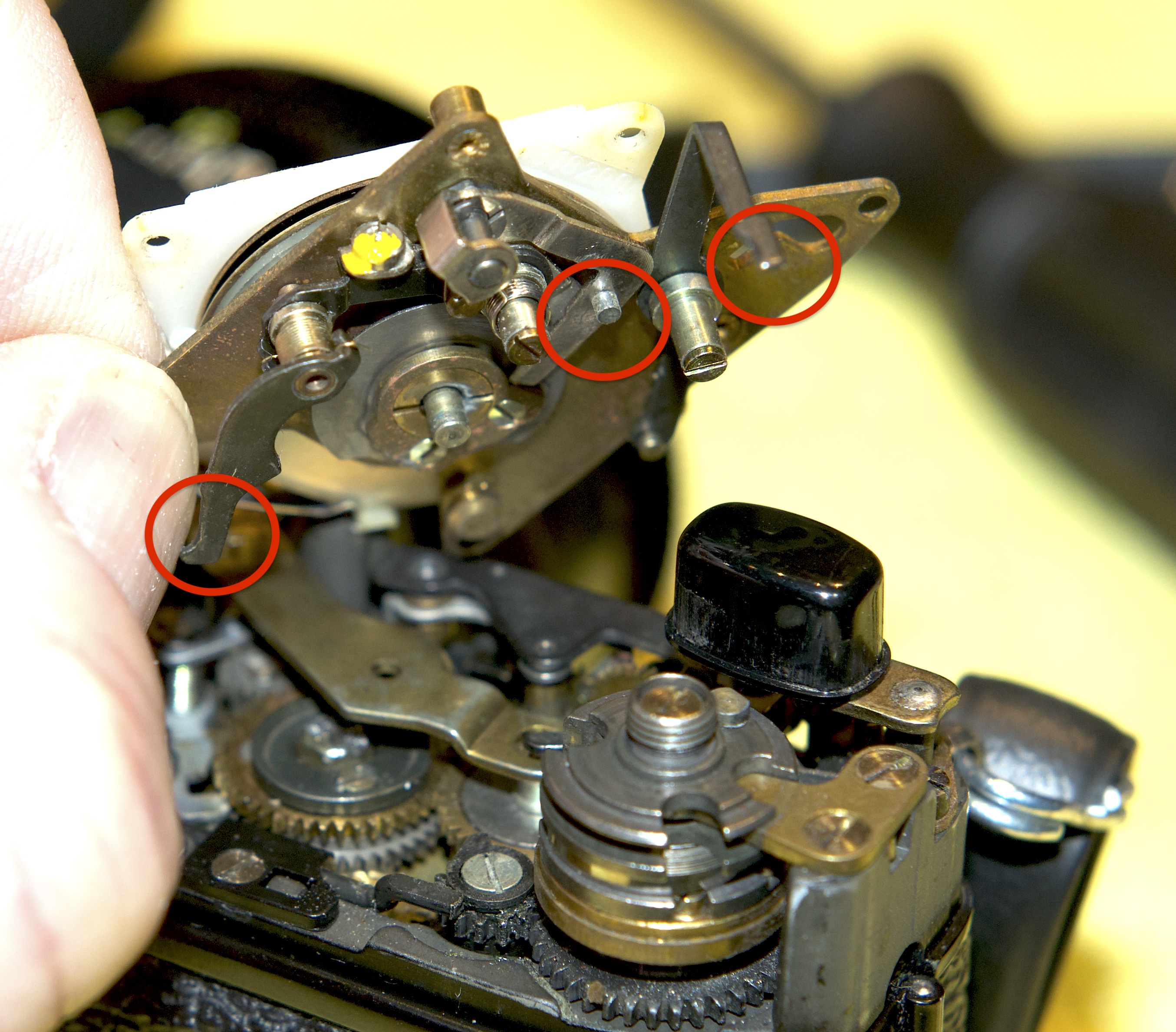

Underside of the speed setting cams showing the three levers that need to be in position when re-attaching the assembly.
This needs to be removed to get to the eccentric screw on the first-curtain cam which sets the slit width for shutter speeds 1/125 to 1/1000.
