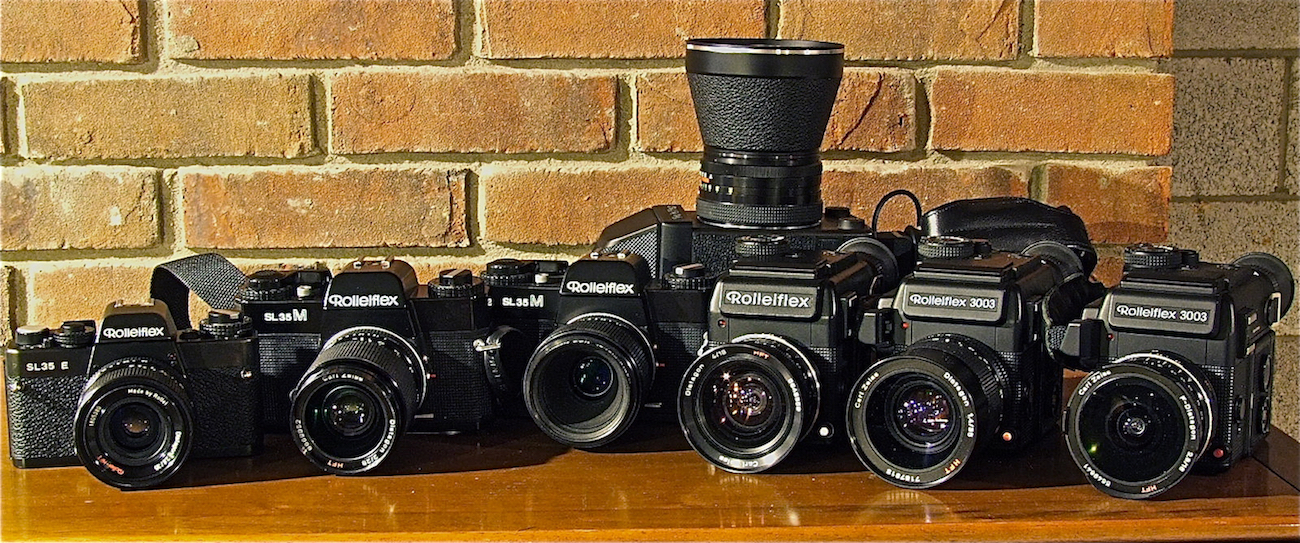

The Rollie that was priced to be in the same league as the Leicaflex was the SL2000 and the and the follow up the 3000. Same lens mount, built in motor drive, interchangeable backs focusing screens, not sure if there were interchangeable heads as well, the examples I've seen show sort of a waist level finder to used at eye level. I think it was all made in Germany.
This is an older picture, I have even more since then. But, other than this new SL35, none of these are both all mechanical and made in Germany.
Back then, while examining the new Rollei 35 I indeed did buy a Leicaflex SL. The two did not compare in quality. Rollei TLR is in a league by itself. The Rollei 35 was just one of many 35mm SLRs in a crowded market at the time.

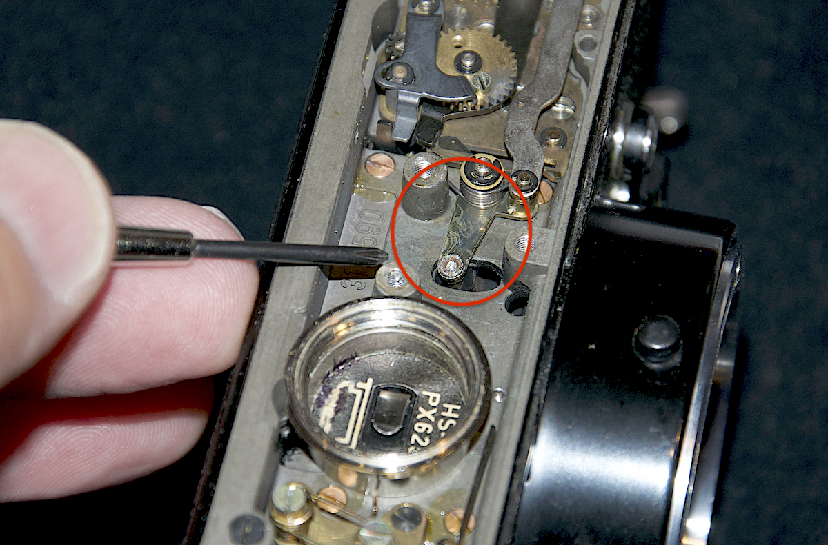

Someone with their mitts on this camera had bent this lever which actuates the stop-down pin. Again, probably trying to press real hard to take a picture.
I had already bent it back in the image below.
In case anyone is using one of these cameras (German or Singapore) if this lever gets bent, the aperture will not stop down all the way when turning on the meter. This is independent of the system that stops down the lens for the exposure though.
Do you think that once bent the level will likely bend again?
None of my lenses require any special force to stop the lens all the way. Someone must have really mashed on the button, I presume to try and take a picture with the meter button.
