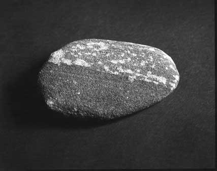

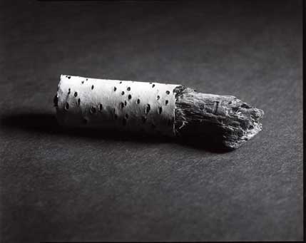

Wow! I just had two spectacular successes. I captured the entire processing on video using a reddened and dimmed Iphone screen, As soon as the prints dry and I do a little editing, I'll upload the stills and vids, with particulars.
Never say never....

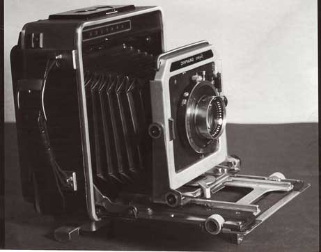

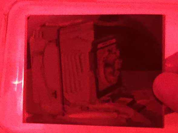

Well, these are by far the best successes I have had with the peroxide process!
I used the identical formulation of the bleach as with my failures: 175mL water + 125mL 35% hydrogen peroxide + citric acid (7.4 grams), but this time warmed to 80 degrees F.
Dektol was used at 1+1.
First development was 90 seconds to completion. Bleaching was 3 minutes. Second exposure was shortened to 30-45 seconds. Second development was another 90 seconds.
I observed that after bleaching, a faint positive remained before the second exposure. There is evidently some chemical fogging process happening as part of the bleaching process. There was little image change during the second exposure, except the dark areas became more coppery in appearance.
When the exposure is right, the first development will render a clear negative image, no matter how long development goes for. This was with a single Speedotron flash head at 800ws at 4 feet. My flash meter was set to ISO 3, which indicated an exposure at f/22.5, f/22 when the 1/2 stop bellows extension compensation was made. It seemed perfect at ISO 3.
Just to be sure this was repeatable, I did a second identical exposure using the cutoff from the 5x7 sheet, with identical processing. It came out even better. Same bleach. I used a shorter second exposure time, 30 seconds. The shorter exposure time gave better whites and fewer swirly artifacts in the highlight areas.
I captured the entire processing on video using a darkened and reddened Iphone display.
Here is the first development:
Here is the bleaching, real-time. I did let it continue another minute past the video end.
...and here is the fogging, second development, and fixing steps.
Apparently controlling the temperature, exposure, and first development solved the issues I saw before.
Hopefully it will work this well tomorrow!
Don

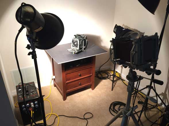

The particular shutter on my 210mm lens is a Copal #1 that is relatively modern and accurate. Being a leaf shutter, it will X sync at any speed, as long as I don't go faster than the flash duration of the Speedotrons, which only can happen at their highest 2400ws power output (1/250 duration). If I use the shutter sync cord, I simply set the shutter to 1/125 and it syncs fine at any flash power. It was simpler to set the shutter to "T", pull the slide, open the shutter, pop the flash manually, close the shutter and insert the slide. Old habit from wet plate.... I have a hand button that fires both slaved packs manually.
The new Minolta IVf flash meter really nails the exposure for the Arista #2 paper at ISO 3.

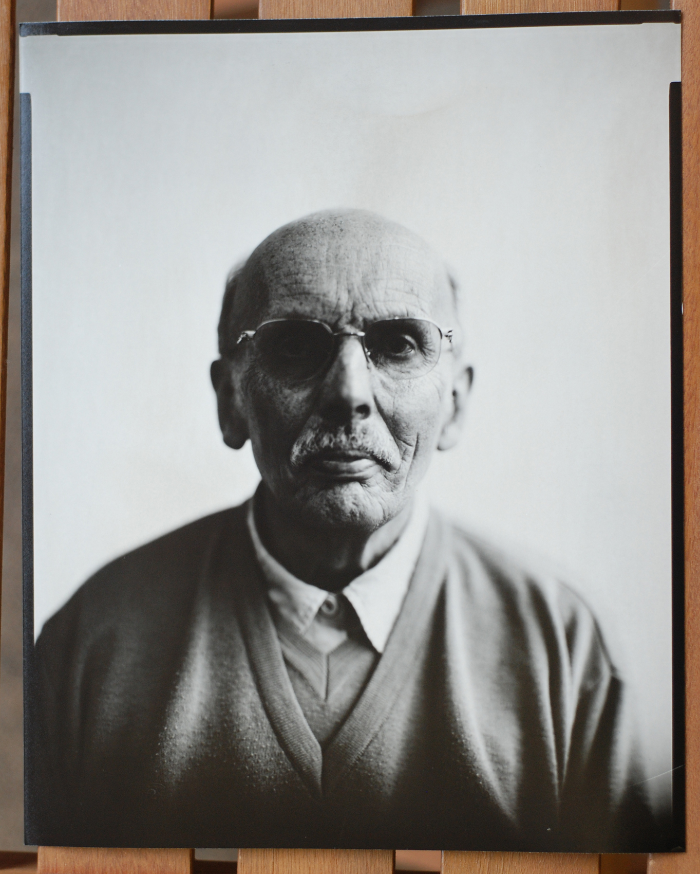

Great image with excellent contrast.. Thanks for details on the processing. I used really cool bleach with a concentration and formulation close to yours with miserable results. Warming it seemed to clear up the issues with incomplete bleaching. I have been agitating the bleach and it seemed to go OK the last round of shots.

Thanks very much, and thanks for the info on the lighting. I'll have to take a break from making these for a couple weeks unfortunately, so when I get the chance I'll have to try some mixed lighting. I'm also curious about about how the temperature of the bleach might be effecting the image too, my only worry would be that the warmer the temp the quicker the bleach will break down.

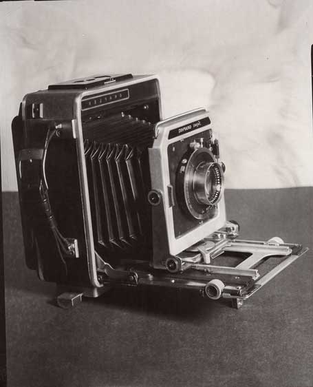

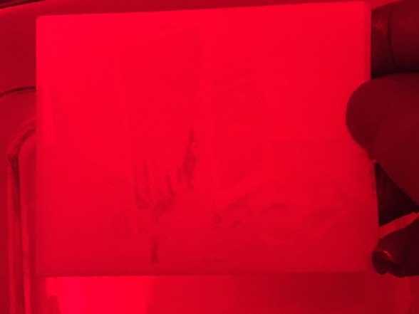

One odd thing I noticed when processing the recent image of the Graflex camera is that the negative image turned positive within seconds of hitting the peroxide bleach. The positive image faded slowly during the bleaching, to re-darken after reexposure and redevelopment.
That seems very odd. The dichromate bleach has no such effect. The negative image stays negative and fades to white in the bleach. A faint positive reappears during the second exposure. That images darkens to a positive print in the developer.
Something interesting is going on chemically.
Don
I noticed the same with my prints too, but have no idea what might be causing it.

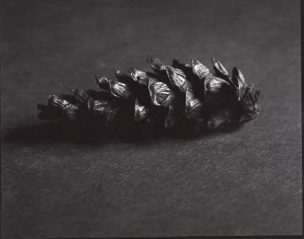

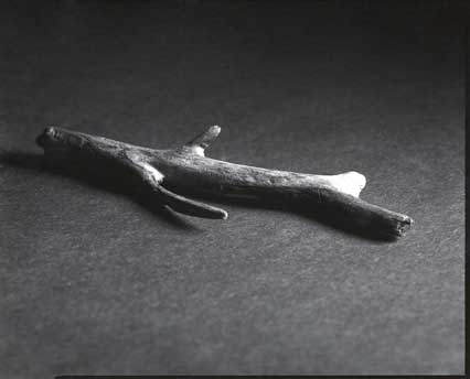

My daughter and I experimented with some low key closeup reversal shots using the potassium dichromate bleach. These were done with a strong side/back light from a single strobe head at relatively low power. Even with the odd lighting angle, the Minolta IVf flash meter nailed the exposure at ISO 3, once the bellows extension factor was made. Accurate pointing of the sensor dome toward the lens from subject was necessary to capture the incident light correctly. I like the way these turned out,

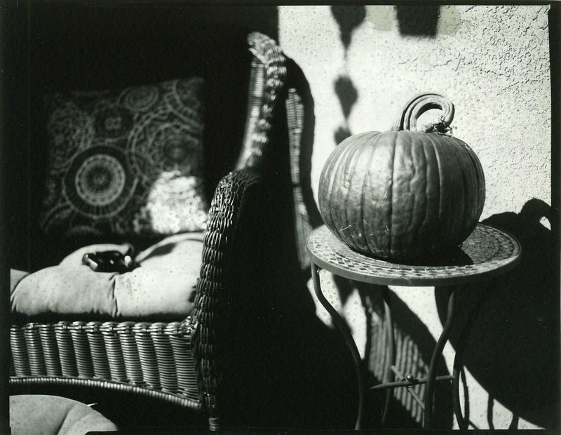

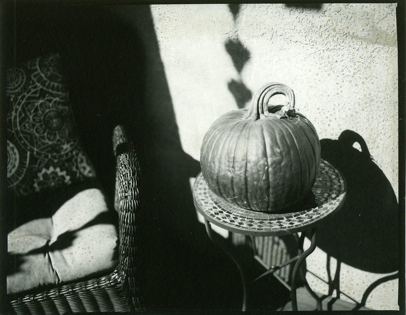

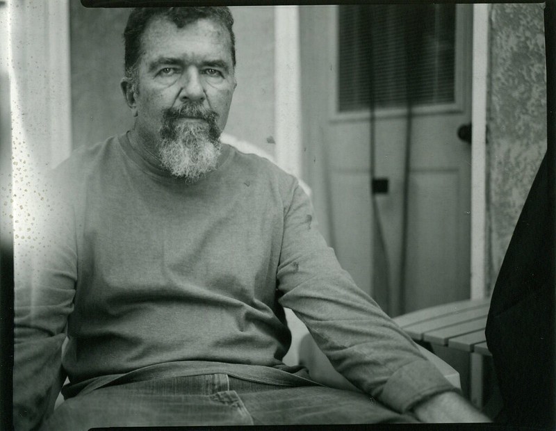

Today I had time to do more reversal tests, with Arista grade 2 RC paper; week-old 1+20 Ilford multigrade paper developer replenished with 1cc of fresh concentrate; 200mL H20+1/5gram citric acid solution; 300mL 9% H2O2. The citric acid and peroxide were in separate trays, as I try a variation on what others have had good results with this week.
My processing methodology: developer 1:30; rinse in water bath :30; citric acid solution :30; peroxide bath 2:00 with GENTLE downward pushes with tongs; citric acid solution :30; peroxide bath 2:00 with GENTLE downward pushes with tongs (for a total of 5:00 bleaching time); thorough rinse under running water; fogging exposure :15 under enlarger at 16" height, f/22; standard develop, stop and fixer.
I first tried this new method on a 2-week old exposure that had been sitting in a film holder (image not shown). It reversed nicely, though the contrast was less than I expect (this was with the week-old 1+20 developer, prior to replenishment with 1cc fresh concentrate).

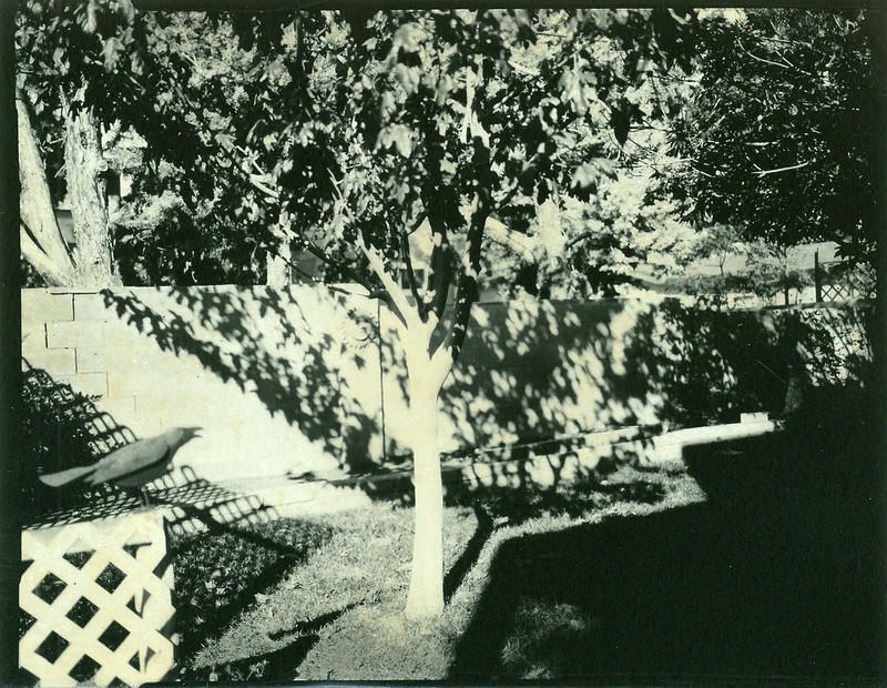

Next was a high-contrast morning scene in my back yard. ISO0.8, exposure 1/4s @ f/5.6. The print was very dark coming out of the first developer. Nothing much visible happened during the first :30 CA bath. But the print quickly began to bleach in the first 2:00 peroxide bath. Gentle downward pushes with tongs helps. Too much agitation doesn't work; too little doesn't work. The technique appears important, like with wet plate collodion. Into the 2nd :30 CA bath a bit more bleaching happens, due to H2O2 carry-over. During the 2nd 2:00 peroxide bath some residual gray tones bleach out, leaving only a few spots of faint gray with otherwise a white-looking print.
Backyard001 by Joe Van Cleave, on Flickr

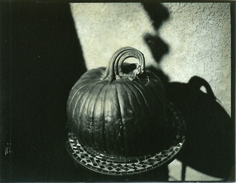

Next I moved my Speed Graphic to the sunny front porch. These next three images were ISO 1.5, 0.8 and 0.8, respectively. The same observations apply during the bleaching steps.
Pumpkin001 by Joe Van Cleave, on Flickr
Pumpkin002 by Joe Van Cleave, on Flickr
Pumpkin003 by Joe Van Cleave, on Flickr
Note that these were high-contrast scenes, and the grade 2 paper seemed to represent the scene contrast pretty accurately. Some "freckle defects" were noted on some of the highlights, more so near the edges than the middle.

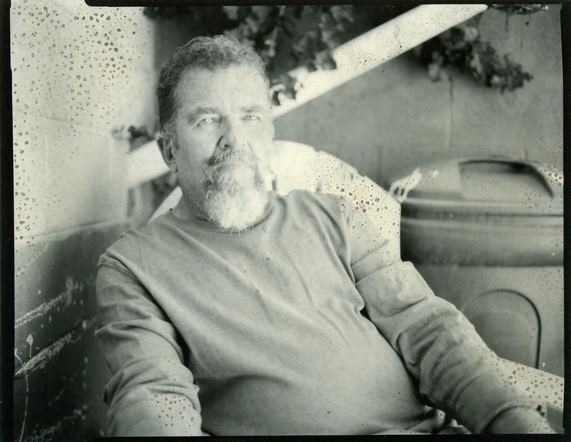

Next I wanted to try selfie portraits in subdued shade. These three are ISO 0.8, 0.8 and 1.5 respectively. Of the three I like the last one, at ISO 1.5, the best, despite the light leak from the film holder and wonky composition. Note the freckles defects again, affecting the highlights and more so near the edges.
Joe001 by Joe Van Cleave, on Flickr
Joe002 by Joe Van Cleave, on Flickr
Joe003 by Joe Van Cleave, on Flickr
In all, I processed 8 prints with the same batch of chemicals. No evidence of exhaustion was seen, unless the freckles defects are an indication. I used 77mL of 35% H2O2 to make the 300mL of 9% concentration; and 1cc of fresh developer concentrate; along with 1/5 tsp of citric acid powder. A rather conservative usage, I'd say. Don't know how much further the bleaching would have gone.
I think it's important to go back and forth between the CA solution and peroxide. I let the prints drip just a bit between each. On one print I tried a 3rd round of :30 CA bath and 2:00 peroxide bath with no indication of further bleaching, indicating there's a limit to how far this method goes. But 5:00 total bleaching time is great. This is with a 9% peroxide concentration; a reasonable compromise between strength and safe handling.
I was happy to get good results for both sunny conditions and shaded light. The working ISO of 1.5 seems pretty consistent in both types of light for this Arista grade 2 RC paper. I should note that the contrast of the print with this grade 2 paper seems to depend a lot on the concentration of the first developer. With the week-old 1+20 concentration, the first print (not shown) was low contrast even though exposed in sunny conditions; while the 2nd print processed (the first one shown here) was very contrasty in similar light, but with freshly rejuvenated developer.
I heated my darkroom to mid-60s F with a space heater. No problems with bleaching at all, for 8 prints. I'm stoked. Hopefully I can do some 8x10 tests soon.
~Joe
EDIT: Note on the last image that the freckles defects are only seen in the fogged highlight area, indicating these are somehow related to the highlight exposure, and/or bleaching action. Note in the first pumpkin picture, at ISO 1.5, freckles are only seen on the stucco wall in the very brightest highlights.
Also, about 1 minute into the first peroxide bath the print suddenly does a sabbatier effect in the middle, as it begins to bleach. It's very noticeable, and a good indication that the bleaching is active.
NOTE: In the last three prints, spots and/or blemishes in the middle of the image are probably due to the tongs being used to push down the print in the peroxide bath, an indication of how sensitive the emulsion is during this step. A better way needs to be found to keep the paper submerged - like a thin vertical slot tank, perhaps.
The last three images were 2 second exposures. I used a 3-foot shutter release cable on the Fujinon 135/5.6 lens, and a focusing target with string attached to a yard stick for pre-focusing the camera, prior to being seated for the selfies.
