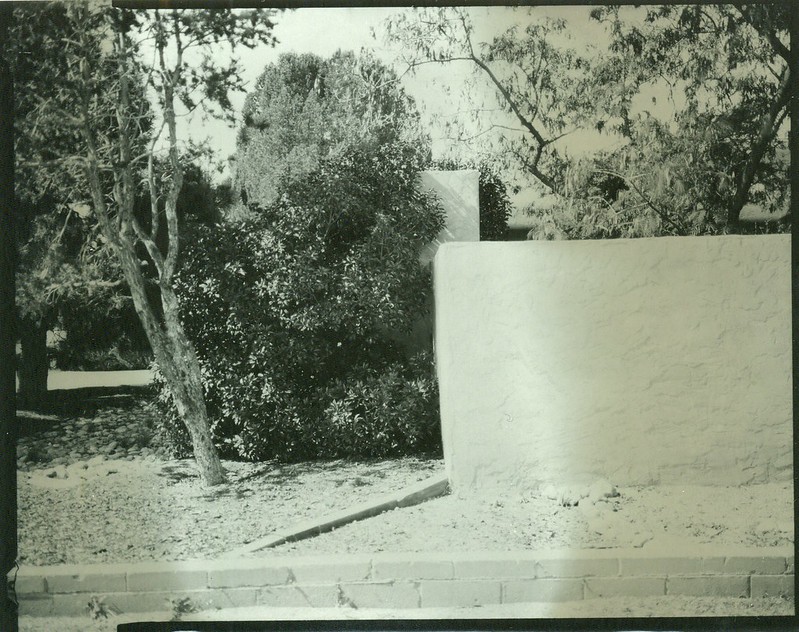

Image 1:
Paper: Arista grade 2 RC, semi-matte finish. Rated ISO=0.8. Exposure = 1/4sec @ f/5.6. Developed in Ilford Universal paper developer diluted 1+10 (100mL H2O + 10mL concentrate). Developed to "completion", i.e. 5 minutes. Bleach: 4.5% solution (100ml H2O + 15mL of 35% H2O2 +1 TSP citric acid, for 45 minutes). Second exposure under enlarger until midtones appear. Result:
Reversal001 by Joe Van Cleave, on Flickr
The print looks pretty good, except for the center 3rd being lighter than the outer 3rds. This was a one-shot process, the next print used fresh chemistry.

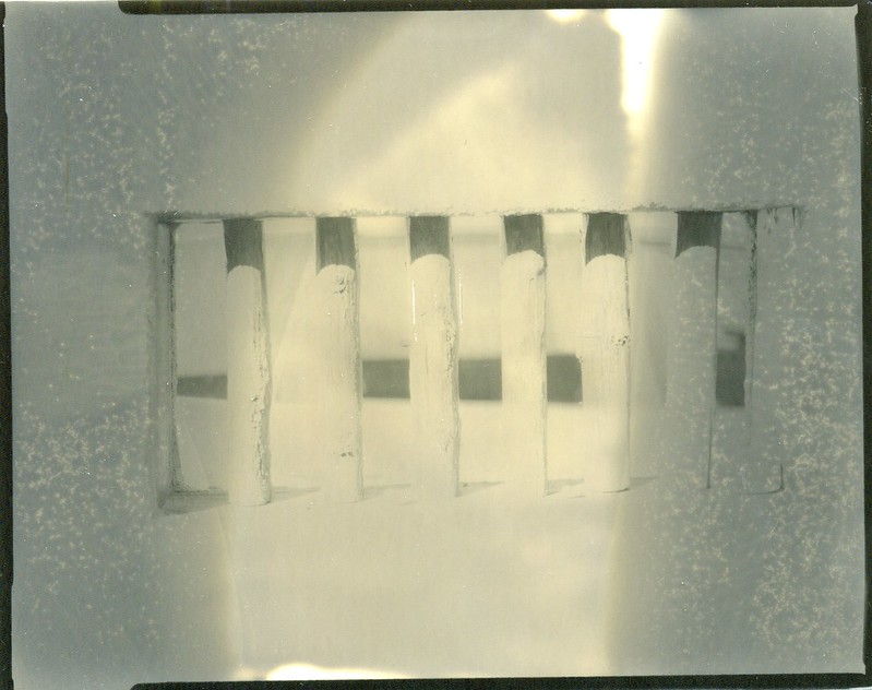

Image 2:
Paper: Arista grade 2 RC, semi-matte finish. Rated ISO=0.4 (3 stops over ISO3 - it was later in the afternoon, less UV light, hence more exposure). Exposure = 1/2 second @ f/5.6. Developed in Ilford Universal paper developer diluted 1 +10 (100mL H2O + 10mL concentrate). New one-shot batch. Developed to "completion", i.e. 5 minutes. Almost black coming out of first developer. Bleach: 9% solution (100mL H2O + 25mL H2O2 + 1 TSP citric acid). Second exposure under enlarger until the midtones appear. Result:
Reversal002 by Joe Van Cleave, on Flickr
The print appeared totally black coming out of the first developer. After bleaching, the center 3rd was cleared white but the outer 3rd on each side appeared uncleared. Not sure why. I'm using 5x7 trays, so the liquid level was rather low. I agitated continuously. I'm attempting to use these chemicals as a one-shot process, to reduce variability caused by chemical exhaustion. But somehow the center 3rd cleared. I had the print face-up in the tray, continuous agitation, ensuring the paper was immersed in liquid. The paper's natural curl means the center was closer to the surface, more shallow chemical. Yet the center cleared better than the edges. Another mystery I can't explain. Why would the center clear better than the edges when it was immersed less in the bleach?
Later, I made another exposure at ISO 0.8, new one-shot developer of 200mL H2O + 15mL concentrate, then the bleach at 200mL H2O + 50mL H2O2 + 2 TSP citric acid, for a concentration of 9%. Bleached for several hours. The print didn't clear, it's mottled badly. I doubled the volumes to compensate for any agitation issues from minimal volumes. Fresh chemistry, temperatures constant. Constant agitation for the first development. Agitated in the bleach numerous times, flipped front and back sides up. Nothing seems to help. I'm leaving the print in the bleach overnight to see what happens.
My conclusion thus far is that the way I'm doing this process is unmanageable. Not able to repeat two prints with the same result, exposed identically in-camera within a minute of each other; each print processed identically with fresh chemicals, constant darkroom temperature, same dilutions, etc. I'm seriously considering giving up on this process. I can't figure out where the uncontrolled variability is coming from. I've been working in the darkroom for +25 years, always have had good darkroom discipline, can make great paper negatives. There's something going on with this process that I don't understand. Help needed.
EDIT: On the second print, note the two vertical scratches near the middle of the image. I've seen these in several prints. I'm good with darkroom discipline, developing these one at a time, using tongs to handle the paper. I'm suspecting this new batch of paper I recently ordered from Freestyle Photo has scratches from the manufacturing process.

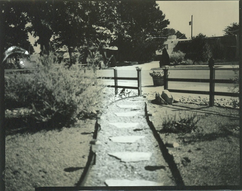

Today I decided to increase the volumes of the developer and bleach to 300mL. The developer was 300mL H2O + 30mL Ilford concentrate. Bleach was 225mL distilled water + 75mL 35% H2O2 + 3tsp citric acid (about a 9% concentration of H2O2).
Based on the prints attempted yesterday and last night, I had a hunch that my assumed paper speed of ISO 0.8 was just too much, the bleach couldn't clear all that silver, hence the mottled appearance. So the two prints attempted today were at ISO 3 & 6, exposed in-camera within seconds of each other. My experience of using the glossy version of this Arista grade 2 RC paper is that it's faster than Ilford multigrade RC paper (I've used it at ISO 12 for paper negatives).
ISO 3 print: exposure = 1/15s @ f/5.6. Subject was daylight landscape of my front yard. Developed for 3 minutes. My darkroom had a space heater running to ensure temperatures were in upper 60's F. Chemical temps were also checked in the trays with a thermometer. Post the first developer the image had discernible shadows near paper white, with highlights very dense. The rinse step between the first developer and bleach was 400mL H2O + 2 tsp citric acid. Bleaching was face-up, continuous agitation for first 5 minutes, then periodically until image was as bleached as it would get, about an hour's duration. I used a black tray covered with another, larger black tray face down, so I could exit the darkroom without fogging the print. Post-bleaching the image was very faded, bleached highlights a cream color, barely discernible midtones in some areas. Thorough water rinse, squeegee front side, then second exposure was under enlarger, 16" height at f/22 for about 30 seconds, or until some tone began to appear in previously unexposed areas of print. Second development for about 2.5 minutes or until shadows were stable.
Reversal003 by Joe Van Cleave, on Flickr
The center of the image, where the path is located, is bleached much more, the tones also more neutral gray. I suspect this was from the paper curl, being face up in the tray, the center of the paper was closer to the surface. Note the tong mark upper left edge, and scratches upper right. Not certain where scratches are occurring. I use the same tongs for the same trays, perhaps some residual contamination. Need to rinse tongs between steps.

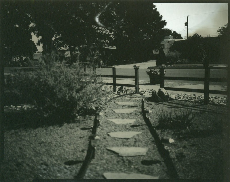

ISO 6 print: exposure = 1/30s @ f/5.6. Same processing as above, in same chemicals (not replenished). I weighted down both long edges of the print in the bleach with thin strips of glass (leftovers from a stained glass project - I figured the glass would be somewhat chemically neutral). Bleaching much more even, though there's some brown tones in part of the sky at upper right. No scratches seen. Note tong mark again upper middle.
Reversal004 by Joe Van Cleave, on Flickr
Going forward, next week I'm going to repeat these steps, at ISO 3 for daylight landscapes. No more than two 4x5's for 30mL of developer concentrate, 75mL of 35% H2O2 and 3 tsp citric acid. I need to prove the results are reliable before attempting 8x10's.
