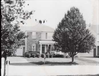

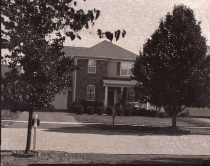

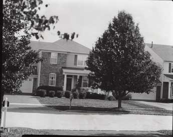

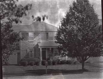

Here are some daylight shots with the dichromate bleach. I used my previous findings for the first two.
This exposure is exactly that recommended by Joe for the Arista #2 glossy paper: In EV14 light (hazy sun) f/11 at 1/2 second. Exposed as ISO 1.5. Looks good!
Overexposed from above by two stops: f/8 at 1 second, EV14 light. Way too light.
Here is my best peroxide print of the same scene, same lighting from last week:
Here is what happens when the first development is not done to completion. The paper was totally white after the bleach, but after fogging and second development, the highlights were not bleached completely. F/11 at .5 sec, same as the good print above. I think the mottling Joe saw (as did I) with the peroxide bleach is from undeveloped highlights from the first development. The undeveloped silver halide survives the bleaching and gets re-exposed in the fogging step, causing the mottling, similar to what is seen here.

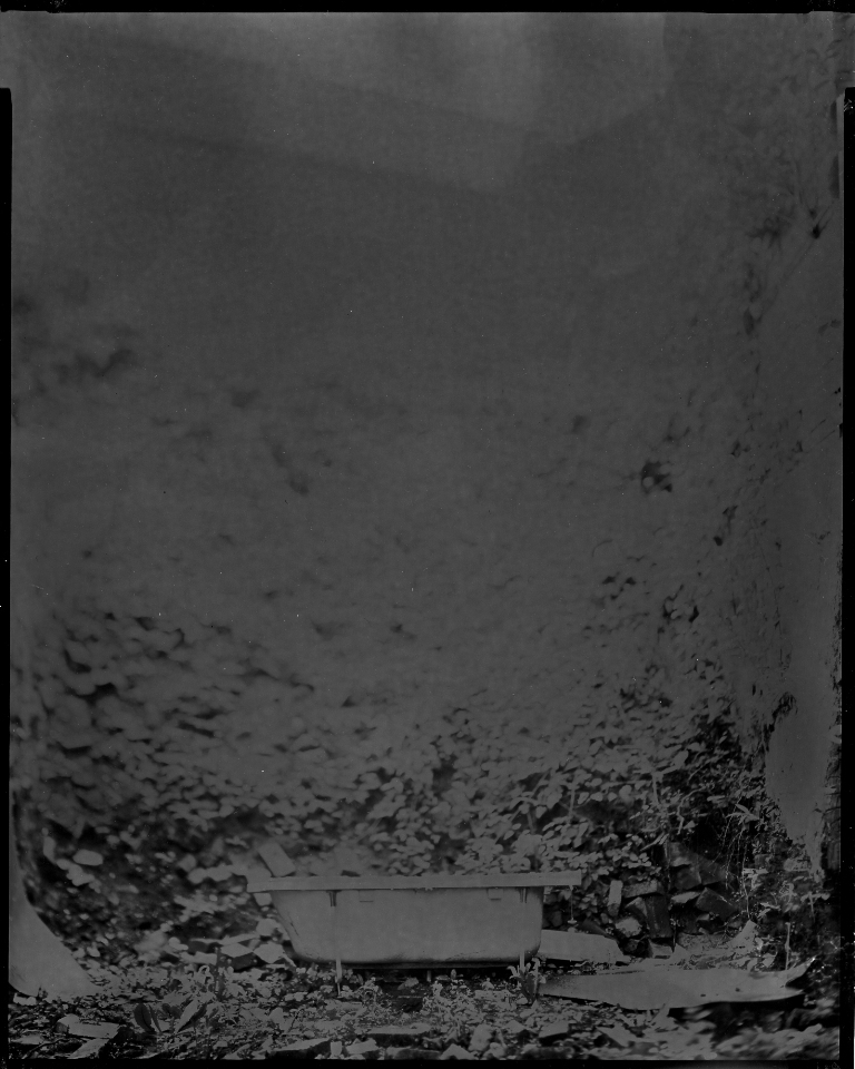

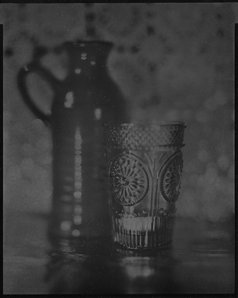

I've been experimenting with this in the past week or so but am going in some different directions:
  • I am using very weak LPD as my first developer, until I like what I see ( but I agree that if you don't get blacks, there will be trouble )
  • I am using VC RC paper
  • I am using weak drugstore 3% H2O2.
  • I am using CA stop bath ( and rinses in water ) prior to bleaching, so that the pH does not change so abruptly in the gelatin.
  • There is a substantial amount of control over contrast using contrast filters for the 2nd exposure, but I agree it needs to be plenty.
  • weak Farmer's reducer does wonders for the highlights at the end. ( so called "proportional", not "cutting", I think )
Still trying to dial in the details, but it's working pretty well and I'm getting prints that I like. Will write more soon when a few more details are better understood!

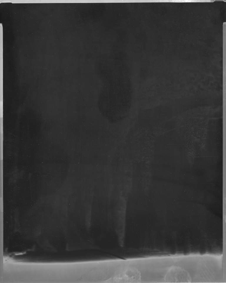

so after seeing Joe's video and also lamenting the current lack of Harman Direct Positive, I've also been experimenting with using peroxide bleach. My results so far have been mixed, but getting steadily worse..
I was originally hoping to use this process as a semi daylight process, so that I could use the second development in demonstration, and but the initial image, as you can see, ended up a little grey. Despite looking (in real life) pretty well exposed, I wasn't getting any white highlights. In the mean time Joe had figured out that he wasn't getting any whites because of overexposure on the second exposure..
great! so off I go with a new exposure to the darkroom, and just as expected by cutting down the second exposure I get some whites. Image 2 is a test image with 2 exposures (1 stop difference, but one is the same as in image rev1) and was processed in the darkroom and re-exposed under enlarger, f8 for 8 seconds.
and so now I'm thinking, this is great.. so off I go another new exposure, then back to the darkroom and with the same processing technique (re-exposure time) I look aghast at another grey image.
I've since tried fixing a couple variables I thought might have been the problem between image 2 and 3. New bleach, new dev, different exposure, but everything just kept coming up grey. And so today I tried a test print with different exposures (on the second exposure) and get this:
It hasn't even reversed has it?
I'm making progress of sorts, I guess, but now I'm a little unsure where to go from here. After Don's latest update I can now only think that not enough developing at the beginning is what's causing the problem, however my process has been consistent throughout - a little background on that, I'm using 8x10 Ilford Multigrade RC (shot at iso 1.5), Ilford Multigrade Dev 1:9, 12% peroxide (plus 1 tsps citric acid per 100mm). Bleaching seems to be working and paper is almost completely white before re-exposing. Everything is currently being done under safelight (which I also tested wasn't fogging the paper).
There have been a few more images than I've posted here, most are just slight variables of image 1 or 3, until today where I got nothing.
I'm not sure if this information is any good to anyone... maybe just as a cautionary tale of something, but of what tho', I'm unsure.

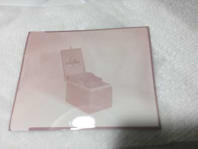

It's not that subtle and easily seen under the 60-watt LED lamp I'm using for the second exposure!
Here's what it looks like just before I developed it (from a completely white image from the bleach):

Right! It's almost like watching a salt print (printing out process) slowly appear, but fainter. I needed to see the midtones before stopping the second exposure and developing. That gave an almost perfect result.
This is with the complete bleaching of the dichromate bleach. I don't think the peroxide gets to the point of an all white paper, but it should be at least a creamy color with a faint image visible. I would think a similar darkening of the image would be evident.
After developing the paper shown above, I got this:
