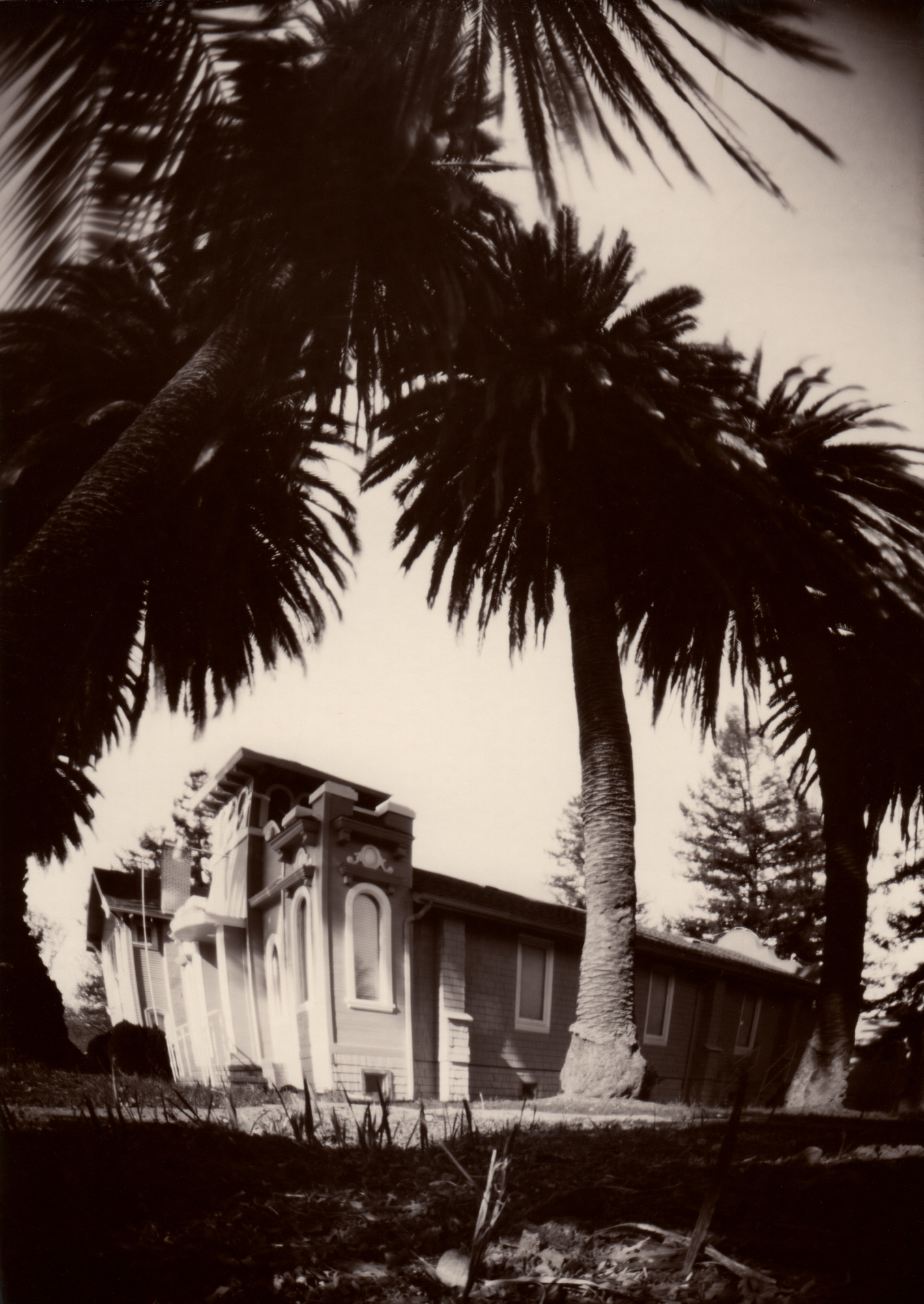

Here's one I made today. The old palm trees caught my eye and I walked down the street to look at them.... they were at a Korean Baptist Church. We don't have all that many palm trees here, but some of the ones we do have were planted more than a century ago. These could easily be that old. I'll probably go back again... something about palm trees and pinhole!
This was re-developed in thiourea... first one I did during the daytime and it was fun to watch it spring up in full daylight.

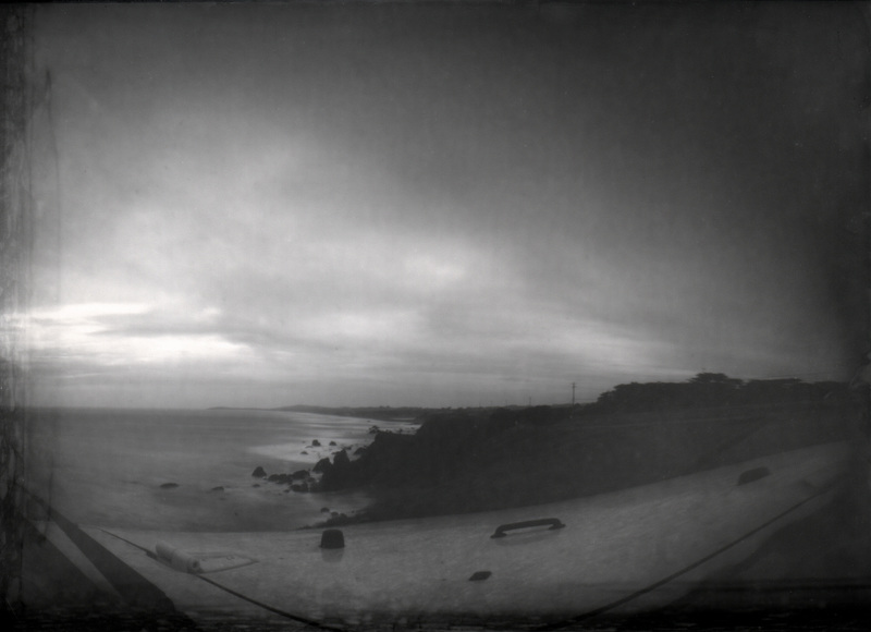

With re-exposing in mind, yesterday I decided to expose one for the sky. Paper negatives can make really neat skies, but usually everything else is a silhouette.
Through the windshield

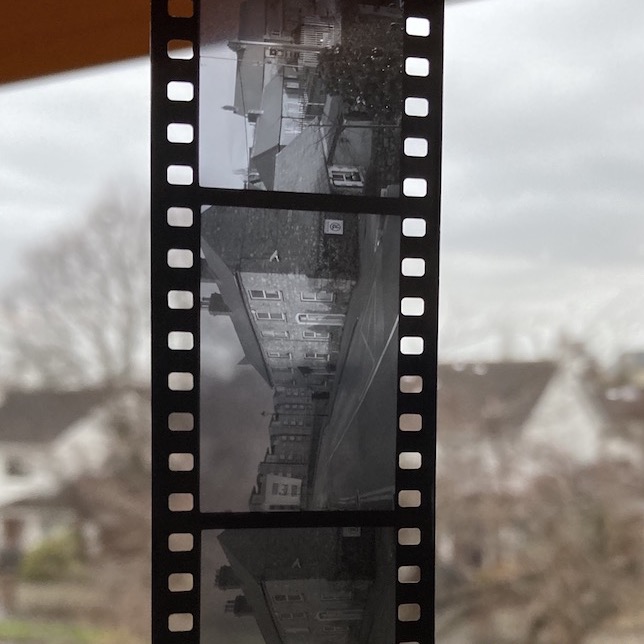

So I've been playing with this technique again after a bit of a break from it and decided to try using it to make b/w slides, and wanted to share the results.
The image attached was shot on 4x5 green/blue xray film (rated at 150 asa originally, with +3 stops for this process) and developed using dektol 1:2 for both dev stages and the same bleach concentration as with previous prints.
Original slide looks ok, maybe a little thin, but there's no staining. It did however take 6 minutes to bleach rather than the usual 3 with paper.
I just have to remember now if I need more or less exposure for better blacks.

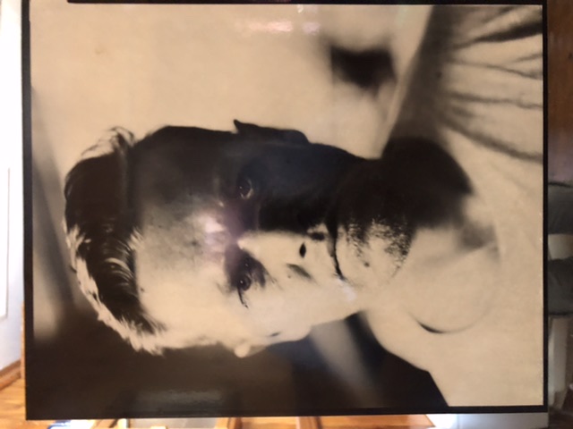

I also did an in-camera 20x24 reversal print recently. It looked great, but handling that much bleach was a little unnerving, so I don't think I would have ever tried it with traditional bleaches.
:smile:
It was fun, but the photo was nothing special just did it to see if it was possible.

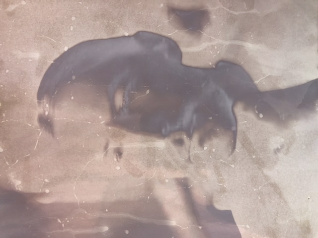

Yesterday was my first try with this process, on 8x10s, using Joe’s recipe for separate baths for the CA and H2O2. The first 4 images worked very well but then things went south on me. The 5th image did not bleach as well so I mixed up a fresh batch of CA and H2O2 thinking it was that. But it failed. I noticed that that I get a lot of black specks in the H2O2 tray and they seem to attach themselves to the paper.
I think my chemical measurements were not very clinical and could have caused the issues.
What would be the best CA and H2O2 dilutions?
Does anyone have an idea what the black specks could be?
Regards to the yellow staining, I actually like it. It adds to my vision.
Here is the 2nd image I made.
Here is an image from the new chemical batch
Apologies for the rotation... first time uploading to a forum.
