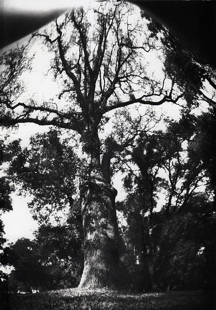

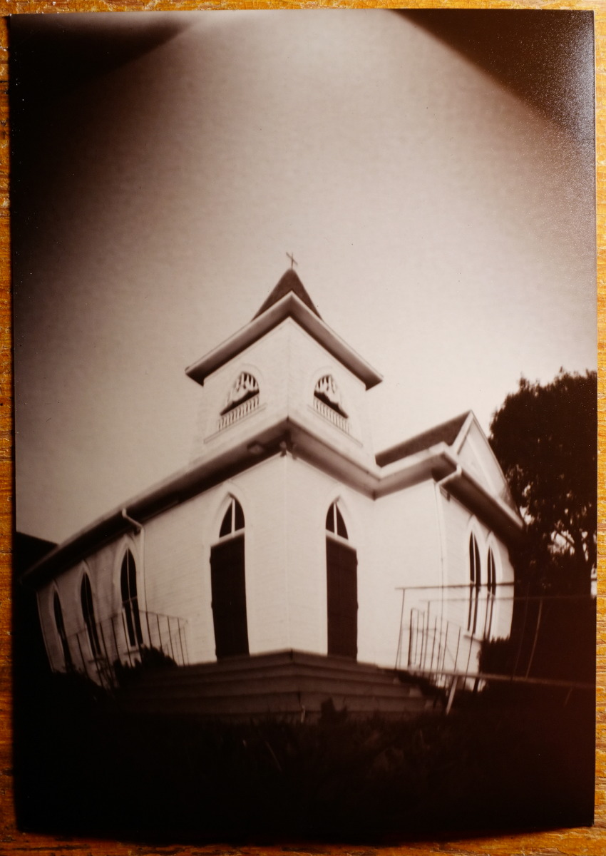

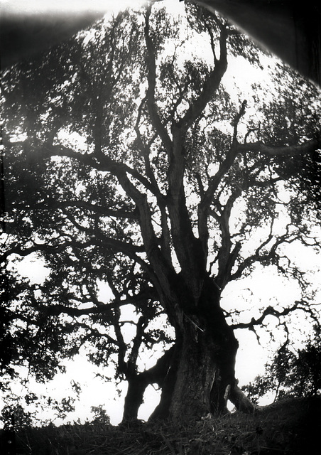

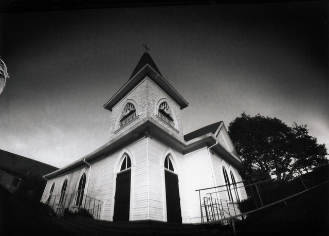

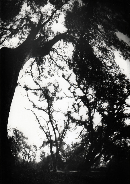

Here are a few. Getting close to the right re-exposure. Contrast could probably get better, but the trees were all mid-day and pretty contrasty situations. The church was late afternoon. These are all 5x7 paper in coffee can pinhole cameras.
Valley Oak
par Ned, on ipernity
Ragle Oaks
Live Oak
Church of the Oaks
Not sure if you can see it, but there's a small brown spot in the 2nd one, near the middle, in the sky next to the distant oak tree. I saw a black spot appear out of nowhere during the bleaching, and it turned into a brown spot... it went away a little during fixing and pot-ferri reducing at the end.
The fingerprint on the church one was from a nitrile-gloved finger, when I turned it around in the first developer... I didn't realize it was already fragile at that point. I've stopped touching them at all for the most part.

These look great Ned, it seems you're getting your process dialled in pretty well!
A couple of my early ones also have finger prints on them, so I've since switched to only using tongs, but still get the occasional tong-print : )

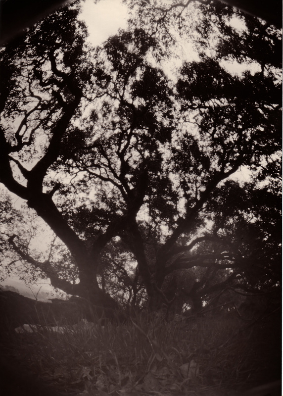

Here's the one developed with thiourea, to give some idea what the tones look like. Not a successful photo otherwise -- breeze moved the camera but it wouldn't have worked well anyway...

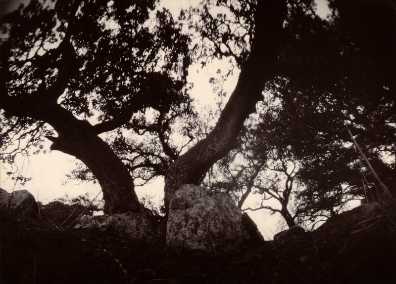

Reading the other thread that David started makes me think that the re-exposure might not matter or even be necessary in the thiourea-developed one I posted above. If that's true then it would make it easier to move the redevelopment outside and it would also remove a fussy step in the process. The next one I try will be:
1) expose paper negative
2) develop, stop, wash, bleach, wash
3) move outside, develop in thiourea
4) wash, fix, wash.
NedL
Aug 23, 2012
3,430
Sonoma County, California
The thiourea works very well and it appears to make re-exposure irrelevant. My initial reservation about it was that it would be difficult to control the re-exposure if you wanted to take it outside for 2nd development, but I made two today without re-exposing at all... and on my earlier one the re-exposure probably didn't do anything. I just carried them out onto my back porch and re-developed, then took them back inside to fix. The process is simper without needing to do a carefully controlled re-exposure.
Also, only a sample of 3, but all three have white highlights with no color cast. I didn't use any Farmer's reducer at the end like I've been doing on all the ones re-developed in LPD. I think our color cast may be related to re-exposure of silver citrate complexes, and that it develops out a little. The silver citrate complexes don't appear to be developed by thiourea at all. I think this makes the reversal process more "pure", like the dichromate process, where it really is just the remaining Ag bromide that gets turned into silver sulfide. If you like the dark sepia color, then this is a very nice alternative and seems to be less temperamental. I like the tones a lot!
It's fun to watch too. The re-development is nearly instantaneous... the picture suddenly appears on the white paper.
