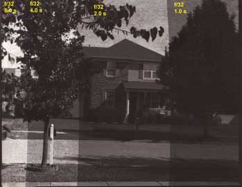

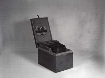

I just completed my initial experiments with the reversal process Joe outlined in this thread. I used the following process, similar to Joe's, but modified for Dektol 1+2 developer and a different 2nd exposure light source:
I used Arista EDU Ultra RC Black & White Photographic Paper, Glossy #2 5x7 cut to 4x5 to fit the film holders.
Expose in-camera at 1 sec at f/16 in full sun with incident light reading of EV 13.33 with diffuser on meter
Develop in a 1+2 dilution of Dektol for 30 seconds to 1 minute.
Rinse in water for 30 seconds
Bleach in solution of 175mL water + 125mL 35% hydrogen peroxide + 2 level teaspoons citric acid (8.2 grams) for 3 minutes
Rinse in water to wash off residual peroxide
Expose under 60 watt equivalent Daylight balanced LED floodlight, set to 24" height for 10-30 seconds

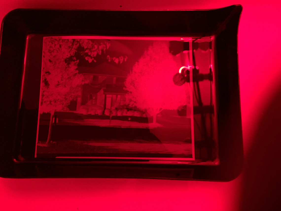

Develop again for 30 seconds - 1 minute; you can see, under the red lights, the image turns positive
Rinse 30 seconds
Fix in Kodak Professional Hardening Fixer for 2:00
Wash for 3 minutes
The test exposures were made using a Graflex Super Graphic camera and Schneider-Kreuznak Symmar-S MC 5.6/210mm lens

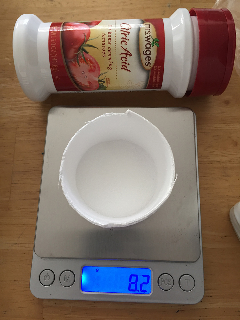

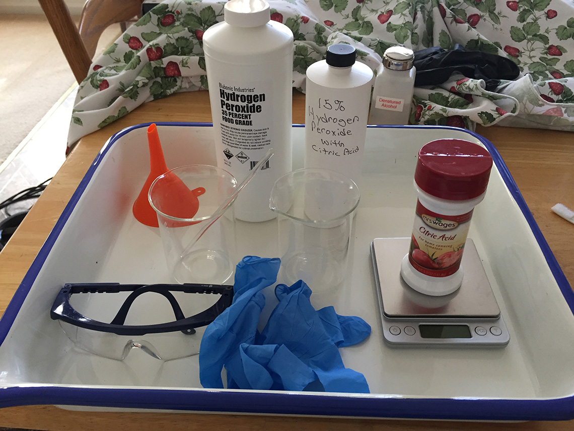

Getting ready to mix 15% hydrogen peroxide bleach
2 level teaspoons of my citric acid powder has a mass of 8.2 grams

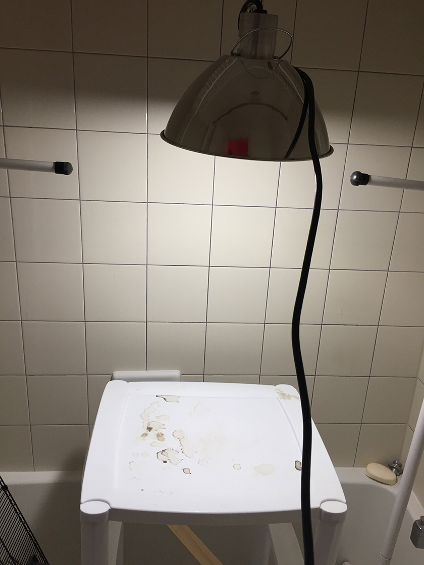

60 watt equivalent LED daylight-balanced spotlight in aluminum reflector holder. For the second exposure, this was about 24 inches from the image.

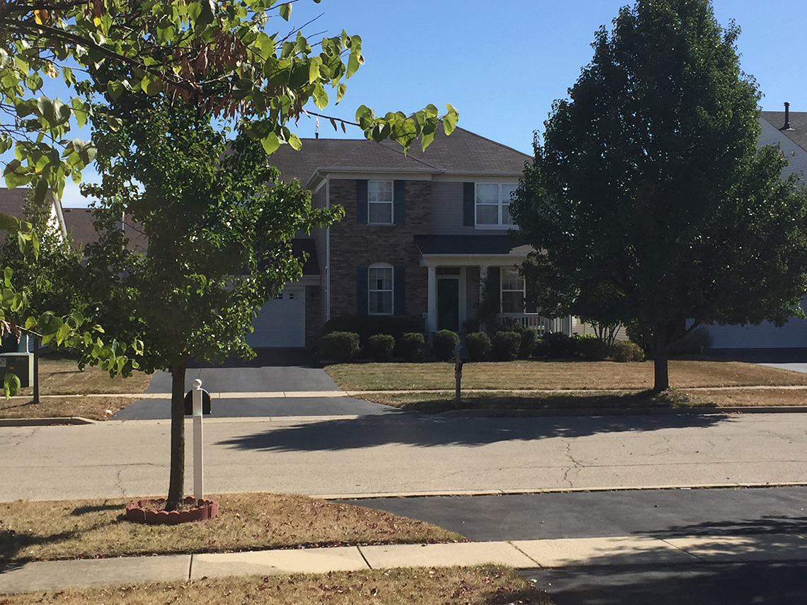

Test scene, shot off the front porch. I reversed this left to right to match camera prints.

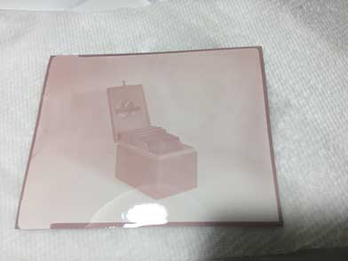

Test exposure, processed with a long 20 second secondary exposure. Base exposure was f/32 at 1 second with an incident light reading of EV 13.33 (full daylight). I selected f/32 at 4 seconds as the best exposure and used f/16 at 1 second as the equivalent exposure for the test prints.

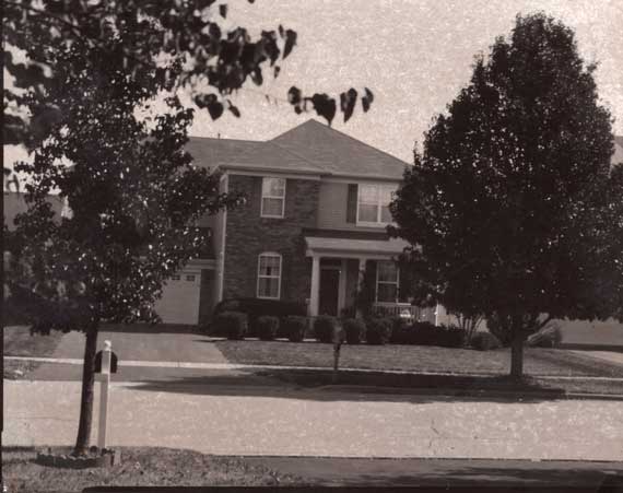

Typical print after first development. Note strange spot in street. This is BEFORE bleaching, so something odd going on. I suspect the Dektol was strong and the print was immersed unevenly in the developer.

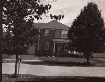

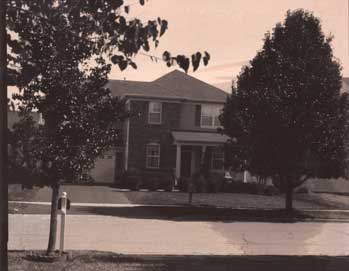

First print at f/16 and 1 second. 30 sec. second exposure. The Dektol 1+2 reached maximum density in 30 seconds. I continued to over-develop for 1.5 minutes, which contributed to the graniness, colored cast and poor bleaching. The secondary exposure was too long as well.
Second print at same exposure. Even more over-developed on both exposures. Second exposure about 20 seconds. Uneven immersion in developer caused uneven bleaching and weird blotches, I think.
Third print at same exposure. Over-developed but with shorter second exposure (10 seconds). There is some weird shadowing in the bright areas of the street. Uneven immersion in developer caused uneven bleaching and weird blotches Less mottling in sky, though.
Fourth print. Shorter development seems to yield the most improvement (30 seconds on both stages). 15 second secondary exposure. Shorter development. I took more care to immerse evenly in developer. Weird shadows gone.

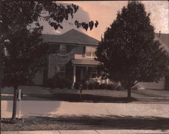

Last try for the day. I bumped up the exposure one stop, kept secondary exposure at 15 seconds and development times to 30 seconds. Bleaching works much better with shorter development.
Overall, I'm quite encouraged. I'm looking forward to more experiments with the process. As Joe just mentioned, getting a nice white highlight is proving to be a challenge with the added variables. I think a more dilute developer might help,
The color cast is not as evident viewed in-person as in the scan.
I wonder what the citric acid is doing for the bleach?
Regards,
Don

Don, good results. I've heard that the silver from the first development combines to form silver citrate, which is light colored and not light sensitive. The peroxide helps form citric ions to help attract the silver.
For less mottled highlights I reduced bleaching time to minimum time to fade the image; I suspect excess bleaching causes the peroxide to attack either the already bleached silver citrate, or the underlying emulsion or resin - not certain.

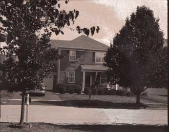

Thanks for the comments, Joe. I know the focus of the thread is using the peroxide bleach, but as I was completely unfamiliar with reversal developing, I made up a small amount of Kodak R-9 Potassium Dichromate bleach (full safety precautions!) and tried to make a few prints as a comparison point to the peroxide. The Dichromate bleaches the print completely white after about 10 - 15 seconds when fresh, so is certainly more active than the peroxide. I used my two 2400 watt-second Speedotron 102 flash heads at 3 feet from a test subject. This gave me repeatable lighting. I use this setup at full 4800 WS for wet plate tintypes. The approximate ISO of the sensitized collodion I use is 0.5 to 1 depending upon the age of the collodion. Since I was shooting the Arista #2 RC paper at ISO 1.5, I figured I could use my wet plate exposure as a benchmark. I ended up with one 4800 WS flash pop (2-2400 WS heads at key/fill 50/50) at 3 feet between subject and lighting at f/11.
Initial efforts came out poorly, until I dialed in the exposures. The finished image was completely black. I found that I needed to perform the second exposure for MUCH longer than anticipated, about two minutes or so. A faint positive image appeared, which seemed to be a good indicator that I had fogged the paper sufficiently. The image then darkened during the second development.
I also diluted my Dektol developer to 1 + 3 in order to get enough control of density during the initial development. I used a weak Kodak indicator stop bath to stop development at the desired point.
I also had to use a Sodium Sulfite clearing solution after the dichromate bleach to clear the orange staining of the paper. This would not be needed with peroxide.
After bleaching, followed fogging for a few minutes, this is the appearance of the paper before second development:
This is the image after the second developer:
Here is a second test image using the cutoff piece of paper from the 4x5 sheet, same exposures and processing:
My next step is to try the same exposures with the peroxide bleach and compare the results.
