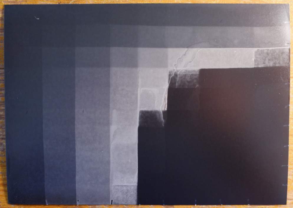

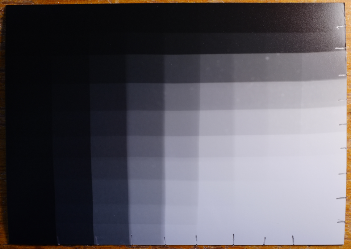

This is the "standard" that I've been using for testing. It's got varying amounts of blue and green exposure in steps, from no exposure at all in the lower right corner to full max black in the upper left corner. This is what it looks like after the 1st development.
Here's one I made when I was trying to simplify the process. After 1st development, I let it soak in 0.5% CA for 4 minutes and then put it directly into 3% H2O2. ( I skipped washing at all ) I was hoping that the carryover CA would be enough to complete the process, but there was enough carryover of developer into the CA to rehalogenate instead of bleaching to something nonactinic:
