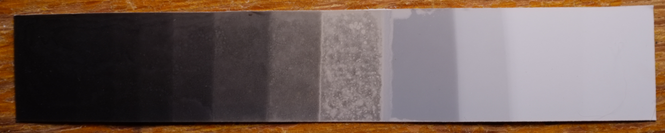

Right! If there is any salt mixed in the H2O2, it will still bleach completely, and it will actually bleach much faster, but it will not reverse.
Re-developing will recover your original negative image.
For example, this test strip:
was exposed in steps under the enlarger, 0 on the right and close to max black on the left. It was developed and washed, and then bleached in H2O2 + salt ( no CA at all ) in the dark. After a couple minutes, it was completely white with no visible image at all. It was never re-exposed to light. Then when re-developed, we recover the same image, not reversed at all.
If this happened while you were trying to do a reversal, it would cause trouble!

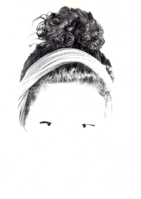

It makes sense! ( Total guess coming next :smile: It could have to do with the length of bleaching....
I just finished processing one... the photograph isn't good but the processing went well and looks good...good blacks and whites and mids. Got one more to try later this afternoon. It's fun!

This is what I was thinking: imagine you have one negative overexposed and one normally exposed... it could take the two negatives a different amount of time in bleach to reach completely white. A "zone VIII" area in one might have the same amount of "whatever makes the gold cast" as a zone "IX" on the other. But I agree if you are using about 3 minutes for all negatives, this explanation is probably too simple.
I had a disappointment. The second one I tried yesterday, the picture was really great. I left it face up in the bleach and at one point I got distracted and it sat for 15 minutes before I agitated it.. looked completely white after 30 minutes, I let it go 45m to be sure... but it has a big stain right down the middle. It must have bowed so that the center was near the surface of the bleach during that 15 minutes. I'm thinking of going back to try to recreate this one... but of course conditions will never be exactly the same again.
