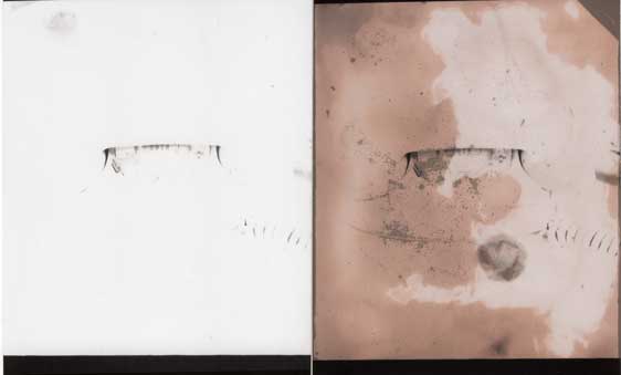

just a quick update, I've been working on the portraits I had initially hoped to use this process for and despite some early success my attempts seem to have slipped back to the grey/blacks of my initial tests.
My process is the same as when successful except that I had to mix new bleach (and variable first exposure) and since then they've been a bit hit and miss. I realise the 2 spoons of citric acid is hardly a definitive measure and there must be some slight difference in each batch of bleach, but the image is still bleaching to completely white in about 3 minutes.
And but despite this, 3 of the 5 images I developed today where grey/white and show a lot of mottling.
So now I have a series of stupid questions, and if anyone has any ideas..
How would over/underexposing the initial exposure effect the final image?
Can bleaching be incomplete, even if the paper is like totally white?
Does initial exposure effect how much 2nd exposure you need?
And finally, should the second exposure be the same no matter what, and the final effect will look over/underexposed like a normal neg/print?

I've had better success against mottling by ensuring full development on the first step. And using a stronger developer concentration that what I'd normally use on paper negatives - 1:10 instead of 1:15, in the case of Ilford liquid paper concentrate. I can't remember what H2O2 concentration you're using, but I've had better luck against mottling with a weaker solution. I'm theorizing a weak first development leaves sensitized, unbleached silver halides behind that end up getting exposed again and developed in the 2nd development, causing the mottling. And too-strong H2O2 may cause a 2nd type of mottling by some other means.
I've been using more exposure on the 2nd exposure than I was before. Like 15-30 seconds, enlarger at 16" height and f/22. You'll begin to see a tonal change to the image. The idea is to fully expose the remaining silver halides.
Under-exposing the in-camera image, followed by successful bleaching, results in an under-exposed looking final print, with dense shadows and highlights not as bright. That was my experience last week, between two prints exposed at ISO 3 & 6. I think the crucial step is adequate bleaching. I've seen inadequate bleaching on a print with adequate in-camera exposure but weak first developer; the highlights appeared dark under red lights but not developed enough to bleach. I've also seen too much in-camera exposure can also tax the bleaching step. Hence the reason why I got better results last week by raising the ISO from 0.8 to 3; even ISO 6 was better.
I'm thinking of limiting how many prints go through a single batch of bleach. Last week I used 75mL of 35% H2O2 with 225 mL distilled H2O (a 9% concentration) and 3 tsp of citric acid powder, for two 4x5 prints. There was a bit weaker bleaching by the 2nd print. I think that's the limit for that volume of solution at that concentration, unless I figure something out better. So it seems this process needs a lot of fresh chemicals.

Thinking about your print problems, you seem to be getting good bleaching, as you say the prints turn white-ish. So if the final positive is too dark, you may be under-exposed in-camera, with successful bleaching of whatever highlights turned dark from the first development (and unexposed shadow areas also white), hence why the print, post-bleach, looks white. Then you have lots of unexposed halides that get fogged/developed in the 2nd.
EDIT: To sum up, give more in-camera exposure for these portraits, and stronger/longer developer. It seems like your bleaching is good.

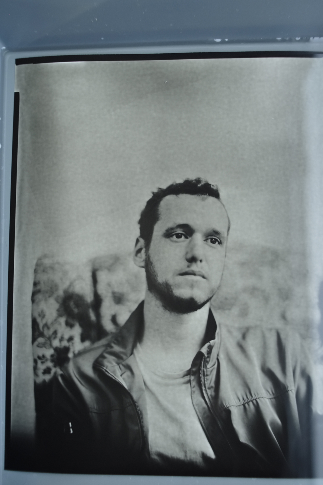

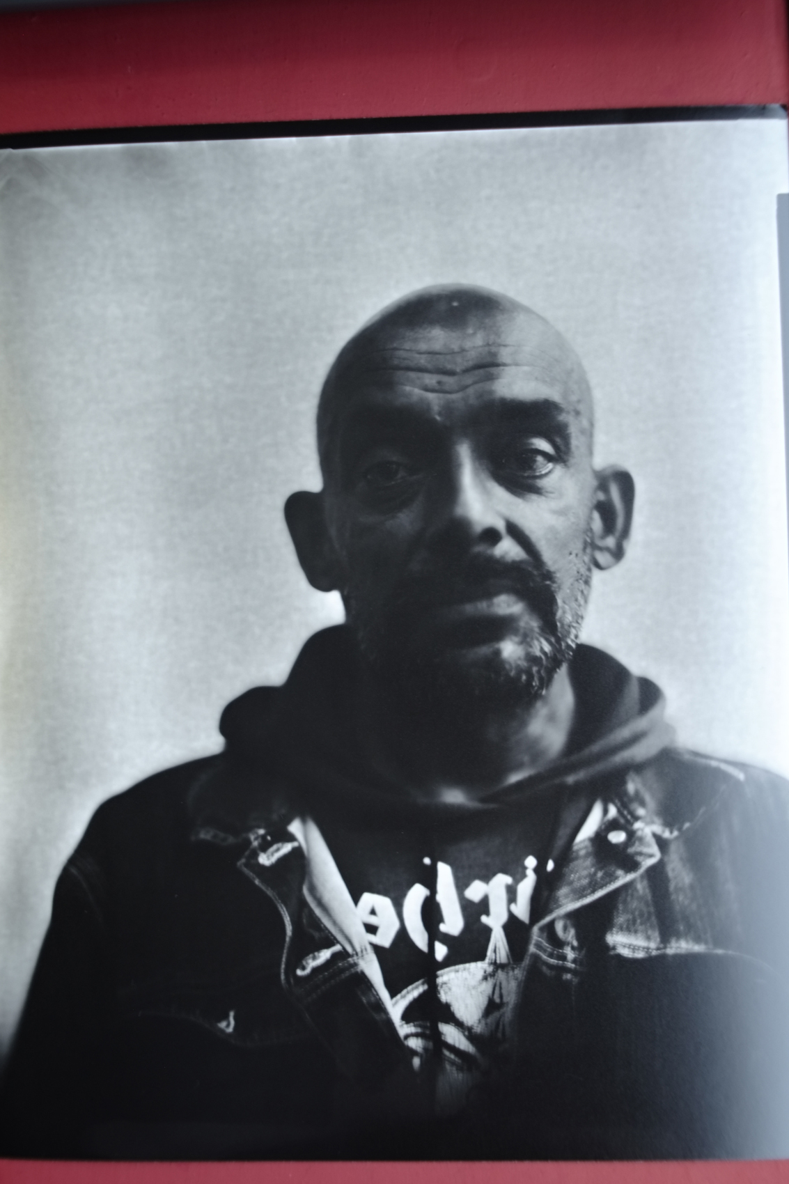

So I just had the opportunity to take and process another image, and I think it illustrates well what I mentioned in my previous post ref the first exposure.
The first image, which is grey and black (and no whites) looks to be the better exposed, maybe just a little over, however the second image is the one with white highlights*.
Both were processed in the same bleach to completely white and re-exposed for 2 minutes with the enlarger.
Unfortunately I'm unable to scan them at the moment, so had to snap them with my digital camera, but I think the difference is visible.
View attachment 188674 View attachment 188675
*it looks a little more white in person, especially the lettering, but the lighting has added a little bit of a yellow cast
I think the first has a good in-camera exposure, but was overexposed some during the second exposure. Try 1 minute. Highlights (background) look dark.
The second seems slightly underexposed in-camera and also overexposed on second exposure.
Just my impression based upon my own trials....

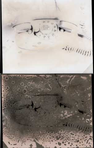

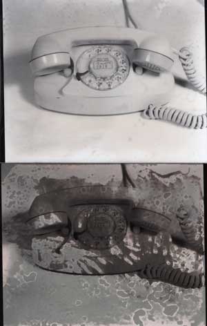

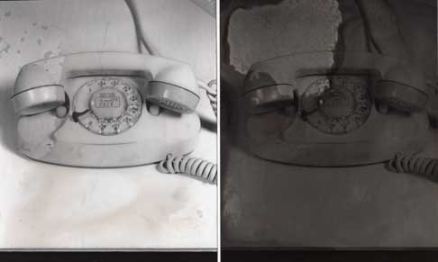

Yesterday I decided to try out my "new" used Minolta IVf flash meter to see how it performed with my studio flashes and the Arista #2 paper. I mixed up fresh chemistry for both the hydrogen peroxide/citric acid bleach and potassium dichromate/sulfuric acid bleach.
For each exposure setting, I took two identically exposed shots with exactly the same flash settings. As there was very dim ambient light, I simply opened the shutter, popped the flash manually, and closed the shutter.
I tried metering at ISO 1.5, adding 3/4 stop for the bellows extension factor on my 210mm lens. This resulted in consistently overexposed images. Metering at ISO 3 (incident reading) resulted in a very good exposure after adding in the bellows factor.
The developer was Dektol mixed 1+1. The peroxide bleach was mixed 175mL water + 125mL 35% hydrogen peroxide + 2 level teaspoons citric acid (8.2 grams).
The second exposure was about 60 seconds under a 60-watt equivalent daylight-balanced flood lamp. I exposed the front and back of each print with constant motion to avoid hot spots.
The subject is an old Princess phone I grabbed off the shelf as a test subject. All scans are in color. I adjusted the gamma to neutral with full dynamic range in the scan, but otherwise the images are not retouched.
Here is my first test. The first image is with dichromate, the second with peroxide. Otherwise, identical processing was used. Both images are very overexposed, but I did note that the peroxide bleach almost instantly bleached the image white. The dark mottling showed up during the second development.
Second test shots. The dichromate process was routine. Exposure seems good. This time I noticed intense fizzing from the peroxide bleach, with an almost instant bleaching to white. The darkness and blotchiness in the peroxide print on the right showed up only during the second development.
The third set of test prints. I mixed fresh peroxide bleach for this test. These are overexposed again due to some lighting adjustments. The weird spots on the peroxide-bleached print showed up in the second development.
The final test prints. This is the best exposure in the batch. The dichromate-bleached print has a few spots, but looks good. The peroxide bleach is, well, .....
These tests were side-by-side with identical chemistries except for the bleach. The uneven bleaching is a real mystery. The clearer areas of the peroxide-bleached prints bleached almost immediately, but the darker patches took many minutes to lighten and never really bleached to complete white. The overexposed first print did bleach completely from a near-black first development. However, the second development revealed the dark splotches.
At this point, I am at a loss to explain what is happening as there seems to be no repeatability with the peroxide process. The potassium dichromate bleach works so well and gives such repeatable results, I think I will stick to that chemistry and abandon the peroxide. The dichromate bleach requires care in preparation and handling. It lasts for many, many prints, is inexpensive, and can be rendered relatively inert by adding sodium sulfite until it turns a deep green from orange.
I think the best explanation for what is happening might be that offered by nmp quite a few postings back. The peroxide bleach forms silver citrate as it bleaches, which is insoluble and remains in the paper. Silver citrate is slightly actinic, meaning it is light sensitive.
That's pure speculation, I'm at a loss to explain the wildly variable results.
BTW, the faint discoloration on the dichromate bleach examples is likely due to not leaving in the sodium sulfite clearing bath long enough to remove the orange stain from the print. It shows up on the scanner, but is not really visible on the print in room lighting. Of course, the clearing bath is not needed with the peroxide bleach.

jnanian,
Thanks, and it's not that I wholly dislike them, but that it would be nice to have some small amount of control over the final image. And you're right, it seems like a technique that gives lovely midtones and shadows.
I wonder if you do experimentation first in the darkroom with the use of a step wedge, like that made by Stouffer
thanks for the info, but unfortunately I already tried that and it's how I arrived at a 2 minute re-exposure, but now 2 minutes doesn't seem to be working anymore. I tried some new images today and re-exposed them for 4 minutes, which seemed to improve the highlights even if the images were a little underexposed.
It's not so much that I mind them not being perfect or exactly alike, it's just I'm burning through paper at the moment.

Don, is the paper wet during the second exposure? Has the front and/or back sides been superficially dried via squeegee? Just curious.
DonF
Jul 19, 2016
285
Saint Charles, Il
I did not squeegee, but I see what your getting at! I have softened water, so it sheeted off pretty well after the post-bleach rinse. These are probably the worst results I have gotten. Wildly uneven bleaching!
Joe VanCleave
Jan 20, 2004
677
Albuquerque,
Pinhole
At a certain angle, a wetted paper surface acts like a good mirror, reflecting lots of light back off before it gets to the emulsion underneath. This might have the effect of reducing the second fogging exposure in those areas. Just another variable to consider. Although the uneven blotches don't look like they're from reflections, they appear too random.
DonF
Jul 19, 2016
285
Saint Charles, Il
I had the print in constant lateral motion, exposing from front and back to avoid hot spots, so it seems unlikely the water would provide such defined spots.
I did completely replace the peroxide bleach with a second batch after the first two prints with an identical mix. The results were different between the first two and last two. I'm tempted to say the issue is with first development time, but I went a full 90 seconds with 1+1 Dektol, which has previously been more than sufficient to avoid the dark patches. The subject was brightly lit on a white background, so it could be additional development time was needed to fully reduce the exposed silver.
I am wondering about separate first and developer baths, with a small amount of hypo added to the first bath, as is recommended for reversal film processing. This is cited as "removing excessive silver halide" and is only used in the first developer. I wonder if that would improve the efficacy of the peroxide bleach.
I am thinking an experiment using phosphoric acid instead of citric might prove interesting. The bleach acts differently from print to print with the same bath. I noticed intense fizzing from the exposed areas once, with no fizzing at all the next print.
Don
nmp
Jan 20, 2005
2,101
Maryland USA
In addition to the uneven bleaching, it seems to me from your photographs, that the emulsion is really getting worked over in the peroxide bleach. Weren't you using a 9% peroxide bleach before rather than what looks like 14% in the above experiments.
Also, I am thinking why does Kodak patent always use NaOH to get the pH to 4.5-5.0 range in all of their example recipes. Although they do not specify the reason for it in the patent that I saw, my guess is it is to provide a more stable environment for the gelatin. I don't know how that affects the bleach rates. This seems to be one significant difference with the dichromate bleach where there is a simultaneous hardening/tanning of the gelatin, as pointed out by you earlier.
Alternatively, I wonder if one can use a hardening developer in the first develop step to counter the effect of peroxide.

I have been using 15% peroxide consistently, adding two level measuring teaspoons (7.4 grams for the stuff I bought) to the 300ml mix. It does appear there is some weirdness with the emulsion going on. I may have performed less agitation than I usually had with the last two, as I was dealing with a minor floor splash of the bleach from a standing wave in the tray!
The recipes for bleach all seem to be quite acidic, so my assumption is that the low pH is needed for the oxidation reaction. I'm no chemist though! I did see that the patent did specify a neutral to slightly acidic solution. The Kodak R-9 bleach recipe (potassium dichromate and sulfuric acid) certainly has a pH much lower than 4.5.
Don
DonF
Jul 19, 2016
285
Saint Charles, Il
Another factor in my results could have been temperature. I mixed the peroxide straight from the refrigerator at 38 degrees F., with room temperature distilled water. Although it sat in an open tray 20 minutes or so, it still may have been quite cool.
Don
