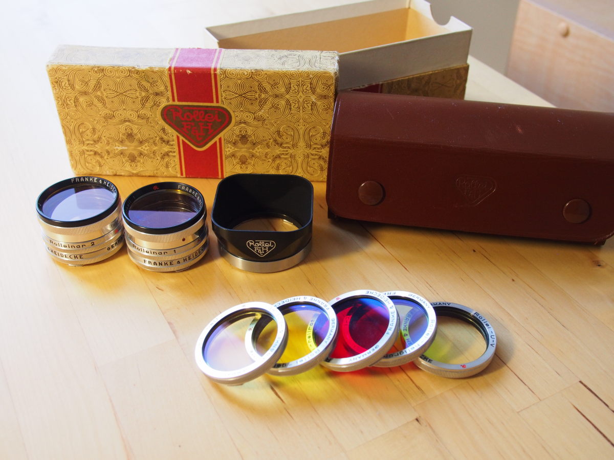

I use a Bay 1 filter set from Rollei which fits fine, it has a lens hood, filters (light yellow, medium yellow, red, green, UV) and the Rolleinar 1 and 2 close-up attachments. All these work great with the Autocord. I saw this kit already in various versions, I guess buyers could chose which filters are in... Here is mine:

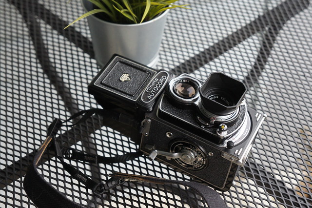

Autocord Hood 1 by Nokton48, on Flickr

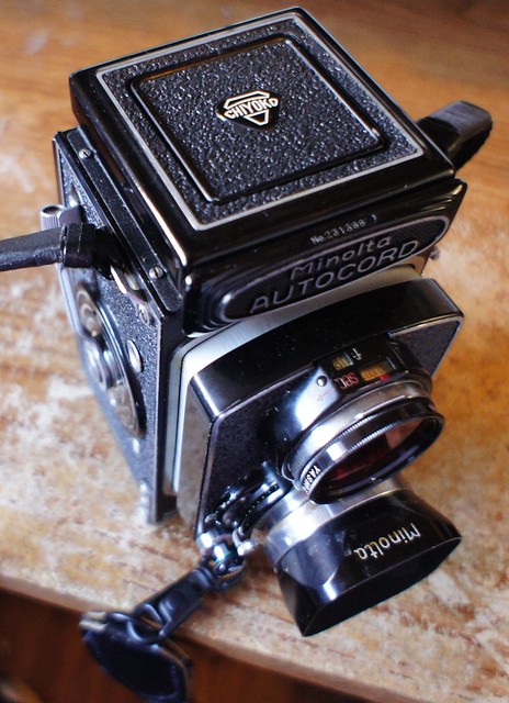

Snagged this Autocord lens hood for $25 including original case. Came with petrified scotch tape around the outside, which will clean up OK.
Recommend this hood, stays where it should, and allows use of all my filters, including my Spiratone B30 ones.
