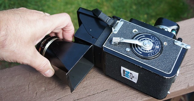

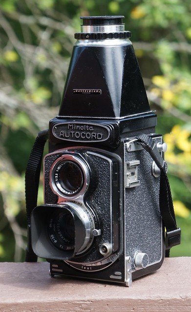

Cool idea. The Hassy chimneys are strangely cheap for a Hasselblad accessory, too, and they have a really well corrected magnifier in them compared to some other chimneys and waist levels I've used.
I've seen photos of some of Penn's cameras, where he just slapped on some gaffer tape to hold it together. I am thinking of the 3M Black Teflon Tape as that is very long life and looks good. The fit is about perfect :smile:
I say go for it! Penn is one of my favorite photographers. There was a wonderful exhibit of him at the San Diego Photography Museum that I just wandered into a few years ago (with my autocord!!) and was just blown away by his artistic eye and his amazing technical ability. His ultra large format stuff really has to be seen in person.
