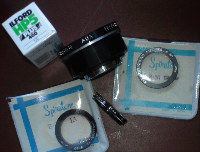

B30 Accessories for Minolta Automat by Nokton48, on Flickr
Found some Bay 30 Accessories a few days ago, while digging around the studio
YashicaMat Auxiliary Tele Lens, Yashica Dark Red filter, Spiratone Diffuser and 1A filter.
