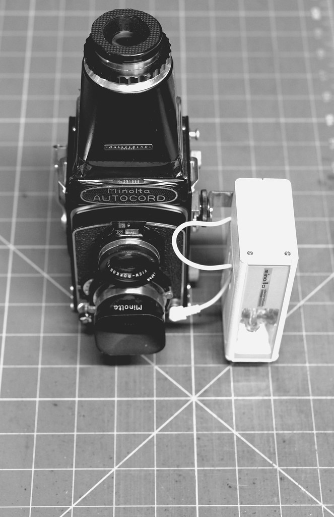

This is the Minolta SRT Electroflash 1, hooked up to a Minolta Autocord. The Stovepipe is Hasselblad and works perfectly. It's FUN to use, I've been popping off shots, on Eastman XX 5222 120 film. Really enjoying using it, it carries easily and works without fuss. Good for incognito photography.

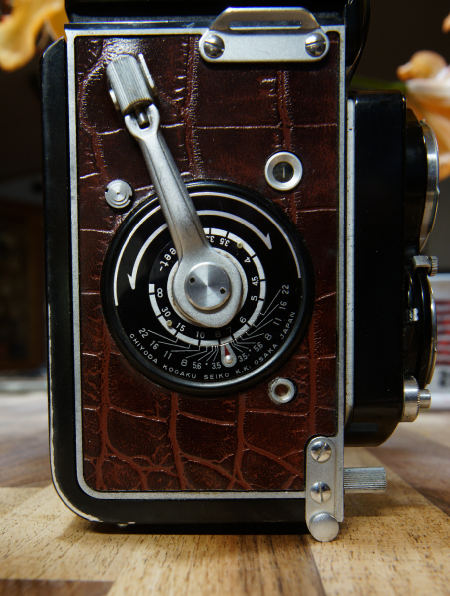

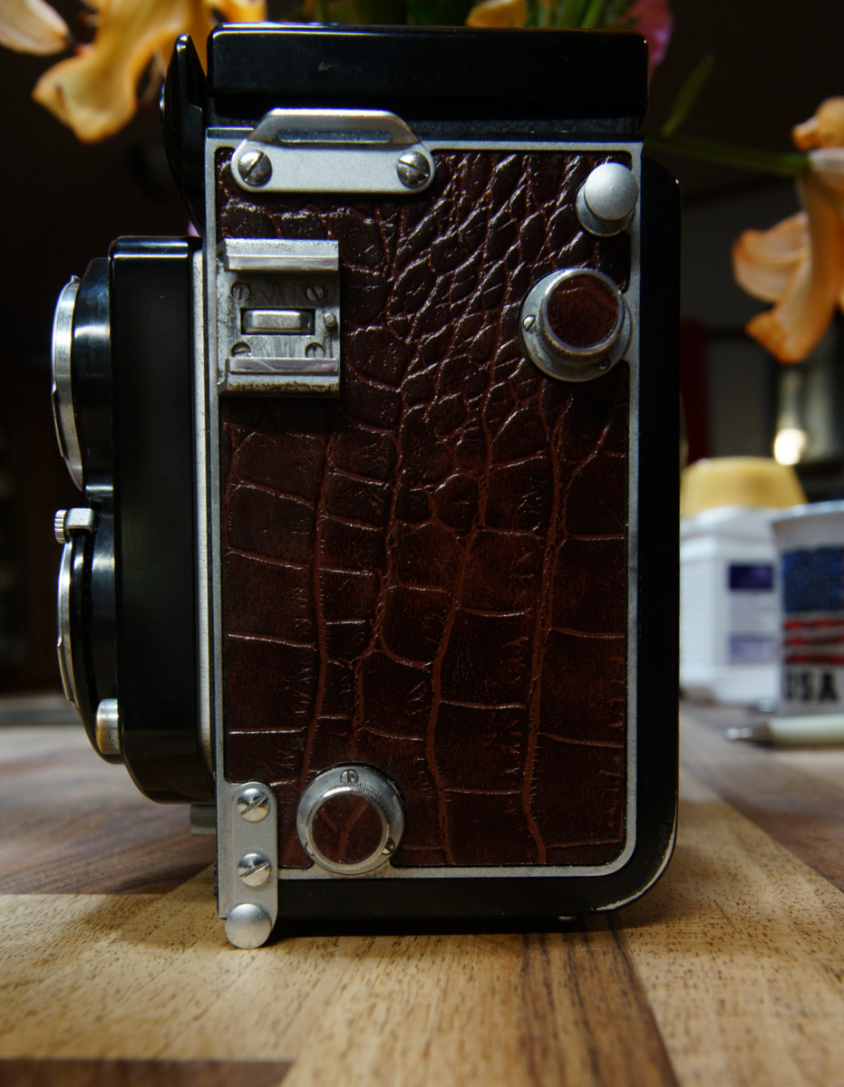

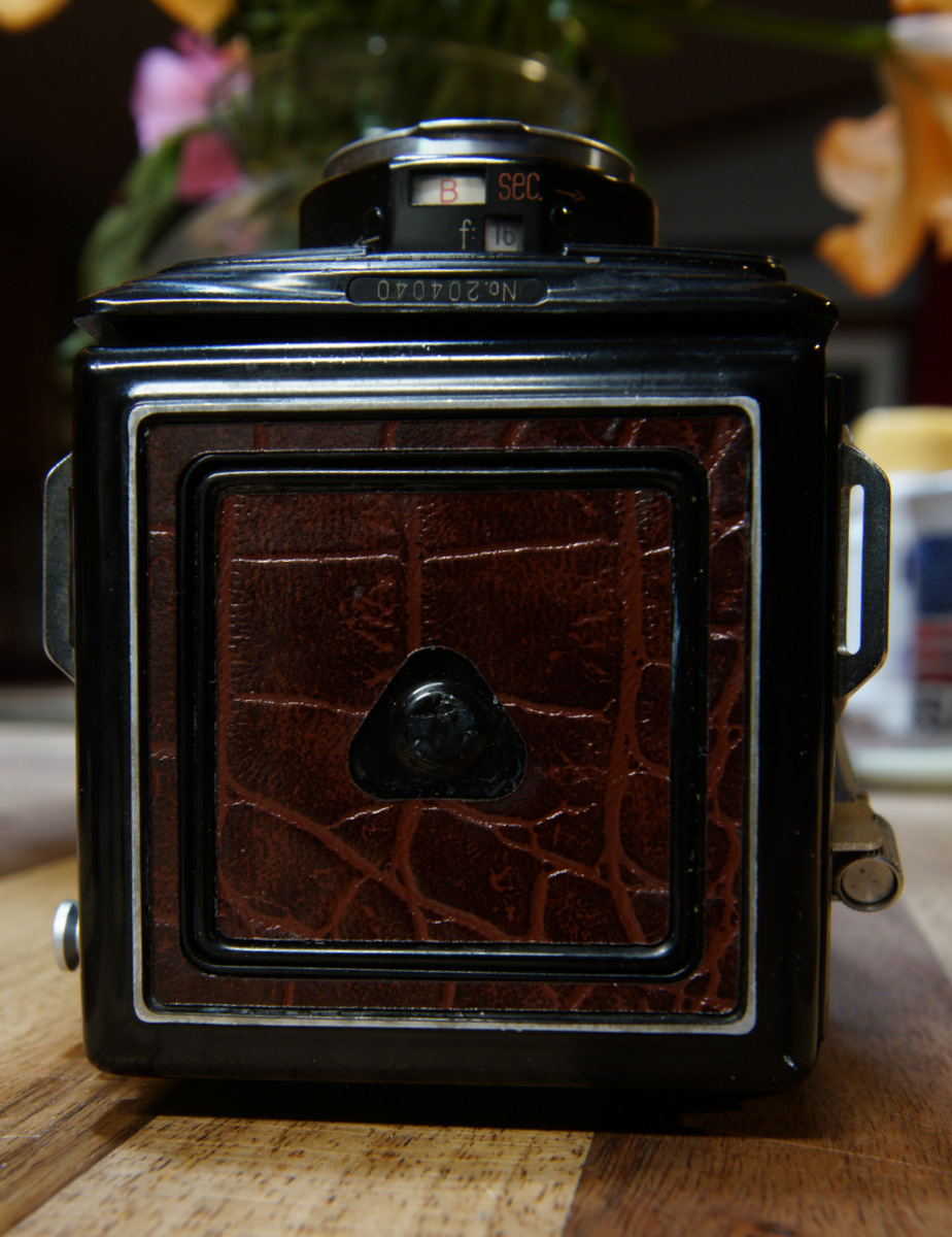

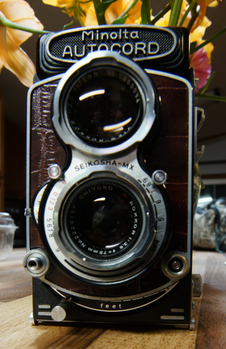

I just bought a nice Autocord off the big auction site. I had one many years ago and really missed it after I sold it to a college kid. When I got the camera its shutter was froze and the leatherette was falling off, but other than those two things it was in great shape. I fixed the shutter and put a dark brown croc skin on it and now it looks and runs perfect except for one little detail. It's missing the little Chikoyo emblem in the center of the top hood. Does anyone have a spare hood they could pop the emblem off? Mine is the 1958 export version I believe. Here's a picture:
