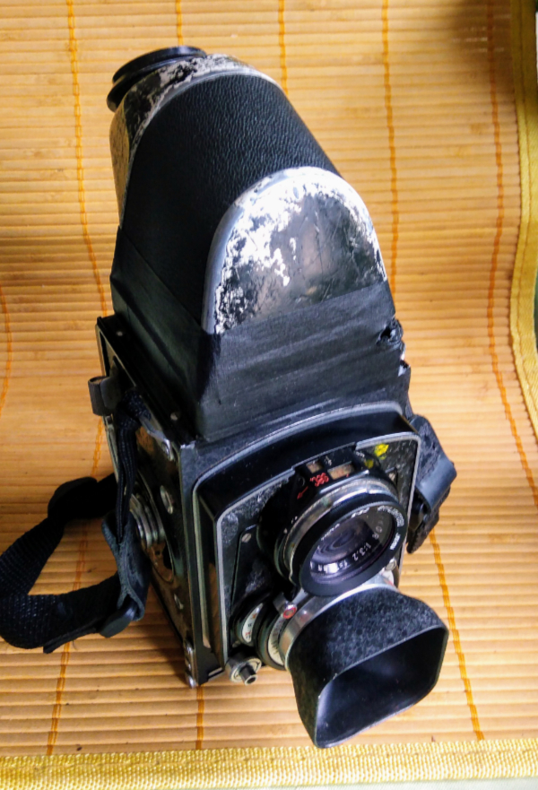

I'm thinking of grafting a Hasselblad Stovepipe Finder to an Autocord viewfinder frame. Similar to what Irving Penn did with his Rolleiflexes......
What do you Guys think? Anybody here have a correct Autocord viewfinder frame they can sell?
If you use an Autocord finder frame and want the Hassy finder to fit in, you'll need to grind away much of the bottom flange on the Hassy finder. Won't fit inside the frame without it. Drop me a note if you want a frame to use.
This is my daily beater these days, Autocord with Hassy NC-2 prism scabbed on. On this prism the flange is actually a steel frame held on by screws. So I simply unscrewed it and the prism slides right into he focus screen frame after removing the moving parts. No need to grind the flange. The 45 degree prism is very nice- corrected view, sits against face with a nice angle, rests in hand smoothly with focus knob and shutter release falling nicely in place. Look for Kiev prism if the NC-2 is too expensive (I bought this years ago during the 'great hassy dump' early 2000s so paid maybe $15. A guy who shot Hassy pro from the 60's practically cried when I told him what I paid for it; he paid $600 or so).
The prism needs to be raised approx. 5mm to actually focus on the screen. With the chimney, I think the focusing range of the eyepeice takes care of this, but still probably best to raise it. I used some basswood strips, 1/4" by 1/4" (or was it 3/16 x 3/16?) to raise it up.

Hassy Autocord Stovepipe Viewfinder 1 by Nokton48, on Flickr
Hassy Autocord Stovepipe Viewfinder 2 by Nokton48, on Flickr

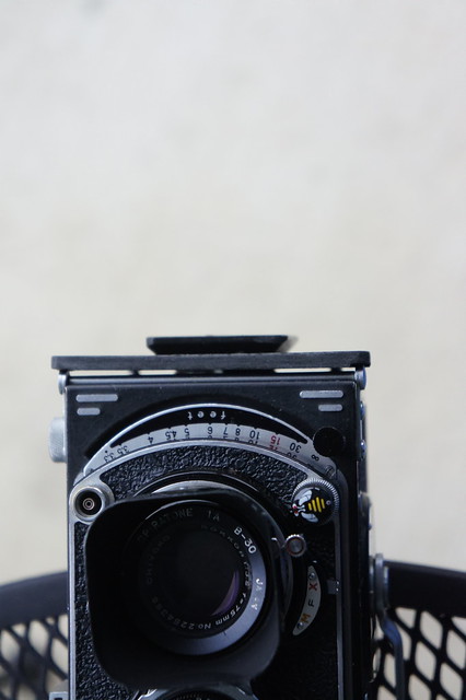

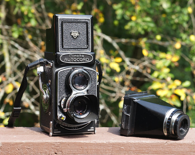

The Hassy Autocord Stovepipe Viewfinder is finished and I like it! It attaches with four screws, easy to interchange the two finders.
It took about half an hour to take the original WL finder apart and I did use my dremel in a couple of spots so that the stovepipe would sit flat on the finder frame. I used 3M 850 teflon tape to attach the finder to the frame. It dosen't change the Hassy finder at all, if I take it apart it can go right back onto my blads.
The tricky part is reattaching the ground glass and fresnel to the bottom of the modded finder frame. Kind of fiddly to do.
A success! :smile:
Autocord Hassy Stovepipe Vie Frame Hack by Nokton48, on Flickr
I like this hack. I can remove my eyeglasses and dial in the ocular to make the screen grain razor sharp. Magnification is increased a bit. Useful. No spurious light spill onto the screen with the stovepipe. I find I can study the composition more intensely with the stovepipe.
I can change it back to the original waist level finder in under five minutes Balance while carrying the Autocord with stovepipe is actually quite good. Not at all top heavy like with prisms.

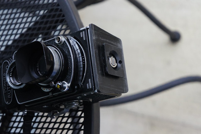

Minolta Autocord Baseplate 1 by Nokton48, on Flickr
Minolta Autocord Baseplate 2 by Nokton48, on Flickr
Minolta Autocord Baseplate 3 by Nokton48, on Flickr

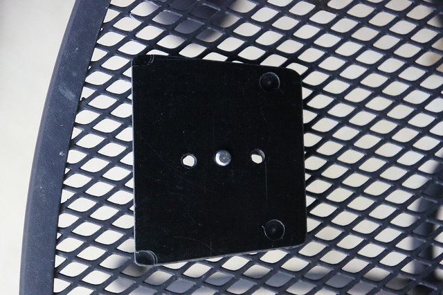

I was unhappy with the way my Autocord could swing when attached tightly to a tripod. Very annoying.
Dan Daniels machined from very heavy plastic this custom baseplate for the Autocords. This one has an Arca mounting plate machined, but he added two 3/8" holes which he threaded. I put my Manfrotto Hex Plates on this and it is now solid as a rock. Recommended!
Dan Daniels is indeed the Autocord Man!!

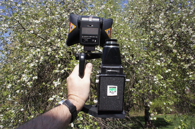

Minolta Autocord Bacharach Bracket 283 Photoflex Inflatable 1 by Nokton48, on Flickr
Minolta Autocord Bacharach Bracket 283 Photoflex Inflatable 2 by Nokton48, on Flickr
Minolta Autocord Bacharach Bracket 283 Photoflex Inflatable 3 by Nokton48, on Flickr

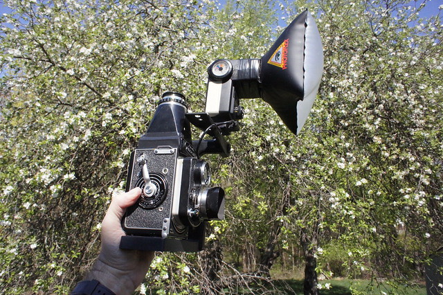

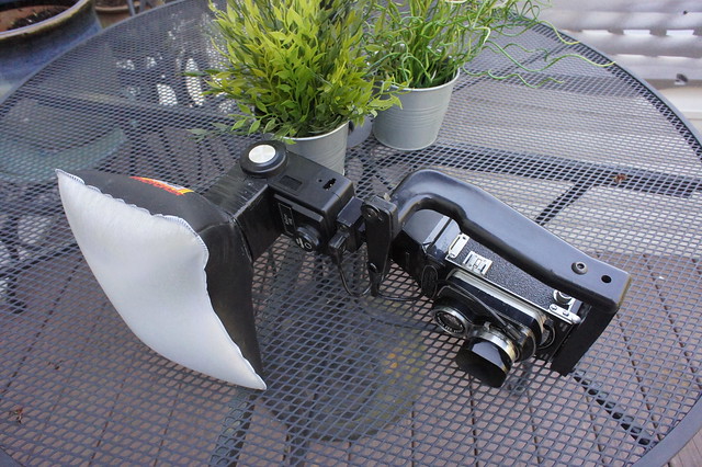

A lightweight extremely well balanced and ergonomic flash on camera Minolta Autocord setup. Similar to what I used with Mamiya C's and Hasselblad for bulletproof photography. I love with TLRs that you can see the flash going off while you are viewing. For a second you can see what you got! No need for chimping
The Bacharach (precursor to the Stroboframe) works really really well with the Autocord and the Hasselblad Stovepipe Viewfinder. When you absolutely have to get the shot without fuss this is the rig to take. Weighs practically nothing
