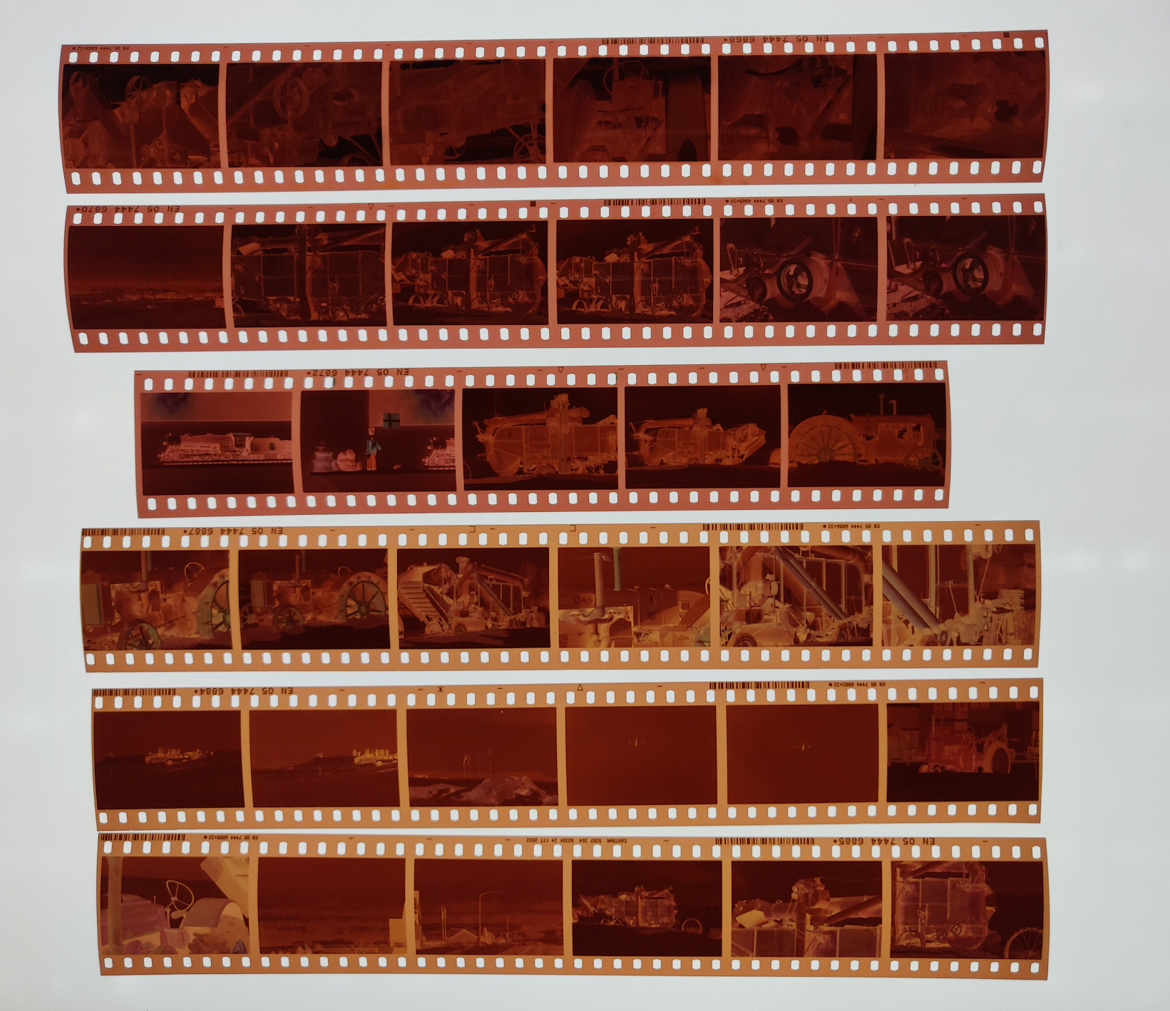

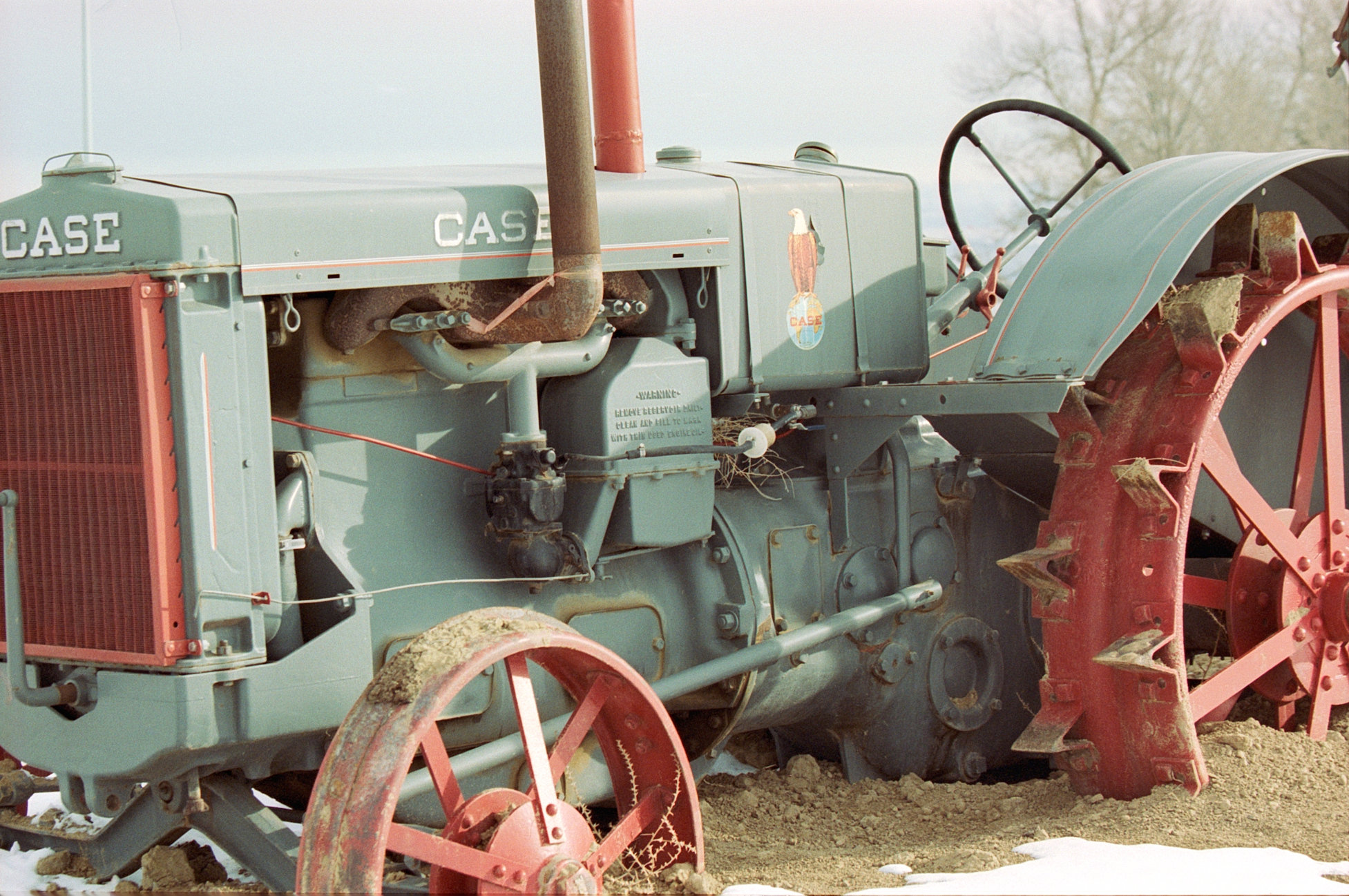

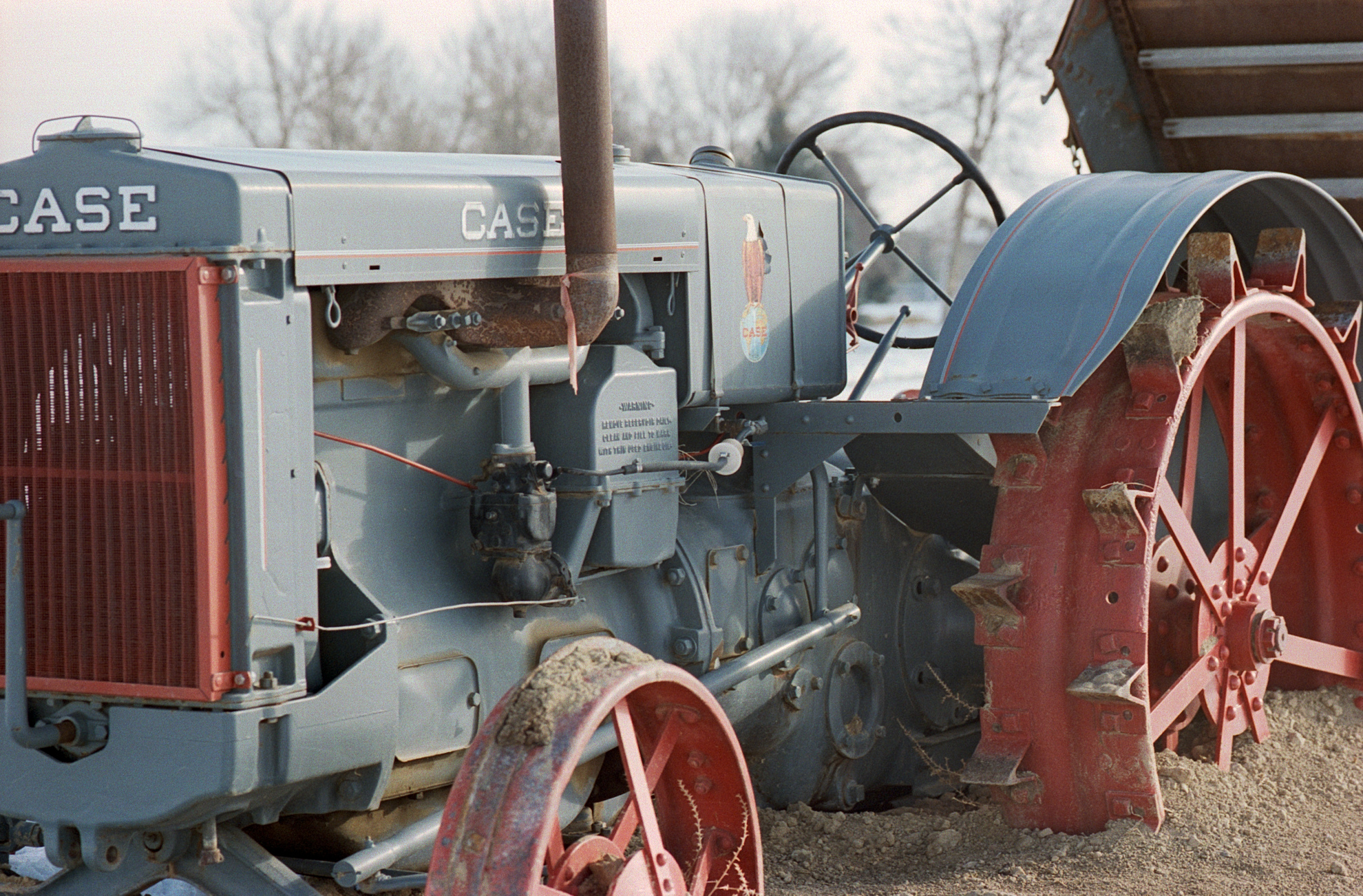

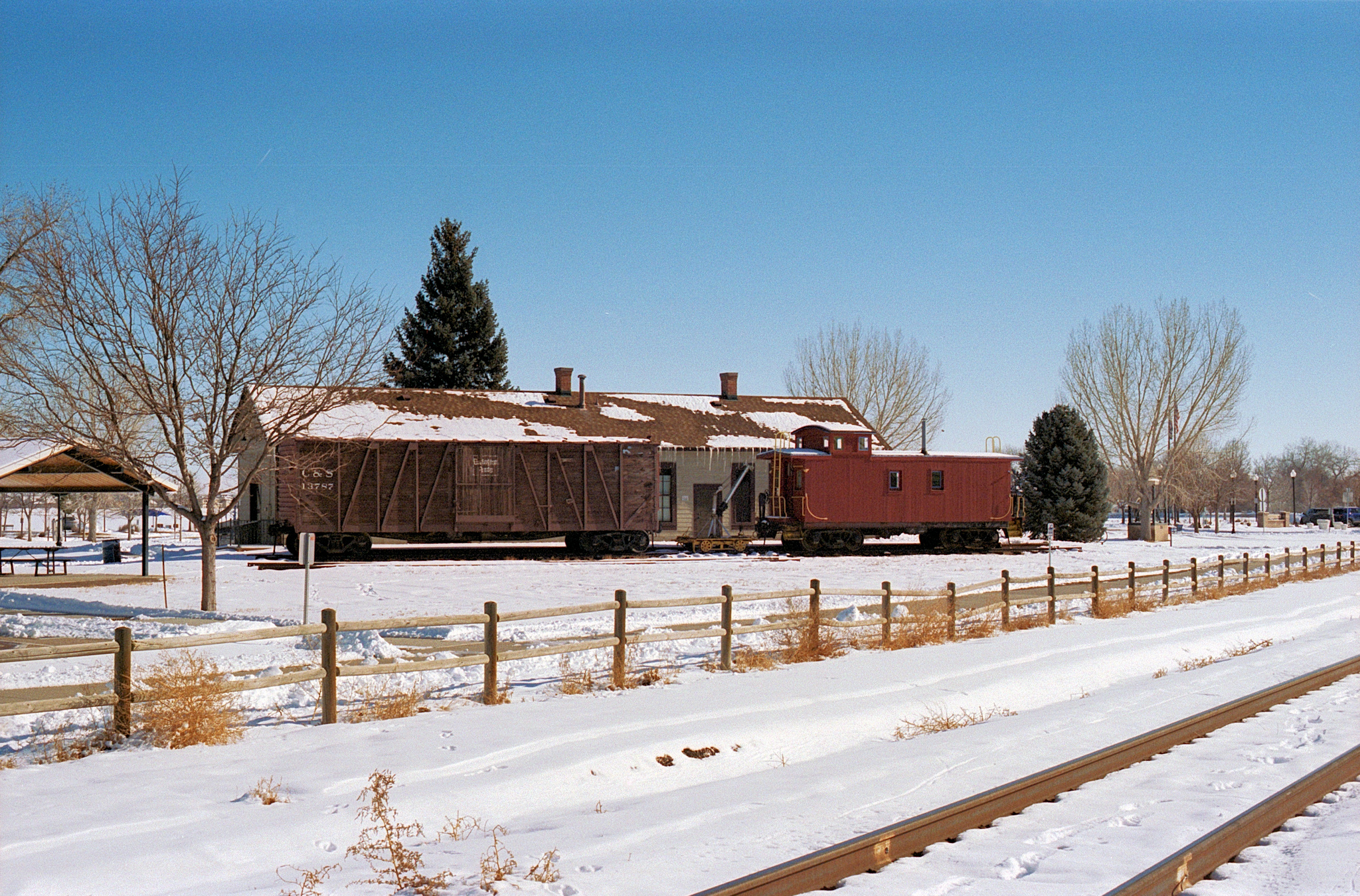

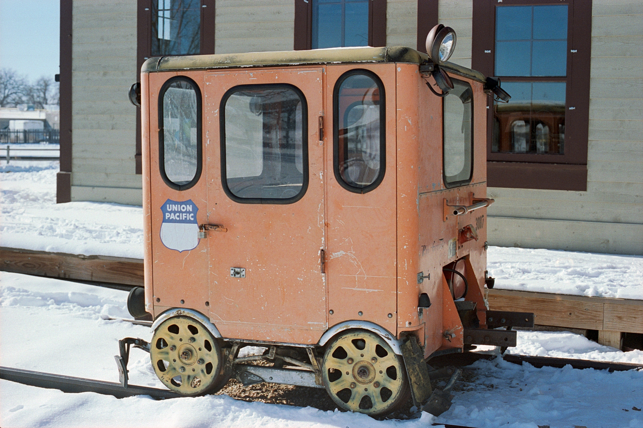

I did another roll where I prewashed before developing. I used Kodaks ECN2 Sodium Carbonate recipe. I also did a quicker DWC post wash ( again trying to be touchless in this process ). I had no left over remjet to wipe off. What I notice, the mask is darker ( similar to the very first roll of 50D I did that looked OK ). I really don't know what this Vision 3 film should look like. Using the pre wash, I think the color is much better. One tractor is my DWC post wash, the other is using the ECN2 prewash. The Prewash version is much truer to the original. One the pic of the negatives, the top three are the DWC post wash, the bottom three are the ECN2 pre wash. In both cases I think I will reduce my development time slightly.
The center pic is the pre wash.
View attachment 325520View attachment 325521View attachment 325522

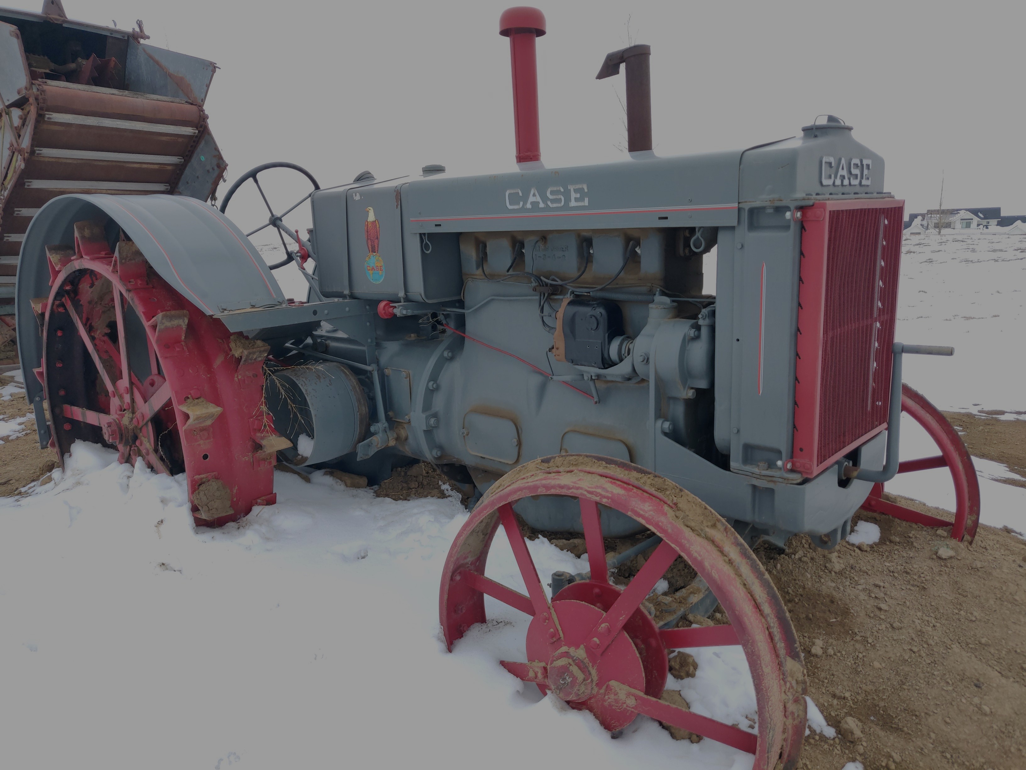

I did another roll where I prewashed before developing. I used Kodaks ECN2 Sodium Carbonate recipe. I also did a quicker DWC post wash ( again trying to be touchless in this process ). I had no left over remjet to wipe off. What I notice, the mask is darker ( similar to the very first roll of 50D I did that looked OK ). I really don't know what this Vision 3 film should look like. Using the pre wash, I think the color is much better. One tractor is my DWC post wash, the other is using the ECN2 prewash. The Prewash version is much truer to the original. One the pic of the negatives, the top three are the ECN pre wash, the bottom three are the DWC post wash. In both cases I think I will reduce my development time slightly.
The last pic is from a digital camera for comparison. It was a little later in the day, not as bright out.
View attachment 325520View attachment 325521View attachment 325522View attachment 325529
My results from Vision3 200T in C-41 chemistry have a darker than normal C-41 film base, like the top set in your photo. I always pre-wash in baking soda to remove the remjet.
