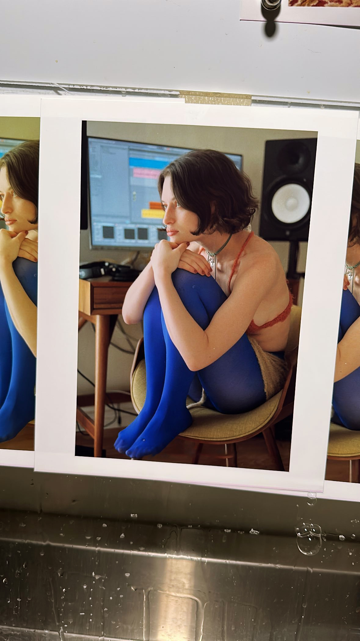

RA-4 print is standard 2m dev and 2m blix at room temp. Paper is Fuji Crystal Archive II glossy. The 8x10 was scanned with an epson flatbed and then adjusted in capture one so that the scans from the epson match a scanned color checker. Basically the print on the computer screen matches the print in hand well enough. No digital trickery or anything like that. Adding an iPhone shot of the print on the board in the darkroom for context.
