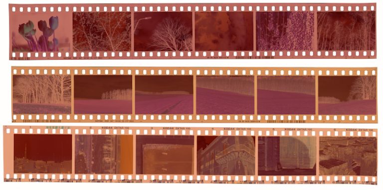

Maybe this helps:
Top: Vision3 250D developed in C41 developer; 3m15s @ 38.0C
Middle: Vision3 250D developed in ECN2 developer; 4m45s @ 41.0C
Bottom: Kodak Ektar developed in C41 developer; 3m15s @ 38.0C
Note that the middle strip is quite overdeveloped to match the lowish gamma of this film to RA4 paper. I overcooked this particular roll; I'd recommend around 3m45s to 4m00s instead. This yields negatives that print similarly to regular C41 negatives, save for the different color balance (particularly the magenta filtration).
