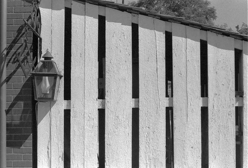

Nikon F3, N-74 pushed +1, Rodinal 1:100 stand.
I mixed up my films and developed this in Rodinal by mistake. It came out ok. I wouldn't do it again though. It needed 20+ minutes of fixing though.

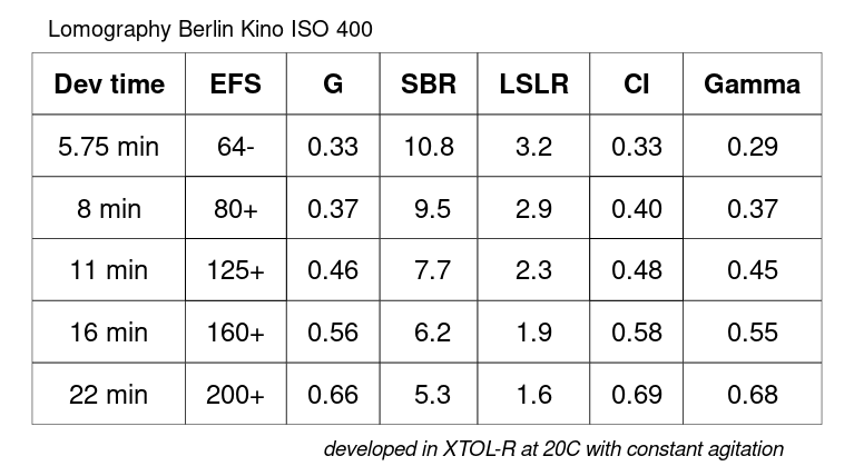

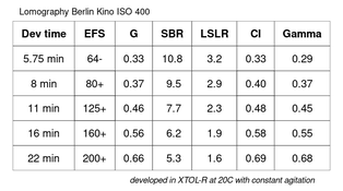

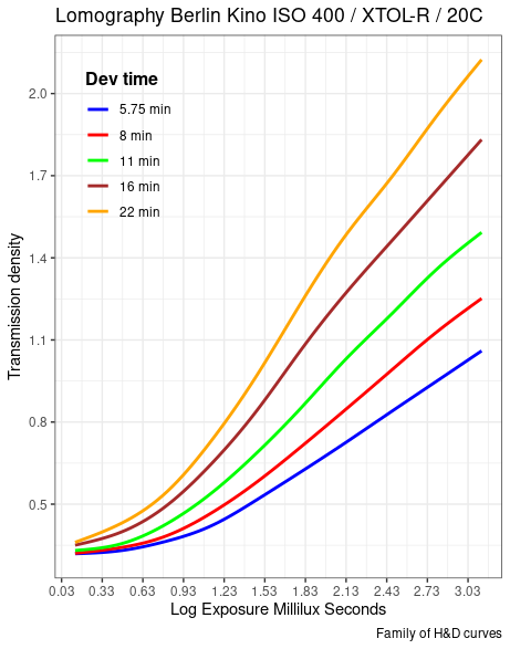

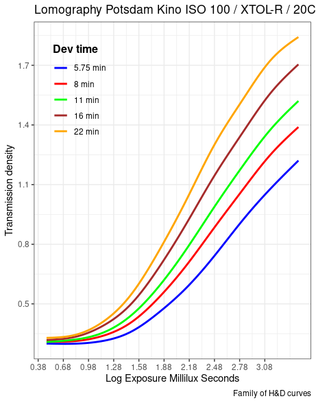

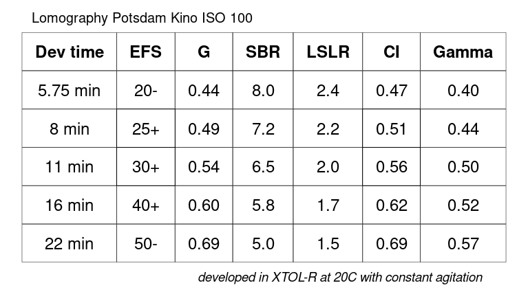

I recently bought Lomography Potsdam Kino 100 and Berlin Kino 400 B&W films (based on cine films made by ORWO).
I ran a typical five-curve family test, which I repeated twice and averaged density values for the final analysis. I processed the samples in replenished XTOL (XTOL-R) for 5:45, 8, 11, 16, and 22 minutes at 20C in a Jobo tank with continuous rotary agitation.
Both films have been a pleasure to work with. Overall, the films performed very well, though they seem to need rather long development times in XTOL-R to obtain “normal” contrast. The Potsdam 100 film speed was ISO 45, whereas the Berlin 400 was ISO 194 in my test (using the 0.1 over B+F criterion). Emulsion quality and consistency seems quite good. I have not yet come across any defects or imperfections. The Potsdam 100 curls a bit, even when dry, whereas the Berlin 400 dries nice and flat. I will post photographs once I've had a chance to digitize them.

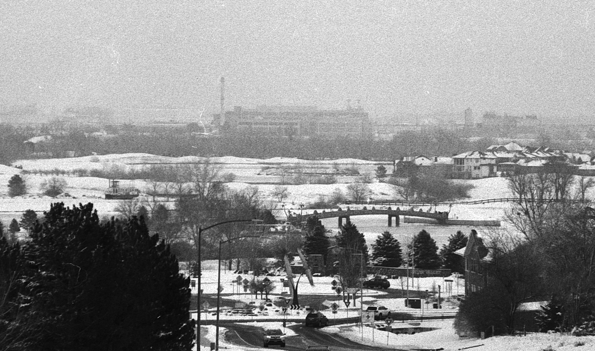

Took a few more shots with Double X. this time in Xtol 1:1 for 8:30. It was an overcast day, quite hazy out. These are scans of the negatives. The one of the Kodak plant is down a hill from me, way zoomed in so does not look so great. I'm not sure if anything goes on there anymore, but I believe it was in production in the early 90s when I first moved to Colorado. Says Kodak Alaris now when I drive by.

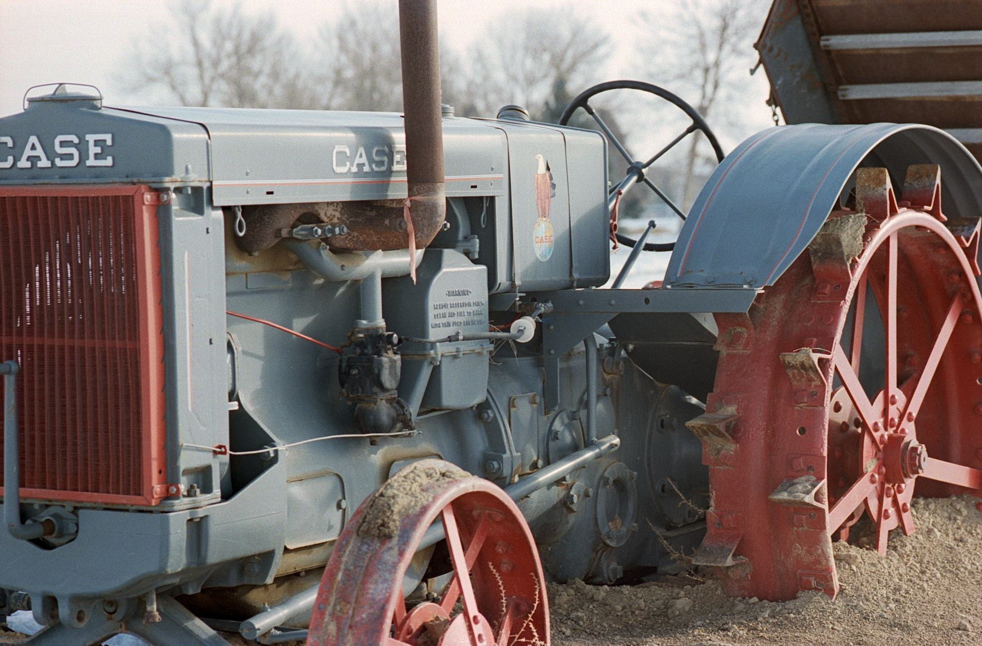

I went back out to the same place with 250D and a longer lens. I must of goofed something up in the processing, things are not right compared to previous rolls. I was able to get a better shot of the Kodak building.
After looking at some of the much better results others are getting, I think next pass I will go back to a pre bath ( milder than my DWC ). It looks like I could be getting remjet in the emulsion during processing, I also wonder If I'm not screwing up the color balance.
View attachment 325433View attachment 325434View attachment 325435View attachment 325436
I've not had consistent results with 250D. 50D, 500T have been just about always the same. 250D seems to go great one roll and awful the next.

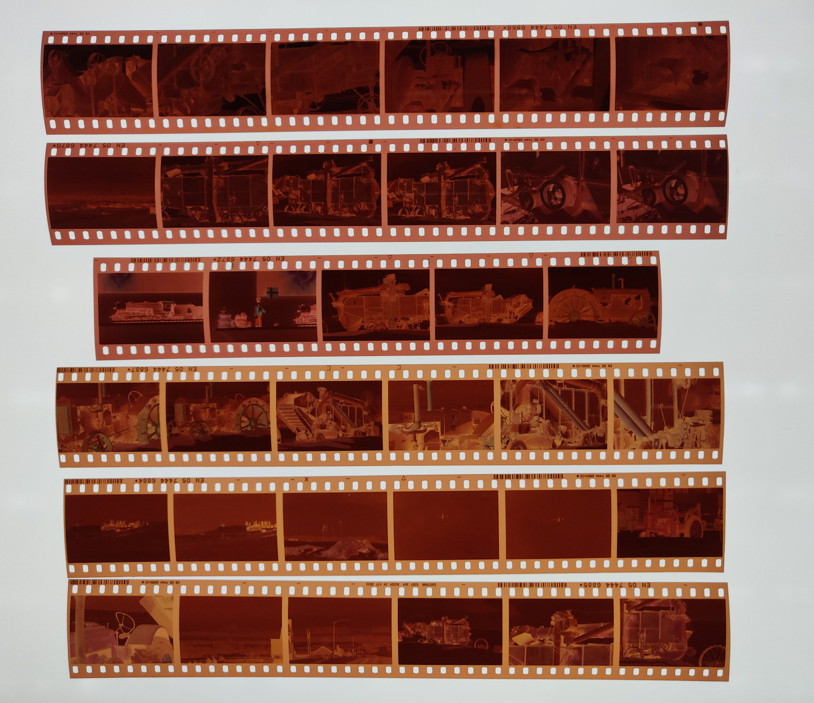

Praktica MTL3, Vision3 250D
This roll is another case of 250D confusion. Inferior camera and lens (in my opinion), well beyond use development kit and the photos look pretty good. I might just have an erratic roll of 250D sitting in my bulk loader. Or maybe the stuff like exhausted chemistry. Who knows.

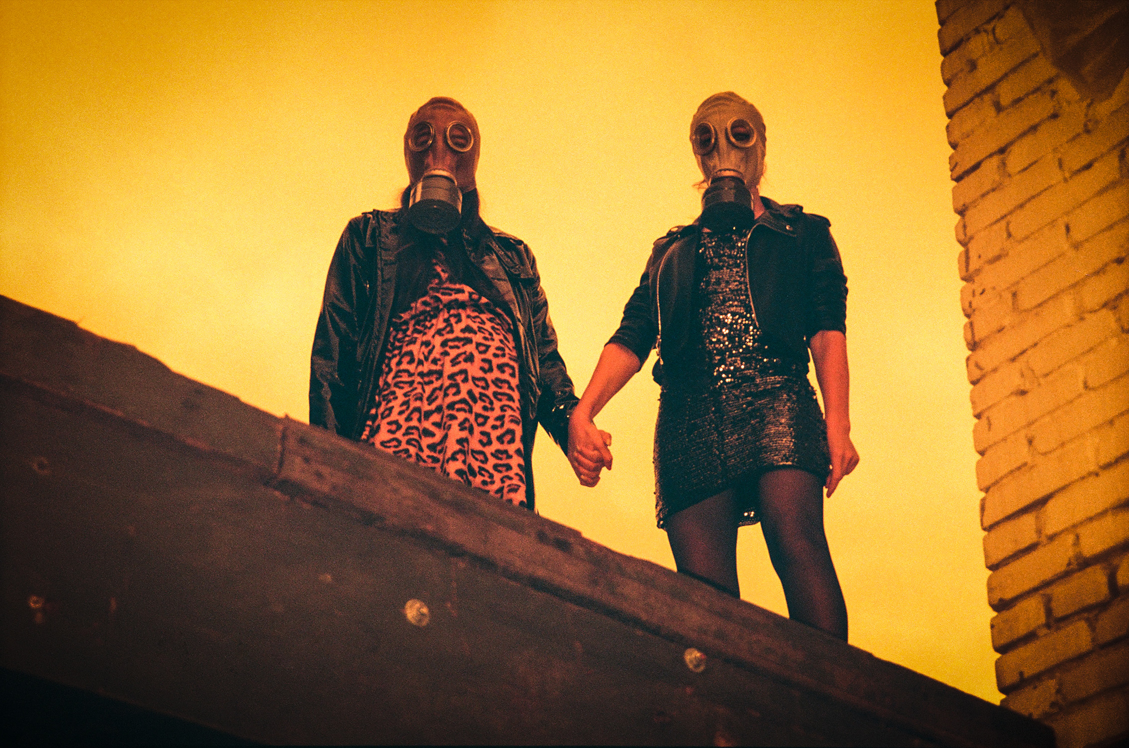

Redscale - expired turned inside out, emulsion layer inside. Canon Photura 135 caption camera

Redscale - expired Kodak T-Max turned inside out, emulsion layer inside. Canon Photura 135 caption camera
Start over there sport.
Redscale Tmax? Tmax is a black and white film. And as far as I can tell it's not a motion picture stock.

Thank you! YES, of course, I copy and paste from the translator, but for some reason very inattentively, although I try. I bought this film, but it's hand-wound expired film. That's all I wanted to say that she is manually turned upside down.
It looks nice. Interesting camera.
