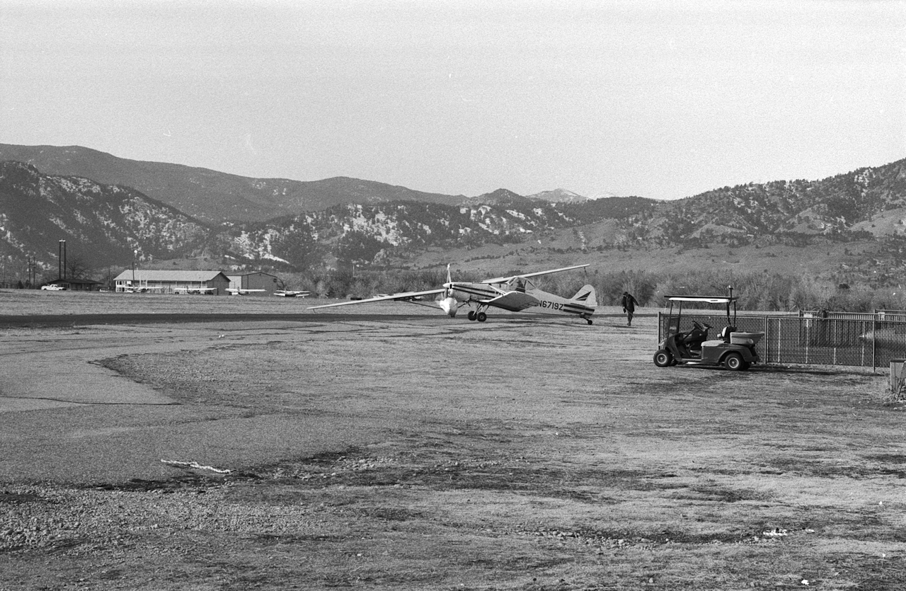

Neg scan. 5222, Hexar RF, Pentax 50 1.4, Sooperhooch 50.

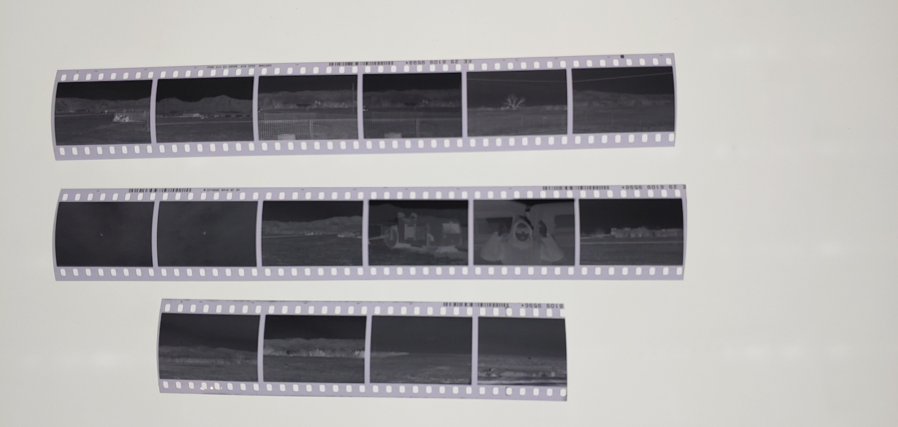

I picked up a 400 ft roll of Double X. I shot these with my OM3Ti at iso 250 and 90mm lens. I used XTOL 1:1 for 10 minutes at 20C. They seem over developed to me, I only say that because I shoot a lot of slide film in this camera and they come out perfect. Overall I think I will be pleased with Double X.

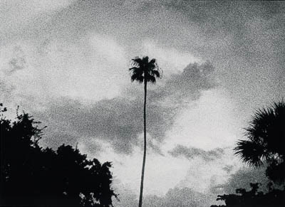

Second roll of Double-X. Still shot at ISO250 but this time developed in XTOL 1:2 20C for 12 minutes. I like the results better. Grain is more pleasing to me.

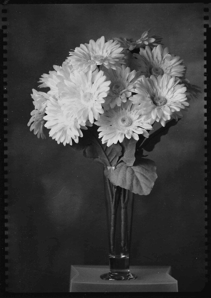

5x7 PlusX 2402 Aero D23 5x7 Norma 500mm Tele Xenar by Nokton48, on Flickr
Kodak Aerographic Five Inch Plus-X cut seven inches, to fit a 5x7 Lisco Holder. 5x7 Sinar Norma with my newly CLA'ed Schneider 500mm Tele Xenar at F22. Hasselblad 40mm Distagon Yellow Filter jammed inside the lenshood, it fits! D23 1:1 8x10 Unidrum on Uniroller. 5x7 Contact Print on Arista #2 RC Dektol 1:2 The Tele-Xenar is quite sharp up front as you can see. I'm liking this film for 5x7, but I can also cut it to 4x5 or even 9x12cm. Like the tonality you get with the Aerial emulsion.
Tim Kelly Inspired Broncolor Balloon 90 degrees left, lighting the entire set. Main light Broncolor C171 Monolight Pulsoflex Softbox, one stop brighter than the fill, 45 left to the set. Just out of camera shot 45 right, is a foamcore freestanding panel for passive fill. Finally, the creme on the sundae, is Broncolor C70 Monolight with Snoot and Handmade Grid from an olde Broncolor Honeycomb. Selecting lighting a small portion of the background. Just because

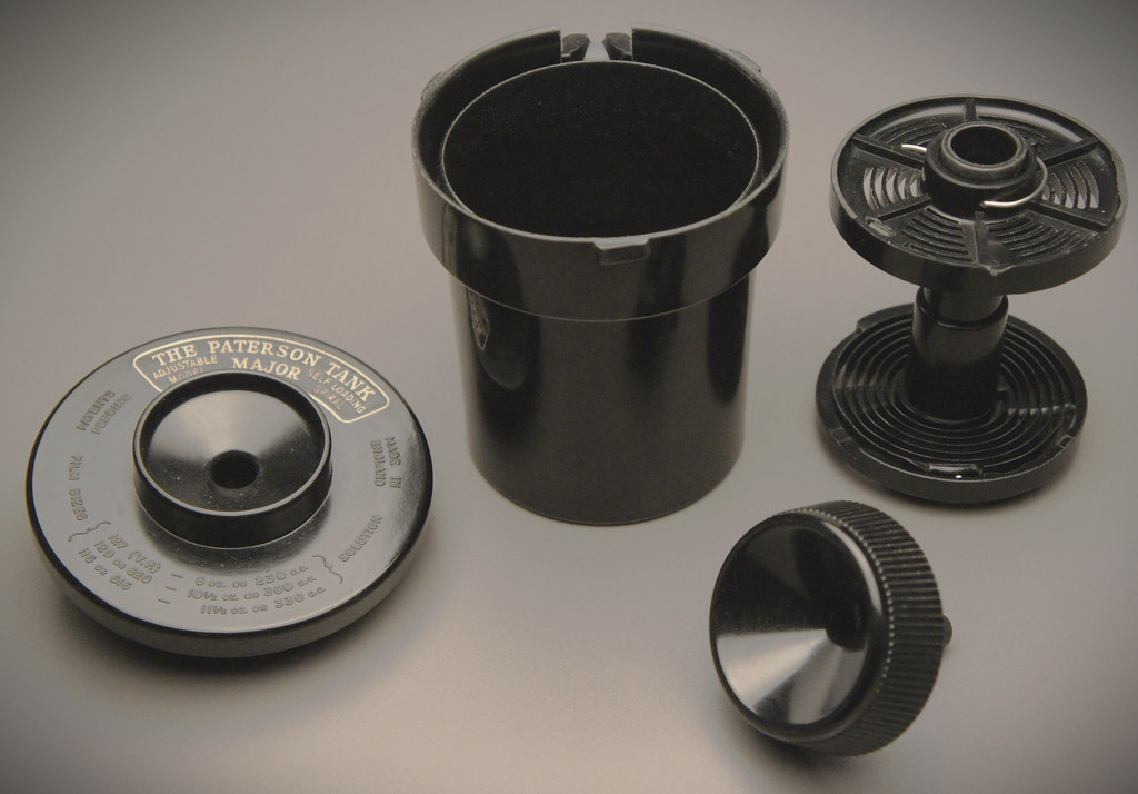

The Paterson Major Tank, just arrived from the UK. Seem to be plentiful. Will hold very well a 120 length of 70mm width film, so good for "clip tests" where I don't want to waste an entire roll. Agitation via spinning the large top black knob, fits on by friction. Works very well for what it is, which is beautiful bakelite. Don't drop it, but it seems very sturdy and solidly made

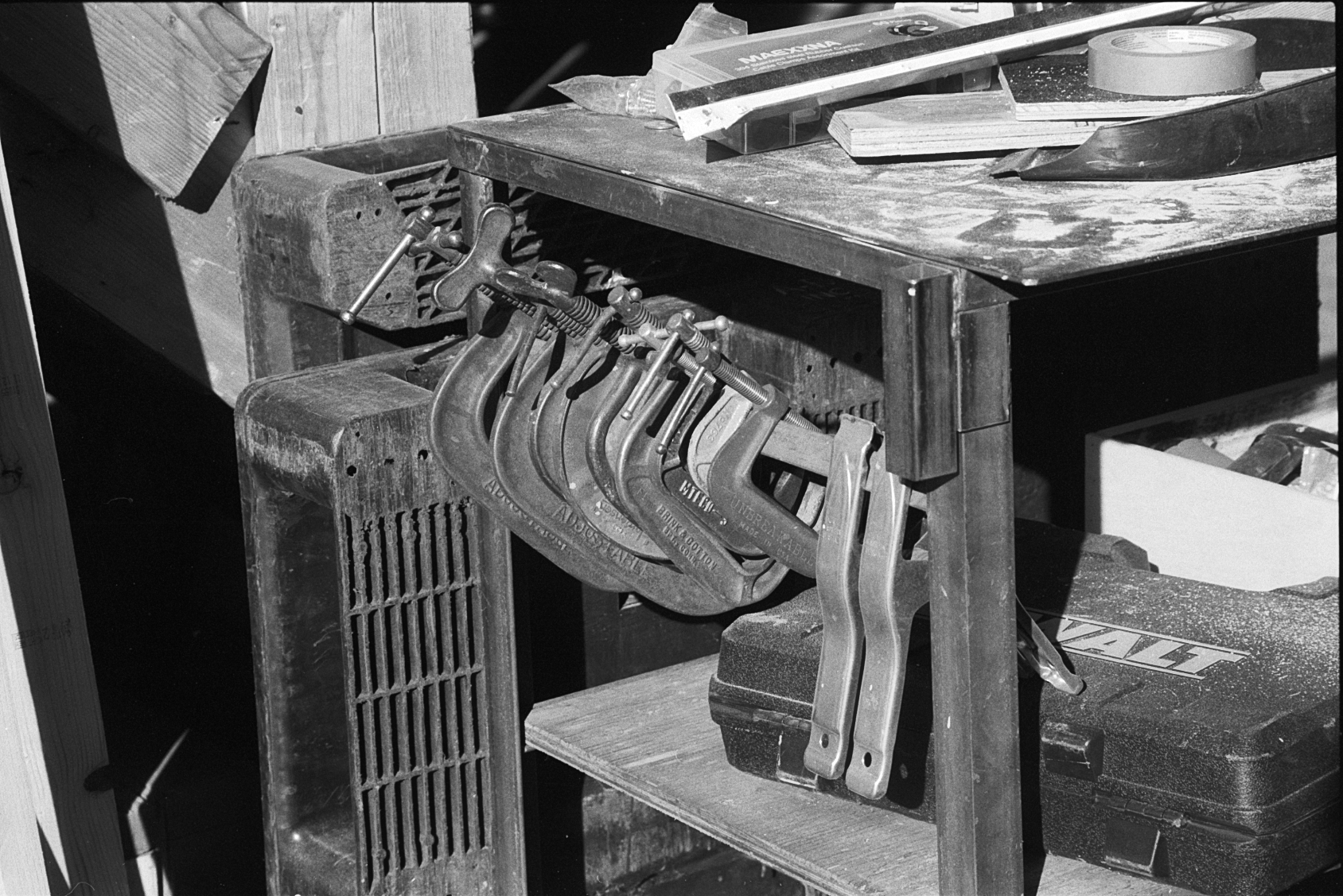

Yashica FX-3, N-74 @200, HC-110B 10min
I'm unsure if the particular lenses I was using were just not that sharp or the film itself isn't all that sharp. The film gets the job done but it's not the sharpest grain out there.

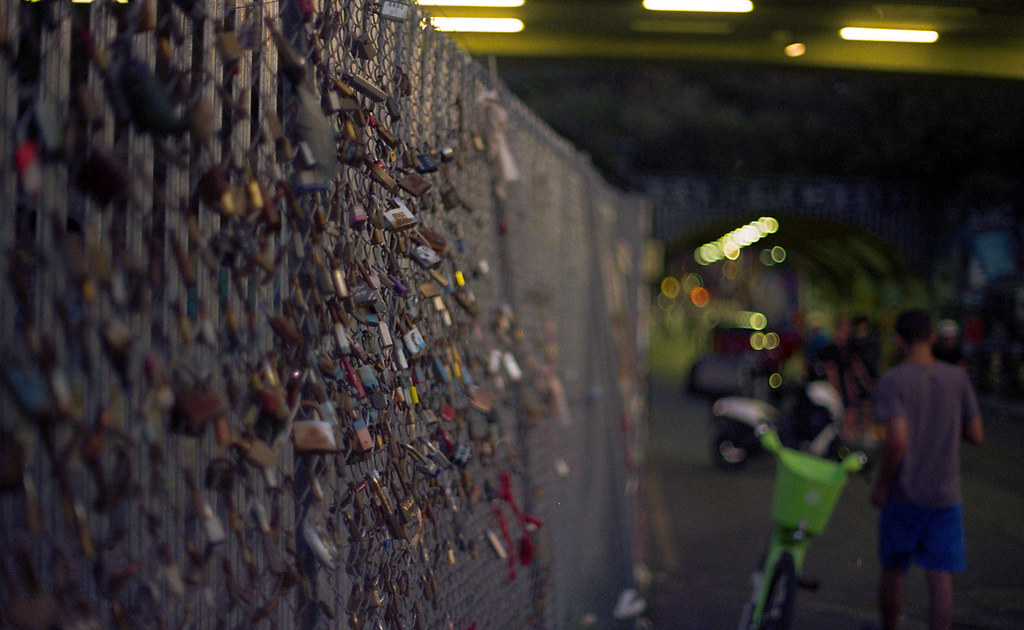

Elan II, 35mm 2.8, Vision3 250D
It looks like my batch of 250D stored in the fridge went off a bit. I'll have to overexpose my rolls a stop going forward. I developed side by side with some 50D and that stuff looks incredible.
Joel_L
Mar 12, 2011
580
Colorado
How old is your Vision 3, I would expect it to last a good long time cold stored?
Cholentpot
Cholentpot
Oct 26, 2015
6,873
Not very, I'm a little surprised. The 50D I shot around the same time, using the same chemistry turned out great.

Thanks to Nokton48 for the tip on the Patersen Major tank. Found one in the US, paid a bit much for a stupid film tank, but it handles my 616 film just right. I bought some 70mm aero film off ebay, will try using it on 616 backing paper for reloads. This will be perfect for the processing.
