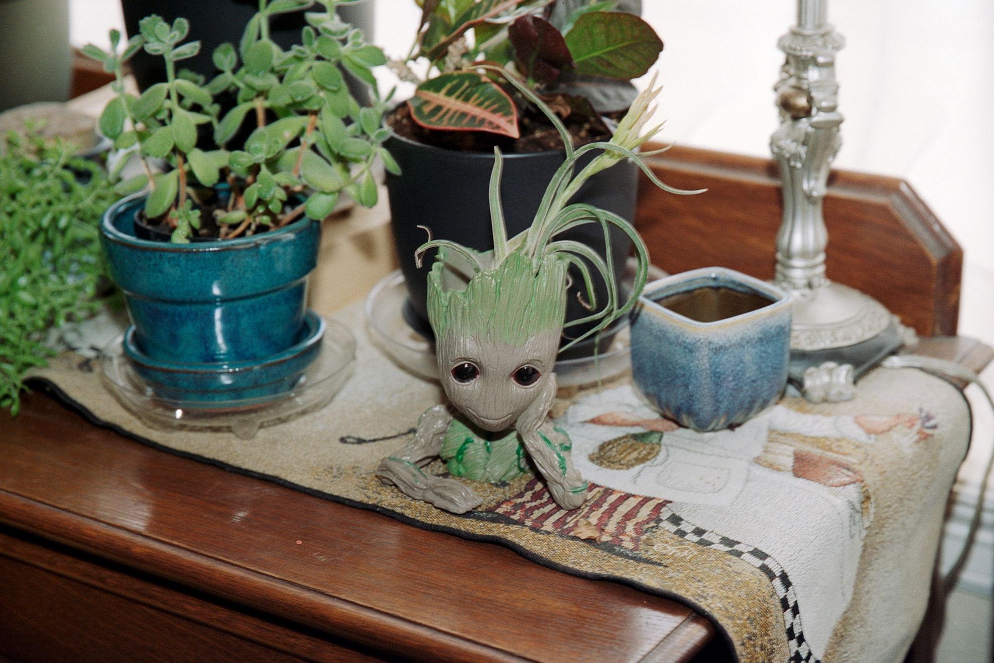

I finally mixed up my ECN2 chemistry and then shot a couple rolls of 250D to do a side by side comparison of using C41 vs ECN2. To my eyes, each worked slightly better is certain images than the other. The ECN2 seemed more saturated ( almost too much in some cases ). The C41 seemed to have a more natural look to greens. All in all, I like the C41 processed results better, but its close. If I were not looking at them side by side, I could take either one.
The C41 images are a bit brighter as scanned. If I darken them, things look even closer. What I'm posting is as they were scanned.

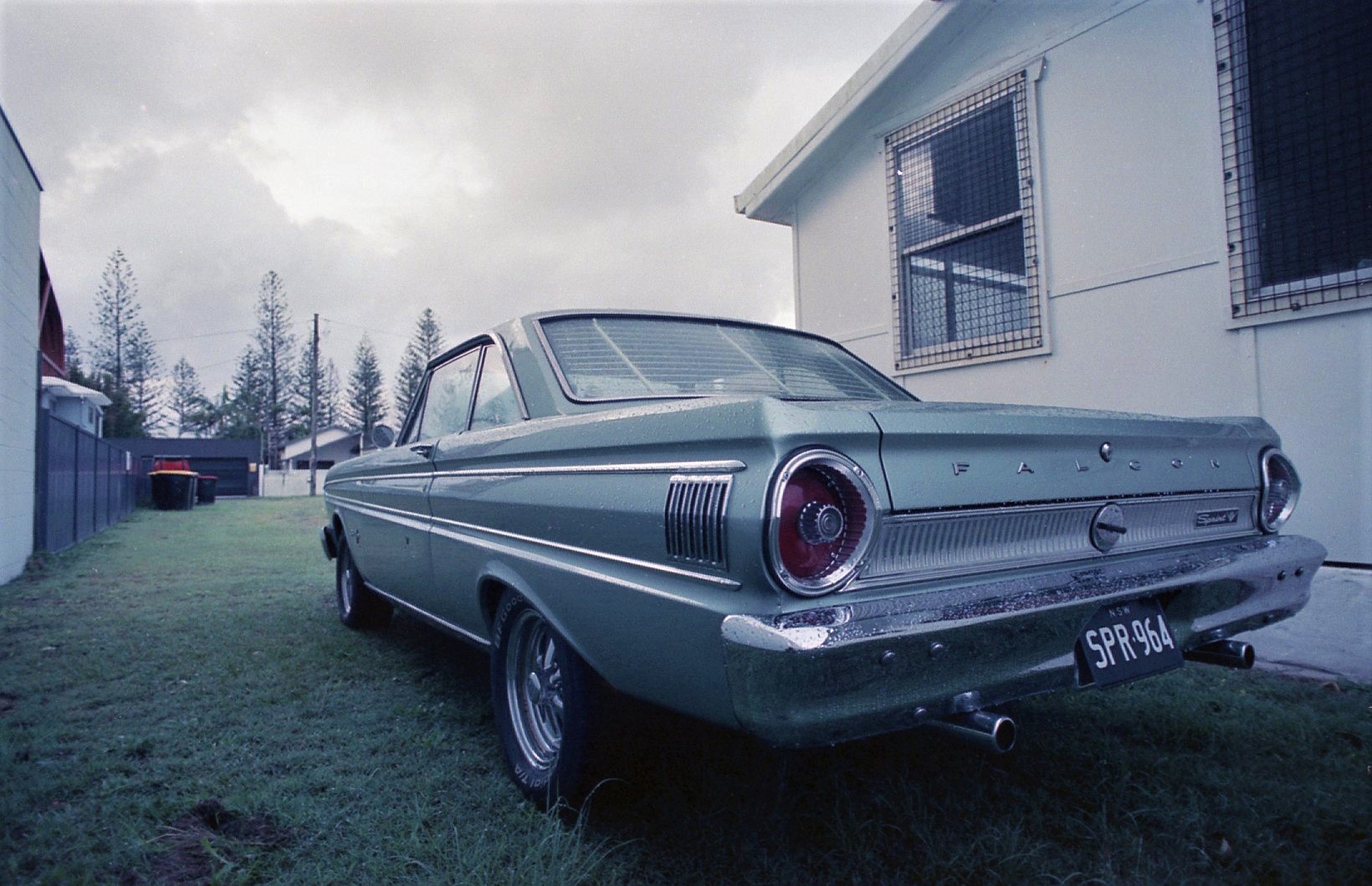

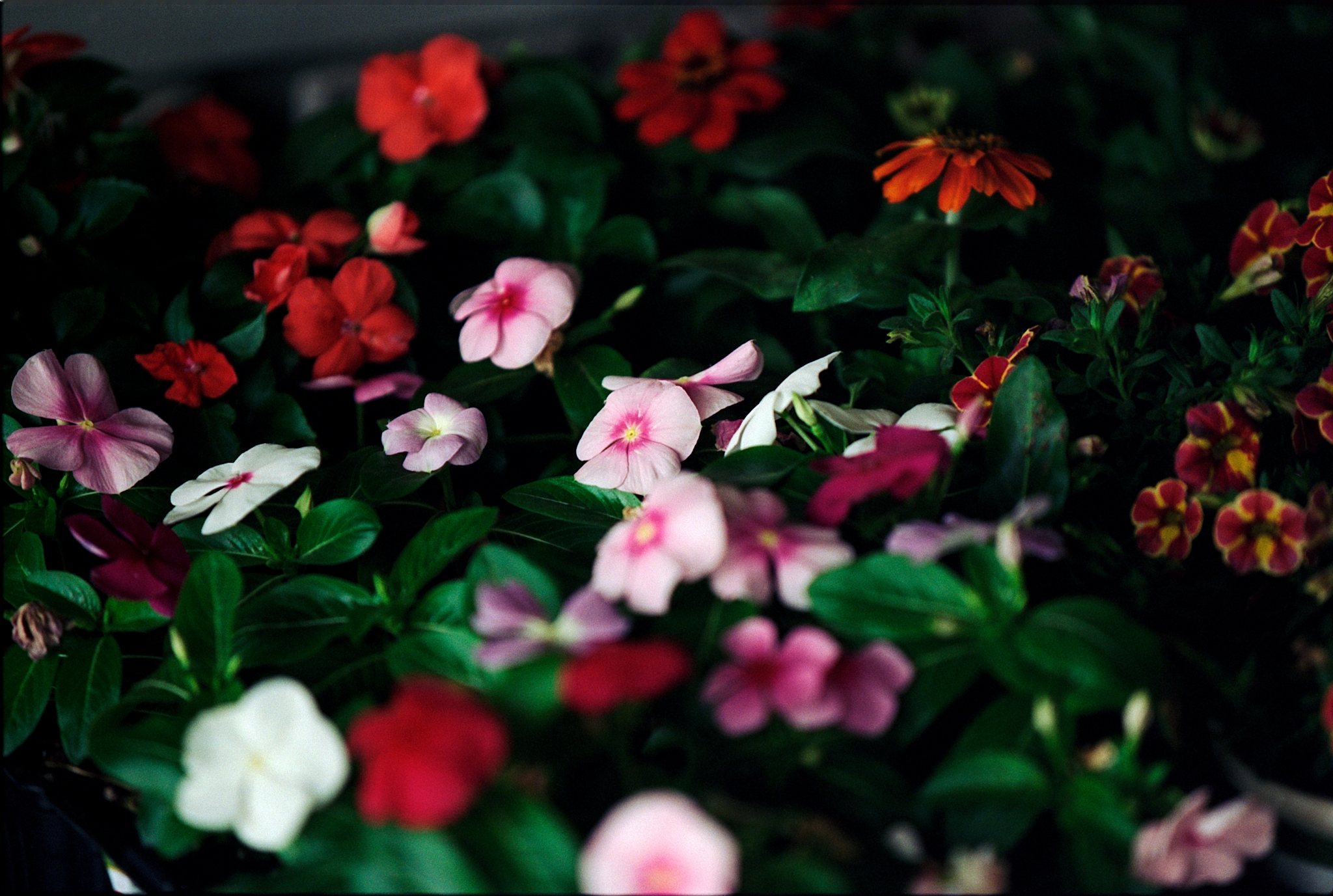

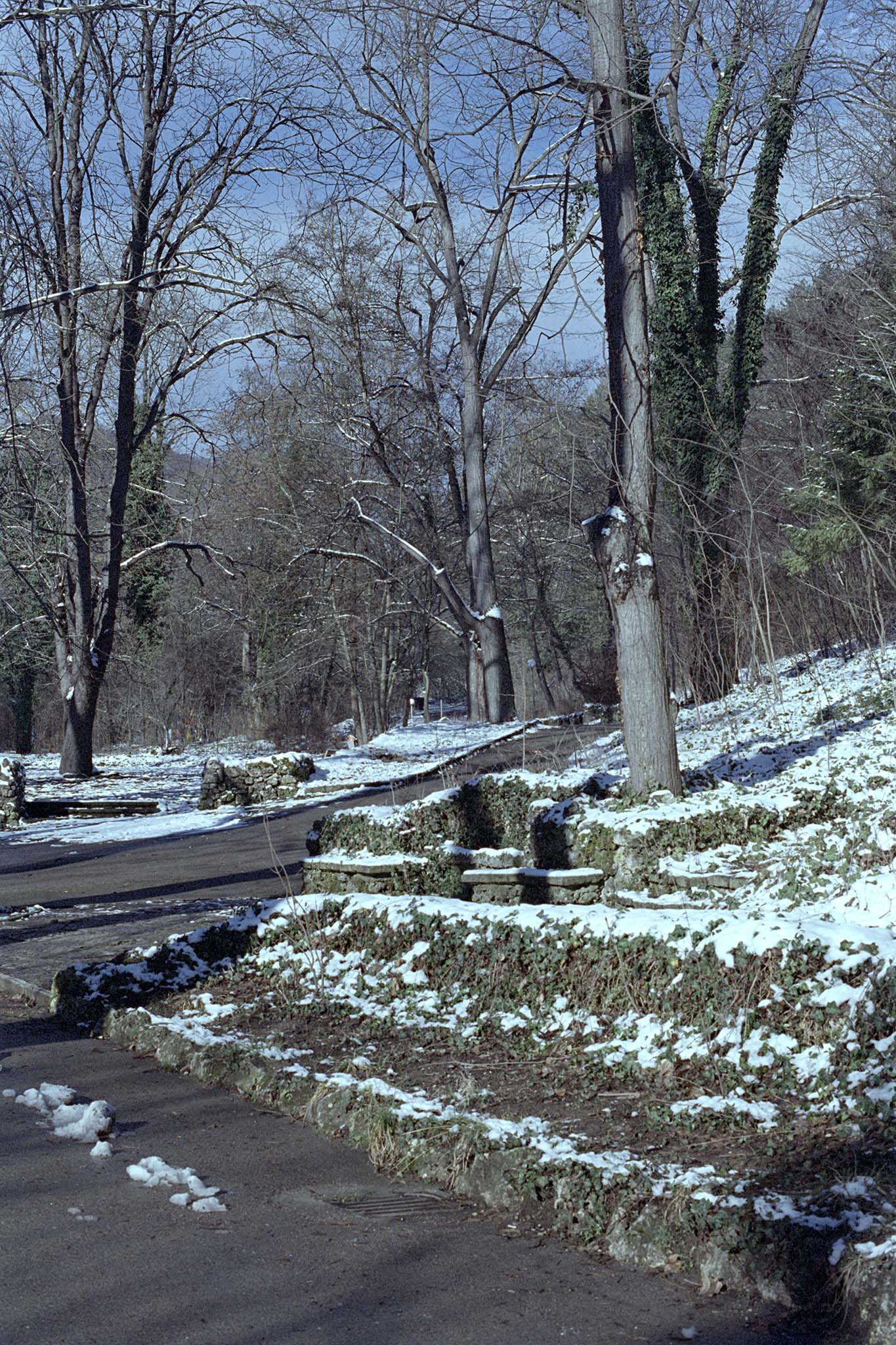

Kodak Vision 3 200T @ 160 iso Home processing Remjet removed with baking soda prewash.
Nikon F100 50mm f1.4D and 20mm f 2.8D.
Digital adjustments.

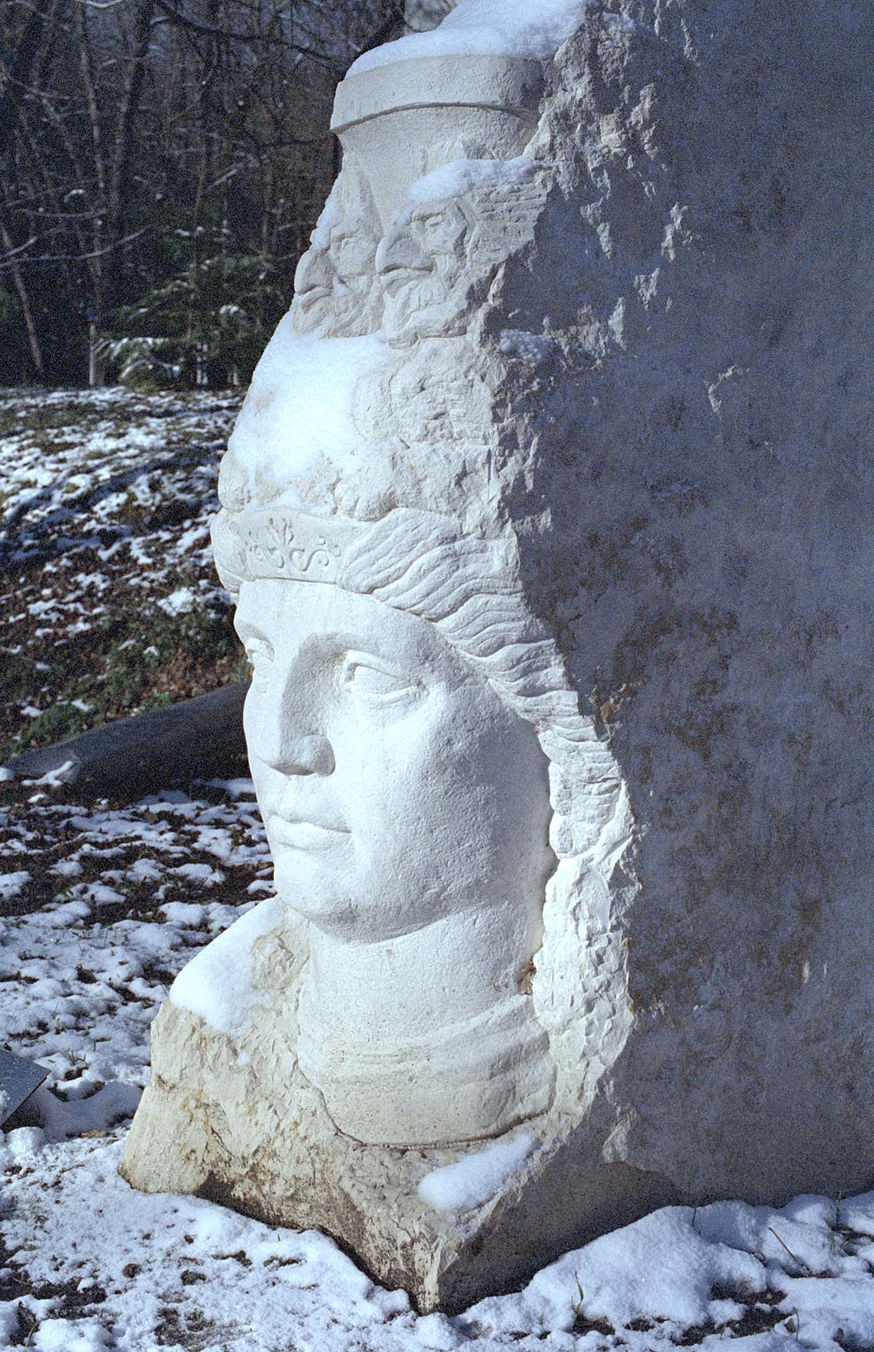

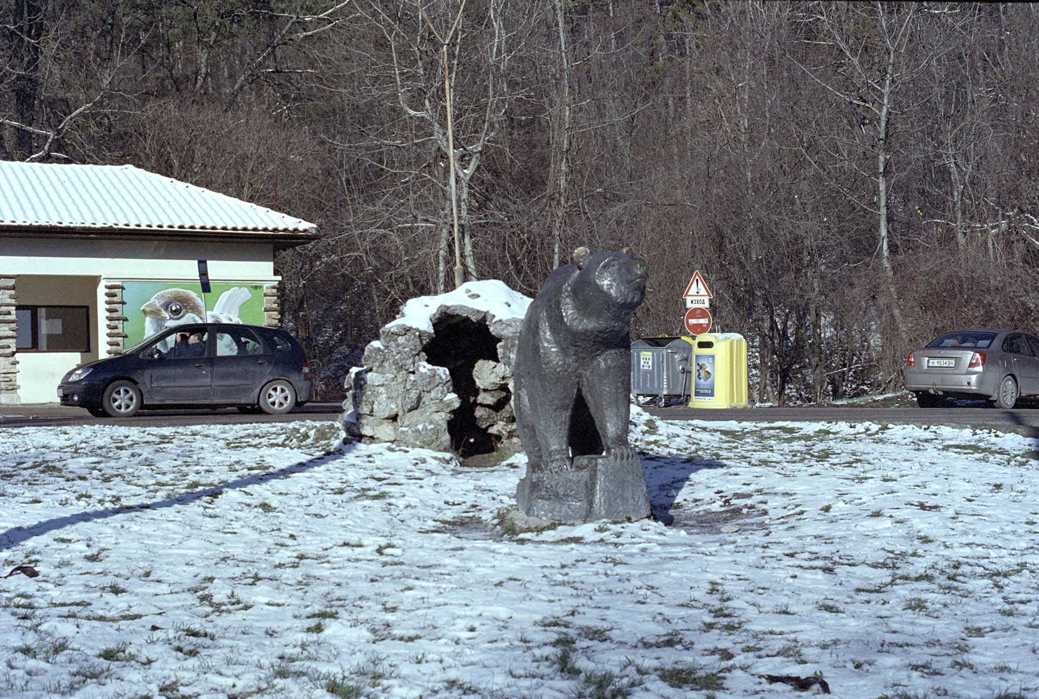

Fujifilm 8563 Eterna 250D @160, Nikon F3 50/1.4 Ai-S
I don't know when it was made, but it probably expired about 15 years ago. I love this film!
ECN-2 home brewed chemistry, Kodak formula Rem-Jet remover pre-bath. Directly exported JPEG from VueScan, no adjustments - just resizing!

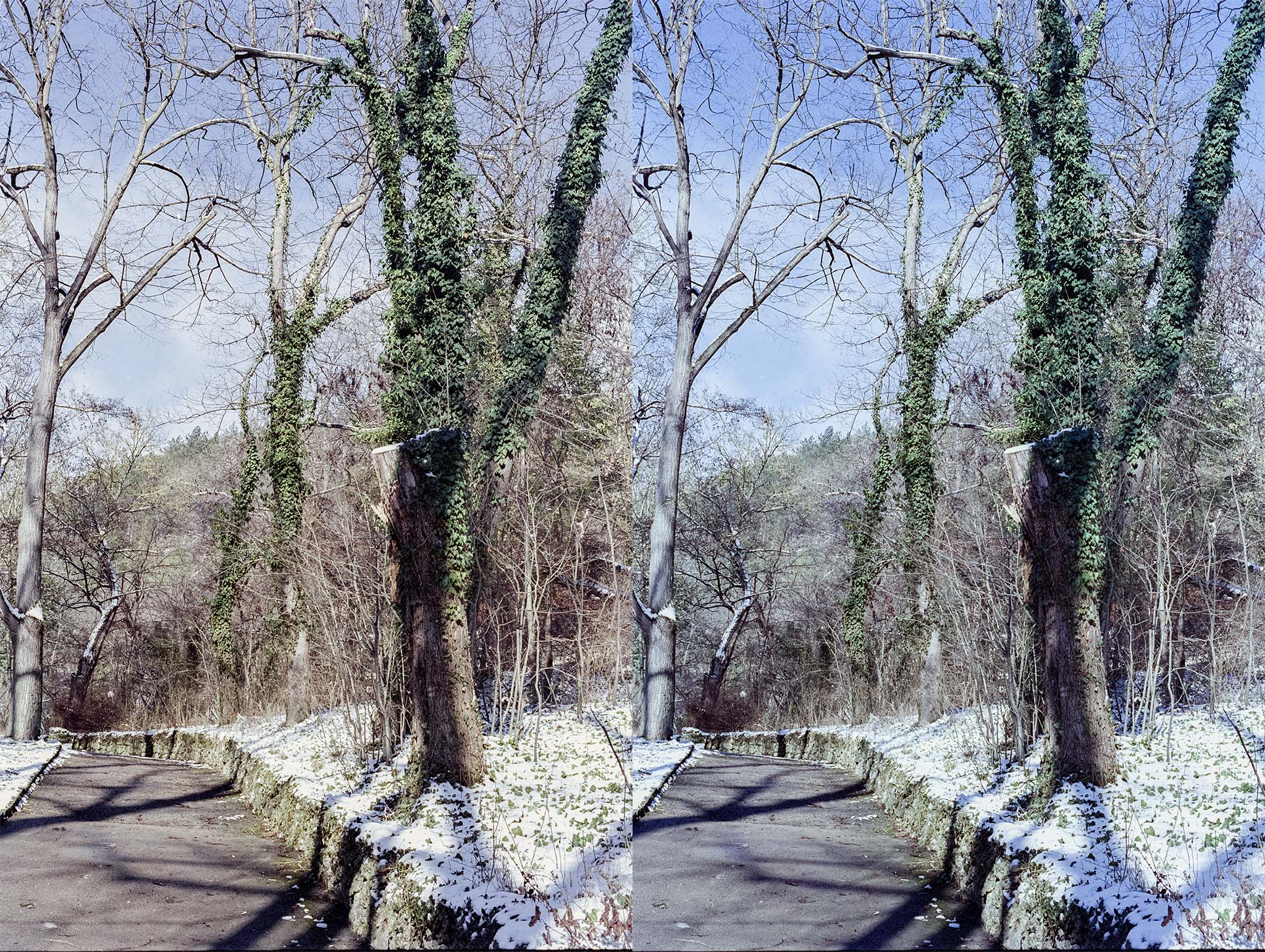

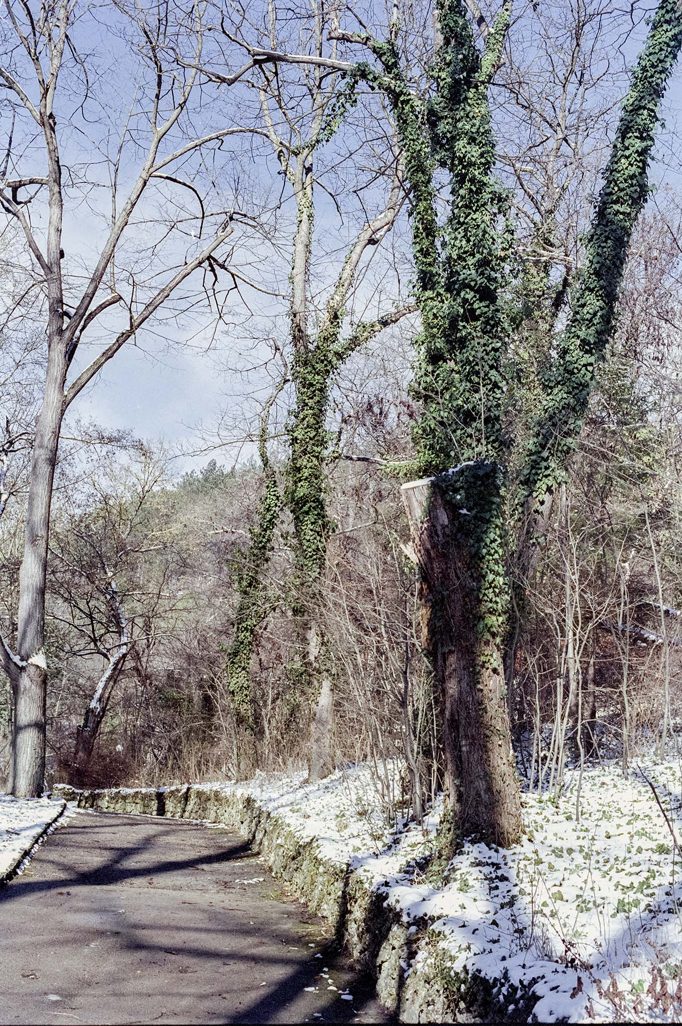

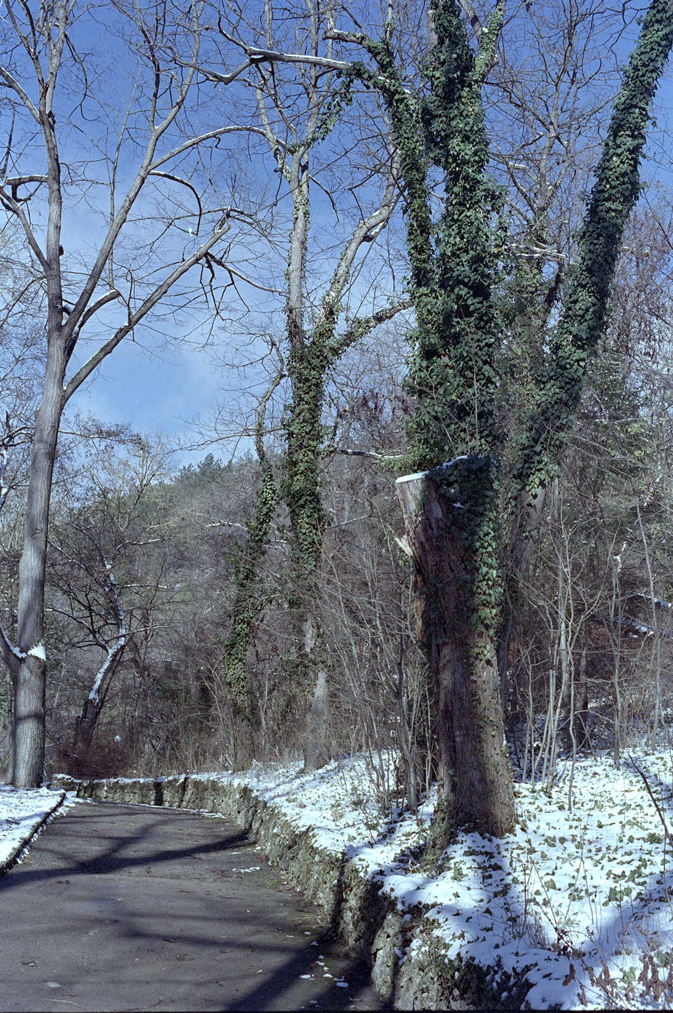

Yes, of course you can. In just 10 seconds!
I am attaching a DNG archive - directly from VueScan (340MB). DNG from VueScan
Left - ten second correction, right - original.
White balance on the tree on the right, and then a slight desaturation of the blue due to the shadows of the snow. They always come out blue…

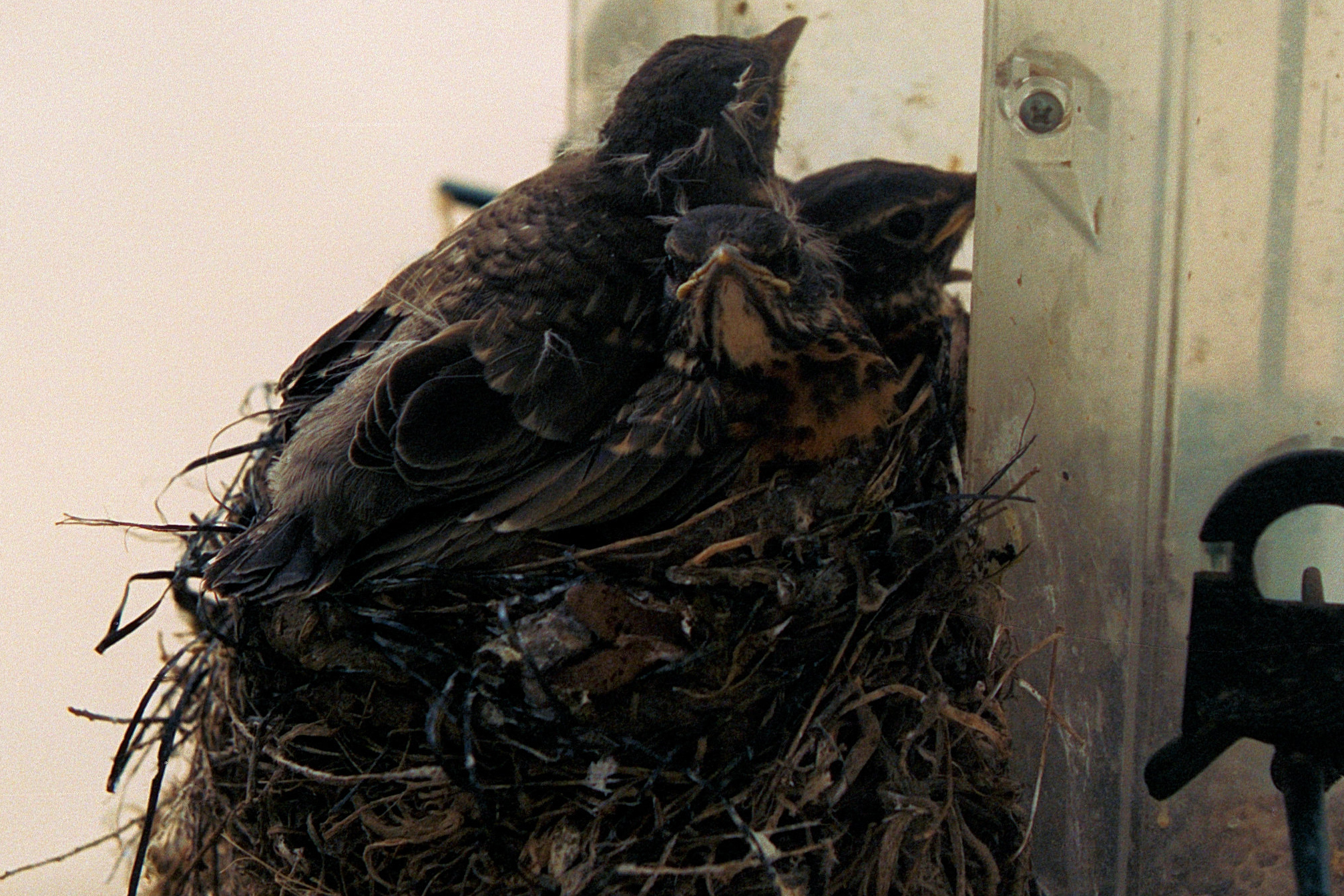

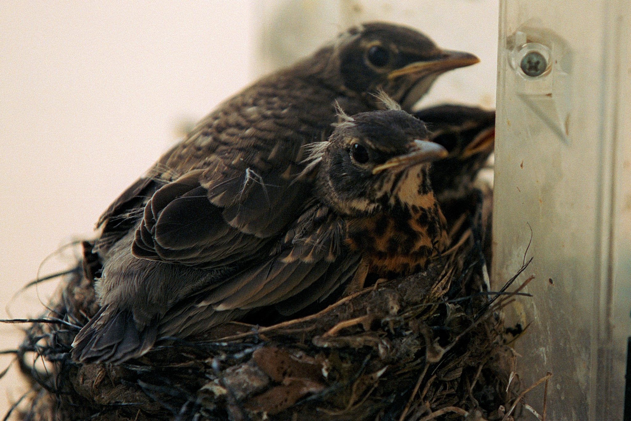

I went out and shot some 250D today. Even though I like the results in C41, I still had some ECN2 I mixed 2 months ago ( April 1 ). So I decided to use it and see what the results are like. It was early morning light, about 6:30 AM. I have some Robins that nested just outside my kitchen window. You could see them grow daily. I expect they will be out of the nest real soon now.
Here are some results with the 2 month old QWD ENC2 chemistry.
