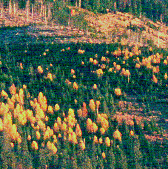

I've never had a good experience with Vuescan. I have tried again. Are these vertical bands normal?

No, not normal. Since they are vertical it can't be because of poor calibration. It could be transport problem, but I guess SF never gives you this problem... 🤷‍♂️
Luckily, Silverfast 8.8 gives me a nice even result! Oh, and a few zigzags... :tongue:

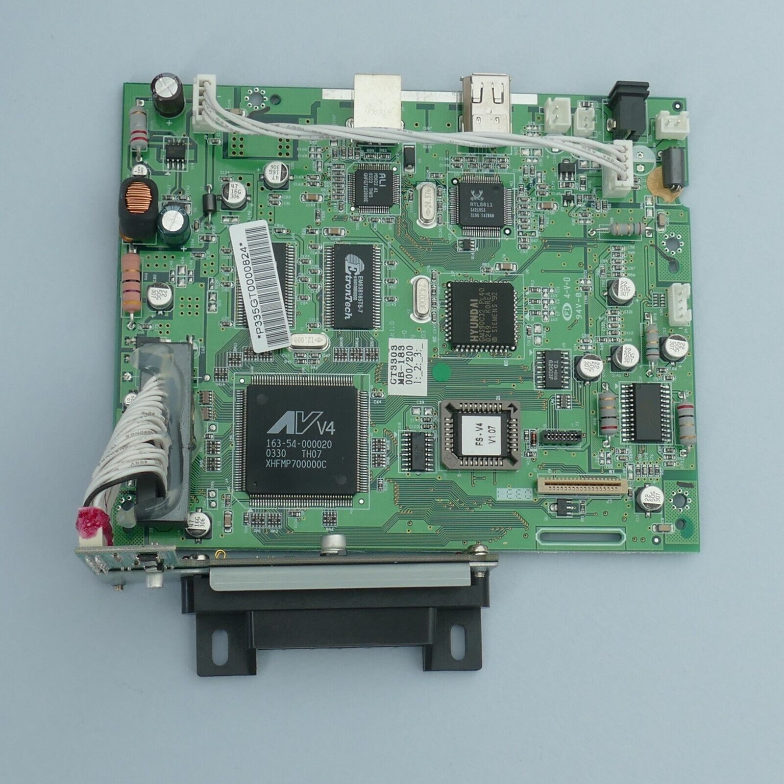

Nikon Coolscan zigzag noise and how to fix it.

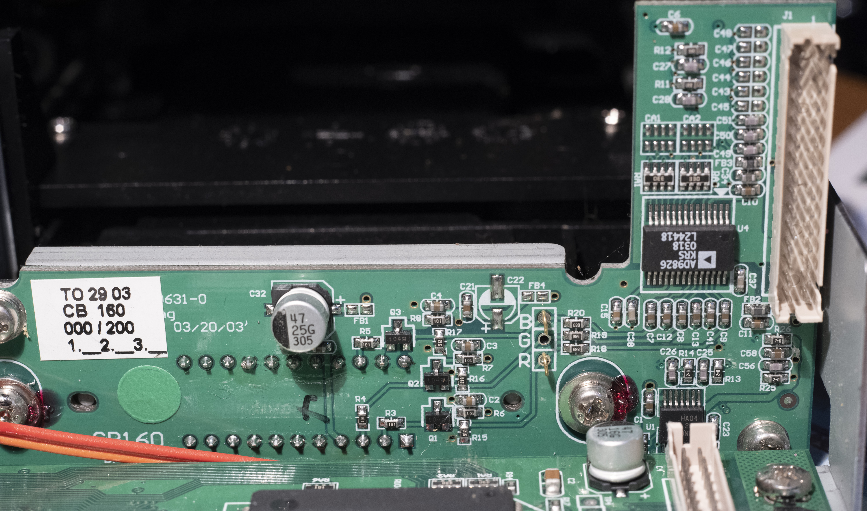

The Coolscan 9000ED and 5000ED use the same AD9826 converter as the Minolta 5400.
This is the main board of the Minolta 5400, but the ADC chip is on the CCD board, next to the CCD:
Quite possible. But noise performance depends on more factors than the chip used, and those factors are generally of a much bigger influence. So it cannot be expected that these scanners will all have the same noise performance, nor the same failure modes over time.
Indeed, so the image shown isn't very relevant as it omits the critical part around the ADC and CCD. Photos of that area were posted earlier in this thread.

Speaking of the 9000, and for completion sake, here is a picture of a spare 9000 CCD I have laying around.
The culprit in that case is C18.
Not that it really helps us in any case, but who knows...
Yes, that makes good sense. Note how C18 is part of the filter circuit around the CAPT and CAPB pins, which set a reference voltage. Any noise on a reference voltage will affect the output severely. Note that this section of the circuit in the Minolta 5400 is largely obscured by the connector between the CCD PCB and the mainboard.

When you changed the capacitor in my scanner, was the capacitor in question related to the CAPT CAPB pins of the ADC?
EDIT : answering my own question. Yes you did.
I tried to a few pictures of the line sensor board. I found an electrolyte at the back of the PCB (C42) with a value of 10mf and 16v that matches the faulty electrolyte of the coolscans. Unfortunately, I can't really trace it back to pin 20 and 21 of the ADC. Maybe the board is dual layered and it is related ?
I know I am out of my depth right there, don't be too harsh on me. Trying to shake the tree. Who knows what might come from it (probably nothing)
Anyhow, The ADC spec sheet recommends a 10mf capacitor in the circuit diagram. Which I can't find besides at the back.
And here is a picture of the sensor board and the ADC without the huge connector. If someone is inspired, let us know.
It's been a while, but I think it was a filter cap associated with the analog supply. AFAIK I did not find any other candidate electrolytic caps that were likely suspects.
Yes, it's likely a double or even 4-sided board. If you have a continuity tester, you can verify how the connections are. In this case it should be possible with some care to verify whether the electrolytic you located is responsible for the problem. Looking at the PCB, it's a little hard to tell, but it does not seem to be connected - however, it's a little difficult to make out based on the photos (although they're good, don't get me wrong!)
Note that the 10uF capacitor can also be a ceramic cap and those also come in small SMD package (the little brown boxes) for this kind of voltage rating. If it's a ceramic capacitor, it's unlikely to be a problem because they generally don't 'rot' the way electrolytics sometimes do.
Hm, that's interesting; I'm pretty sure the replacement I did on your scanner was C22, but that's unpopulated on the photo you posted.
It's a spare unit I had close to my hand. It's working and showing the usual zigzag symptoms.
I'll try to test continuity, I have a multimeter somewhere.

The interesting bit is that it shows that there are different versions and the BoM has varied between them. But it's only marginally relevant, since we already established that replacing C22 didn't do anything, anyway.
Yes, see what the continuinity testing gives. I'm interested whether you can verify that C42 connects to both pins 20 & 21 on the ADC chip. If so, it would be worthwhile replacing it with a new one and see if that improves matters. It's a good lead.
