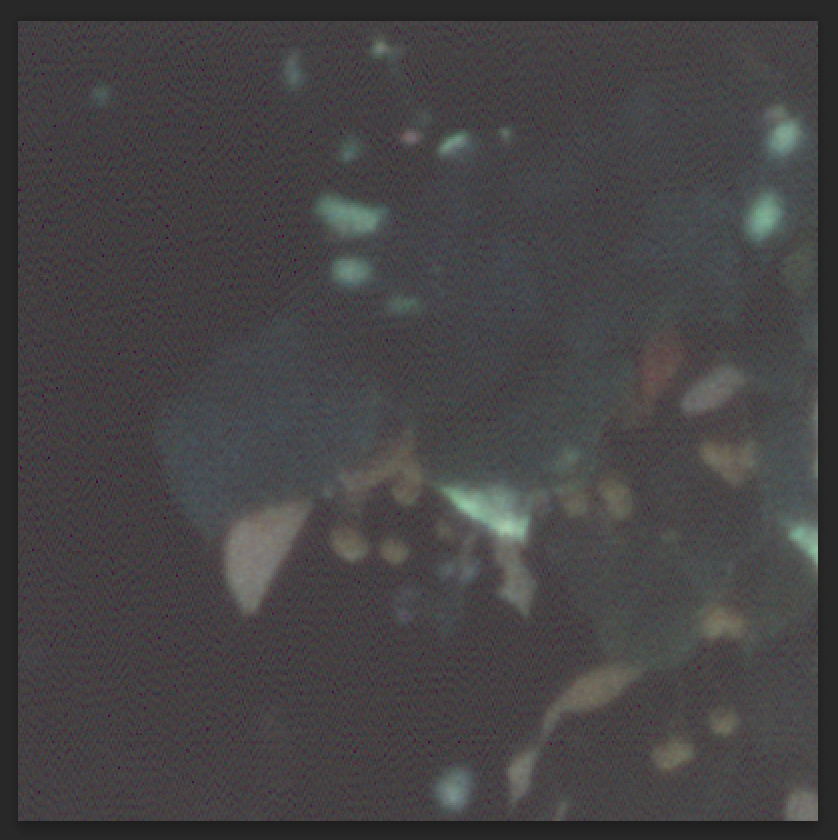

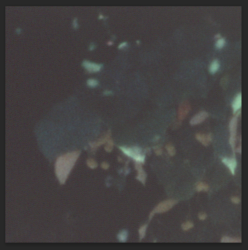

This implies that it's difficult or even impossible to verify the suspicion that the noise problem appeared suddenly. The scanner may have performed the same, always, but you only noticed it at a certain point.
I think the difference is quite obvious. I have looked at many of my previous scans and none of them show the defect.
In every scan, when Silverfast scans the first layer without Multi-Exposure, the defect is very noticeable(1:1 view mode). When the software adds the Multi-Exposure layer, the zigzag pattern is significantly reduced.
So I see the following, but I can reduce it when ME is on:

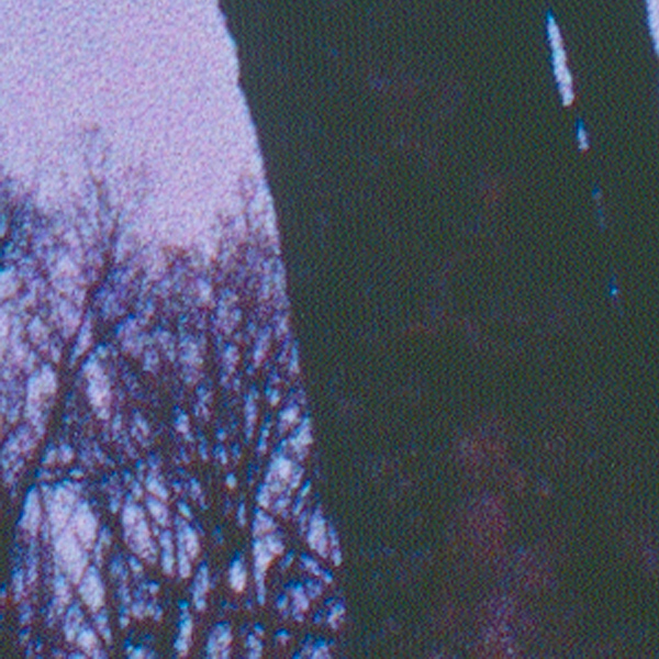

Here is my RVP50:
200% crop:

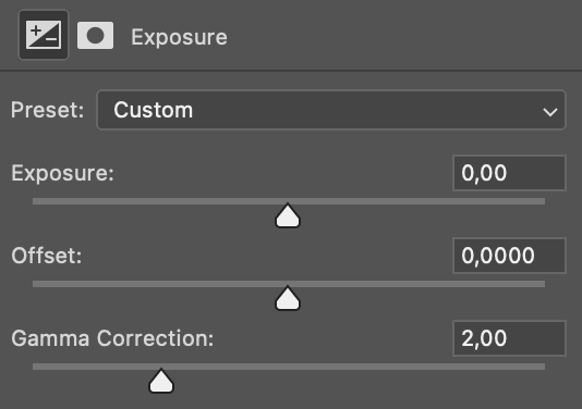

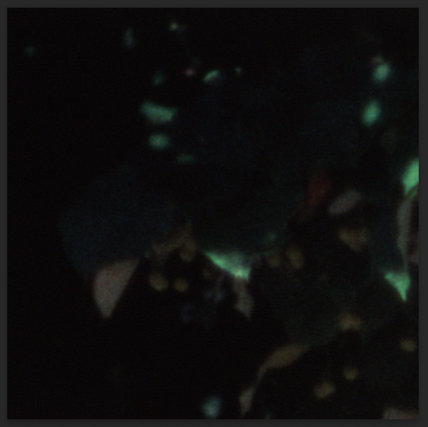

Lifted gamma +1:
As said, with GD it's considerably worse:
And using a profile made from IT8 target would make it worse as well. All scans with 6x multisample, single sample is also much worse.
It's interesting that R, G, B noise patterns run independently from each other. G channel is the dominant one on my scanner.

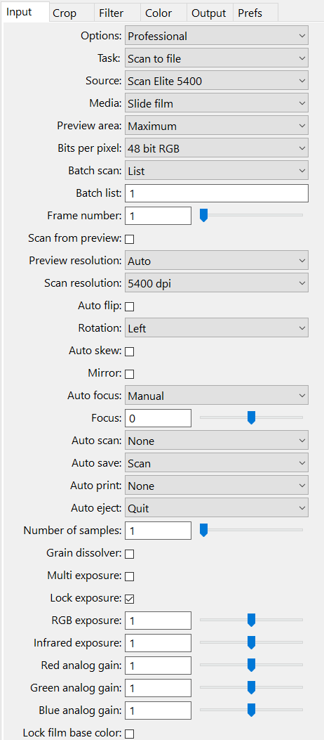

We can't compare the state of our CCFL bulbs directly, but we could compare them indirectly.
Vuescan always calibrates the scanner so that Exposure Lock value of 1 will be just bellow the clipping for Dmin of 0 (no film in the holder). If one's light bulb is particularly bad, then scanning of entire empty frame will be considerably longer than others.
What I did is:
- turn on the scanner
- opened Vuescan
- selected 'Scanner - Calibrate' exactly 2min after turning on the scanner
- after calibration, set the lock Exposure at 1, 5400dpi, 1x multisample, manual focus, 48bits (no IR)), no raw (since that brings disk speed into question with folks with slower computers)...
- and record the duration of scan time for frame 1 of the negative strip holder (FH-M10)
My time is 47s.
