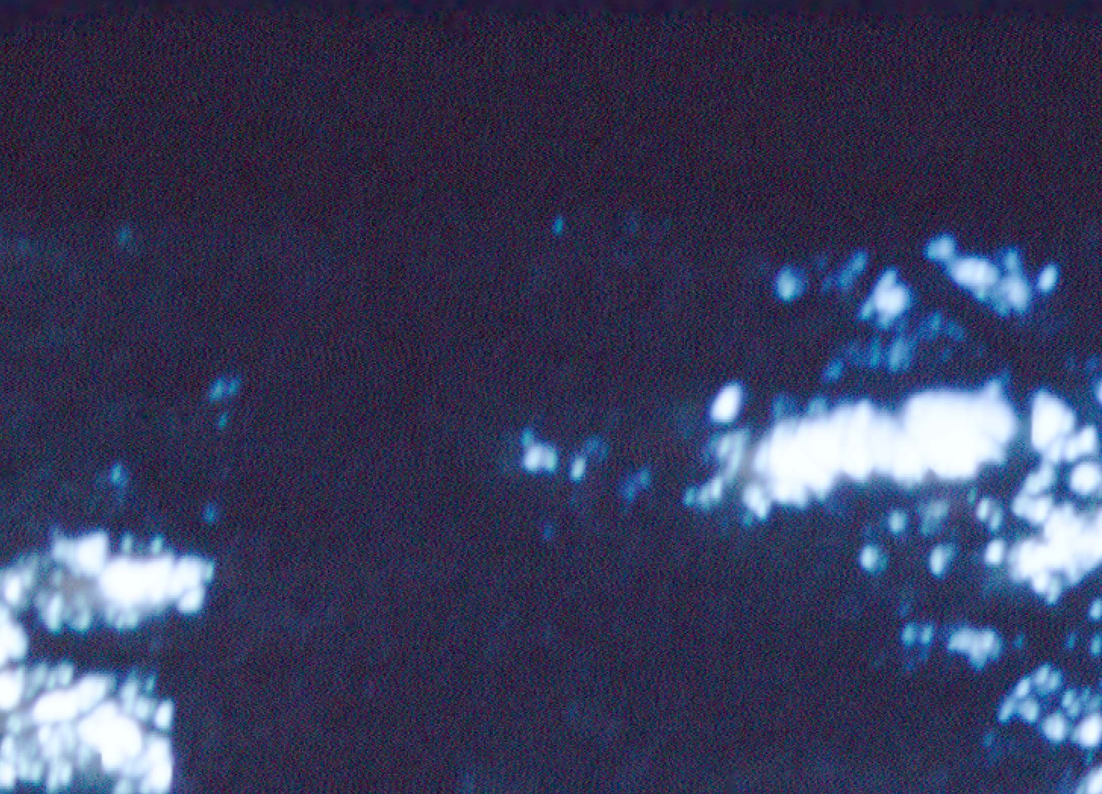

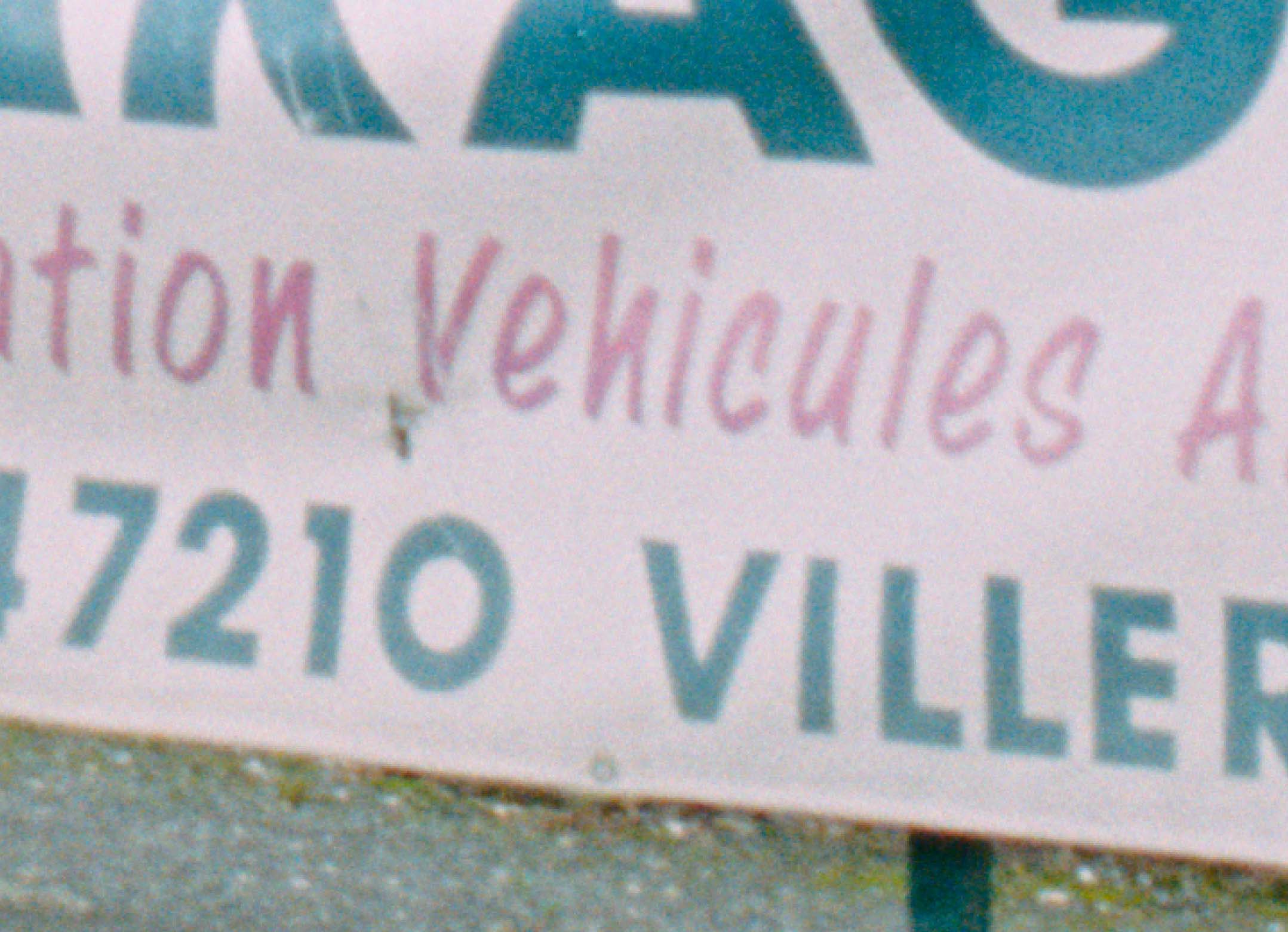

Here are two examples. One in the shadows of a slide. Another in the densest highlights of a negative. Click to enlarge :

It could be due too low exposure. I got 5400II and it had no problem in deep shadows due rather modern sensor. I also tested Dimage Scan Elite II scanner and noticed a lot of similar patterns in the shadows. x2 or x4 multipass helps a little bit to fix this problem.

Yeah, it's mainly in shadows and thicker part of negatives. But I have a couple of 5400 and the problem is less pronounced in one copy, that's why I believe it's - probably - an aging capacitor.

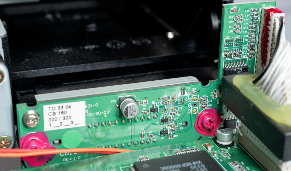

Here are some pictures to download right here. My most likely culprit is the CCD board capacitor but it's entirely guessworks at this point. And I was planning to have everything replaced. I might as well get a new power brick.

Ok, looks like they have kept the analog path as short as possible, which makes good sense. Here's the first place I'd start looking:
C32 (47uF) you could replace to begin with; it's an electrolytic cap that performs as a bulk cap for the sensor and A/D conversion board.
I'd also check the part number of the IC that's half-hidden behind the connector (actually ferrite bead) to the right; this is likely the A/D chip. It'll have some decoupling caps associated with it; C10 is one, but there may be others - e.g. C15 & C38 may serve in this role as well. Use the chip number to retrieve the datasheet and use the pinout to locate the power supply decoupling caps. Replacing those may help - although these ceramic chip capacitors generally last very long.
If I had the machine sitting here, I'd probably solder some leads to power supply rails in a few points, power it up and connect a scope to it to see how clean the power supply is in various places - especially during operation when the motors are active. The positive terminal of C32 would be a nice place to start; this should be perfectly clean with only single-digit mV noise (at the most); the same for the Vcc pins of the A/D chip. For good measure I'd also probe around different power supply rails on the mainboard (the one with the many IC's on it). There are some PSU-related areas there as well; notably bottom right (around the DC input jack) and top right (with the big power resistors, inductor and linear regulators) where most of the power conditioning is done. By tracing around the PCB you should be able to determine which regulators create the digital supply (which will be a bit noisy, which is OK) and which one(s) are associated with the analog circuitry (these should be pretty clean, especially as you get closer to the parts mentioned earlier).
I'd also be tempted to probe the test points/lugs on the B and R analog lines (the gold loops just to the top left of the pink mounting screw), although what you measure there might be difficult to interpret as it's not clear from the PCB if e.g. the sensor element itself is put into sleep mode during film transport or the signal clamped down by Q1 through Q3 etc.

The AD chip is labelled AD9826 by the way.
Check the capacitors that are connected to pins 15 and 28. Those will be the most critical. They will be one or two small tan caps of around 2mm length.
