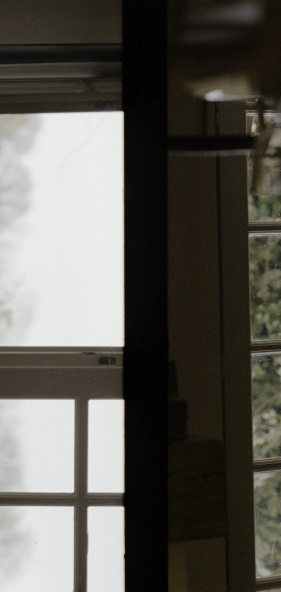

It's Nikon level I guess. An exemple with negatives (inverted)
It's really manageable with negatives, a bit less with contrasty Kodachrome :smile:

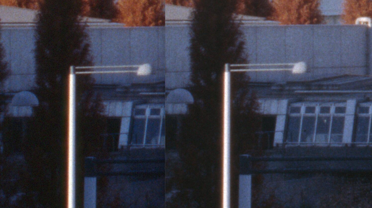

MKI has coolscan level flare, some unit can even worse than 5000ed. This flare is also caused by reflection from CCD cover glass, and it's colorful due to the RGB filters on CCD unit.
Here's an comparison between 5400 MKI with significant flare and 5000ed using the same high contrast B&W reversal slide. Left is 5400 and right is coolscan 5000ed.
I have cleaned the mirror, lens and sensor cover glass for both units. you can see this 5400 MKI produced narrower but more disturbing RGB flare, and the flare from coolscan 5000 is wider, but not so disturbing in this case. I've also seen MKI units producing less flare, but it's still observable when scanning high contrast images like this.
A 2005 post on photo.net also reported such kind of flare. You can see a similar RGB color flare around lamps. Original post also made a comparison between coolscan 8000, DS 5400 MKI and sprintscan 4000 to show how this flare behaves.
MKII uses AR coated cover glass, and I did not observe such kind of flare. Also, MKII have no zig-zag banding issue because it uses ceramic capacitor under the ADC chip. For the fixed pattern noise in the previous review, they don't use the official software and used Vuescan for MKII. However, Vuescan will recognize MKII and MKI as the same unit. If you have used MKI before, Vuescan will automatically use the calibration data from MKI and cause image quality problem, and vice versa, because light and CCD sensitivity irregularity is compensated by scanning software, not hardware.

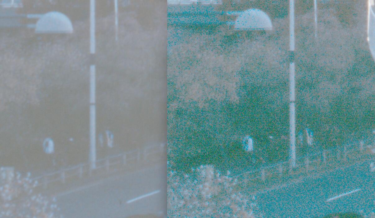

That's a little bit strange. After changing the capacitor, I also compared the noise level of both unit, and they performed very similar. I'm using a newly purchased 24V 2.5A PSU for both MKI and MKII. The adapter from Minolta is too big to be plugged into the AC socket. With Vuescan 9.8.11 I've also obtained extreme high noise level on MKI unit, especially in green channel, but on MKII noise level seems to be better. After updating the firmware and using the latest Vuescan it seems to be fine now, but I found strong magenta shadow cast only happen on MKI even if I have calibrated it with an IT8 target. I have to adjust brightness of each color to eliminate such color cast. On MKII it's fine. Previously when I use Elite II (no 5400) I found one unit will produce significantly higher background noise than another unit. At that time I just changed the ADC capacitor and I did not modify other capacitors, but the problem still exists. Till now I'm still not sure what caused this variation
I made a comparison between my MKI and MKII unit. Left is MKI, and right is MKII. I'm using latest version of Vuescan. This MKI unit shows much less color flare, but it still appears around high contrast objects. The noise level of my MKI unit is comparatively higher than MKII, and you can see more (but just a little bit)shadow detail on my MKII unit.
Comparing with Nikon scanner that have a lot of filtering capacitors and LDOs on its main board, Minolta seems to use less amount of the filtering capacitors. After such a long time, they may fail, just like the capacitor on the CCD PCB. If one capacitor failed, it may have larger impact on Minolta scanner than on Nikon scanner. The capacitor used by Minolta seems not from Japanese companies, so it may be affected by capacitor plague and deteriorate much faster. On my MKII I found one Luxon capacitor is used in DC-DC circuit. This brand is affected by capacitor plague, according to other report (but not verified).
If you can find some MKII CCD board, you may swap it to MKI and not have to delid the sensor. I have not compared the pinout of CCD board between MKI and MKII, but it looks almost identical.
