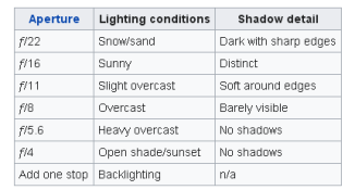

Sunny 16 says 4 stops from sunny to open shadow...

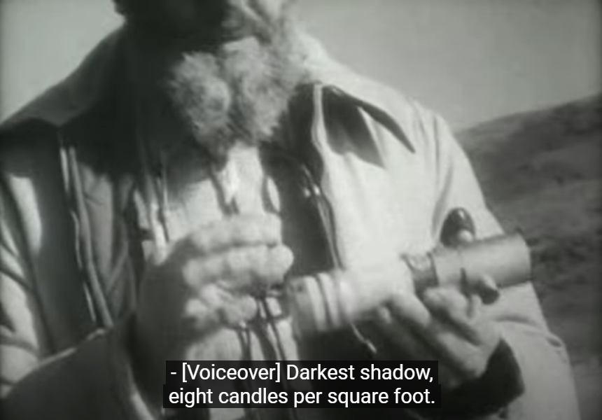

If you don't know how much Adams sometimes liked to burn the tonal values in the foreground into the floor, consider this earlier print. It looks like the light was much the same where Adams was standing as deeper into the scene. Certainly enough for him to have been able to check scene values with his reflected light Weston meter if he wanted.
Vedostuu's '-3 stops' comment was about how you index a shadow reading from a spot meter (for example) to give a correct meter reading to base your exposure off. Let's say your darkest shadows that you want a hint of detail in meter at an EV of 9 - if you index them to Zone II, you'll actually be basing your exposure off an EV of 12. Or you can use the IRE shadow index (-2 2/3 stops) etc. An incident meter used to read from your own shadow (using the correct EI compensation) should end up at essentially the same EV.

Indeed. And as the film of Adams shows, he sweeps the scene looking for the deepest shadow & brightest highlight he wants, allows for system flare (which also plays a role in determining his processing), indexes the shadow value to keep the deep shadows really dark & makes the exposure. And the process was vastly elongated/ repeated for the benefit of the film crew. All the SEI meter did was speed things up & essentially confirm what EV tables say.
