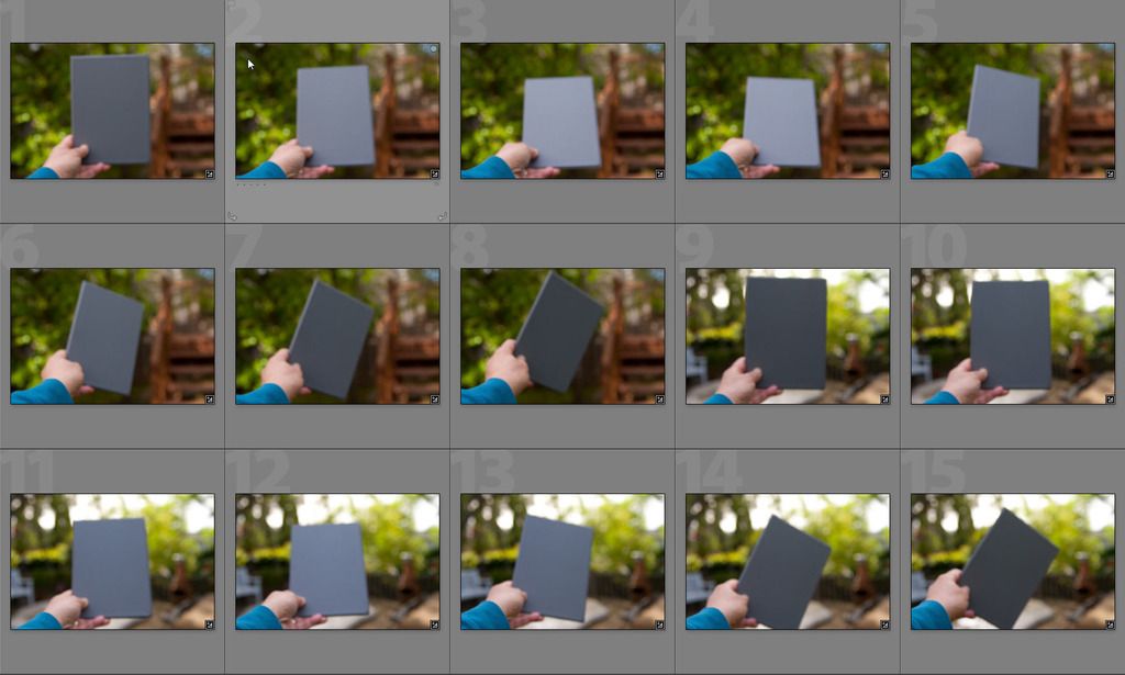

To wake the ogre asleep in the cave...a grey card is NOT necessarily consistent in the reading it produces!
Here the gray card can provide different brightnesses, as captured with one f/stop and shutter speed!
From two different camera angles (two different 'scenes' at 180 degrees to one another, but both at the same location -- my backyard-- and same time of day with consistent lighting)...this points out the need for some degree of consistency in how the card is angled.
Yes, but this is perfectly fine. If you tilt-swing an expensive Sekonic also under directional light then you'll also get the the shift in the reading. In fact you do that for portraiture to measure the key and the fill components, and you do both with the card and with the incident meter.
Both the Gray Card and the Incident meter have selective sensitivity to the orientation, the Gray Card is more selective, but this is not good or bad, for example when wanting to meter Key vs Fill the card provides better direct readings, but the card requires to be better oriented if we want a single basic reading.
While the incident meter reads worse the key/fill also the photographer may correct that from feedback, so problem is not big.
In the card instructions it is explained how to orient the card for a single basic reading, then we may tilt-swing the card to better understand the light nature we have. That variability in the reading is extremly useful to meter the diffuse vs directional components, to realize what light nature we have in the field, and to adjust light in the studio.
The Grey Card also provides the neutral color at the exposure level, while the white reverse provides neutrality at around +2.5. In a session it can be extremly useful to spend one shot with the card in the framing. A bare white sheet also is useful for that.
