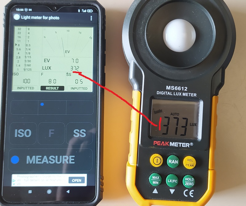

TEST PERFORMED
For incident metering, I've completed an extensive practical test, playing for some 60min in different illumination situations including direct sunlight, and pointing the meters to different directions.
Compared a Lux Meter to that App+Xiaomi Note 8 Pro.
Result: I got discrepances of about 15% nominal in the reading, this would be under 1/4 of stop perhaps 1/6. We may find that discrepance is common between commercial meters.
Disclaimer: Apps may allow to adjust corrections for the offset and gain, still some smartphones may sport a very directional senstivity that require a very different interpretation. IMO it can be recommended that anyone wanting to use the smartphone for incident metering he should check the consistence of the readings with an Lux meter or at least comparing with the spot metering on a grey card, checking different orientations to the light source.
(Since my Weston Master IV died I had no incident meter, personally I use Spot a lot, but I wanted to know if my particular phone could deliver a reliable reading if wanted, if I was always incident metering I would like a Sekonic or a charming Weston).
