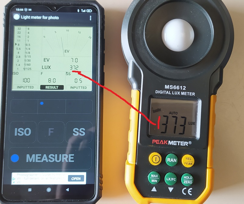

This is about comparing side by side like in the image I had posted:
If I had a Sekonic I would compare with it, as I have a Lux meter then I compare to it, this is about finding different illumination situations (direct, diffuse...) and comparing to se what nuances we tilt-swing the meter.

I use the "Light meter - Free" Android app, and using the front camera meter, I get almost exactly the same reading as a sekonic with the 3D dome (5.4 vs 5.6). However, I had to adjust the app by -1 EV-- it seems to be consistently off by 1 EV. I tested this with a DSLR and with my spot meter. The spot meter function in the app can produce similar results to my spot meter, but it's finicky.
A real light meter works better and more reliably, but the app will work in an emergency.
I get almost exactly the same reading as a sekonic with the 3D dome (5.4 vs 5.6). However, I had to adjust the app by -1 EV-- it seems to be consistently off by 1 EV. .

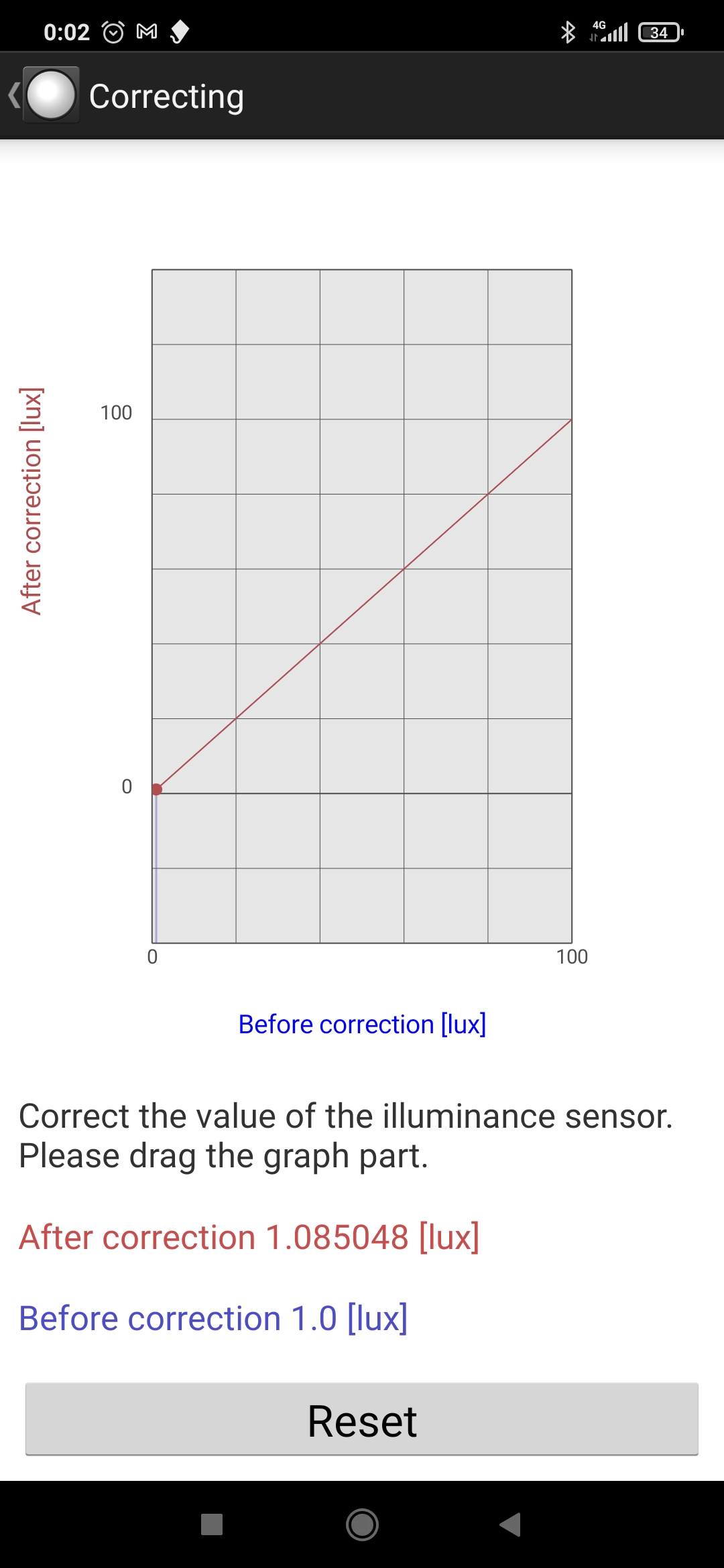

In the app I posted you can adjust offset and gain of the reading, just going Settings -> Correct Sensor

You may try it for free,and you may calibrate offset and gain... IMO it deserves a try....
