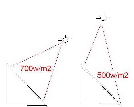

To simplify my question. Would a reading of an object be the same with a 1-degree spot meter if the sun's angles are different? Could that change the setting you choose?
If the sun chages its position it illuminates differently the faces of our subject, so the same spot will recive more or less light and it will be differently relfected, so tell an extreme difference you may have a shinning glare on an spot or another.
But when spot metering we approach the calculation differently. We meter Spots and from the metering we'll know what will result in that spot.
If we make a an ISO standard processing those spots metered 0+/- will have a 0.62D density over the Base+Fog (not exposed film). For each stop more(less in an spot density will increase/decrease by 0.62/3.33 = 0.17D.
So if I'm metering an spot in the scene, if reading is +1 then after development that spot should have 0.62+0.17 = 0.79D more than Base + Fog.
If Base + Fog of your film/processing is (say) 0.15D then total density will be 0.79+0.15 = 0.94D. We also know that spots at -3.33 will have 0.1D over F+B.
If performing N+/- these values will change acordingly...
Of course it is not necessary to calculate the predicted density when spot metering, but if having to print in the darkroom challenging scenes then we may end thinking in similar terms: we know the quality loss for each local underexposure stop and how difficult highlights become to print for each local overexposure stop.
At the end, with challenging scenes, before shutter release we balance what shadows will be lost to make some highlights easier to print. If the scene is not contrasty then meter like you want, no problem. Also if scanning then no problem, 3.0D is no problem for the scanners and later you do what you want with photoshop.
...but if having to print a sound optic print from a challenging scene then better if one thinks it twice before releasing shutter, or a sound print will be more chanllenging than the scene itself.
So your answer to my questions are what?
1. Would a reading of an object be the same with a 1-degree spot meter if the sun's angles are different? ________?
2. Could that change the setting you choose? ____________________?
I wonder how Miroslav Tichy metered his pictures. He probably used a spot meter.
Yes...
if rays come at 45º light received is 70% of the case light is perpendicular.
Also the reflectivity changes depending on direction...
Yes...
Suposedly you want a shading to depict volumes, in case of incident metering you don't change the reading. Incident metering would be the perfection if illumination was always uniform, but it isn't.
But in reflective spot metering you also correct the exposure depending on the relative brightness of the subject. If you meter on a perfectly white wall then you want that wall at +3, if you meter a very light caucasian cheek you want it at +2.. if you meter on concrete you want it at 0+/-
If subject is mate and illumination angle aganist the surface is 45º then you should correct exposure by 1/2 stop.
