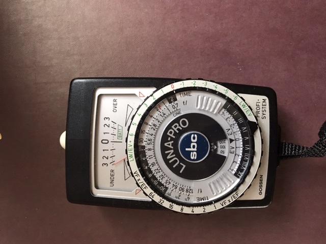

This Gossen Luna Pro SBC light meter seems to get the job done and it works for the Leica M2, Mamiya TLR, 4x5 Graflex Crown Graphic and Deardorff V8. With practice, Sunny-16 works pretty good too.

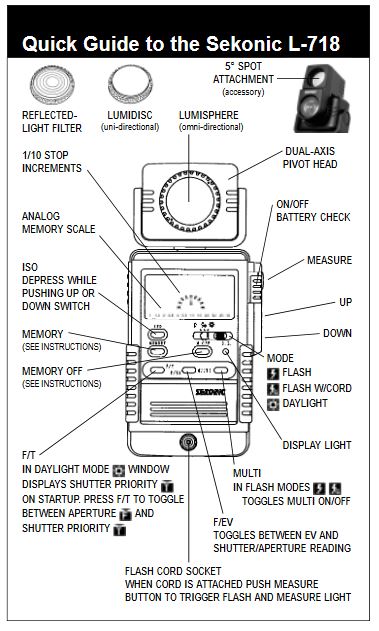

Check out the L-718 Sekonic. I have used it successfully in all these modes. The spot attachment is a bit wide at 5° but quite usable. Mine has stayed accurate for many years. Attached is a summary:
