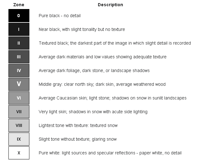

I mostly practice ZS and I'm happy with it, ZS is about spot metering, you spot the zones. Any averaged system is manfestly lower in control, still it may be enough. But before spendind a 8x10 sheet (two, with the backup) what I want to know is the exact +/0/- exposure I have in each spot, and what will result after the planned custom development, including custom agitation pattern. No doubt that some scenes are simple to meter and process, others require quite an effort...

ZS is not obscure, you have a table and an easy recipe, made to teach rookies, this is the table:
Anything obscure in that table? Nothing new !!! it only tells the film nature (of classic films, specially).
ZS prompts the photographer to visualize the final print he wants before shutter release, in that way you may expose/process to have it. If not the many variables the in the workflow may deliver an aleatory result, nothing wrong with lomography, but if you want to nail depth in the final image then you should understand scene, you should know what you want and you have to play the path between the two things.
> Today raw ZS has two problems, first in 1960 exposure was shifted by one stop, so the "zones" vs meter have that shift
> "Modern" Linear films are less suitable for ZS recipes because the extreme zones are not compressed (S shape curve) like the table suposes, so on the paper we have natural clipping instead natural compressions, commanding additional techniques when the scene range overruns the paper range.
Ansel "discovered" Visualization (divine inspiration :smile:) when shooting the Half Dome with the crappy Adon he had by then, but Visualization is in the creative process of Artists since humanity was painting in the caves, as Michael explained to all 5 centuries ago.
ZS is not obscure, it is pure common sense: at -4 you have black in the print !!!
Today we have new tools: linear films, good variable contrast paper, advanced techniques. Still the "common sense "core concepts" of ZS are still in force, because ZS is about common sense.
