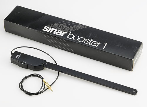

The Minolta Autometer 3 will do all three function providing you can get the attachments to fit over the sensor. I was lucky and bought the as a bundle. The meter has a memory function as well and have yet to find it anything but very accurate. The spot-meter is actually a 5 degree meter rather than the normal 1 degree, To be totally honest, I cannot see that it makes any significant difference.
I have the same meter and have used it for years. However, the 5 degree is for the IV. The Autotmeter III uses a 10-degree spot. The 5-degree attachment is not recommended. You might want to check. In any case, I aim the 10-degree spot for an "average" looking area. (I mainly shot chromes with it). Then I bracket a stop or half stop. Medium format is relatively cheap and bracketing is cheap insurance that adds only seconds to do.
