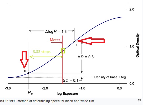

Please see this graph... Light in the Hor axis (Log scale) density in the vertical axis (Log scale)
When you enter the film ISO in the meter, an spot reading +/-0 will be situated in the red vertical line (green square), before 1960 the meter aimed it was in the n point.
m is the "speed point", the exposure at what film starts building density. ISO norm considers places that exposure point where density has increased 0.1D over base + fog. There is another requisite for the ISO calibration, development should be nailed to increase density (over the density in the speed point) by 0.8D if exposure is increased by an x20 factor, whick is 4.3 stops. But from the meter point to the speed point we always have (in the ISO calibration conditions) 3.33 stops. Meter point to the speed point = 3.33 Stops.
For this reason, nominally, you always have 3+1/3 stops latitude. If you shot manual and use spot mode, an spot reading -3.33 will be in the speed point, mostly with texture destroyed.
Of course some developers will add or loss some speed (1/3 stop?), a reference Full Speed developer was D-76, but today a manufacturer may use the developer he wants to make the ISO calibration, he should say what one. For example Foma uses an speed increase developer to say the speed rating, what can be a bit missleading.
_______
For advanced metering, you always keep in mind where the m point is, what image quality you have there (at -3.3) and how it improves at say -2.3 or -1, depending on film and processing. Each spot in the scene has it's particular local exposure, you may read it if you want.
The more accurate you meter and expose (shutter tested?) then the more you can play in the underexposure Zones having a controlled result, and having to overexpose less highlights. So you may want to need a lower personal safety factor, you get that from consistency in the workflow, which is quite appreciated for LF: You shot way less and want all your shots on spot if possible.
I would say treating flare as a safety factor is not a good idea. Refer to the diagram I posted. Even if we assumed the flare factor can be accurately predicted, flare is not simply uniform extra exposure you can offset by underexposing. Flare compresses contrast/detail, and it does this most at the low end of the exposure scale. The last thing you want to do is destroy even more shadow contrast by moving those compressed shadows further down the characteristic curve where the film itself has less contrast.

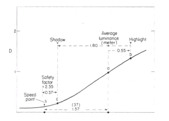

Here's the 1960 Nelson paper:
http://beefalobill.com/benskin/content/safety factors in Camera Exposure.pdf
In average lighting, flare brings exposures that you think are at the speed point up in density as if they had received 0.4 greater exposure (about 1 1/3 stop).
This is "previewable" on a spotmeter. You can also think it through, walk up to a car on the street and meter the light underneath. Then walk away from the car and meter the same light underneath the car. From where you are now, the new reading will be higher due to flare.
It could be argued that your video demonstrates a change in ambient lighting, more than flare-- I assume, in order to get closer to the dog, you were literally closer-- so you were blocking reflected light from the pavement (even in shadow, you being next to the dog alters the reflected light around the dog).
Even so, as you point out, that's a heavily back-lit scene-- unless you want the garish, washed-out background, your metering should incorporate the highlight areas as well. Personally, I would meter the dog's fur, as it appears to be the darkest area, "scan" the shadows between me and the dog, and under the table, and also meter the area behind the dog (the brightly lit background).
Your example of metering under the car while next to it, is irrelevant for metering a photograph taken some distance from the car-- all you're really demonstrating is that you need to meter the scene you're actually going to photograph. The "flare" as you put it, is going to affect the film as well as the metering, so it should be part of your measurements.
When I mentioned you can decrease exposure 1/3 to a half stop, I didn't mean dial in 640 for your 400 film as a matter of course (but you can). I just meant you can get away with it when you need to. I still dial in 250 for 400 film because after all the studying I have done, I have decided for myself that I want better negatives for less difficulty in the darkroom, and I believe that a slightly greater exposure will give me that.
Bill, this Jan. 1960 paper is quite interesting... it just paves the way for the 1960 Film Speed Change, when box speeds were doubled but contained the same film.
Interestingly, it considers that speed point to meter point was H = 1.57, this is 4.7 stops, and not 4.33
IMO that paper was to justify the Speed Change that was in course that year... and probably that change was aimed for the consumer segment.
Of course consumers obeyed and dialed the new speeds, exposing the hallf in 1961 than in 1959. Instead Pros and Artists mostly ignored the new stamps on the boxes. Suposedly they had their workflow well tunned, and it would be LOL thinking they were to change how they worked because of an stamp.
Still the 1960 x2 speed new stamp still generates controversy today, 60 years later.
In the ZS some some say that meter has to aim Z-4 instead Z-5. Others rate speed to the half (250 to 400 is nearly the half), and some say that very deep shadows have to be placed in Z-3 instead Z-2. Well, it's all the same... this is exposing like in 1959 before the speed change, and just before that paper was published.
_______
Another interesting factor is how Nelson defines Safety Factor: as the distance from speed point to "shadows"... but each shot has a particular shadow depth compared to metering.
IMO, that speed change had to be favoured for consumers, it was mostly benefical, but that paper sports some conceptual flaws when generalizing about what is the "typical shot".

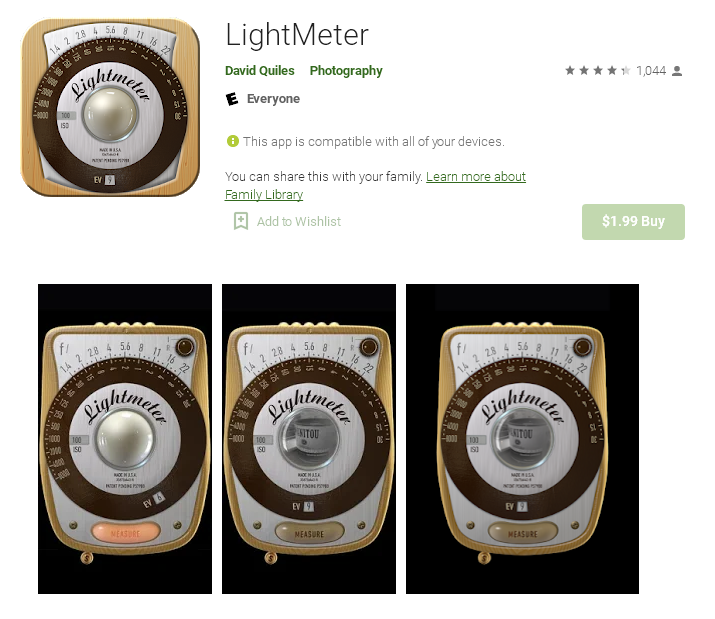

I just found a nice little device that can do incident metering, reflective metering and reflective spot metering all in one device and it is extremely small because it attaches to the phone.
https://lu.mu/
Did anyone use it? Is it any good?

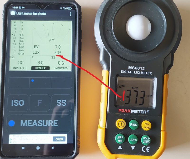

Alan, mine it is, and it is a cheap ($250 ?) Xiaomi Note 8 Pro, just tested it right now to show it to you, see bellow.
The App may use the light sensor for screen auto-bright or the front camera. If it uses the light sensor then reading may differ because that sensor is usually very directional.
Still, best is purchasing a (cheap) lux meter and also comparing to spot reding on a grey card to make sure both the phone and the App are working ok. The great thing is that if it ends working OK then the investment consists in a some $20 lux meter that may also be used in the darkroom for film calibrations.
Please note that I was talking about the Luma sensor for the phone. So there is indeed a separate sensor that is advertised as being extremely accurate.
But today I learned that the external sensor is (of course) only used for incident metering. For reflective metering (spot and „normal“), the phone‘s camera is used.
Yes, of course. My intention was to suggest that you may save $200 to $400, having also very extremly accurate readings, without having to carry an accessory, but pointing that it has to be checked if the phone-app combination is accurate, so it was not a direct answer... only telling an idea I judged it could be useful and cheap.
