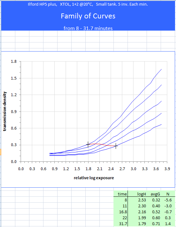

OK, after a bit more work with the spreadsheet, I have now shifted the relative placement of my curves up to simulate reducing the exposure (if you remember I had overexposed the stouffer step wedge thereby not getting into the toe region).
This shifting permitted me to create the toe for each curve. I already had two points in the toes on the curves, the FB+F and the density of one step from an X-Rite cal film having a Tx_density of 3.80.
Now having done this, I notice that I probably didn't develop for long enough. Given I was using Xtol 1+2, even though I extended out to nearly 32min@20degC, it looks like I needed to take it out to perhaps >50 minutes in order to get out to N+3 (avg. gradient =1.0) on the curves. Does that sound reasonable ? If so, then to save me exposing yet another film, can I assume that it is now OK for me to extrapolate my existing curve of Zone System [N] vs. development time[min] (bottom left of the 4 curves) out to say t=50minutes ?
One thing which makes me weary of doing this is that Ralph's example had him reaching N+3 and his corresponding curve is much more linear above N=0 rather than concave down (like mine). Now of course he used Tmax100 in ID-11 (I used HP5+ in tol 1+2) which could account for the different shapes, but I'm not familiar enough with the shapes to know if my shape is OK and whether I can extrapolate it or not.
My test summary:
Ralph's Test Summary:
My Family of Curves:
My spreadsheet:
View attachment FilmTestEvaluation #002b of Ilford HP5plus 120 in XTOL 1+2.xls

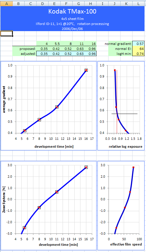

Peter,
There's nothing wrong with the shape of the Time/Gradient curve. The shape depends on the film/developer/methodology combination.
One of the advantages of plotting a Time/Gradient curve is that you can extrapolate data. One potential problem of attempting to extrapolate too much above the available data is there's no information about when the film hits gamma infinity.
Looking at your curve, I'm not sure if the film will make a gradient of 1.00.
Steve

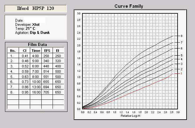

Peter,

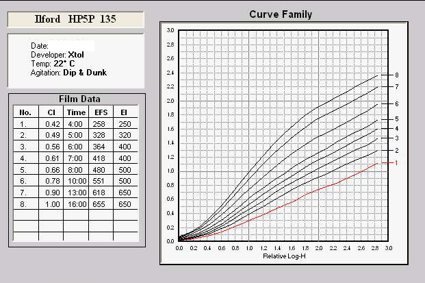

I've attached a family of curves for HP5-P developed in Xtol. I have a feeling if you want to achieve the higher CIs, you're going to have to reduce the dilution.

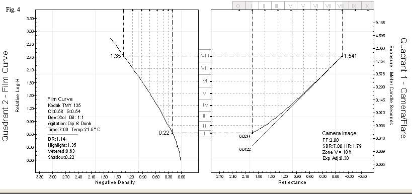

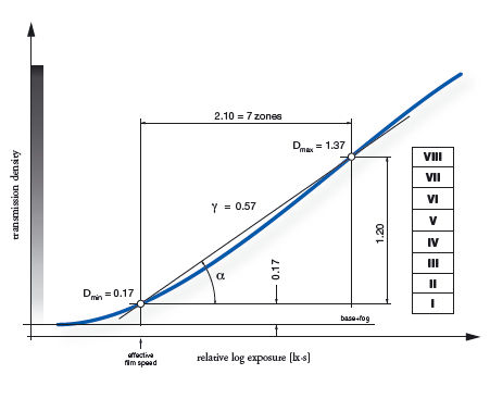

Is Ralph's effective film speed at 0.17 above B+F ?
Well, my lens/shutter has been mostly CLA'd (2 speeds are still out by 1/2 a stop), and I have now repeated the test to determine the film's ISO in my workflow.
I need help interpreting Ralph's instructions. In summary I need to know if he is suggesting to set the speed point at
  1. 0.17 absolute transmission density, or
  2. 0.17 above base+fog level.
My B+F=0.13, so if I use (1) then the ISO for my HP5+ seems unusually high at 635 , but if I use (2) then the ISO is a much more sensible 252.
Here are the instructions from Ralph's pdf above:
"A long but precise way to determine the normal EI requires one more roll of film and an additional test.....as explained in Way Beyond Monochrome, ....enter your normal EI into cell ‘L9’."​
then reading from p.139 in WBM, step 9.
"9. Using a densitometer, start with the first frame and twice the advertised film speed, count down 1/3 stop for every frame until you find the frame with the transmission density closest to 0.17 (Zone 1.5). The film speed used to expose this frame is your customized 'normal EI'"​
(I only reproduced step 9. to ensure Ralph still sells his book for those interested in the full test procedure :smile: )

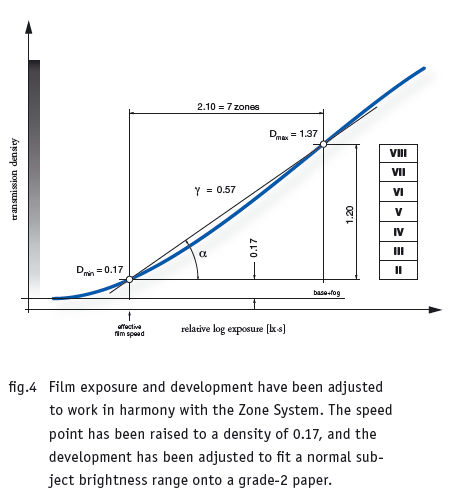

Anyway to put the 0.17 into perspective, have a look at the following Figure 4 from the pdf Ralph attached above.
So far so good, as it appears to refer to using 0.17 above B+F (so in my case this equates to an abs density of 0.13+0.17=0.40 which is pretty high but gives an ISO of 252 by my testing).
There are however two points which conflict with 0.17 being a relative measurement above B+F.
  1. In the Figure 4 above, the RHS column shows Zone II beginning at 0.17 rather than Zone 1.5
  2. All the density measurements done thus far for the spreadsheet and entered into the "Input Data" tab (fig 3 in Ralph's pdf) are absolute values, but in point 9. above, there is no mention that 0.17 is a relative value in the instructions.
Can anybody explain why Zone II is beginning at 0.17 and reassure me that 0.17 is actually a relative density measurement ?
thanks
Peter
The diagram clearly illustrates with two arrows (bottom arrow pointing up to B+F), the point selected is 0.17 above B+F.
With seven zones fitting in 1.2, each zone is 0.17 of density on film. Ralph positions Zone I so it is in the density range from B+F to 0.17.
Ralph may explain better but I think Zone I is "at" 0.09 and ranges from 0.00 to 0.17 thus Zone I 1/2 is conceptually the border between Zone I and II.
This is Ralph's method of determining the speed point, the film speed rating that produces .17 negative density above fb+f and there's nothing wrong with that.
In the ZS as it is taught in The Negative , the speed point is determined by the film speed rating that produces a Zone I negative density of between .09 and .11. In past discussions, I know that Ralph does not consider a Zone I neg density value and thus a Zone I print value (i.e., the first suggestion of tonality, but containing no textural quality) to be of any "pictoral" value at all. Therefore, he dismisses it in his interpretation of the useful log exposure range. Again, nothing wrong with that------it's the same ZS principle, but IMO, with a different interpretation on establishing the speed point. I'm sure when Ralph sees this thread he will quickly set it straight if I have mispoke.
Thank you Bill for reinforcing for me that 0.17 is indeed a relative measurement. I'll re-read WBM to see if Ralph's half zone nomenclature refers to the boundaries between zones while an integral zone number would refer to the mid point of a zone range. It does get confusing as I have always thought of each zone as a range rather than a discrete point, but the latter makes more sense.

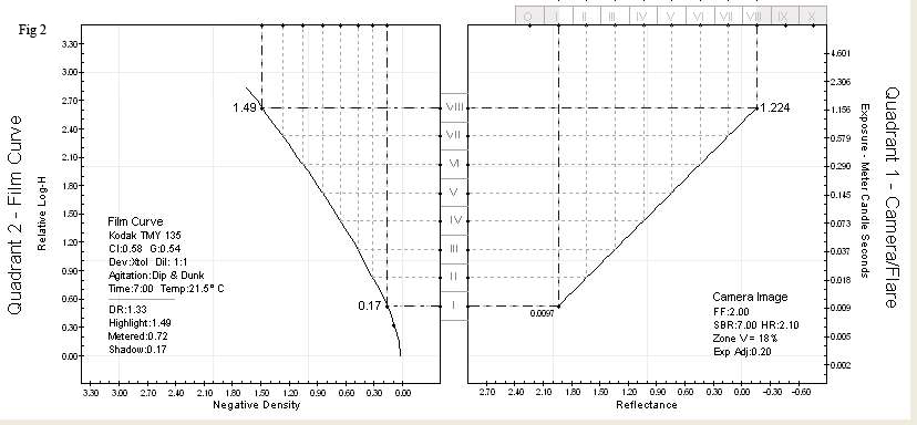

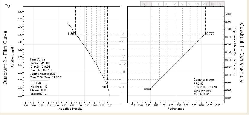

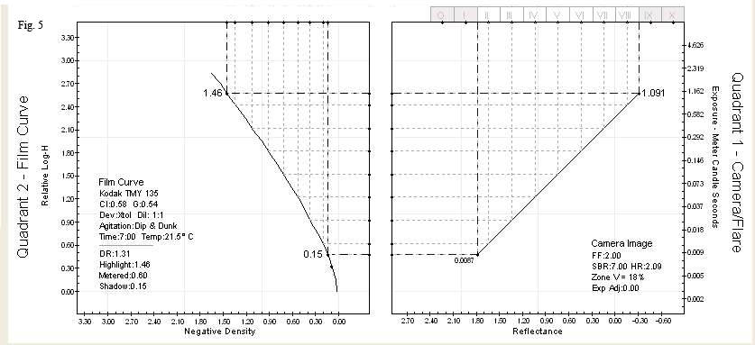

It’s hard to figure out where to begin. There’s the concept of speed point and exposure placement and how they are two different things. There’s also the question of the accuracy of Zone System testing. But I’ll attempt to limit it to the question at hand.
Bill pretty much answered question 1. The range for a zone is from -1/2 to +1/2 of that Zone with the Zone number falling in the middle.
As for the second question, it’s all relative with the film curve because apart from using Zones as a guide between the original subject and the paper curve, Zones have little relevance when it comes to the film curve. There simply isn’t a fixed relationship between Zones and negative densities.
The scene has a luminance range and camera exposure places it on the film curve. The key is to place the scene’s values on a portion of the curve with a sufficient gradient to separate the tones on the print. Increasing or decreasing the exposure moves the entire illuminance range up or down the curve, but the luminance range of the scene remains the same.
In other words, the illuminance value that falls four stops under the metered exposure point is considered Zone I when shooting a 100 ISO film rated at 50 and it is also considered Zone I when shooting a 100 ISO film rated at 100. Using Ralph’s 0.17 as a speed point decreases the film’s EI as it relates to the 0.10 speed point by ½ to 2/3 of a stop depending on the curve shape and average gradient. This just shifts everything to the right 0.15 to 0.20 log-H units. The shadow falling four stops down from the metered exposure point doesn’t change from Zone I to Zone I ½ .
How it is illustrated in Ralph’s graph only works if you consider he is referencing how the change in exposure compares to using 0.10 as the speed point.

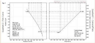

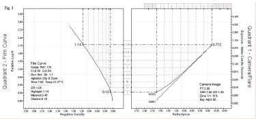

Figure 1 illustrates the relationship between the subject’s Zones and there placement on the film curve placing Zone I exposure at 0.10 over Fb+f.
Figure 2 illustrates the relationship between the subject’s Zones and there placement on the film curve placing Zone I exposure at 0.17 over Fb+f. It can also be considered simply increasing the camera exposure by 0.20 log-H units (2/3 stop).
Figures 1 and 2 represent the relationships in a non-flare environment such as during testing. Actual shooting conditions include flare.
Figure 3 illustrates how flare changes the relationship of the illuminance values with the subject luminance values. Everything is the same as with Figure 1 except for the addition of flare and an adjustment in the camera exposure in order to place the flare shadow exposure at 0.10 over Fb+f.
Figure 4 can be considered the type of results that are obtained using Zone System testing with 0.10 as the speed point. With ZS testing there is little flare. An exposure four stops down from the metered exposure point excluding flare will fall on 0.10 over Fb+b, but with the addition of flare that exposure produces a higher film density, but it is still considered a Zone I exposure. As flare varies from scene to scene, it is impossible to predict exactly where the shadow exposure will fall for a specific scene.
What makes Ralph’s example confusing is that he suggests decreasing the film’s EI to increase the exposure by approximately ½ stop, yet what he seems to be describing is a change in the scene’s luminance distribution. Figure 5 illustrates a change in the distribution of the luminance range from Zone I to Zone VIII to Zone I ½ to Zone VIII ½. While this will shift the exposure to the right on the film curve, the mechanism isn't the same as changing the EI.

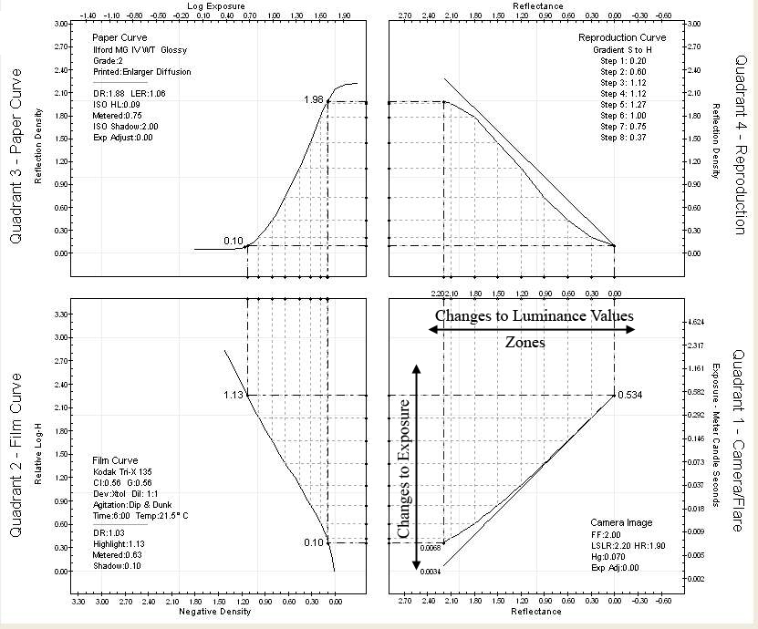

Maybe these two examples will help clear up my point. The four quadrant curve should illustrate the difference between changes in exposure and changes in luminance. The second example is an adjustment to Ralph's illustration.

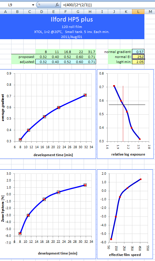

I will finish documenting my film speed test results here.
I wanted to share my latest version of the film testing spreadsheet. In summary I have made changes to permit the user to adjust their target density range. Ralph had defaulted it to 1.20 in many places (as he targets grade 2 paper in a diffusion enlarger). But because others will use condenser enlargers etc, I wanted to share my changes.
I replaced all instances of the 1.20 constant with a user adjustable value on the first worksheet (Input Data, cell K66). The value I adjusted mine to was 1.05 because I have a condenser enlarger (which would usually take it down to 0.9 as a starting point), but my camera system is susceptible to a reasonable amount of flare so I increased it by 0.15 to 1.05.
View attachment FilmTestEvaluation #003 of Ilford HP5plus 120 in XTOL 1+2.xls

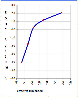

Now it is rather late in my evening and I want to get clarification on a major concept. On p. 7 of Ralph's PDF instructions in this thread (also in WBM p. 139), Ralph plots the Effective Film Speed versus Zone System N. I'm embedding the one I've come up with.
My normal (N=0) EI turns out to be 252 (no surprise there as it is 2/3 of a stop below the nominal 400). Hence for an N=0 scene with SBR=7, I would set my light meter to ISO 250, meter a Zone III part of the scene and expose accordingly.
Now, if I photograph a scene that is say N+2 (i.e. with a SBR=5), do still have my light meter set to ISO 250 or do I set it to the value of 650 shown in the above graph ? I'm pretty sure I leave it at 250 and I know I could answer this question myself by thinking about it and doing more reading, but right now it is late and it is quicker for me to type these 2 paragraphs and get a quick answer from the experts. Soon all this will be 2nd nature to me, but right now I am taking it one step at a time. BTW if you do happen to answer, please don't feel obliged to give a really long explanation. Just a simple yes or no will be plenty !
If you feel your testing method is accurate, then you adjust the EI; however, it's not an absolute requirement.
Thanks Stephen. I had forgotten that the shadow transmission (Tx) density increased with increasing film dev time. I should have remembered this last night when I posted, but my brain was shutting down as it was late.
The highlight Tx density on the neg increases much more (with increasing film dev time), the shadow Tx density does still increase to a lesser extent and this is catered for by giving less exposure by increasing the effective film speed. This is obvious to me now since the Family of Curves worksheet clearly show each toe region being higher in Tx density than the last as the film dev time is increased. Ralph points this out at the end of p. 139 in WBM (and prob. in many other places in WBM too).
I'm happy that my test method is sufficiently accurate for my initial attempts. Assuming I didn't make any unintentional errors then the only thing I would change if I retested would be to reduce my exposure times to get more of the toe in for each of the 5 films. I did get one point on 4/5 of the toes, the last one I guessed to match the obvious pattern that emerged. Full details specific to my testing efforts are in the spreadsheet I attached in my last post.
