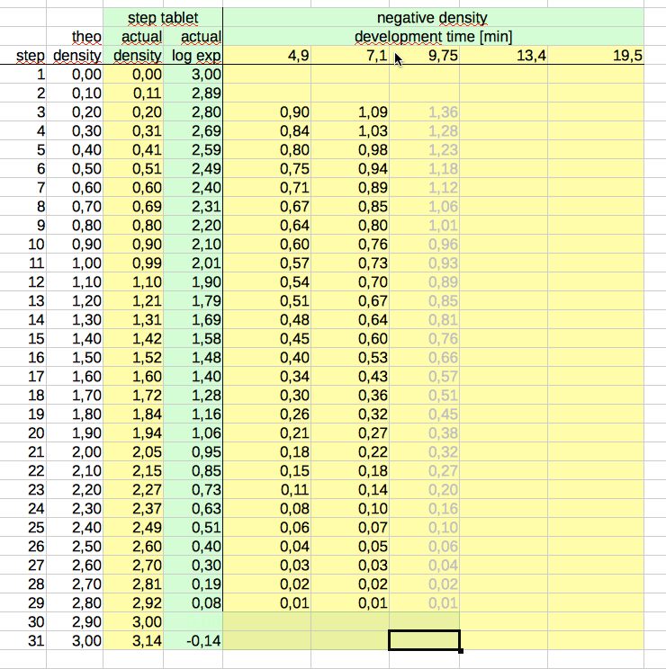

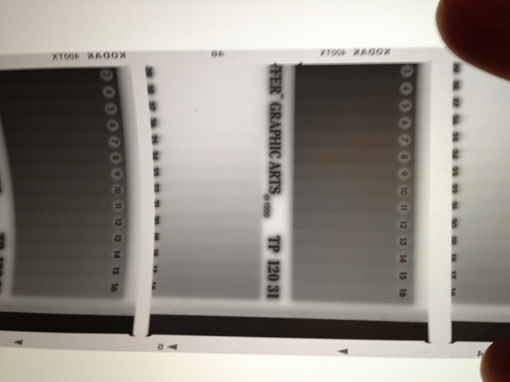

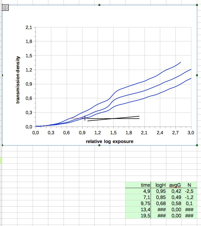

hello,
after i did the first three tests with the stouffer 120 6x6 I got following results -> see pictures
the steps 30/31 and 1/2 are missing because the stouffer wedge was displaced in the hasselblad filmholder :-(
- why I have this "jump" on step 16 to 16 (other side of the step-wedge).
- what do you think about those results in general?
- should I have to repeat the whole process or should i go on with minute 13,4 and 19,5 ?
best michael

hello,
best michael
Hi michael,
Double-check your actual step wedge "calibration" densities.
I don't think the jump is that dramatic, but it's interesting.
When I drew a smooth dotted line between points, the "outlier" on the 9,75 curve was the point for Step 17.
I see your calibrated value for Step 17 is 1.60. The "outlier" "fell into line" when I changed that value to 1.61. So double-check, maybe your calibrated wedge is 1.61
Regards,
Bill
Michael, the jump probably means illumination onto the Stouffer was uneven. I suspect the right half of the chart got more light than the left part. If you're using an enlarger as a light-source, this could mean the film-holder was not centred under the enlarger, so that the left half was farther away from the centre, experiencing fall-off from the enlarger's lens. Or the light-output of the enlarger might be uneven.
I suggest checking centring. You also might want to use an enlarger lens with a longer focal length and raise the head some. An easy way to test uniformity is to expose a piece of film in your film-holder, with *no* Stouffer present. Then measure density at various locations across the negative.

thx,i used a step wedge-negative placing in the hasselblad filmholder, photographing a white card placing on zone X; did this with 5 films!
maybe the displacing of the negativ leads to an uneven illumination (i lost steps 30/31 and 1/2)
should i repeat shooting 5 films:blink:

No, I think it's expected to have a jump at 15-16-17 because those steps are near the edge. My edge densities are often "higher" than the inner densities. Just look at the overall trend and ignore the anomaly in the middle - consider it an artifact of the layout of the step wedge.
thx,i used a step wedge-negative placing in the hasselblad filmholder, photographing a white card placing on zone X; did this with 5 films! maybe the displacing of the negativ leads to an uneven illumination (i lost steps 30/31 and 1/2)
should i repeat shooting 5 films :blink:
I downloaded your photo and looked at pixels in the two #16 wedges in Gimp. Densities by the centre are the same, but they're different by the outside. No need to repeat development. Just re-measure the wedges at the inside.
By eliminating the jump, you can compute CI accurately.
HTH,
Mark Overton

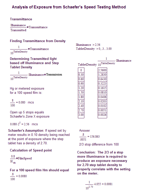

Mark, how are you determining speed/EI photographing the backlit wedge?
You'll laugh at this: I guess based on where various films hit .1 over B+F!
That's their ISO speed-point, and I know where that should be on the log E axis. Of course, developers shift that point, and there's no guarantee that the films themselves hit it exactly. But this gets me close. All my work has been comparative, usually comparing with XTOL's curves, so I haven't needed accurate log E numbers.
Mark
Mark, there is a way to quantify those results. It's not perfect as you can't be certain of the metered exposure, so any variance of the film speed can't be attributed with certainty to any one factor. The basic idea is to know the value of the metered exposure. Once you know this, you can determine the exposure value at what ever additional stops is given for the test. Next, know the target exposure at the speed point for the the speed of film being tested. You can then calculate what step tablet density that should fall at for a given speed with your chosen exposure value. The attachment breaks this technique down. It's from an analysis of a method proposed by Schaefer, but it should be applicable to your situation.
BTW, if your interested in learning more about the ISO speed point and what it means, check out the thread (there was a url link here which no longer exists) ,ISO speed determination constants - question for Stephen, Bill etc.
